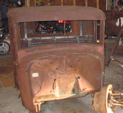

    anybody know for sure what year this one is? it came off a 1 ton, i thought it was a 32, but now hearing all this stuff about firewalls has made me curious.

    I believe that is a 33/34 firewall. The 32's were separate and the 33/34 were welded in. They also stick out a little for extra foot room.

    Yep 33/34. What does the back of the cab look like and does the roof have a screw on the ouside @ the windshild post holding the roof skin to the w/s post?
    If the back of the cab has 2 belt line moldings then it is a '33 if it has 2 + 1 fat one on top...for a total of 3 belt line moldings across the back of the cab than it is a '34
