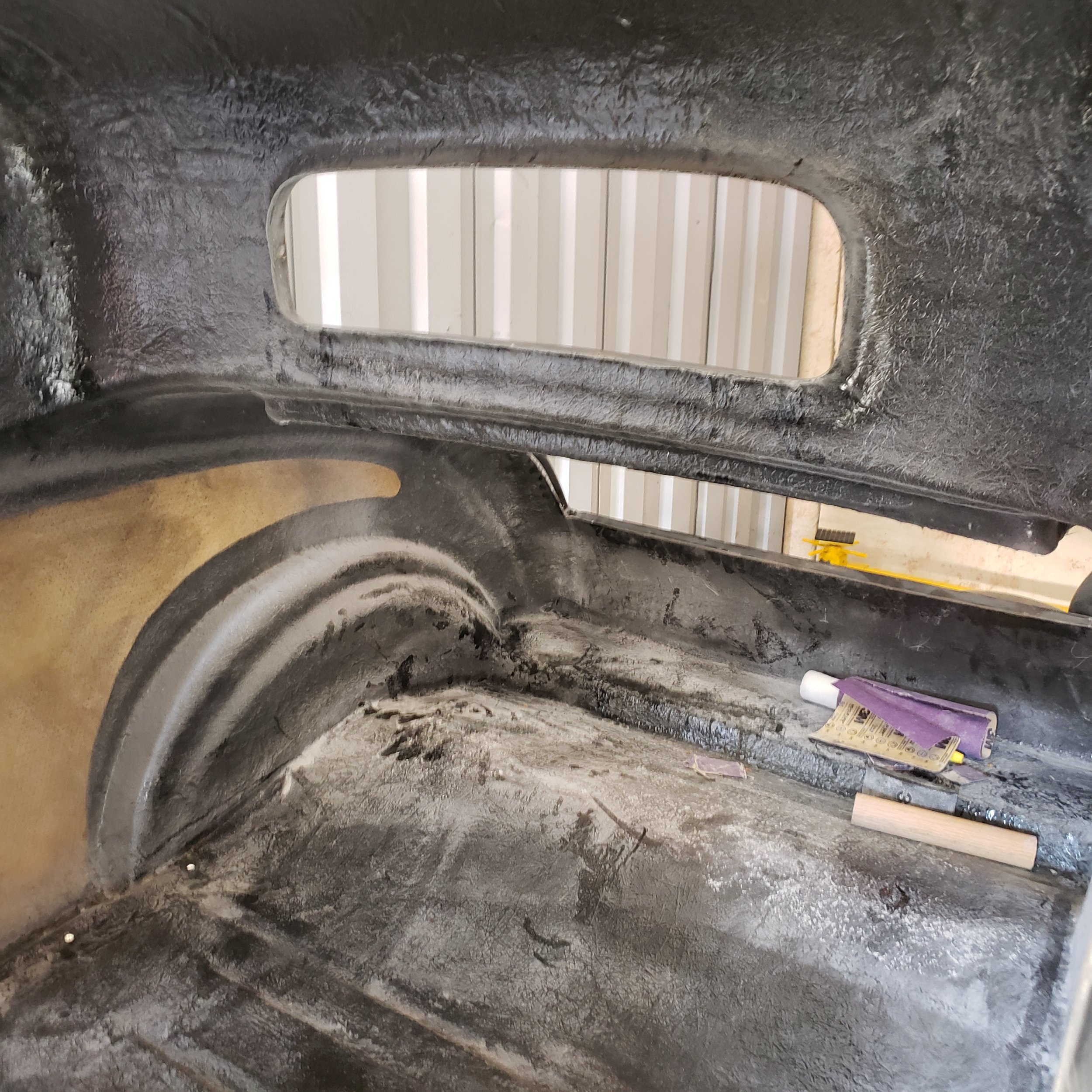

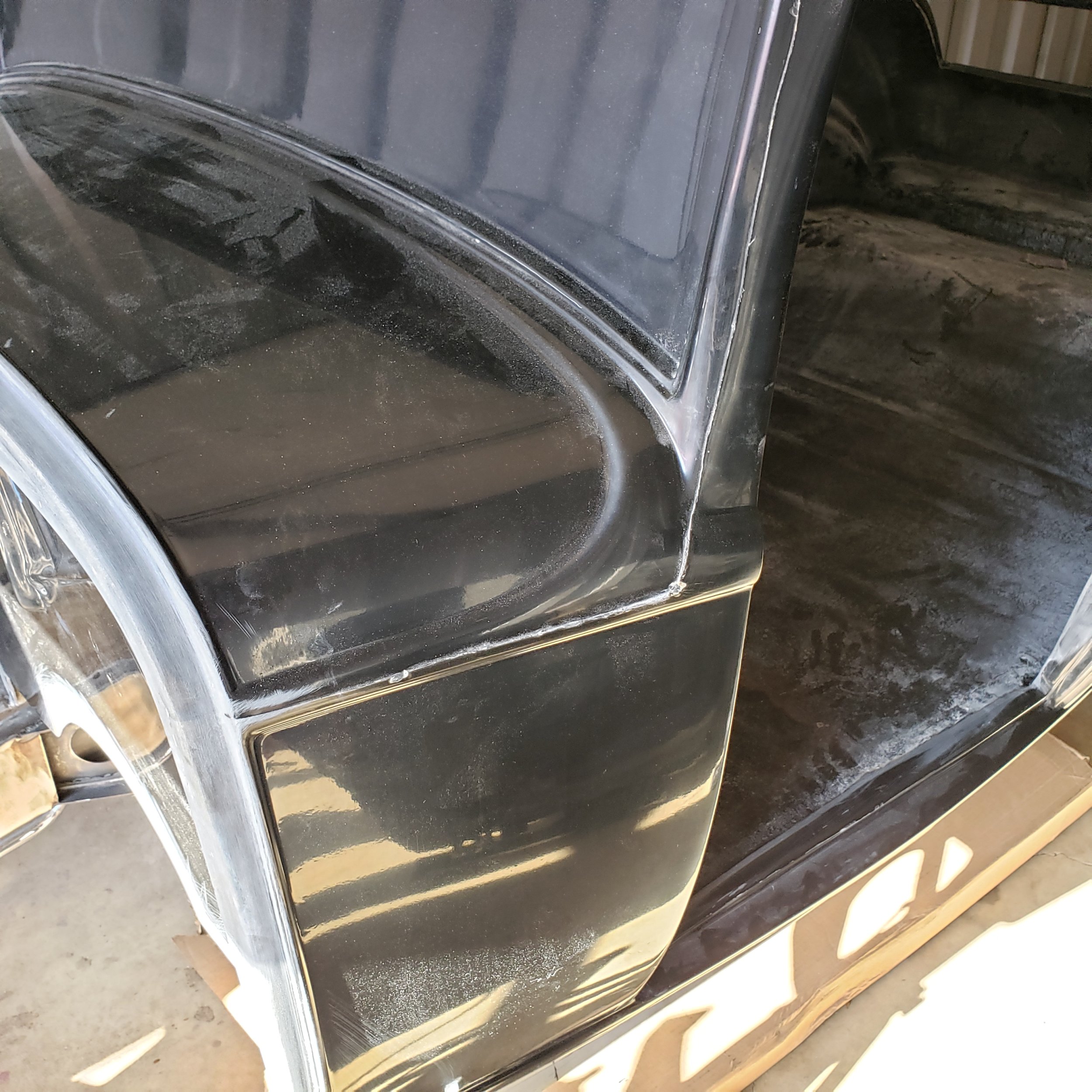

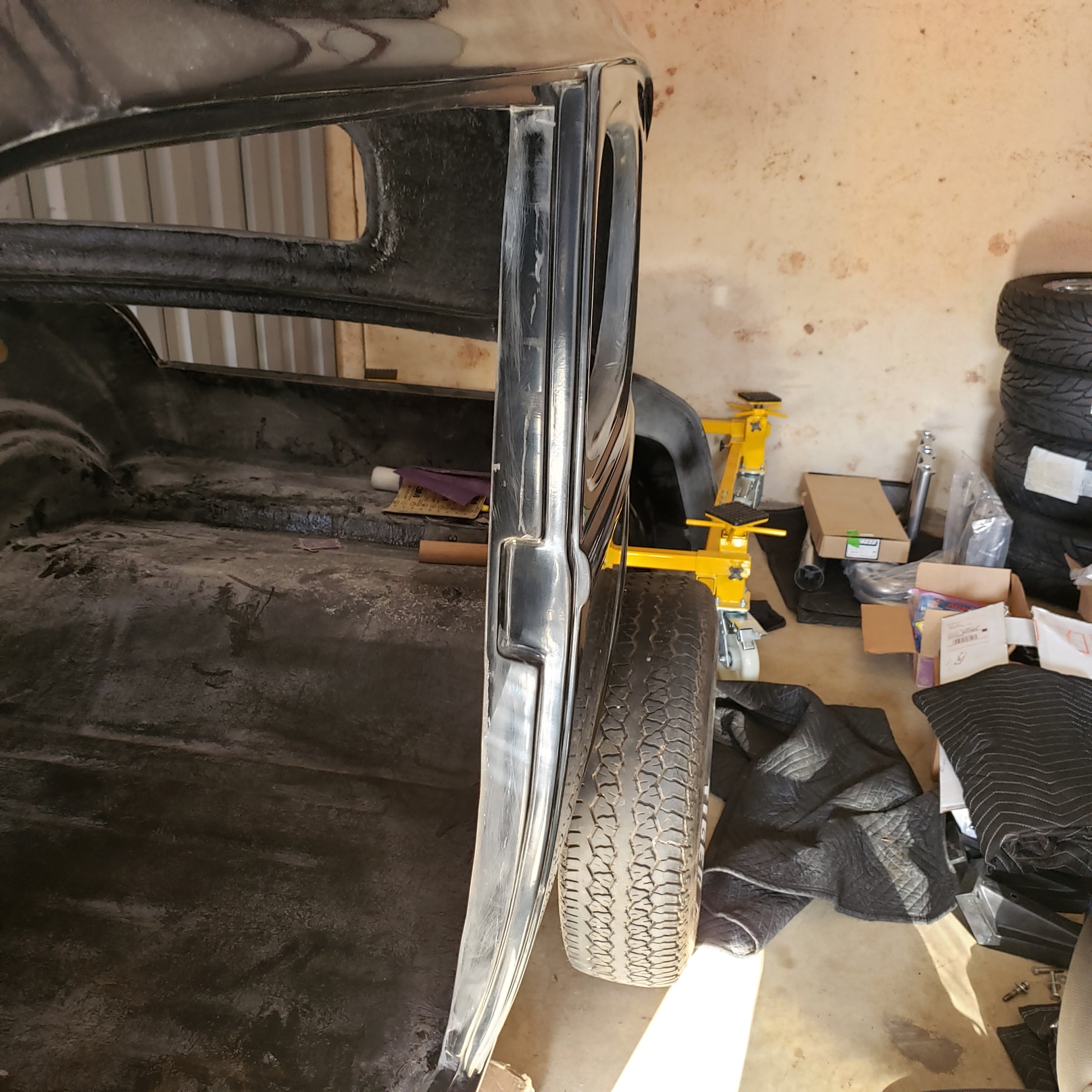

  17. Eric Stiegmann
    Joined: Mar 16, 2025
    Posts: 20
    Eric Stiegmann
    20250308_131454.jpg 20250308_131624.jpg 20250308_131638.jpg 20250308_131922.jpg 20250404_164337.jpg 20250405_170005.jpg 20250405_172852.jpg 20250405_172904.jpg 20250405_172946.jpg 20250405_172953.jpg 20250405_173000.jpg 20250405_173017.jpg 20250405_173047.jpg 20250405_173058.jpg
    guthriesmith, loudbang and swade41 like this.

    Finally got it home and into storage for now. Inventorying parts and making decisions on which way I want to go with the build. My son is relocating to Richmond Virginia in the next couple months and we plan to build a detached garage. That will take a bit so I will be limited to what I can do in the storage unit for now. The body still scares me. Thinking hard about whether it would be smarter to go with a more finished body like the New Age Motorsports body with the inner structure, doors hung, gl*** installed. Wondering if I can sell the County Line Rods body I have to a more experienced builder to offset the cost of a different one.
  19. alchemy
    Joined: Sep 27, 2002
    Posts: 22,987
    alchemy
    Yes, that body needs a whole lot of additional bracing and wood. Only fit for a very experienced fibergl*** man.

  24. swifty
    Joined: Dec 25, 2005
    Posts: 2,629
    swifty
    You say you can handle the welding stuff OK so why not attempt the steeling out of this body? All fibergl*** bodies here in Australia are fully steeled out with no wood used unlike a lot of the US bodies. Tube bending machines are readily available and would be necessary for the job. Deuce Customs here in Oz would be the most common supplier and may have pics of how it is done. I have a Deuce Customs body - 32-5W - but it's fully trimmed so most of the details are hidden now. I must admit that I didn't really investigate how it was steeled out as I bought it as a project from another rodder.

  26. Blue One
    Joined: Feb 6, 2010
    Posts: 11,550
    Blue One
    from Alberta
    Steeled out. Interesting, how is the steel bonded to the fibregl***? As far as I understand wood can be bonded to fibregl*** more easily and more permanently than steel can.
    Just curious how the tubing structure is attached to the body.
    Another advantage of wood could be attaching upholstery.

    I looked at New Age Motorsports. Looks like a very nice product. Unfortunately they have an 18 month backlog. I can put a refundable $500 deposit to get in line. Been looking at several pictures of how folks have installed steel and wood as well as how to bond fibergl*** to wood. Thinking I will put a deposit on a New age body since it is refundable and start working toward building this body out and see how it goes. Most of the wood parts can be purchased but will need to be modified for the chop. A lot of the steel part can also be purchased. I want to figure out how I will do everything before I start. Wood B pillars can be purchased but not A 32 ford windshield.jpg pillars. I have seen several pictures of fibergl*** builds that appear to have wood A pillar supports. does anyone know how that is done? I have another question as well. I want to cut out the windshield part of the body so I have more light working inside the car. Referring to the picture, from the main body there is a step then the flat part that needs to be removed. Not sure how much of that flat part to leave, if any. Does the windshield frame seal against the step directly or is there a rubber seal that needs to be installed on a lip that I would need to leave. If so, does anyone know how tall the lip should be?
  29. alchemy
    Posts: 22,987
    alchemy
    I highly recommend finding an original body to view before you begin. It will help a ton.
    I also think you would save a mint by making your own wood, because the original stuff will not be a direct fit in the gl*** body. In fact, Ford didn’t even use wood in the A pillar.
