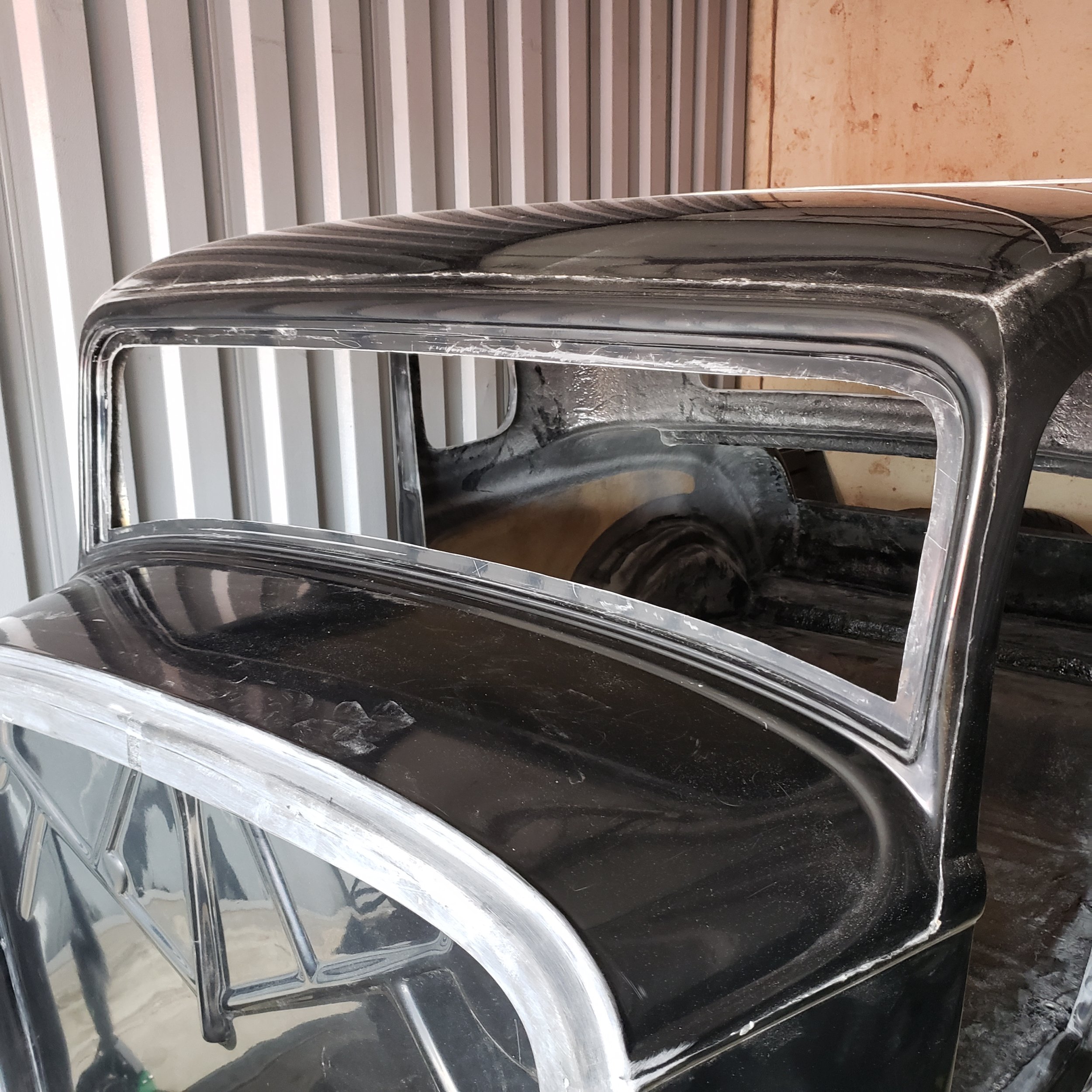

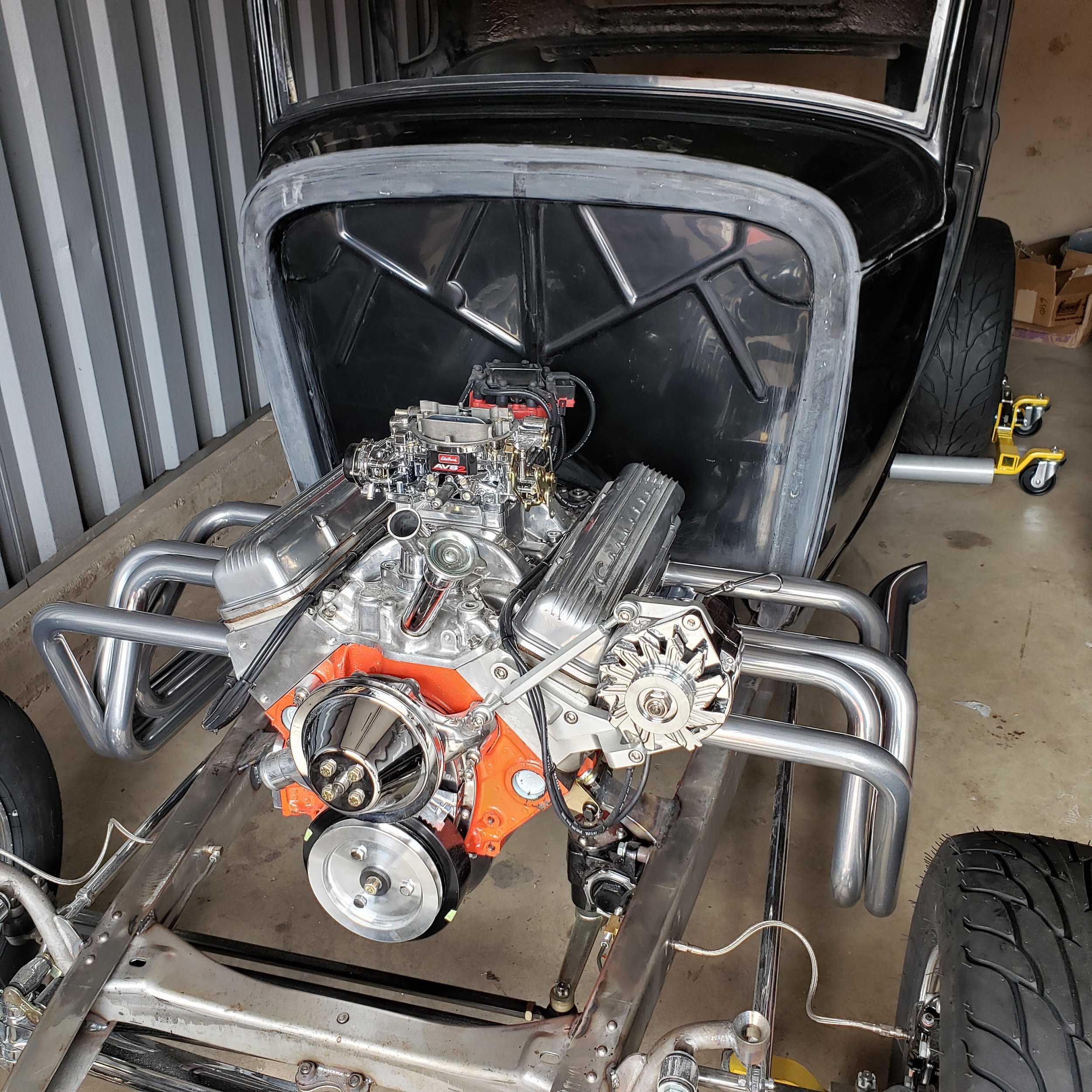

    Makes perfect sense. I trimmed the body a little and got it sit down on the frame. Only a few of the mounting holes line up. Most are close. I will look at that more to see why. I cut the windshield out to get more light inside while working on it. Don't laugh... I am starting to get it, why lots of folks don't like working with fiber gl***, what a mess. I wore a a respirator, a face shield and gloves. Also mated the bell housing and trans to the engine and mounted it all to the ch***is with the body on to see if I had any clearance issues. All seems to fit.
    As you recco'd I will focus on getting the body secure to the frame, then bracing the body and then door hinges latches etc.
    Thank you all for the advice, I really appreciate it. Windshield cutout.jpg Engine mounted.jpg

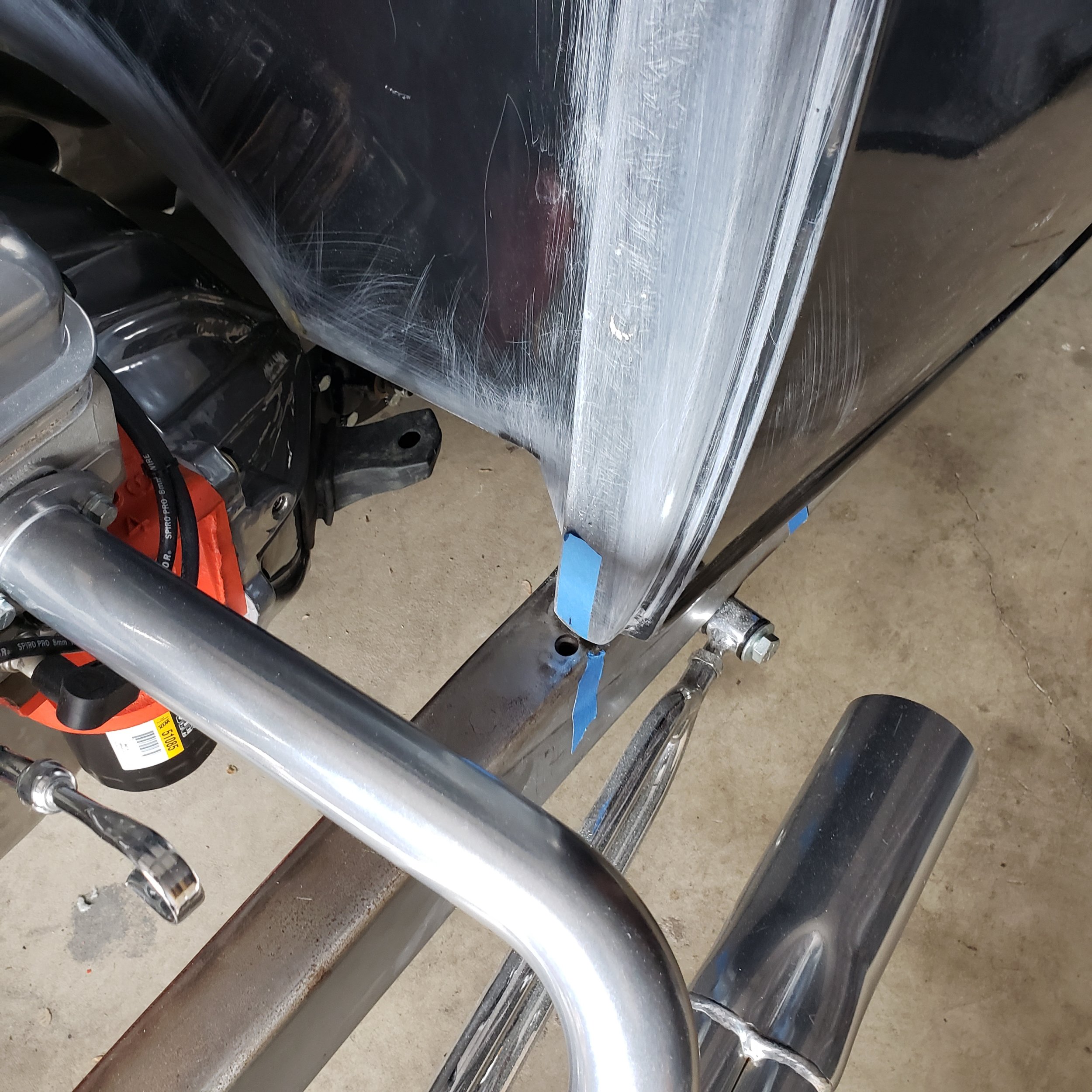

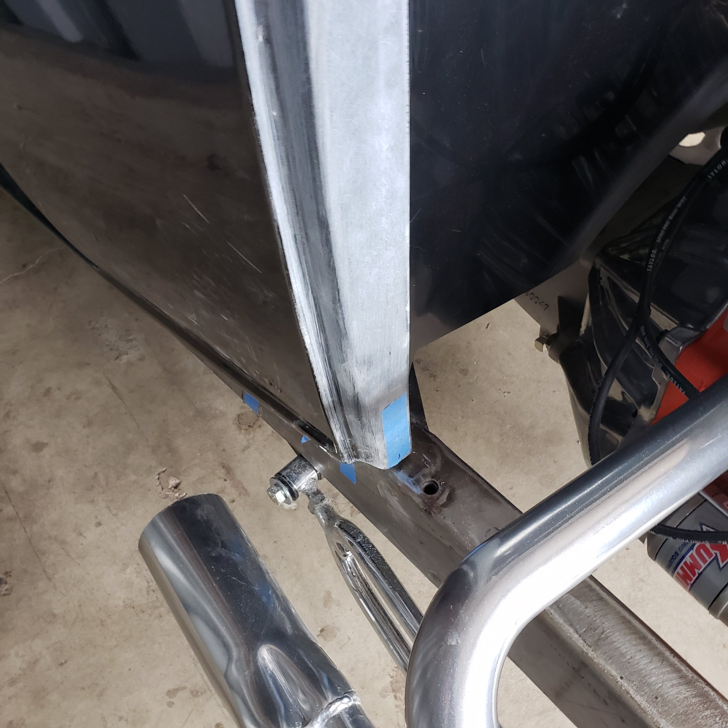

    Front rigth hole.jpg front left.jpg back right.jpg Been working on securing the body to the frame. Had to trim and clean up a few spots. When I position the body on the frame so most of the holes are close, the distance from the holes near the firewall to the firewall itself is off by and inch side to side. See pics below. If attach the body in this position, I will have issues adding a hood and engine side covers if I choose to later. To fix this, I would have to swing the back a good bit. Not sure that is the right answer and can't really as the body fits very snugly against the frame in the back. I measured the frame front right to back left and vice versa using the front bolt hole (for the firewall foot I believe) and the last bolt hole in the back. Side to side it is off 1/4 inch. Contacted the frame builder and see said that is OK. Any thoughts on what to check to see where the issue is?

    To be clearer, I am just using the bolt holes as a reference point as they are the same distance on each side from the front of the rails and from the radiator mounting holes. Which I believe means the body is not square to the frame or the firewall is not square to the body.

    Yup, that can happen when you get repro parts from two different manufacturers. Maybe the frame is off 1/4” one direction and the body is off 1/4” in the opposite direction.

    I would not be happy with a 1/4 inch difference corner to corner. I'd start measuring all the holes and plot them out, front to rear. If a simple ratchet strap or come along pull can get things closer. If not, I'd start checking the vertical height, too. Same with the body. I'd expect the frame to be closer to square than the body, but I'd measure things to know which way to 'fudge' things to align properly.

    so is your frame square ?
    Also,
    - Check that one frame rail isn’t slightly forward of the other
    If you want to run with a hood in the future, now is the time to also sort that out, along with grille surround positioning.
    ( a lot of cars out there have a sloping hood top - which maybe why some don’t run them )
    the other comment I will add, is ;
    these cars were nowhere near perfect from the factory, so sometimes everything won’t be perfect on a scratch build, - but it should always look right, such as the swages on the hood top lining up with the swage on the cowl, etc.
