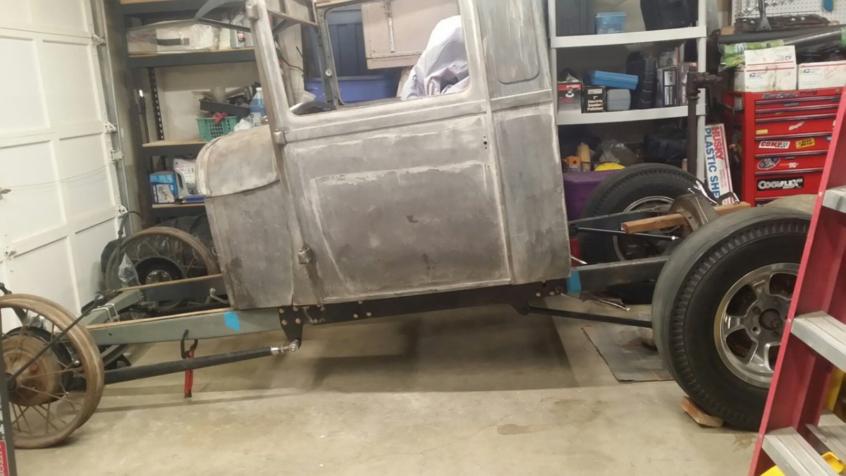

    That 32 looks great. Nice find. Looks like the progress is coming nicely as well. Just posted an album on my page, but here is the most recent picture of my build. Not a 32, but it is a 1928 Closed cab pickup.

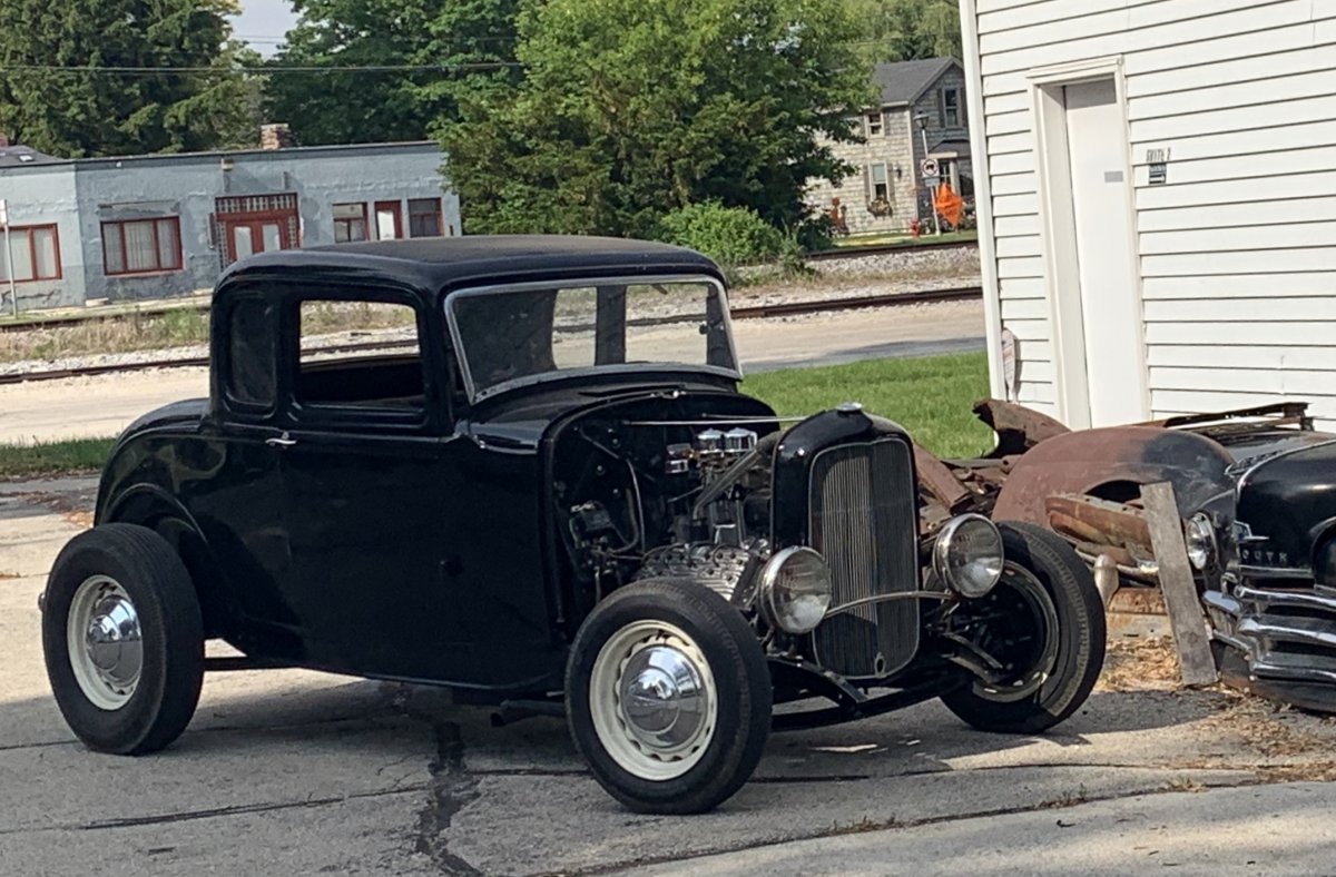

    Here's mine. Very basic early post war hot rod. 59ab,39 trans and 40 rear. 40 ford brakes all around with orig paint steelies.Real mor-drop big beam axle. I envisioned it this way for years before i actually built it. The bottom picture is from it's last resting place.It had been a hot rod forever.
