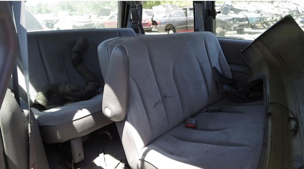

    As a matter of interest what make / year of mini van did you recover the seat from ?

    The seat came out of a 1994 dodge caravan 42 inches wide , perfect fit. Adjustments.JPG

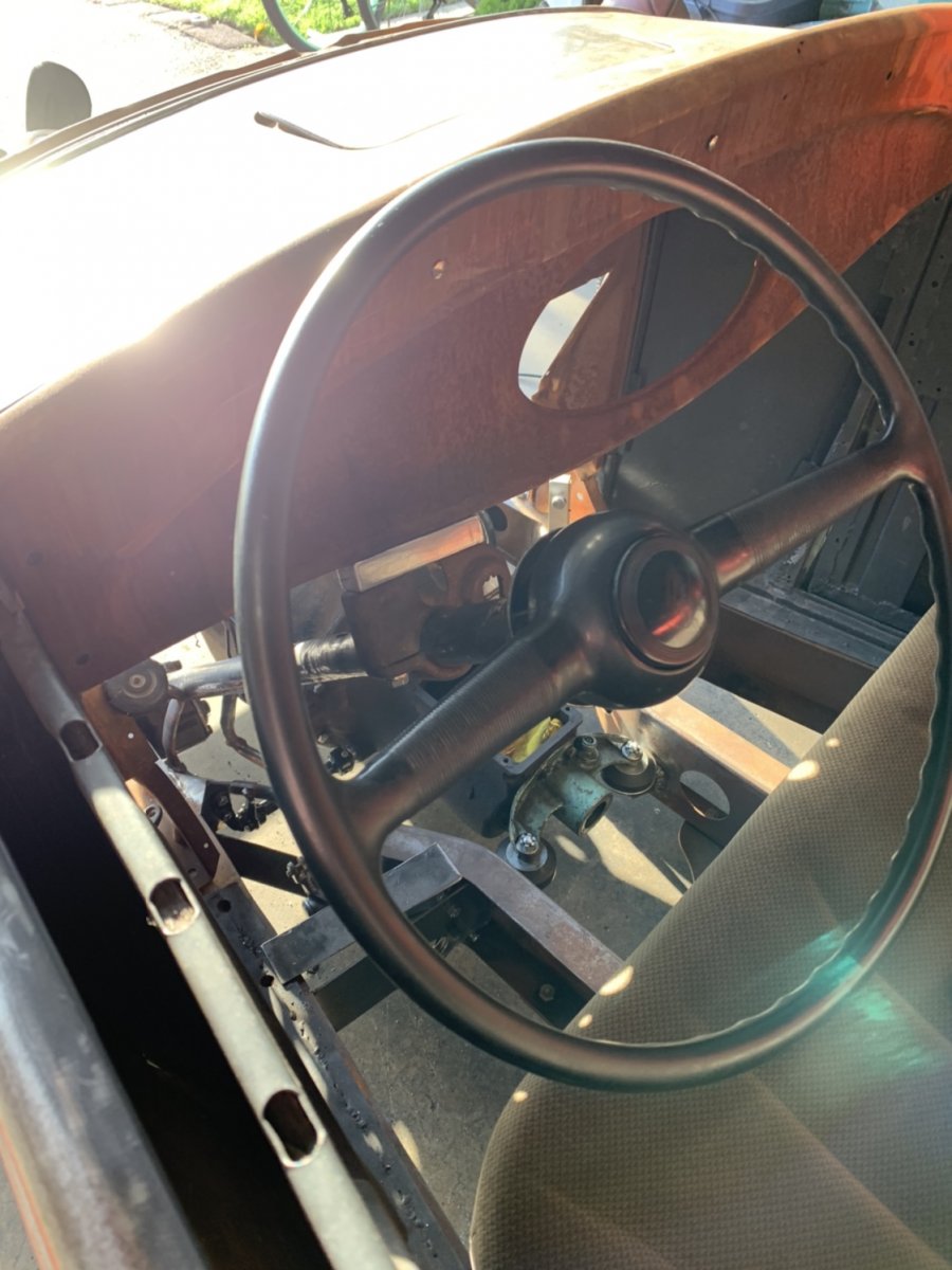

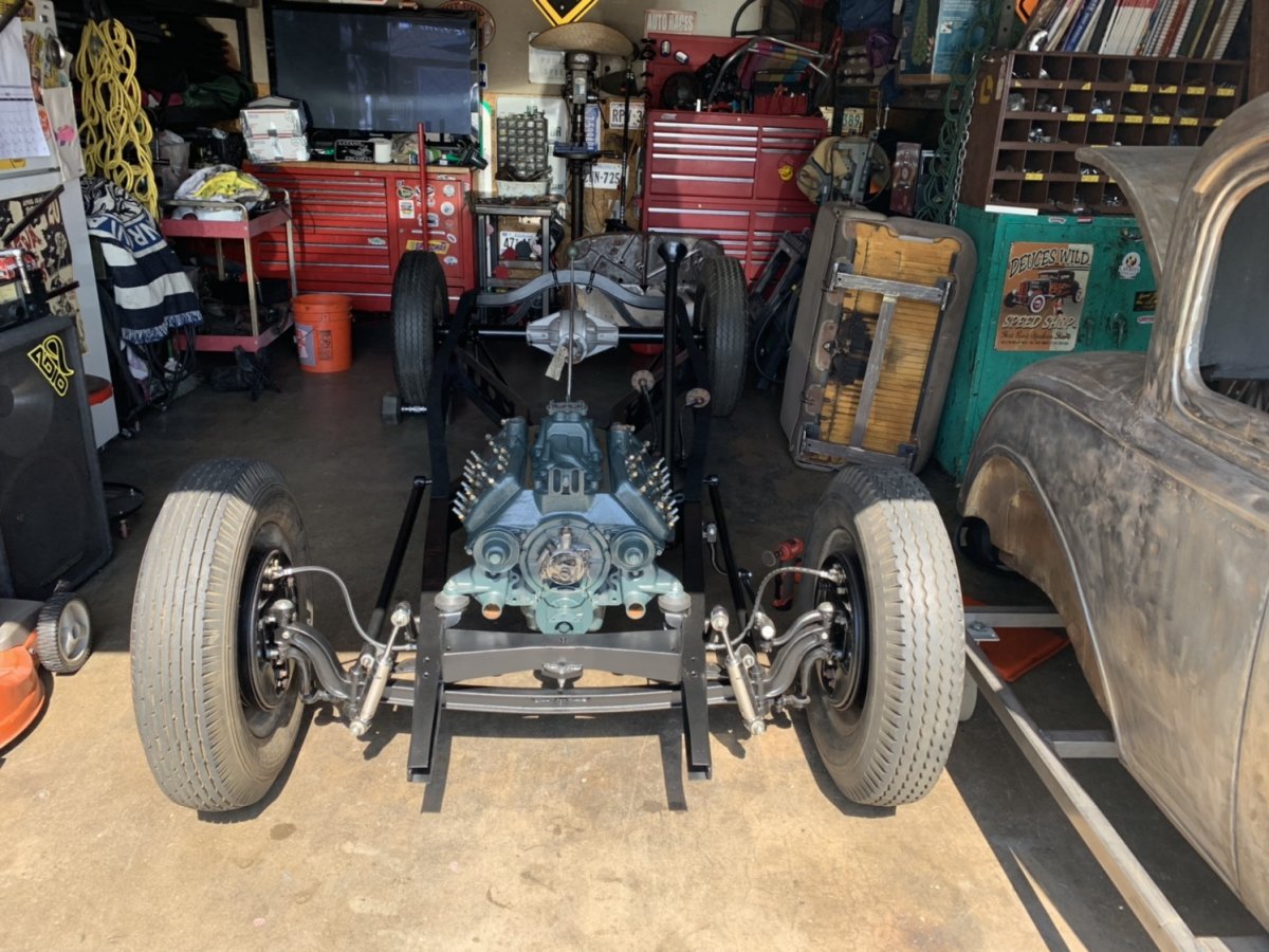

    Quick update, I was able to finish heating up my pitman arm,clutch and brake pedal ,spindles and shock mounts. Also worked on the steering column and got that right where I need it. I need to figure out what I can use as a column drop for the column also .Here’s some pictures guys. IMG_5653.JPG IMG_5652.JPG IMG_5647.JPG IMG_5646.JPG IMG_5639.JPG

    Wow, that pitman arm sure is wacky. Doesn't the pitman arm on those boxes fit on backwards also? If so, you could use an unbent one and have the drag link inside the wishbone. Should give you more clearance around your tire during full left turn too.

    The pit man arm was just bent forward a bit and the ball joint down for the clearance. No problem with clearance now the arm swings full both ways. The pitman arm is inside the wishbone , there’s a half inch gat between the two or it would rub.

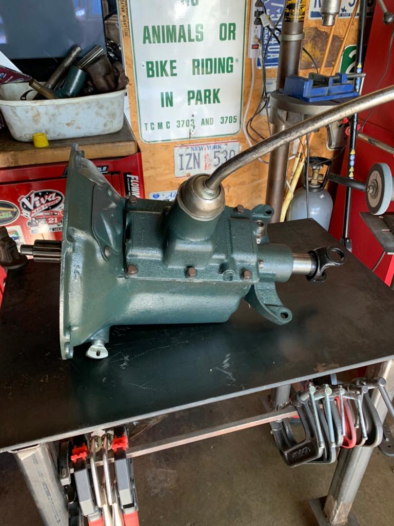

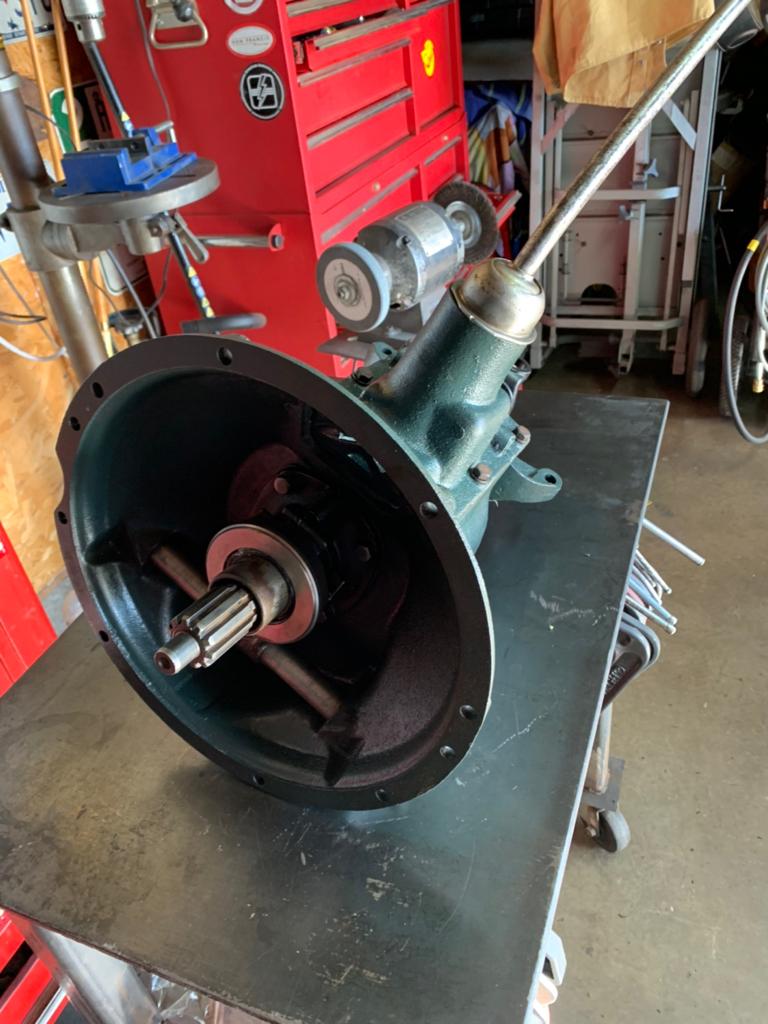

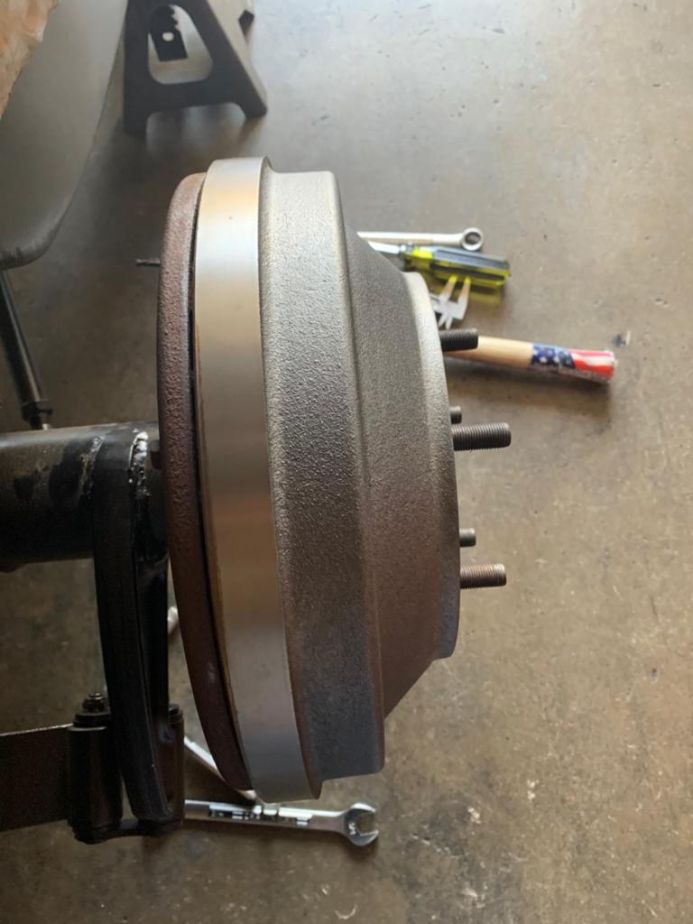

    Been busy lately but was able to rebuild my transmission today. Got all the goodies from early ford store in San Dimas California. I didn’t take any pictures of the progress but how it turned out. Next is to try and fire up the motor.[​IMG][​IMG][​IMG]

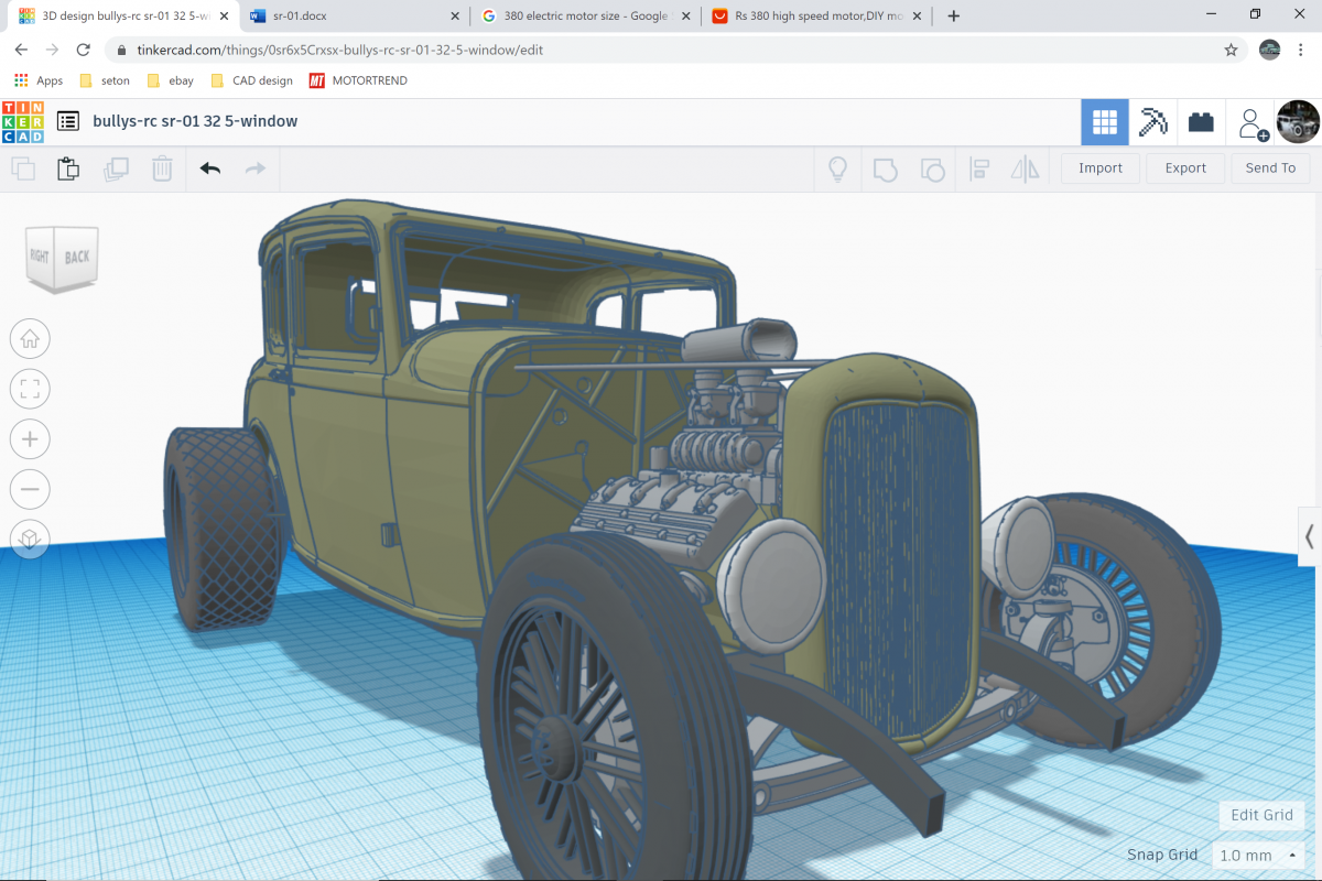

    Nice build, I've started a 1/10th scale 32 5 window project modelled on Tinkercad, should be 3D printing it soon Screenshot (120).png Screenshot (116).png Screenshot (122).png

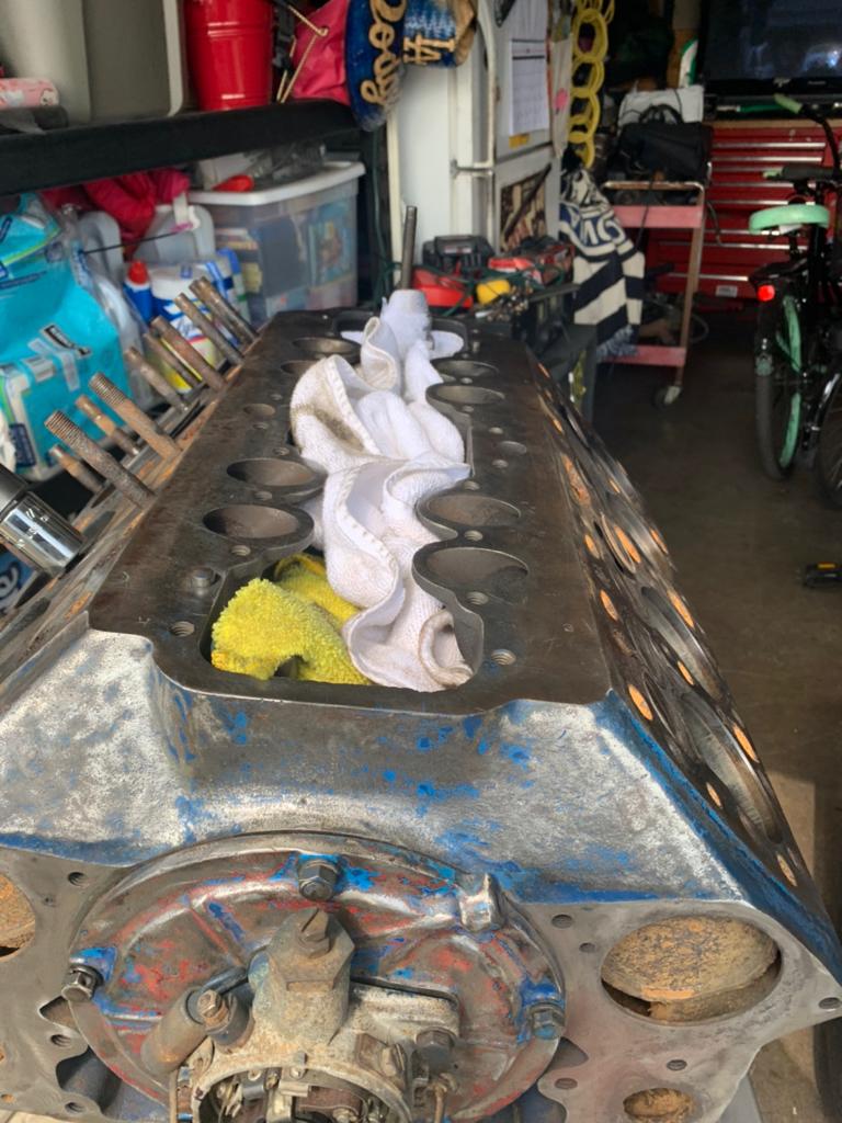

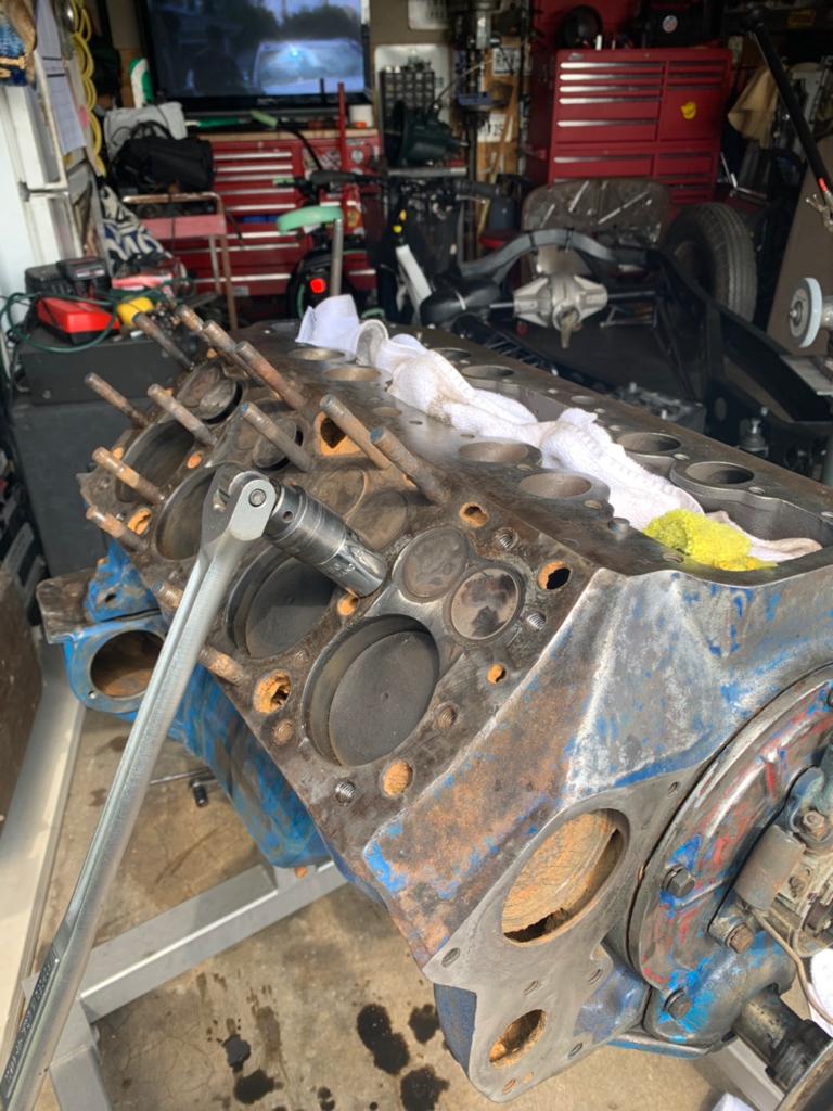

    [​IMG][​IMG][​IMG][​IMG] quick update on the coupe, I’ve been taking the studs of the block due to some being stripped. Unfortunately one broke off and I had to drill it out and recoil it. Looking at the rest of the holes I found six more that need to be recoiled because the threads look awful. Once I do that I will paint the motor to match my transmission. I have new set of gaskets and studs on the way by speedway. Also have my clutch , pressure plate and flywheel being rebuilt at the moment.

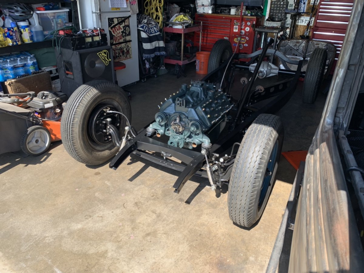

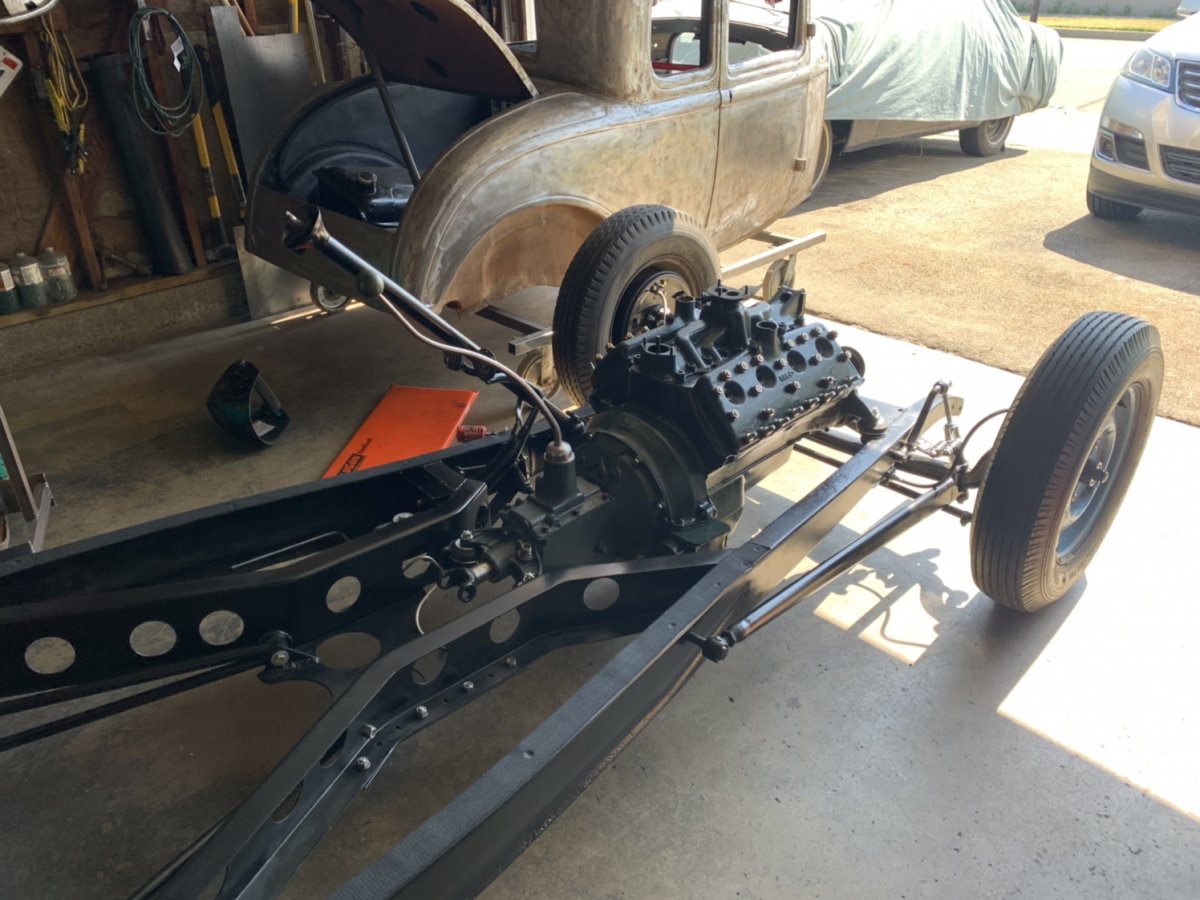

    Painted the motor and installed it this weekend. Waiting on my generator so I can paint that as well . Had that converted to twelve volt. IMG_5812.JPG IMG_5807.JPG IMG_5811.JPG

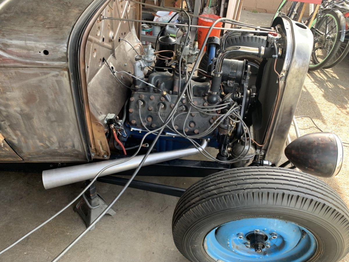

    Been busy working on the coupe these last couple of weeks forgot to post some progress. Still have lots to do. I added a Carburetor,new fuel lines, spark plugs, wires, oil pressure gauge, radiator, coolant over flow can. All these things are so small but take lots of time for me at least lol.

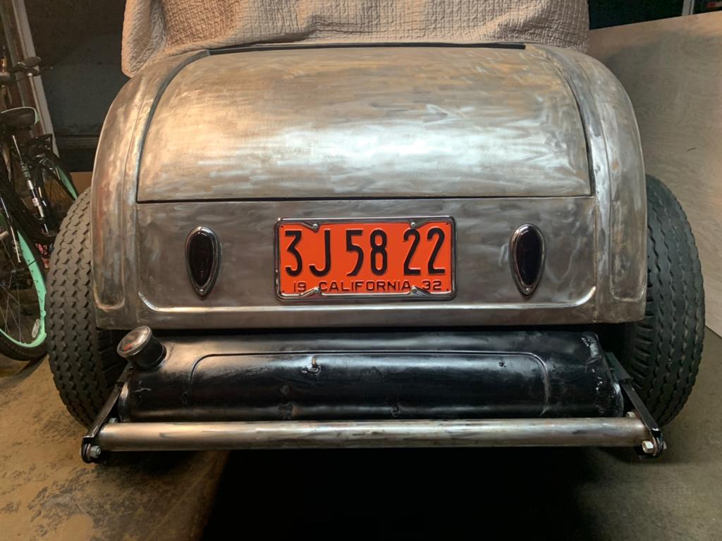

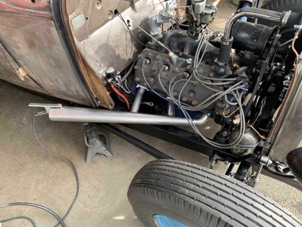

    Quick update on the coupe, got my tail lights in and license plate on as well. Wired up my headlights and tail lights. Also picked up my brake parts to get those mounted up this week!![​IMG][​IMG]

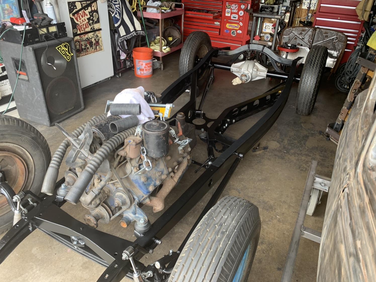

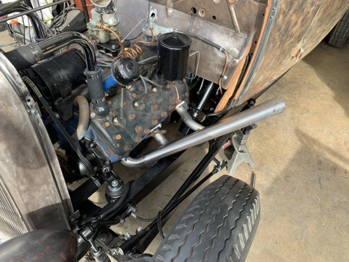

    Hey fellas been off this project for a couple of weeks. Been busy with life and work. Had the flathead break on me with some cracks on the block. That definitely slowed me down trying to figure out what to do motor wise. I decided to take my Merc flathead out and use it on the coupe. Haven’t painted it yet just putting it in as it sits till I get this car going then tear it down . Also decided to go with lake style headers for the build. Been working on that over the weekend. Just need to tig up the headers to finish them off. Here are some pictures guys. IMG_6540.JPG IMG_6580.JPG IMG_6598.JPG IMG_6599.JPG 63512245673__CA788C61-0B7C-4F46-B4E9-9CB78C1D0039.JPG 63512246601__985542E8-E18E-48AF-849C-8DA72101F82B.JPG

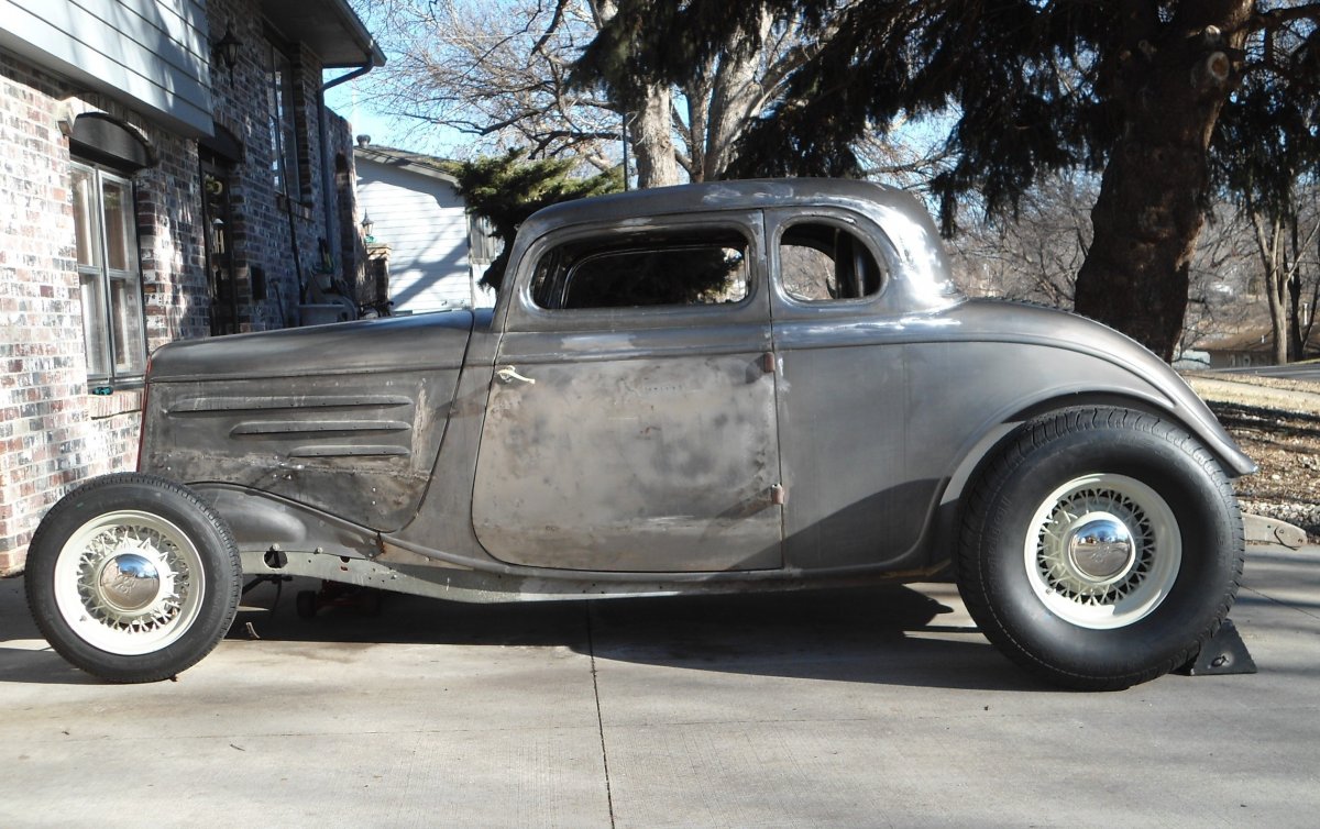

    It's coming along. Lookin' good. My wishbones [33-34] also ended up in the center of my rails. I used F-1 pedals and mounted the pedal mount like you did from the X-member to the frame rail...works well. I was able to find a new bushing for my pedals but I don't remember where I bought it. Haven't installed the new bushing yet. I was able to use the F1 pedals without any heating and bending but I have the luxury of using a 33-34 frame. I did move the engine over to the right and inch and a half to gain some much needed room. Pontiac engines have the starter on the driver's side.
    The Gibbs oil kept my 34 rust free for the years we worked on the car in the body shop. I wiped it down with lacquer thinner before I laid on the Urethane primer. No problems with primer lifting. 34side1_15-0.jpg
