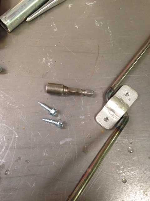

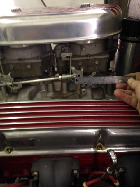

    After starting on the transmission tunnel I am re-thinking the shifter. My all-time favorite car to shift is my 64 GTO. That's because I put a brand new Hurst shifter in it back in 1977. I still love the way that car shifts. I have decided to put a Hurst shifter in the 32. So I ordered a Hurst installation kit and have begun the project to switch it out. The shifter handle will likely be custom made. The Hurst has those two bolts to attach the handle which will make it easier. I will probably make a shifter handle from round stock and not use the rectangular Hurst one. I don’t think they had rectangular handles with the word HURST on them back in the late fifties. This will require the body to be off the car so I will get to this later.
    So I moved unto the throttle linkage. I started tracing cardboard for the carb bracket.
    Then cut and drilled.
    Then I did the same for the throttle cable bracket.
    Some cutting, drilling, bending and grinding. Finally a carb and throttle bracket that work smoothly and fit with my new Lokar throttle linkage.
    Next I take it all apart and flatten it out on my Dake Press so I can trace and make a final sketch.
    Then some designing to make it look less industrial and more Hot Rodish. This mock up was only .06 thick so I could modify it easily. The real one will be .12 thick. My wife will draw it up in CAD and my son will cut out on the laser . If all works and looks good I will paint it silver to blend in.
    Anything you guys have learned from throttle cables and bracket?? I did find some info on the HAMB and internet and applied as much in the design as I could.
    Greg

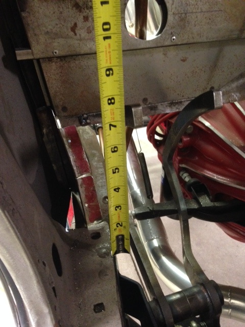

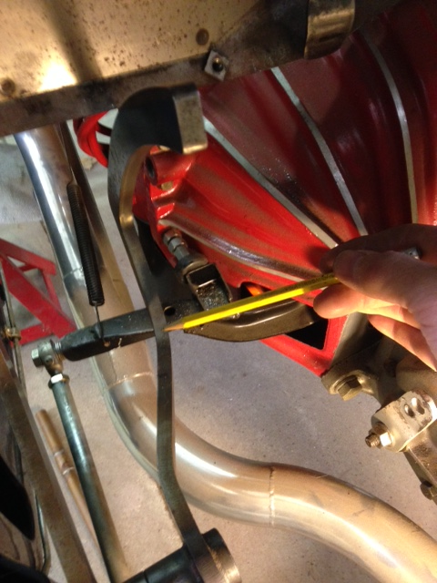

    The center of your brake and clutch should be about 7" off the floor. I built three Ford 3 windows all with 3 pedals. Two with under floor pedals and my current one one with hanging pedals. Your left side kick panel will have to be as tight to the left as possible, so you operate the clutch pedal.You wont have any trouble getting in and out of a 3 window with suicide doors. Make sure you remove the package tray, you can move the seat all the way back.

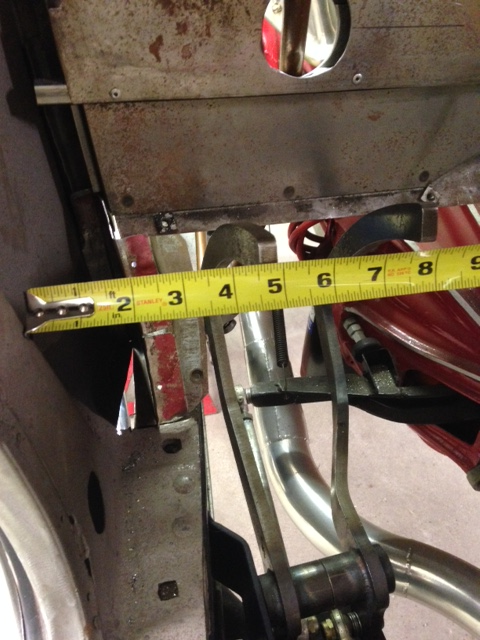

    The package tray is gone. I am waiting for a new seat frame from Glide before I finalize gas pedal, steering wheel, etc.
    Now I am unto the clutch and brake pedal. Great timing on comments above.
    Sorry for the close photos you have to look at them a minute to get your bearings.
    The pedals are 7 inches off the floor
    and about 6 1/2 from floor by firewall.
    Clutch pedal is about 4 1/2 from the side. So should be OK.

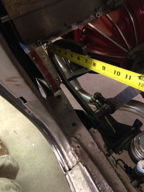

    I have an issue with my brake pedal that will need attention. It hits the clutch fork before it travels all the way to the floor.( see where pencil is pointing) Gotta fix that. I need to redo fork anyways, you can push clutch in with one finger. I think fork is too long.
    Greg

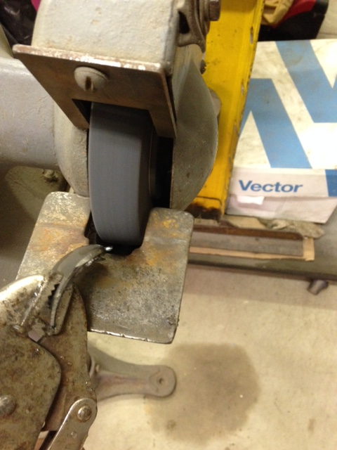

  7. verde742
    Joined: Aug 11, 2010
    Posts: 6,588
    verde742
    go to work with a belt sander on the anvil...;)
    people kill for those now days.....:rolleyes:
  8. Chief 64
    Joined: Dec 10, 2010
    Posts: 303
    Chief 64
    That anvil is beyond belt sanding, it needs to go on a blanchard grinder......for about an hour... lol

    You want about 6:1 pedal ratio for manual brakes. Your clutch fork looks a little long, are you sure you are getting disengagement ? My 1st was mechanical clutch linkage, then wet to hyd. on the next two. Mechanical is foolproof. You could move the cross shaft bel crank behind the pedal ***embley and tighten

    Make sure your brake M/C. bottoms out completely with out fluid, or your dual brake system won't work.
  12. Watch the pedal ratio on the gas pedal.
    It's real easy to get that ratio backwards.
    If you have 1-3/8 movement at carb from idle to wot make sure the s**** moves at least 2x that much. 4" works better.
    A Touchy gas pedal in a over powered and under weight car is not good, and to that cramped Foot room & you can get in trouble real quick

    32 Vicky with a Hemi - Thanks for info on gas pedal. That has been my concern, a touchy pedal. I will shoot for 4 inch travel.

    I agree with the comments about the clutch fork being too long. In case you have not tried this?:
    -push the clutch pedal down, then put trans in high gear, wheels off the ground, then put a bar through the front u-joint to see if it disengages, and "where" it does that.
    if the driveshaft barely starts to move when pedal is all the way down solid, it would get somewhat better when the disc wears, but still not the right/ideal setup IMO
    seat looks nice the way it goes back under the window...for long leg drivers.
    -- If you can keep the lower steering column exit point as it is, that's awesome. I could not do that with my big Olds engine, and sometimes I "feel" the column if I need to hit the brake "quickly" for whatever reason. I don't have enough drive time yet, to get the feel of things yet.

    Mine is "ok", but the first time I had to scramble to hit the brake, I felt the side of my work shoe hit the column first...kind of a spooky feel that caught me off guard.

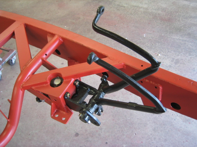

  17. The actual problem here is the pedal design. Although simple, Your current clutch pedal is what's used for a hydraulic clutch.
    A set up like this one below incorporates the bell crank right into the pedals, drives the clutch fork from the inside of the ***embly. Vs trying to cross the brake pedal arm's path-The brake pedal's axle is the clutch bell crank so the paths do cross but within the rotation about the axle. Now in and of itself, this pedal set up is more complicated than your current one but it makes 100 other things quite simple and more importantly correct.

    31 Vicky has the correct approach. To get these cars to drive well you have to modify things. Three pedal cars take more effort, that is why so many automatics, (sissy sticks). If you have to change things, do it now in the construction phase. I prefer the clutch slave outside the bell housing. If you have a problem you don't have to pull the transmission. I modified a GM bellhousing, putting the clutch fork on the p***enger side with outside slave. Freed up room for the brake pedal.

  25. Chief - regarding moving the clutch fork to the other side...Cut out the hole exact so that a factory arm boot fits, fabricate slave cylinder bracket to bolt to the block. There is another pivot ball blank spot under the trans on the p***. side. You need to drill and tap it like the driver's side. I don't recall the tap size but it should be available thru MSC or Grainger or ? I did 3 or 4 of them over the years, last in a '40 coupe a few years ago.
    The fork you have is just plain too long and the clutch lever would better serve a small clutch master. Speedway has Chevy forks in a few styles.

    +1 on moving the clutch fork to the other side. Also a shorter throw clutch fork. Slave cal. have limited travel.

    On your bellhousing, seems you might be able to do right side clutch fork. Chevy did have factory one that is right side and hydraulic: the 61-63 trucks with V8 had this. Getting hard to find, and sorry I don't have a picture handy. But its a cast iron bellhousing with a external hydraulic slave cyl. You know those square firewall mounted master cyls you see used a lot? Those are what goes with the same trucks, and have two outlets - 1 for brakes and 1 for clutch. You would not be using that, but the external slave cyl and bellhousing is a potential use for you.
