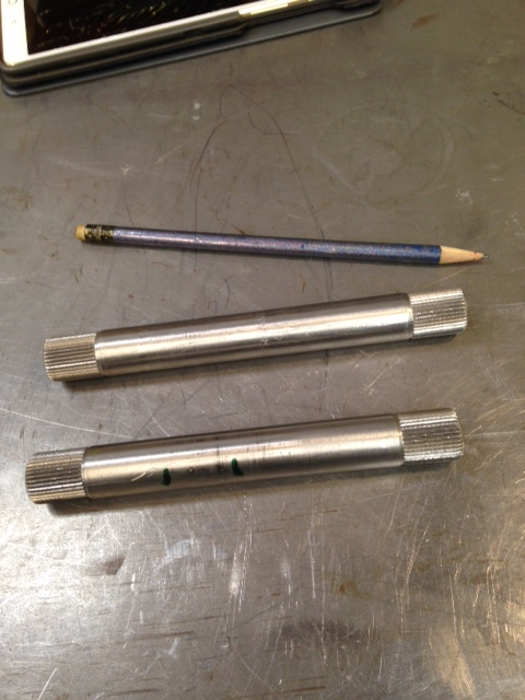

    Hi Guys,
    I am back on the 32. I haven’t posted in a while because my wife had final exams late November early December so computer was tied up. Then after she finished finals, the computer died so it had to go into the computer shop. But now it is fixed and I can post some progress. Not too much progress due to Holidays but some to show.
    I am just finishing up the steering supports.
    I got the final made to size steering shafts from Borgeson. But they didn’t fit the steering support.
    They are about .001inch to big. So I chucked them in a lathe and polished them down a bit.
    I filed hard , then sanded and finally touched up with scotch bright. Now all is good. I may buff later at final ***embly.
    Then unto the steering support brackets. Here is the design progression for the lower steering support. Prototype #1 was made from a thin sheet of aluminum. The thin aluminum is easy to cut and form and try out. From Prototype #1 my wife draws it up in CAD then off to the laser. For Prototype #2 I used a slot for the steering support so I could better fine tune the perfect in/out location. Prototype # 3 is the final design which has been optimized with a hole instead of the slot and made a little smaller. This will go in the car.
    Same process for the upper steering support.
    Then some C clamps to try it out and mark locations of brackets for welding to the frame later when the body is off and we can get a good weld angle for a nice weld. The steering works great and moves lock to lock nice and smooth and has reasonable clearance between exhaust manifolds & frame. This steering was a big task but I am happy with the results. Now on to the alternator brackets.
    Greg
