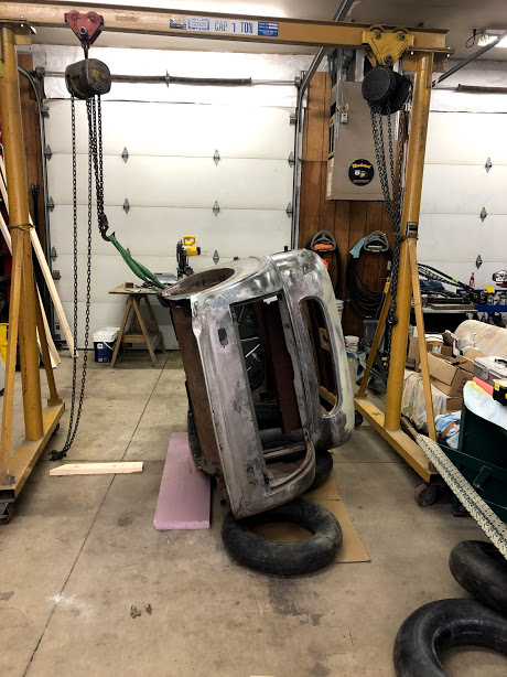

    I need a break from body work so I am going onto the bottom of the body for awhile. I made a 2 X 4 frame to lift the body off the frame. I didn't want to lift by the roof but that probably would be fine.
    Then a little work on the gantry crane.
    Had just enough height to get ch***is out.
    I have poor man's rotisserie.....1953 Pontiac inner tubes:rolleyes::rolleyes:
    up, up and over. Thank GOD for my strong sons!!
    Then unto a wooden frame with casters.

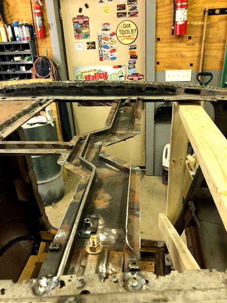

    The goal for the under body is to;
    attach nuts for seat
    attach nuts for seat belts
    attach cross channels to stiffen up trunk floor
    attach stiffener to cross channel where modification for Hurst shifter was made.
    weld up numerous random drilled hole from the last 88 years
    remove all rust and prep for primer

    I don't think I ever showed much detail on the cab floor yet. The cab floor was done a while ago. We went with a sheet metal floor. My son did the design, sheet metal & welding work. I made the “dimple die” so we could flush mount the fasteners. The goal for the floor was to be as water tight as possible, be removable and have the fasteners fit flush with the floor.
    The cab floor is 5 parts. Three large removable panels. Two are under the seat and one panel where your feet go. And two small access covers. One for the master cylinder and one for the shifter. The car had a floor when I got it, but I switched to a Hurst shifter which changed the floor a lot. Instead of modifying the other floor we decided to make a new one.
    Making the floor took lots of measurements and even some poster board cut outs to get the right shape and fit up. A lot of trial & error. In order to strengthen the floor, we put some stiffener channels underneath the floor. We originally did this thinking we could run the wires from the front of the car to the back in this channel but that just didn’t work. The 5 pieces weigh in at 24 lbs. Which is totally useless information but I thought some one may want to know.
    The channels tacked in place.
    more to come

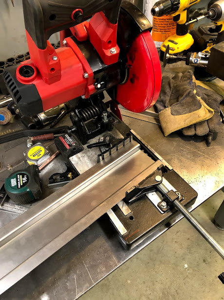

    Today I worked on stiffening the front body cross channel by adding a ¼” x ¾” stiffener. The cross channel was modified to fit a Hurst shifter which meant we had to put a big zig zag in it. We knew this would happen, but it really made the channel flimsy. Today I fixed that problem. First, I checked where the frame cross member was so I cleared it. Then I bent up a 1/8 rod for fitting & as a template.
    Using an 1/8” rod I bent up by hand for trial fitting, I bent the ¼” x ¾" bar stock on the press.
    It came out flat which was good. I didn’t have to fix it.
    I wanted it to span under the rocker panels, so I had to fit the ends by cutting them down a little.
    Finally, I got a good tight fit. ( this photo is bottom of body)... Sorry a little confusing photos
    I didn’t want too much of it unpainted & I couldn’t find my weld thru primer so I did it the old fashion way by taping off where I would weld and painting the rest .
    Final fit up with C-clamps and some primer.
    And a little weld.
    And its all stiff now.!! I can check this task off the list!! This is part of a build but not very exciting....I hope I didn't put anybody to sleep.:eek:

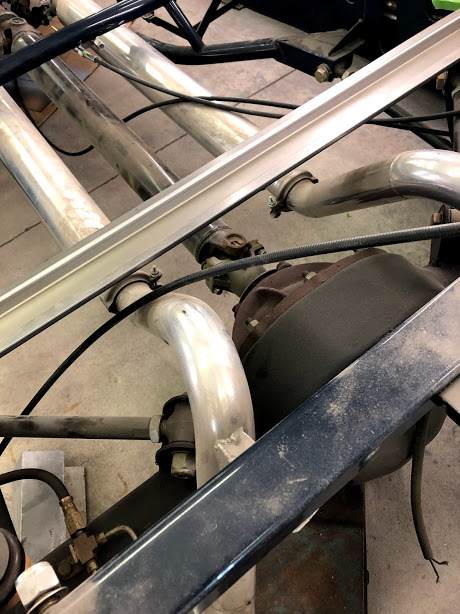

    If you have been following along since 2016 you might remember I bought this car from a friend who started the build, but then I bought it from him. My friend had put a late 50's Corvette shifter in it, but I am Hurst guy. Putting the Hurst in required several changes, one being the exhaust needed to be modified to make clearance for the shift linkage. Well, my son who is a much better welder than I am came over and we modified the exhaust.
    This picture shows the interference with the linkage and exhaust.
    I placed an order with Summit for some pipes.

    Back to the 32. Now that I can bolt the body down tight to the frame I went under it with a flash light and looked all along the frame rails to make sure I have a good fit and no gaps bigger than the felt that goes between the body & frame. All looks good! Then I started to think about any other detail I needed to finish on the underside of the body. The only thing I thought of was the e-brake cable brackets. So with the cables attached to the backing plate on one end and the other end at the bracket by the floor brake handle I laid out the cables. I sorta let the cables run where they wanted to without forcing them. They made a nice big arc. Then I marked a few spots for a bracket. I taped them in place and checked where the driveshaft and mufflers will be and made sure the bracket will keep the cables from drooping down.

    However, I will never be able to get to these bolts in from the top when the floor is in or from the bottom when the mufflers, floor & battery are in.
    So I decided to weld two tabs to the battery box and two mating tabs to the frame tubing. Then I will bolt them together. This will hold the battery box in place and allow me to unbolt it and let it swing down. Tabs held in with C clamps in this photo.

    This kind of work is fun. A little cutting on the shear.

    But first, before I went to the barn to work on the 32 I had to shovel. My grandson was driving his favorite car in the snow while I shoveled. Suddenly he says "Grandpa the car won't go!" I look and he is pedaling like crazy and the back wheel is spinning! MY GRANDSON DID HIS FIRST BURNOUT!! Okay maybe it was on snow but the fact is the back tire was spinning. I said you are doing a burn out! He looked at me real serious and said "No I am Not" So I had to explain the burn out thing to him. He seemed confused. Much talk on the HAMB about the future of our hobby but the hobby will be alive and well in my family. :D:D
    Ok I have stalled long enough.. I have to show my body work. With the car upside down I am working on the lower 2 feet of the car that is easy to work on with it upside down. If the regular filler will be more than .03 to 06 I use Tiger Hair. I only use Tiger Hair for .06 - .12 , deeper than that I add sheet metal if I cannot get to it from behind to beat it back into the correct shape. Here is an area I needed Tiger Hair.
