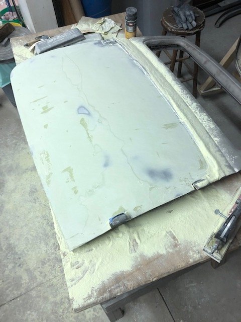

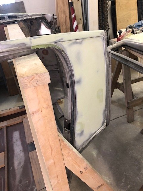

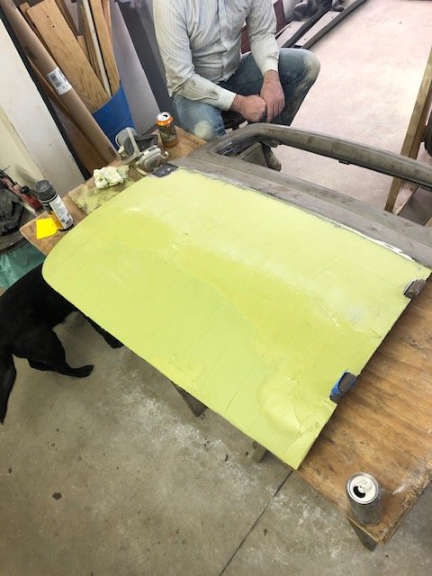

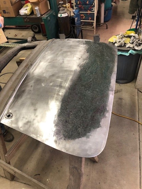

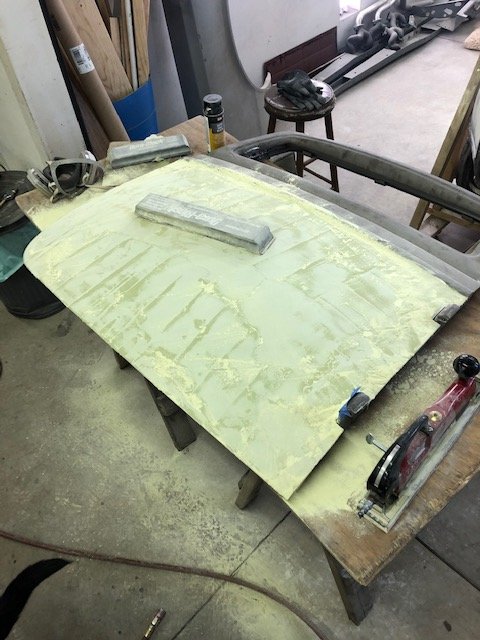

    My son is doing body work on the door. It has a patch panel at the bottom and since there is always a chance of a pin hole in the weld we put a layer of Tiger Hair on the seem to seal it really good so no water ever gets in from behind and causes problem later on
    After sanding the Tiger Hair, Rage filler was applied
    Then sanding and knocking down the high spots
    More sanding and knocking down the high spots in the steel.

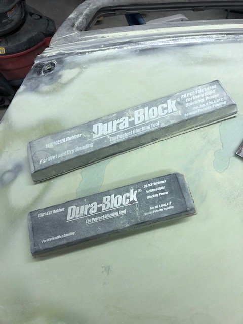

    We have been using a Dura Block.

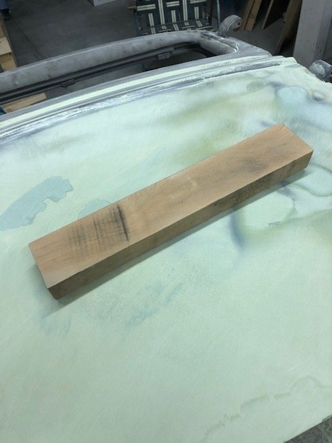

    The door has been a struggle. So a friend recommended a hard wood block for sanding thinking the Dura Block was too flexible and causing us undo problems. So I made a hard wood flat sanding block. We'll see how that goes.

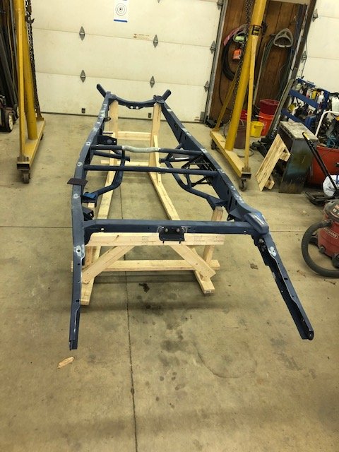

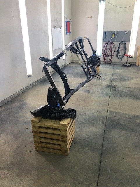

    The frame is totally prepped and ready for paint. I made a wooden cart to wheel it in and out of the paint booth and around the shop.

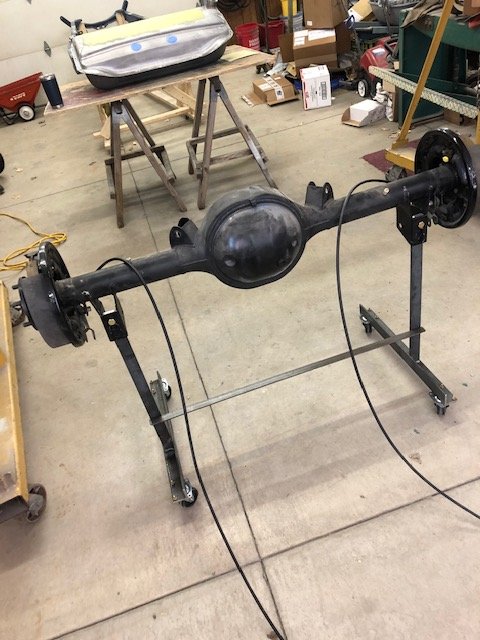

    I also made a cart to hold the rear end for painting and to wheel around the shop. In the background is the gas tank I am applying filler to smooth out the areas you will see when the tank is mounted on the car.

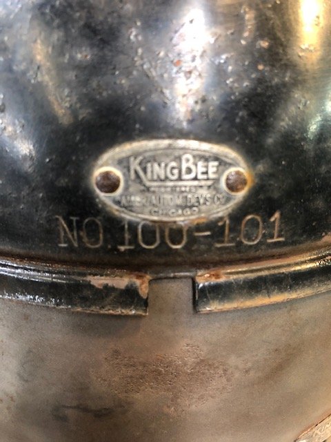

    I started working on the headlights. My sandblaster has not been working very good but I found out my compressor regulator went bad, so I replaced it and now my sandblaster works great!!! I am so happy I have been sandblasting everything in sight! I have these headlights for my car, so I sandblasted them.
    They are King Bee 100-101

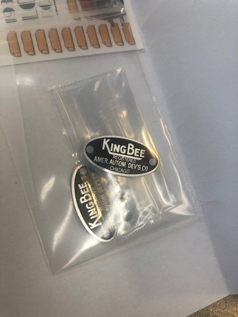

    I ordered some new tags for them from a HAMB member that makes them. Really nice tags.

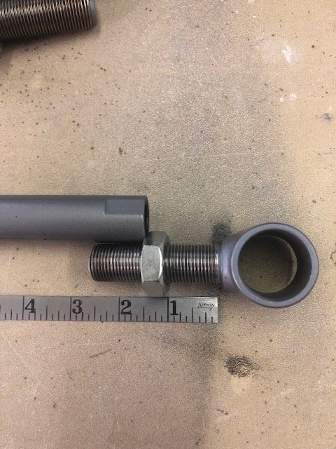

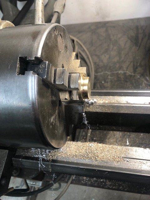

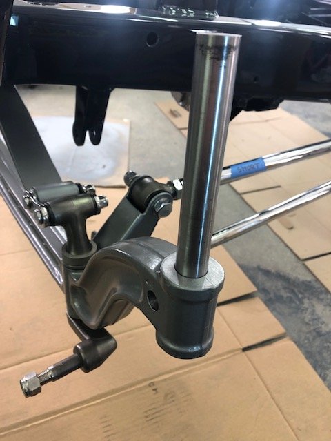

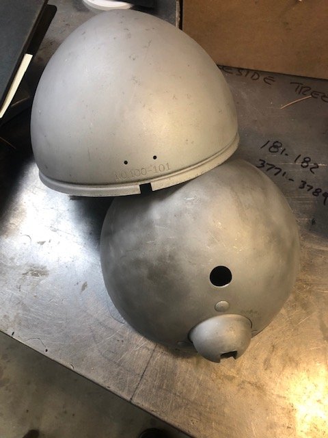

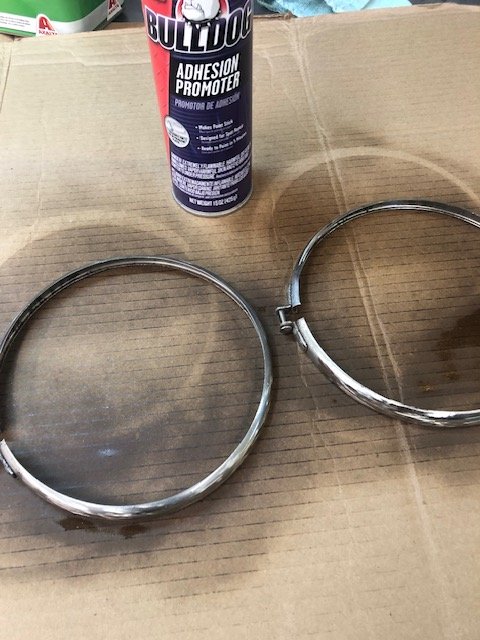

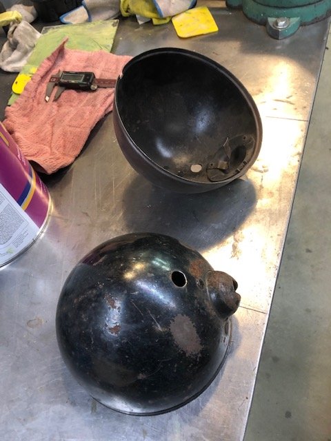

    Next was to finish the headlights. There was only some very small dents that I was able to fix without body filler. There was a little rust pitting I needed to skim with body filler.
    I had to slightly widen the slot to get a good fit up with the mounting bolts square shank.
    Then I shortened the mounting bolt and milled a flat on it so I can tighten the mounting nut tight without worrying about the headlight being deformed by the square shank on the bolt. I have a feeling these headlights need to be tighten fairly tight.
    That should work. I can put one wrench on the mounting bolt and another on the nut.
    Then a quick trip through the paint booth.
    And because I stink at painting and have to much orange peel, I had to wet sand and buff. In the end they turned out great. Later I will install the King Bee nametag and call it done.

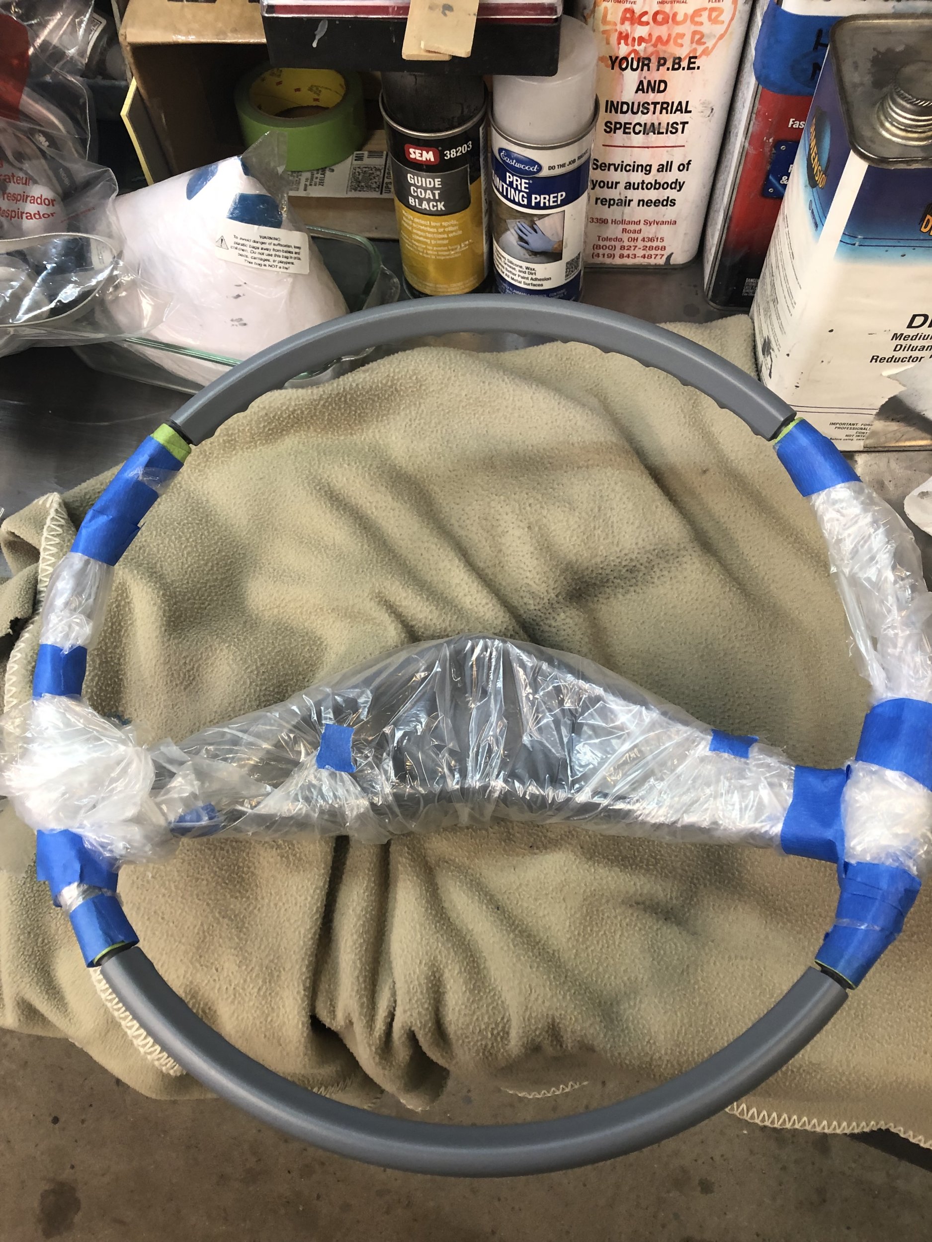

    I finally finished the steering wheel & steering column. The steering wheel is a 1958 Chevy steering wheel that came with the car. It started out maroon & cream.
    Under the maroon & cream it was orange & silver.
    It had some cracks in the plastic so I bought one of these kits to repair it myself.
    I think it went well, just like filler on a body part. I "vee'd" open the cracks and forced the epoxy into the crack.
    When it dries I started with a file and then sand paper to blend into surrounding surface.
    The light grey is where the crack is repaired with the epoxy. There were several cracks that needed epoxy.
    Next I painted it with auto body 2k epoxy primer.
    Then masked it and painted the top & bottom white.
    The masked the top & bottom and painted the middle blue to match the body color.
    I also painted the steering column blue.
    I was tickled pink with the out come.
    It looked great with new chrome separators where the color changes.
    It fit nicely on the column until I realized I needed to drill an extra hole in the steering wheel for the IDIDIT steering column cancel cam to function.
    So I had to drill a hole in the steering wheel on a finished painted wheel. :( I carefully marked the hole and had my wife hold the steering wheel with towels while I drilled it. I sharpened the drill by hand the best I know how so it would cut like ****er. We did it!!, We drilled the hole with:eek:out scratching the steering wheel. The turn signal cancel function works perfect now. ( the new hole is the one at the 10:30 location)
    I have read both good & bad about the epoxy PC-7 and both good & bad about using regular auto body paint for steering wheels. :rolleyes: Long term I will see how it holds up but doing it myself is keeping with my theme of a garage built Hot Rod.

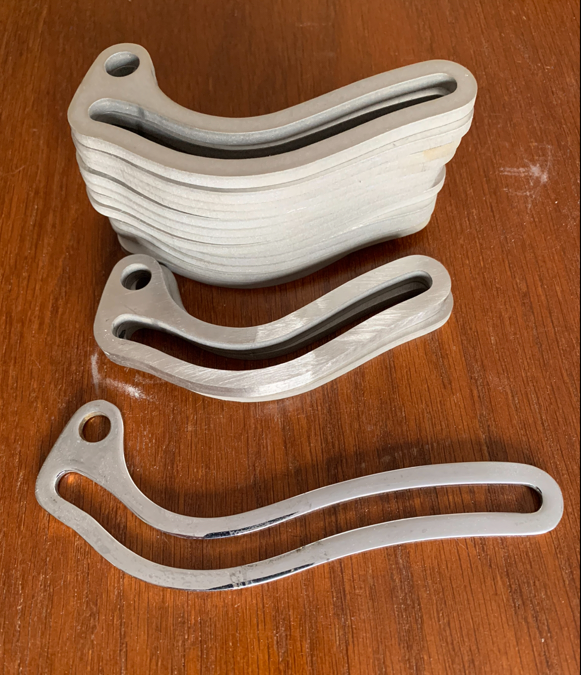

    Happy to see you back on your 3W project and don’t fret about your project timeline. I’ve seen a roadster project on here that’s been stalled (apparently) for ten years. Keep up the great work and I’m routin’ for ya.
    Those slide arms look pretty nice. I had a bunch of shorter slide arms cut from stainless steel (304 if I remember correctly) a few years back as I could never find a set when I needed them. Now that I see what folks are selling them for, I better find my stash and polish out a few more sets. :p

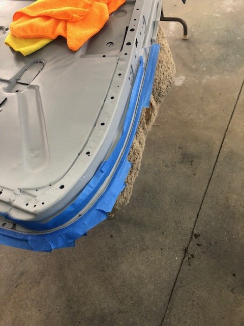

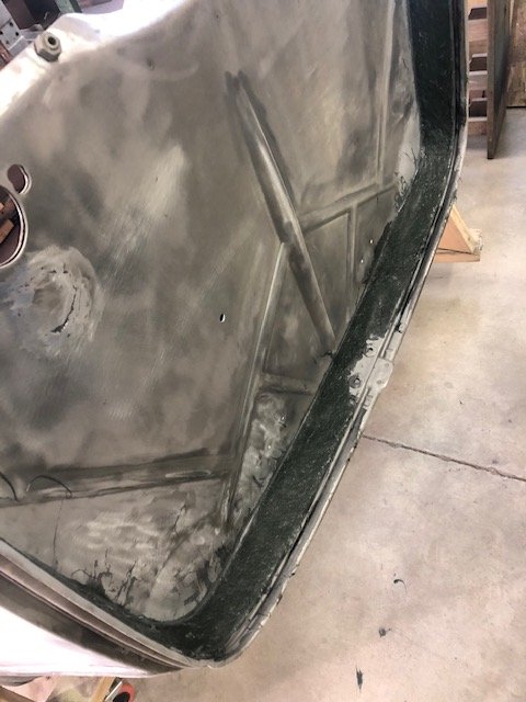

    I spent the day seam sealing the doors & trunk lid. I used the 3M 08367. That is nice sealer, spreads nice, comes out of tube easy and cleans up nice.
    I taped off where I needed sealing.
    Spread the sealer on, then dipped my finger in lacquer thinner and spread it out.
    Then peeled the tape off.
    I think I am ready to paint the doors & trunk lid now. Except I keep doing the "one last check" before paint....and then I see something, some little pin hole or a hair in the primer ( I have a barn cat to keep mice population down and a golden retriever so I have hair everywhere in my barn.) Then I try to fix it by sanding and/or sanding and re-priming a small area. This process is driving me crazy. I think it is time to paint!!

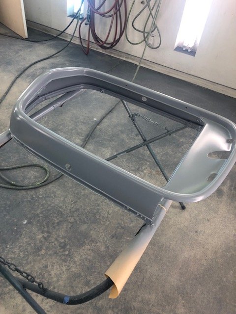

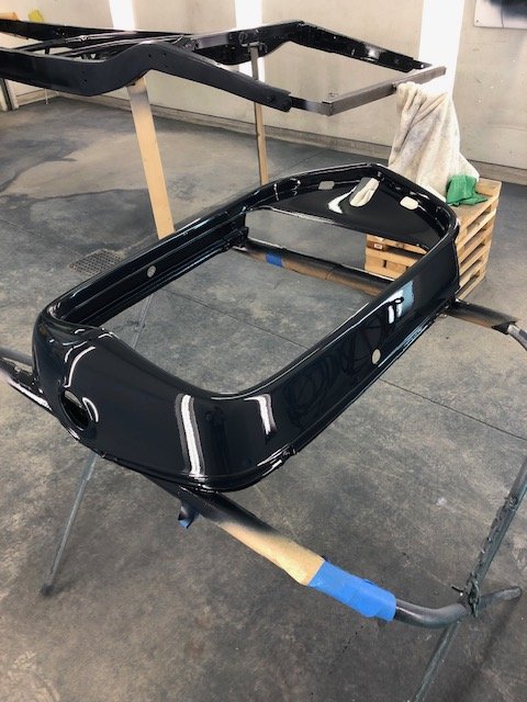

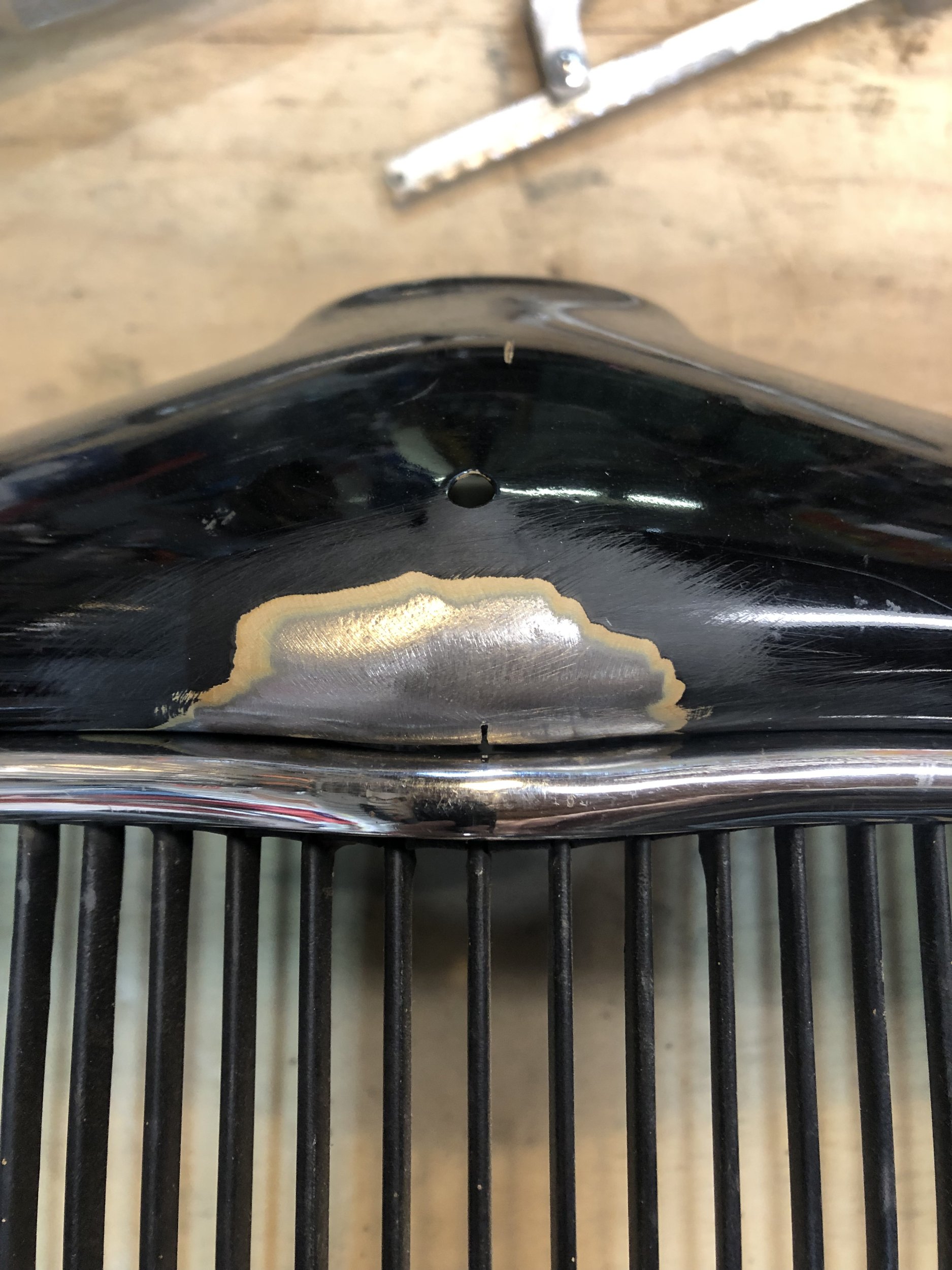

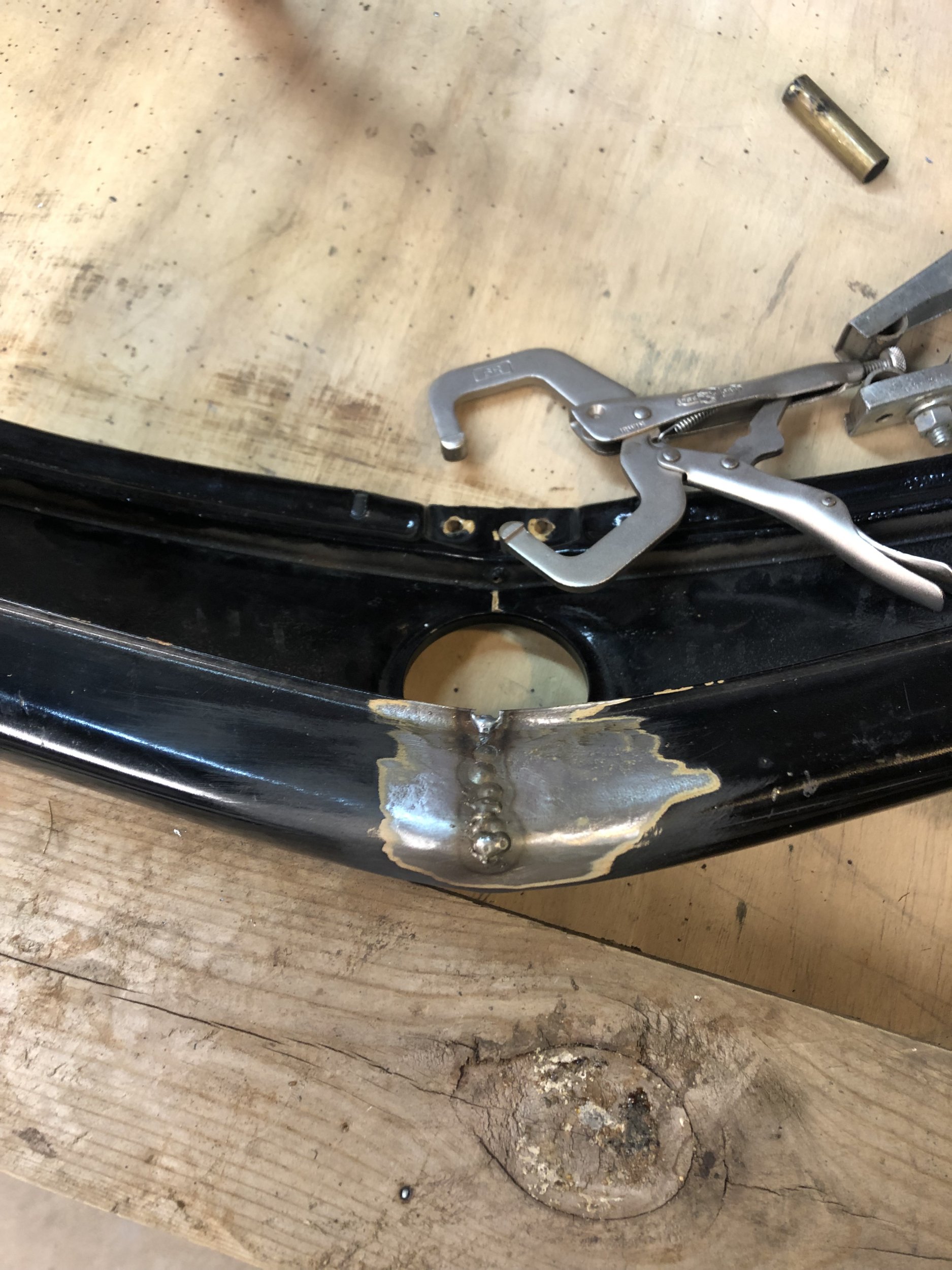

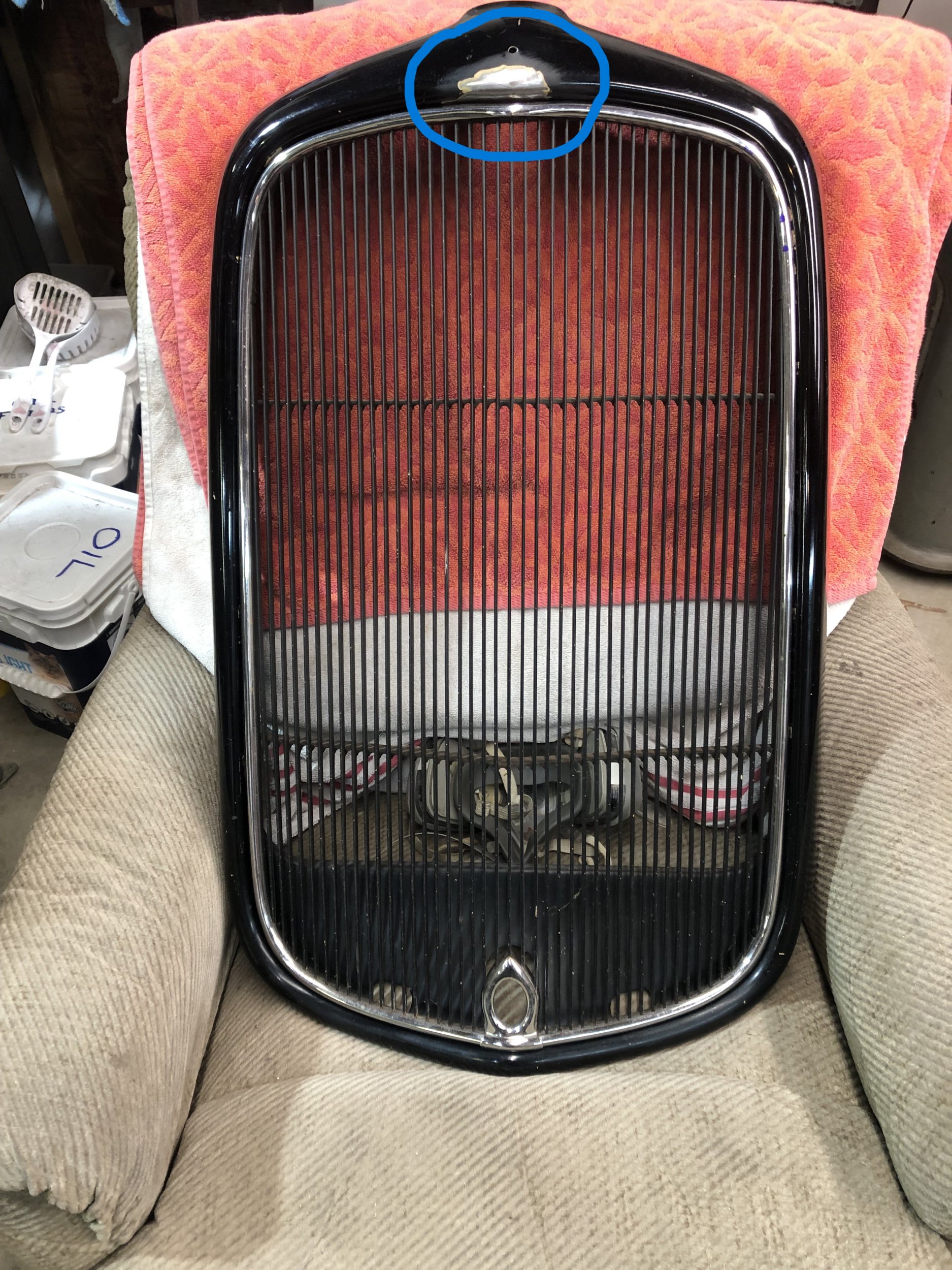

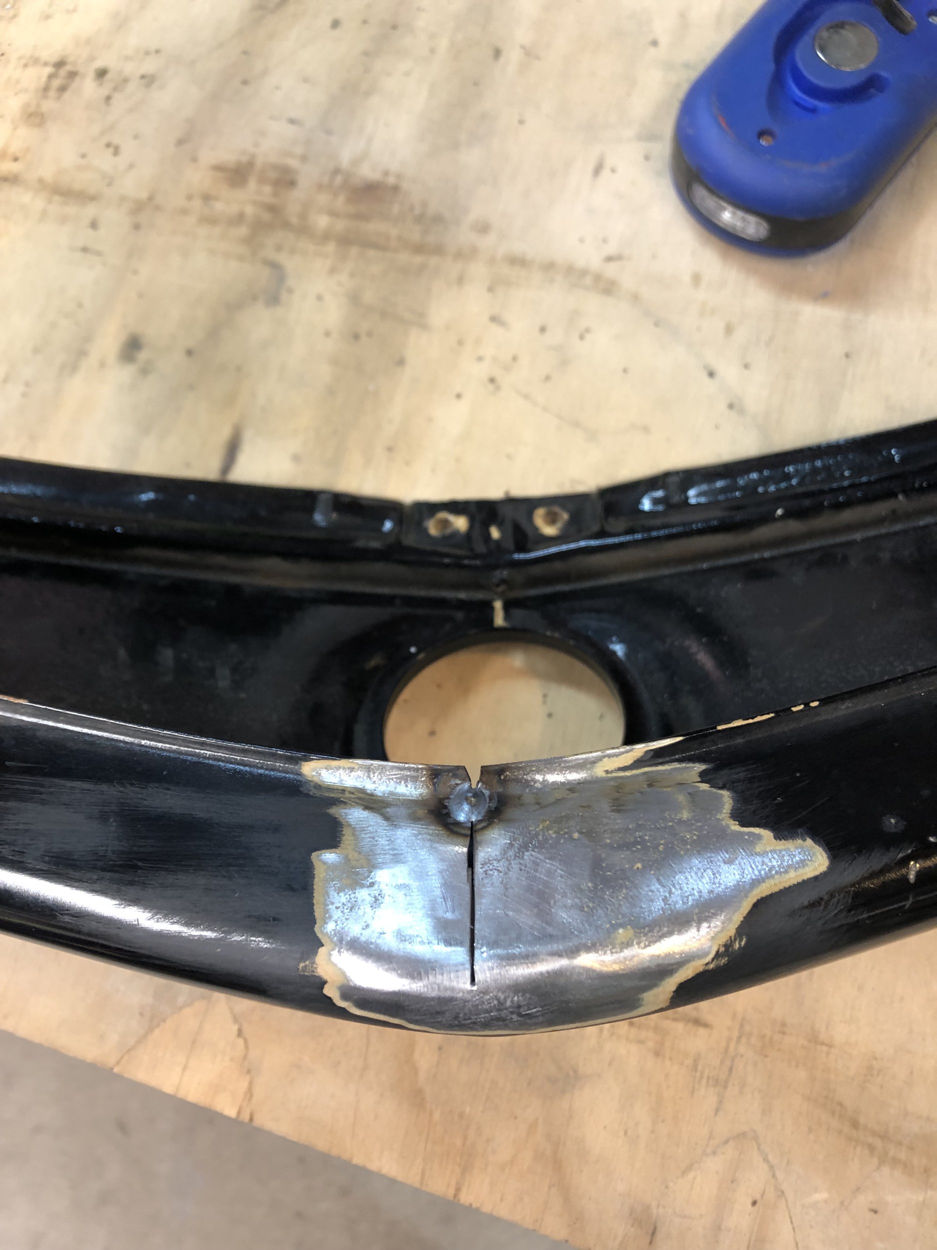

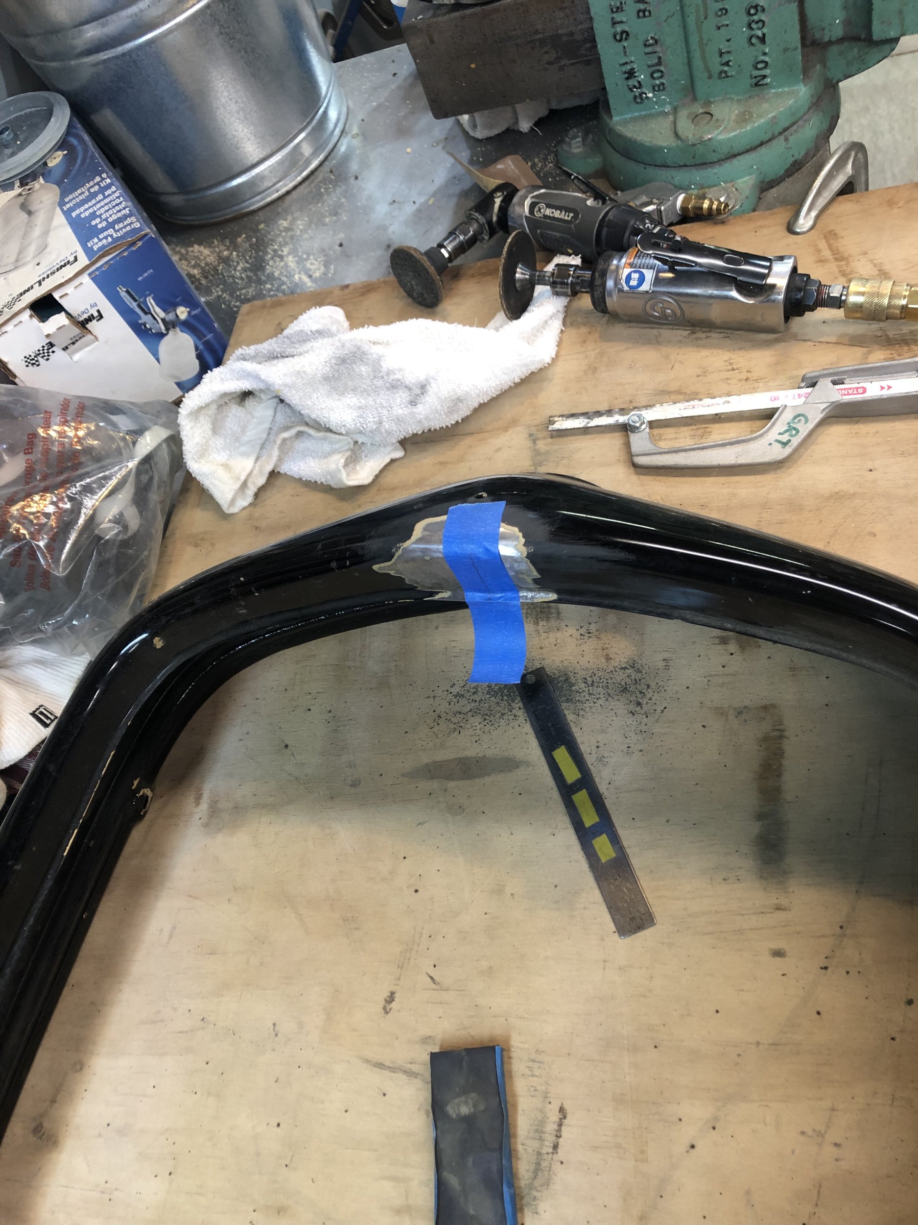

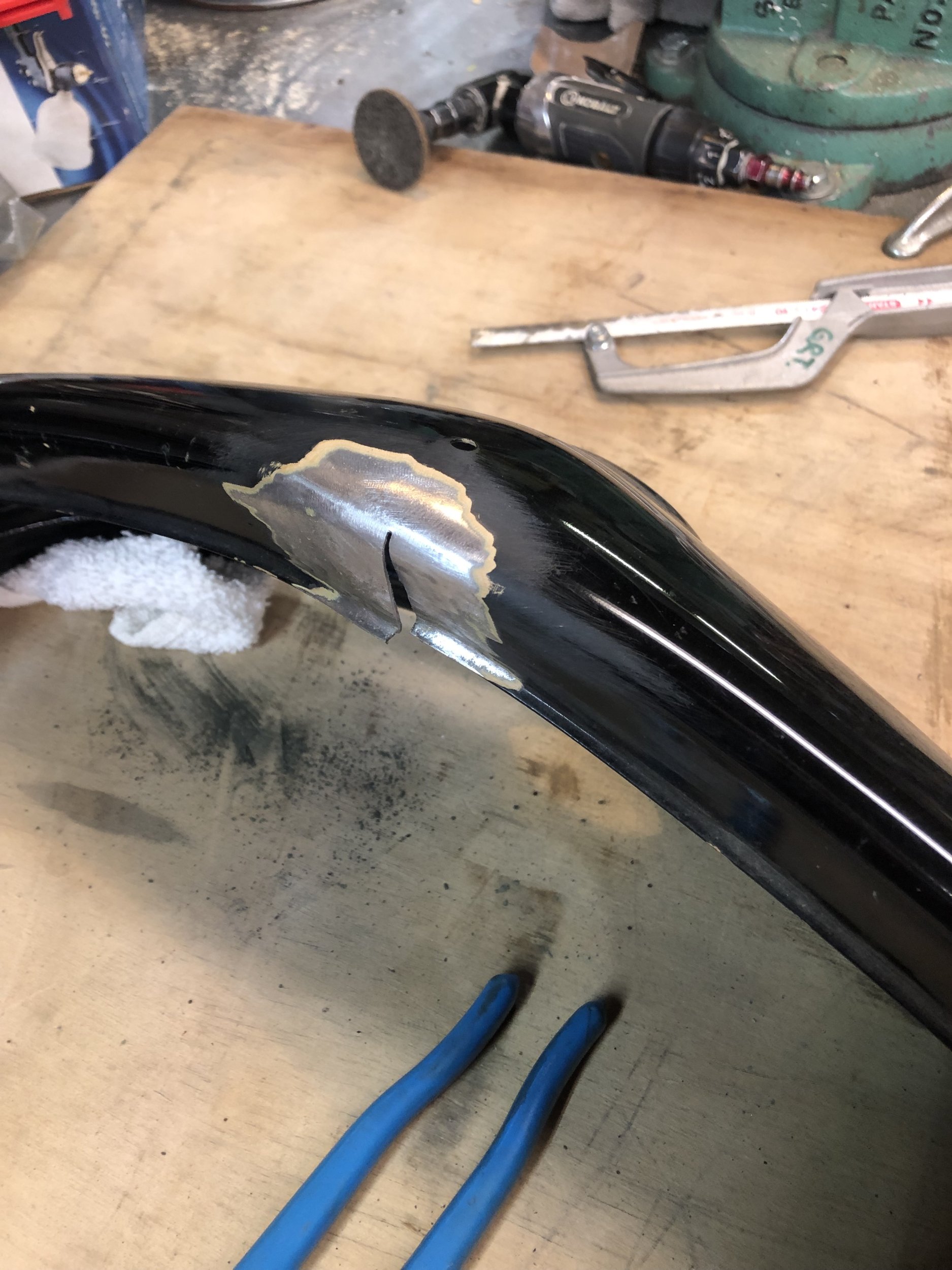

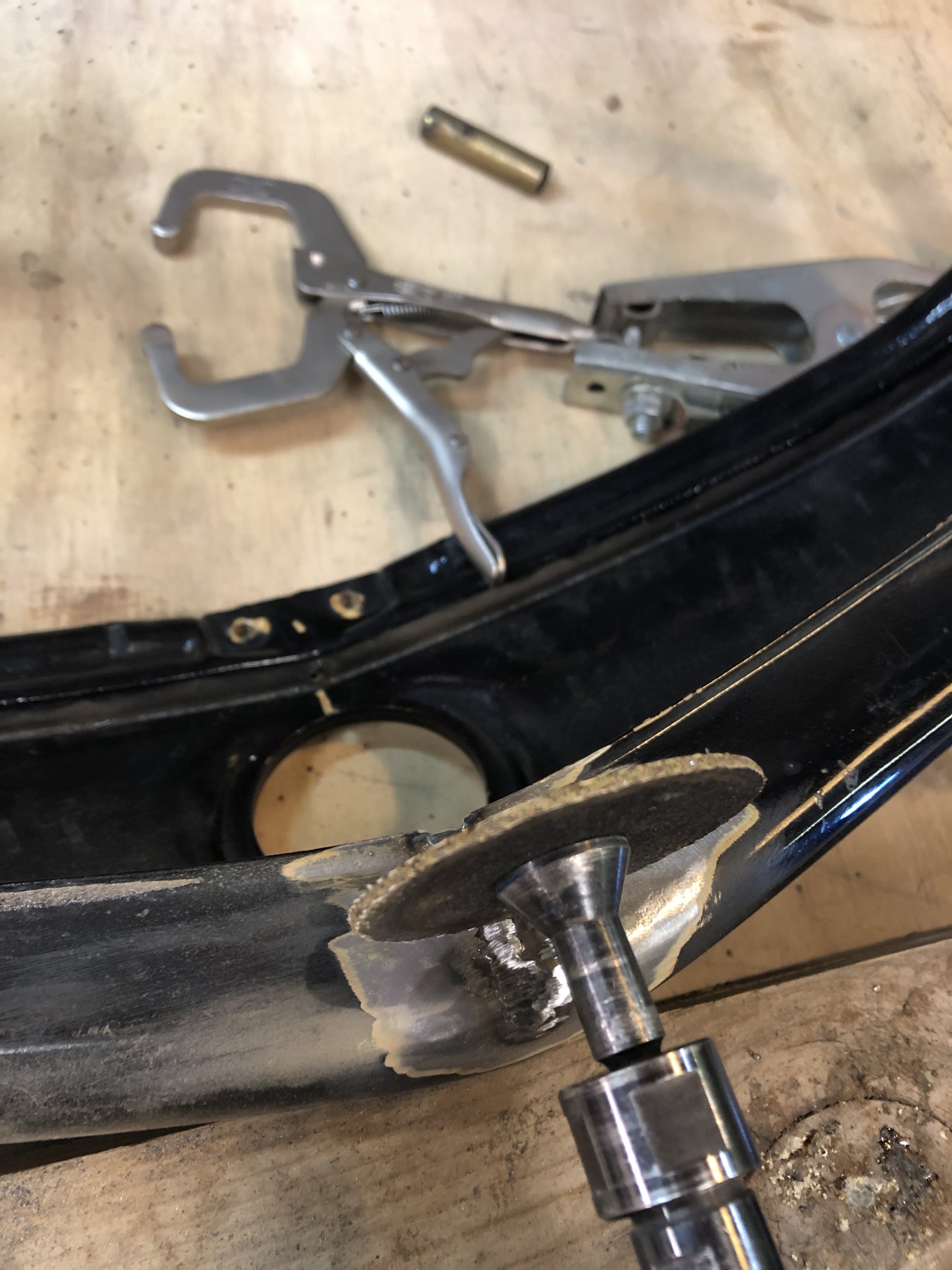

    I started to get the grille shell ready for painting. I decided to see if the grille fit nicely into the grille shell prior to painting since the paint will only make the grille fit tighter in the grille shell. Well, it was a very tight fit and it was difficult to get them apart. The grille is too tall at the area shown circled. The grille shell dips down in that area. So I decided to modify the grill shell.
    First I marked a cut line after I sanded off the paint.
    Then I cut it with a .023 wide saw blade and carefully folded it back to make room for the grille insert. (only one side done shown here)
    Then I tack welded it to hold it in place.
    Next I tried it for fit. Much better!
    Then I finished the **** weld.
    Then grinding the weld flush with the edge of a cut off wheel.
    Then a little sanding & filing, another test fit up which looked good and now it is ready for filler & paint prep.

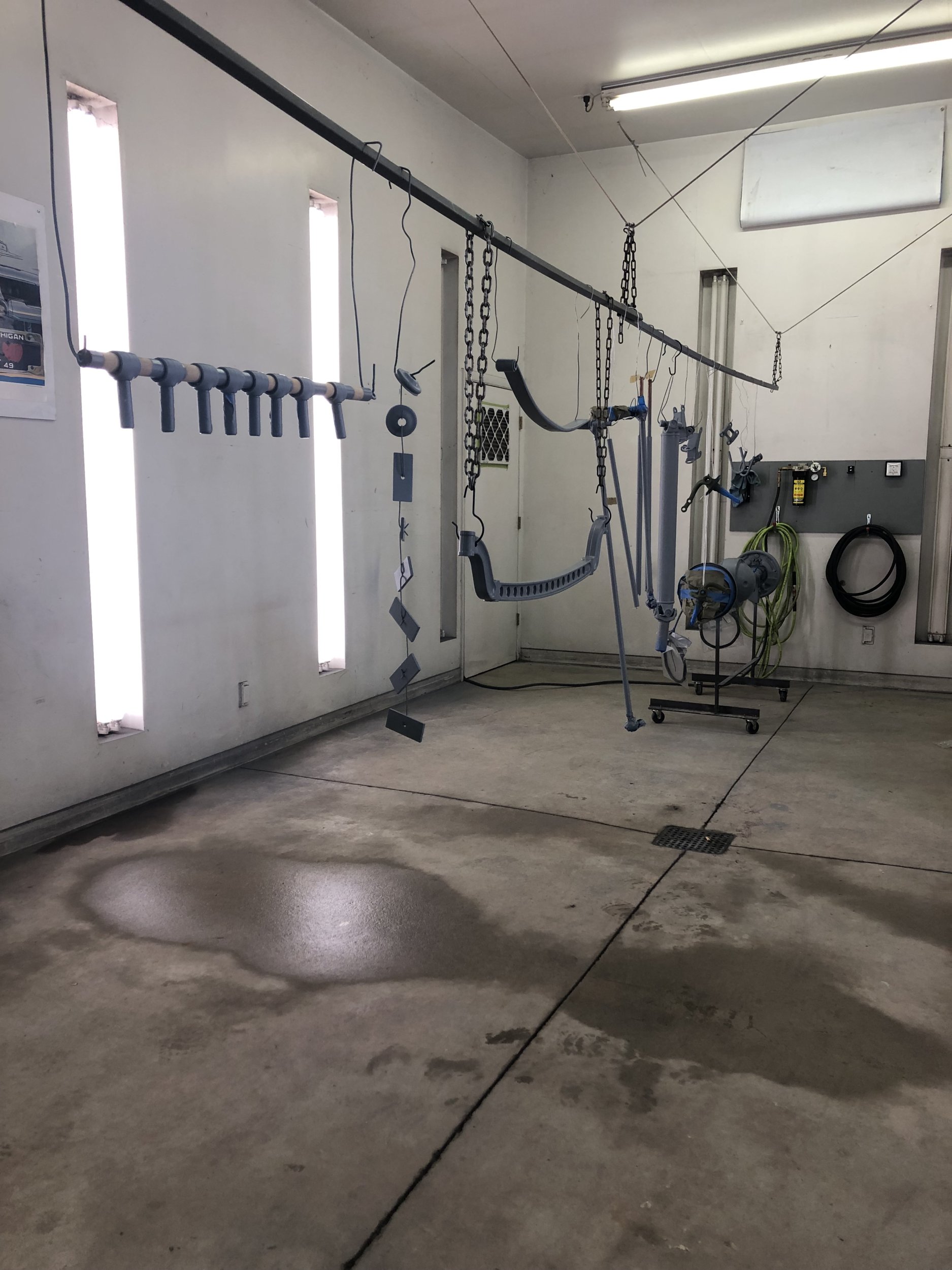

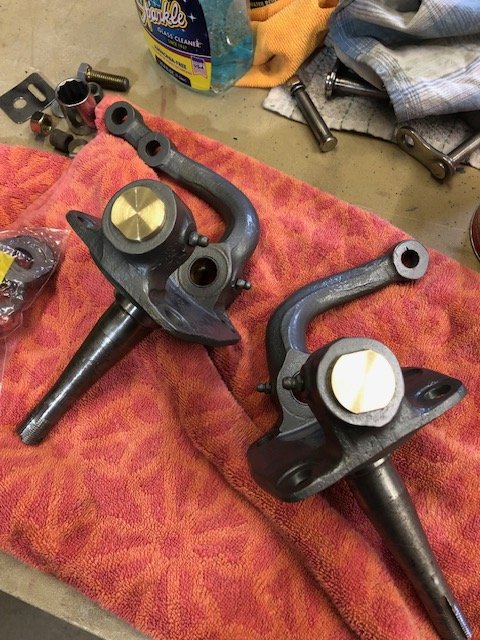

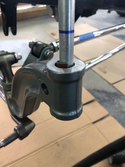

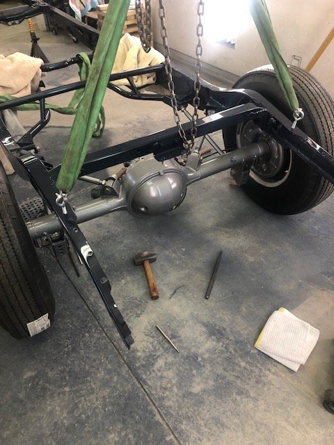

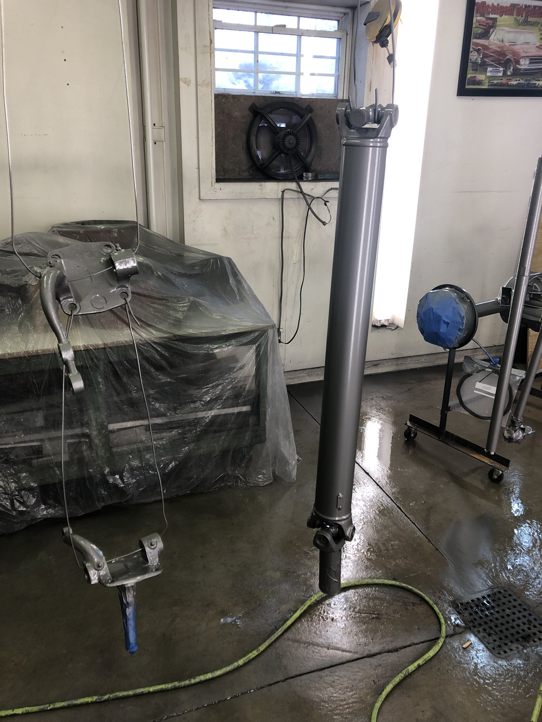

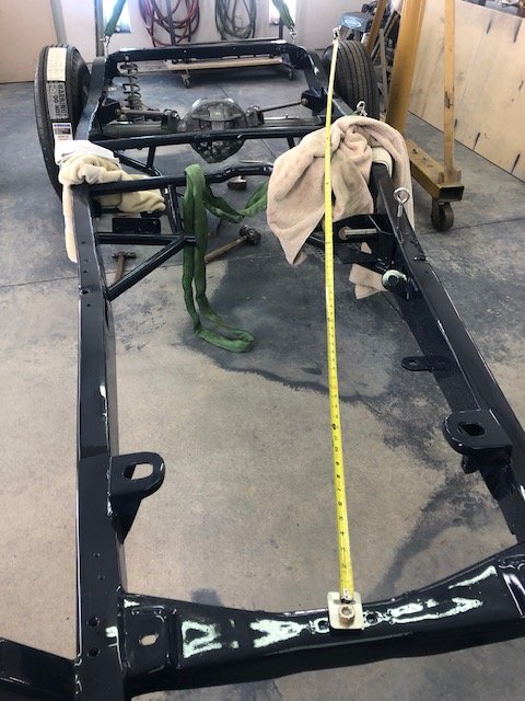

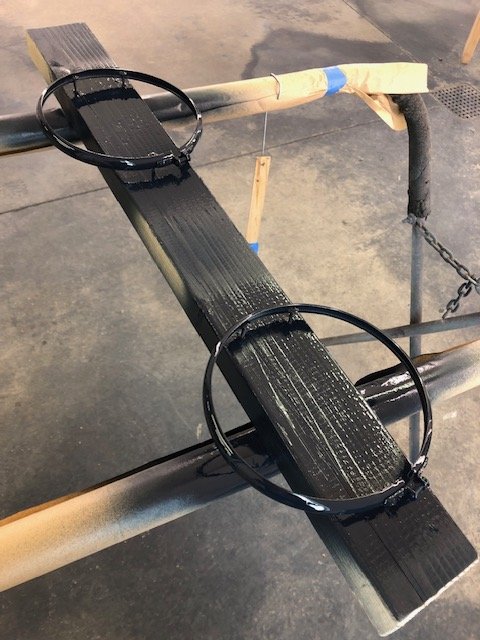

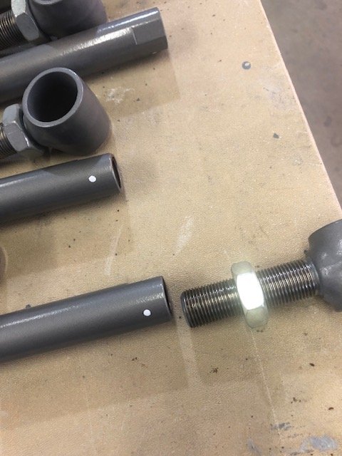

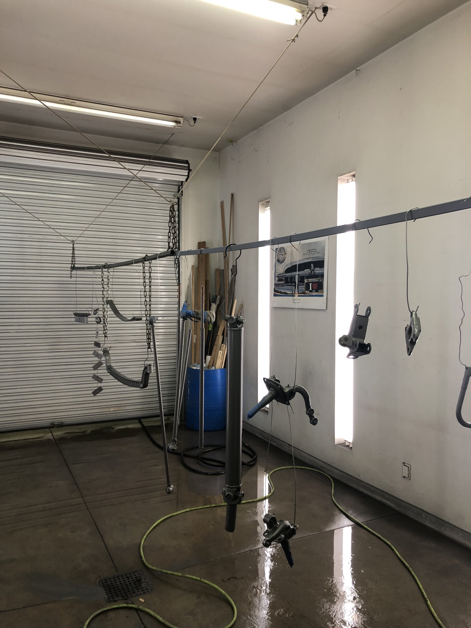

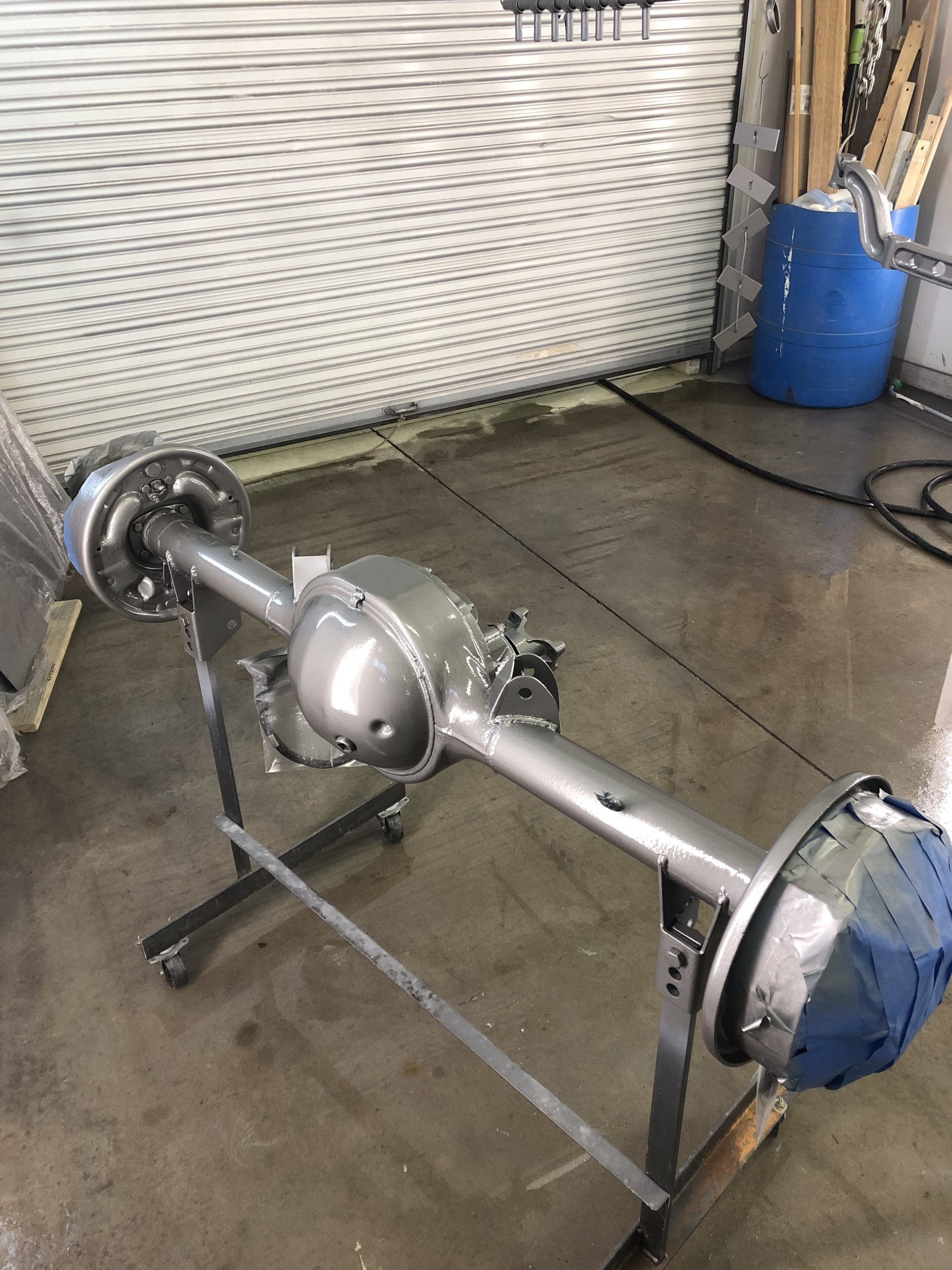

    In other news, I painted most of my suspension parts. I chose to go with cast iron gray. I am used to ch***is black from doing GM muscle cars and I wanted something a little different that would be a contrast with the very dark blue that I am painting the frame & body.
    All the parts were first coated in 2K Epoxy primer.
    Then the Cast Iron Gray.
    Some finished pictures.
    The rear end all ready to go.
    Next up is painting blue on several parts.

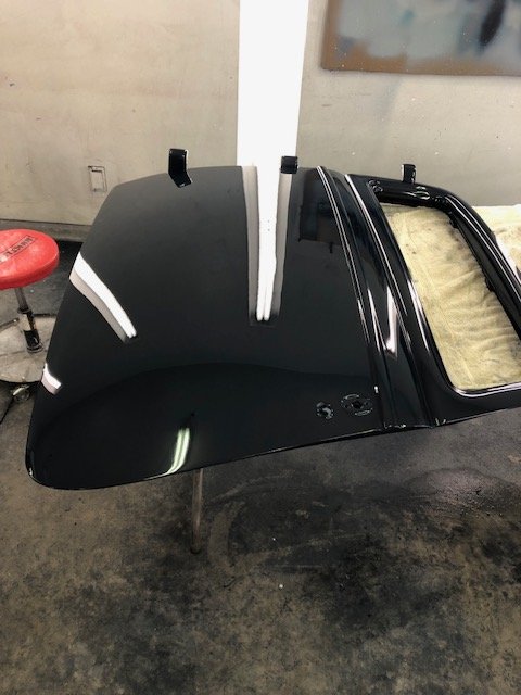

    I made a little progress on my 32 project. A friend came over and we sprayed 1/2 gallon of paint. Some parts for the first time and some re-do parts for past painting issues.
    The big parts were the doors & trunk lid.

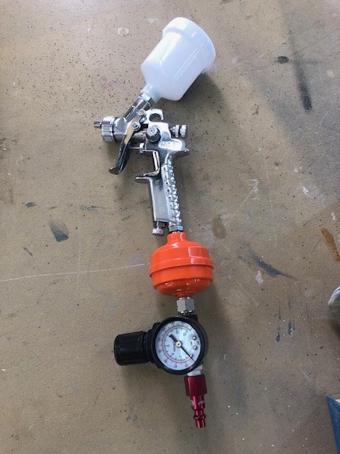

    We painted the bottoms of the hood. We wanted a little practice painting the louvers before we paint the top side.
    A few of the parts had a small crater in the paint. A perfectly round dimple like a BB had fallen on it when the paint was still soft. Its the dark circle below the tape. Ignore that squiggly piece of lint.
    So I bought a box of pipettes ( I call them eye droppers). I put 4 drops of paint, 1 drop of hardener and 2 drops of reducer in a small gl*** bowl and mixed it up.
    I took a fine paint brush and put a little into the crater.
    This paint takes two days to cure for sanding. I carefully sanded the dot of paint after two days. I have no idea if this will work long term, but after sanding you could not find the dot or crater.

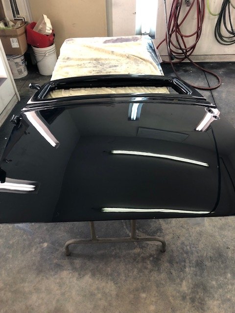

    After wet sanding it was time for buffing I laid out my ****nal of buffing supplies and my new Harbor Freight buffer. My old faithful Milwaukee buffer is getting to heavy for this...actually its always been that heavy, I am just getting weak :rolleyes:
    The trunk lid was ready for buffing. The doors will be ready for buffing in the coming week, I am still wet sanding the doors.
    Here is the finished trunk lid.
    Another shot
    I am really happy with the results. I will be able to pick up speed on the next one which will be one of the doors.

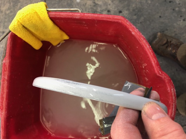

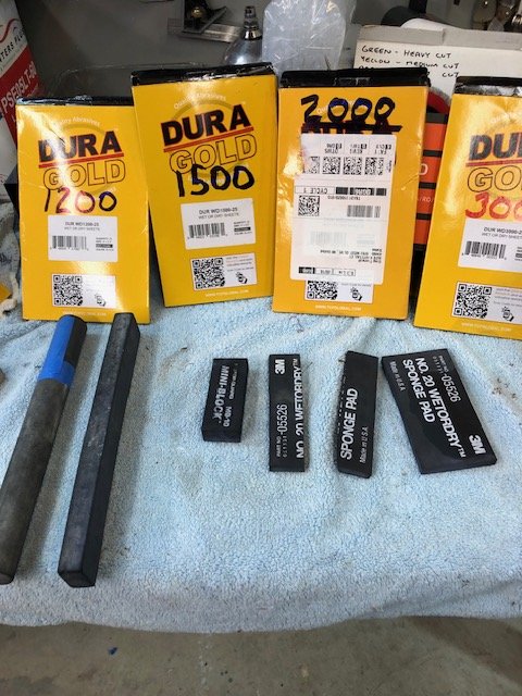

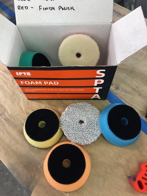

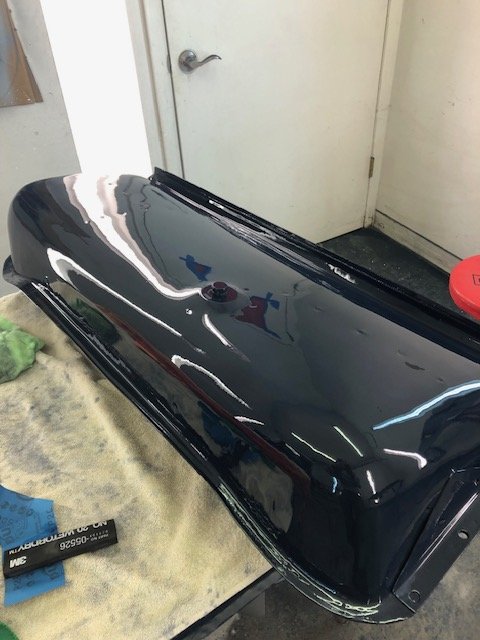

    I spent the day with my gritty littles buddies Mr. 1200, Mr. 1500, Mr. 2000 and Mr. 3000. I wet sanded my p***enger door and used 3 times as much water and I didn't push as hard wet sanding as I did with the trunk lid that I did a few days ago. And when I got all done buffing, I can still see tiny micro scratches in my paint. :( It probably doesn't help I am standing right under florescent lights but still, my goal is to not see any wet sanding scratches.
    The Data Sheet from the paint says to start with 1200 grit. Because I had a few sags & runs in the paint I sanded those areas in 800 and then 1000, then onto 1200. Otherwise, if I start with 1200 I will still be sanding the sags & runs next summer. The paint is PPG Concept single stage paint. At 3 feet away it looks fine. I am open to suggestions to eliminate sanding marks.
    I also wet sanded and buffed the under side of the gas tank. (the top side hasn't been painted yet.) Here I was not going for a deep luster, I just wanted to sand out some dirt knibs.

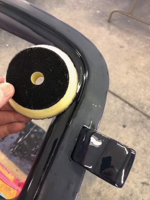

    The window area on the door of a chopped coupe can be a challenge to buff so I bought a set of 3" buffing pads to help out. These little buffing pads sure look small on a standard size buffer.
    They do help you stay out of trouble on a chopped window opening. You can get into trouble easy with a 9 inch buffing wheel when you are looking at where you are buffing and the other side of the buffing wheel catches on something.

    I have some progress on my 32 to show. Just painting, nothing to exciting. Actually kinda boring.:rolleyes:
    I finished painting, sanding & buffing several large parts. The wife said I could store them in the house so they are up in the loft.
    With all the big parts safely in the loft I cleaned the paint booth and got ready for more painting, but first I played catch with my dog Summer in the empty bay. I am up to 1 hour with her in the barn before she stands at the door & barks to go in the house. I am hoping to get her to be like my other shop dogs where they would stay in the barn with me all day but she is sort of a house dog.
    I dug out the frame and rolled it into the paint booth and washed 3 years of dirt, grim & shop dust off of it.
    My friend who helps me paint suggested because of all the nooks & crannies on the frame that we really need a rotisserie. So I welded up a budget rotisserie using the spreader bar mounting holes, jack stands and my wooden stands.
    I designed it by eyeball for the center of gravity. I almost nailed it but if you leave it alone, it slowly rotates to being upside down. So I just prop a stick under it.
    A garbage bag over the jack stands and its ready for painting. The body work was done 3 years ago so I just had to scuff the whole frame and clean it again to get it ready for painting. First a coat of epoxy primer
    Then the top coats of blue.
    After several rotations it was all blue again.
    Several other parts were painted also, the top side of the gas tank. (The bottom was done a few weeks ago.)
    The dashboard.
    The glove box door.
    Several other small parts were also painted but we had to pull the hood out of the line up.
    For some reason as soon as we started to paint, it spotted up. We decided to skip it until we figure out what happened. Any ideas guys? It had the same epoxy primer, same high build primer, same cleaning, but it didn't like what we were doing.
    It feels so good the have the frame painted again.. It was painted a long time ago by my friend who I bought the car from but I welded on body mounting nuts, revised the crossmember so I could use a Hurst shifter, welded on brackets for the steering linkage, brackets for the e-brake and mega fuse. By the time I got done doing all this welding I decided to re paint the whole frame.
    Next step is wet sanding and buffing the frame and all these parts.
    Thanks for following alone!
    Greg

    Could it have been contaminated by a product with silicone during storage?
  24. Chief 64
    Joined: Dec 10, 2010
    Posts: 303
    Chief 64
    Possibly? I didn’t have any issues when I painted the underside of the hood a few weeks ago. I normally keep anything silicone away from my shop. I keep the rags separate that I use for cleaning for painting, wet sanding etc. When my wife washes the rags she uses no fabric softeners or soap with any additives like perfume. I scuffed the hood with a brand new scotch brite pad the day before painting, then rinsed with warm water.

    I've had problems with wiping a panel down and applying paint too soon.
    If you used a degreaser or some other product just prior to shooting, the product might not be fully dry even if it looks dry. Still might be g***ing off.

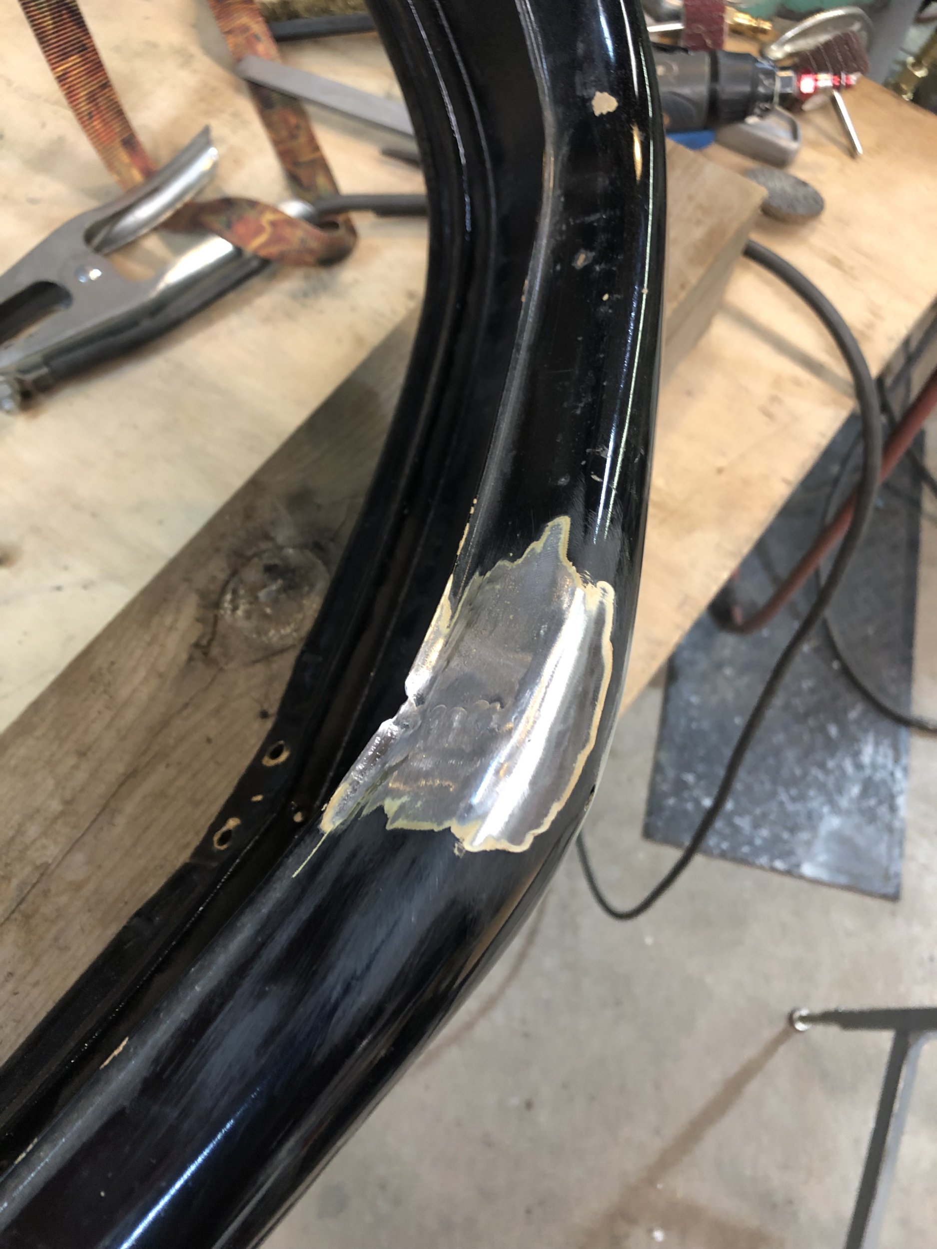

    Well, as my painting went on the results did not improve and possibly it was getting worse. I kept finding little things to try to fix it but no luck. So, I talked to the guy at the local paint store. I was lucky and for once the store was not busy. He offered a few suggestions. First, even though my paint spec sheet says 65 F minimum he said in January in Michigan you have to bump that up to 70F or higher. I have an infrared temp gun and always check my parts but I see his point. I had been painting if it was above 65F surface temperature. But, if someone walks in the shop door when it is 15F outside the shop cools in a hurry. The second thing he said was try a different wax & grease cleaner. He said he has something that also has an anti -static feature. Oddly, it was not on the shelf in his store, he had to go back in the warehouse to get it. He said all the pros use it. This is the stuff. It was over $40 /gallon. You must shake it first and spray it on with a sprayer. At this point I’ll try anything. And as 1956 caddy suggested I clean parts 1 hour before I spray them.
    The other change I made was a friend of a friend that uses PPG single stage paint said to wait 1-2 hours between coats, not 10-15 minutes like it says on the spec sheet. So I did this and cleaned the gun in between coats.
    The last change I made was to try a new gun....and yes that makes me feel like a real loser.... You know you are a loser when you blame the paint job on the gun.:eek::eek::eek::D:D:D.
    Since I had a bunch of small parts to paint I bought a $29 Harbor freight touch up gun to do the small parts. Seriously, that gun is AMAZING!!! I was planning on painting my grille after the small parts with my DeVilbiss FLG3 but I just keep painting with the Harbor Freight gun. The grill is by far the best part I have painted. Here is the gun I bought. I plan to order a rebuild kit for the DeVilbiss soon.
    Here is the grill in primer.
    and painted ready to cut & buff.

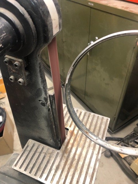

    It seems that the chrome 7" headlight rings are no longer available so I dug out my old pair and decided to rework them and paint them until new ones are available. First I ground off the pits & rust.
    I was concerned that some of the left over chrome would cause the paint to not stick so I hit with some adhesion promoter.
    Then a little high build primer and wet sanding.
    Then some more primer & paint with my new harbor freight gun. I think they will work for fine awhile until I can get some chrome ones.
    In other, news I started to ***emble ch***is. I installed the rear end and began do a preliminary alignment/square up job.
    I installed all the rod ends on the rod links in the middle of the threads on each end. I am not sure if this is the best but it seemed like a good plan.
    I put a little white dot on the L.H. threaded end of the link and put all the L.H. thread towards the back of the car. That way I always know which way to tighten/loosen the lock nut.
    After I put the 4 links on I did some preliminary adjustments.

    I started ***embling the front suspension. I cleaned, polished, buffed & waxed each part as I go and work hard not to scratch the new paint but man is that tough with old fingers.:rolleyes:
    I have the style of king pin that does not have a head on it so I needed a cap to cover the top of the kingpin and keep dirt out and grease in. It seems all kingpins now have the head on the top of them. I went looking for a cap and only found one aluminum cap. I decided to make my own cap from some br*** bar stock. So a little time on the lathe.
    and little time on the mill to make some wrench flats.
    Now I have some kingpin caps. They will get some silicon to hold them in place. The flats are so I can twist them off with a wrench and break the silicon. (There wasn't enough bore length in the spindle to rely on a press fit.)
    I can't wait to be out with the car when some thinks I have a br*** kingpin and tells me I can't use br*** for a kingpin. I will tell him I used to use wood but it keep failing :D:D
    ***embling the RH kingpin & spindle was a breeze. The LH was not.
    The back story is that when I bought the car it came with a cast SuperBell axle. In general I prefer forgings over a casting especially in a critical component. So I bought a forged Roadsters Supply axle. They warned me about the slightly wider track dimension. I like the forged aspect of the Roadster Supply (actually I think SoCal)axle but I didn't like the extra weight or the extra track width. I liked the sleeker, slimmer look & lower weight of the SuperBell axle. I was having a hard time deciding so I sent a PM to Krylon32. Gary sent a nice reply and said he has used 100's of the SuperBell axles but also 100's of Roadster supply forged axles. I even did an old blacksmith trick to check my Superbell axle. I hung it from a wire and taped it with a br*** hammer. It rings a nice tone as beautiful as a 400 year old German Church bell. If it "rings" it means no cracks. If it goes "thud" when you hit it, it means that casting has a defect (crack ) in it. At this point I was still sitting on the fence until one day I hit a MICHIGAN pot hole in my truck that I didn't even see and it rattled my brain!!! I thought to myself if I was in my 32 I would rather hit that with the heavier forged axle so I decided to use the Forged one. I'll keep the SuperBell for now.
    Back to where I was, the LH kingpin would not go into my new forged axle.
    The kingpin is .808in and the axle bore was .8065in. I didn't exactly have a .808 reamer on hand so I made a poor mans reamer out of a piece of aluminum and emery paper.
    Then using my drill I did the best imitation I could of an old Sunnen honing machine.:p I ran the drill at full speed and went up & down in the bore and rotated it in a circular motion all at the same time. I stopped often to check my progress. After a awhile the kingpin could be taped in with a rubber mallet.

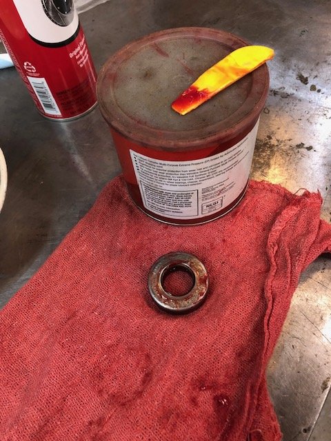

    Time for ***embly. I am taking so long with this project that the grease had turned into soap so I had to clean and re-packed the kingpin bearings. The bearings are new...well they were back in 2002 :rolleyes: otherwise I would have bought new ones.
    Not to mention I ran out of shims and had to order some more, but after this I was ready to complete the RH kingpin with new grease, new shims, honed (sanded) axle bore. My excitement ended quickly when after I had is all ***embled, I realized the spindle would not rotate forward. I had interference with my new forged axle.
    So off it came and I had to grind some off the spindle casting. There is that word casting again. Maybe I should see if a forging is available.
    The front suspension is finally together to the point I can take new measurements for a longer tie rod and drag link tube to compensate for the wider axle.
    I will do a little rough alignment next and then comes the front brakes, bearings, drums & wheels.
