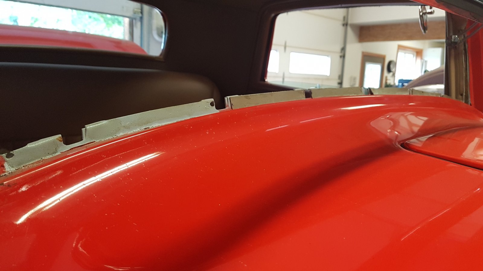

  1. Looking for some help on what the fasteners and/or clips? cage nuts? or whatever is supposed to retain the dash at the bottom of the windshield frame flange on the '32 3-windows. There are 7 recesses in the area of the body (see pic) that line up with the dash holes (the screws go in from the windshield side).

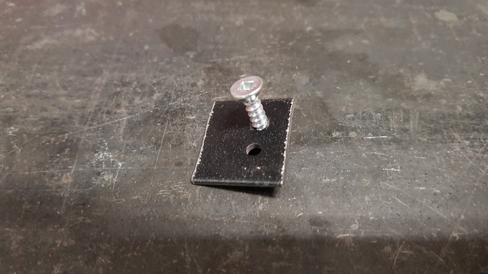

    When I removed the dash, mine was held in place with wood screws threaded into a small pieces of 18 gauge sheet metal that sandwiched the dash to the flange (see pic below). I'm pretty sure this wasn't Henry's design...but would like to know what type of fastener/clip or whatever is supposed to be there. Thanks in advance.

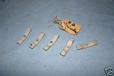

  7. Fordbarn to the rescue...thanks guys...along with the installation process.

    Late to this party! As you can see in the pic, these are effectively pieces of flat bar with a standoff formed to presumably allow some flex. Easily reproduced and if you're not too fussy on the originality a more common threaded fastener could be used.
    On my Brookville bodied coupe I chose not to use them for a couple of reasons. Firstly, I decided they were awkward to fit ( I guess loosely ***embled on the dash and then offered up, probably a pita to align etc and risking paint damage?), and secondly, more crucially, the notches in the body i decided were a source of water ingress, so I filled them and welded nuts to the inside. All fits together nicely but still at painted but not re***embled stage so I don't know how it will work out in use. I'll be fitting a rubber or foam strip to avoid metal to metal rattles and to allow some flex.
