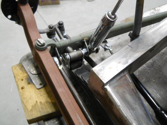

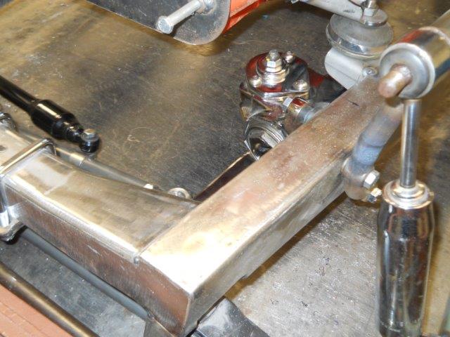

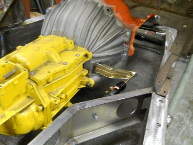

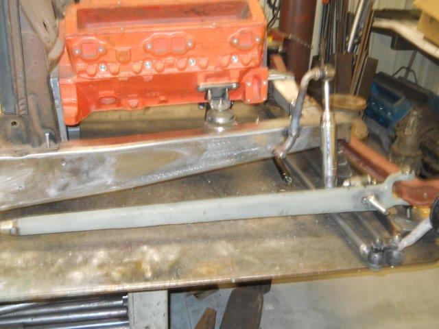

    More pics of the ch***is work by Krylon. DSCN0512.jpg DSCN0511.jpg DSCN0510.jpg DSCN0509.jpg DSCN0508.jpg DSCN0507.jpg DSCN0506.jpg DSCN0505.jpg

    Very nice. What year bellhousing uses the release arm on the p***enger side? Seems like a real problem solver to gain some space.

    I believe there is a knock out provision there, and a emobossed area for pivot ball on p*** side, just needs to be drilled and tapped. Gary machines out the hole and welds up the drivers side.

    Picked it up today from Gary and just wanted to say I am very impressed with his skills. Very nice set up on the bell housing. Can't wait to get everything in primer & paint so I can start putting things together.
