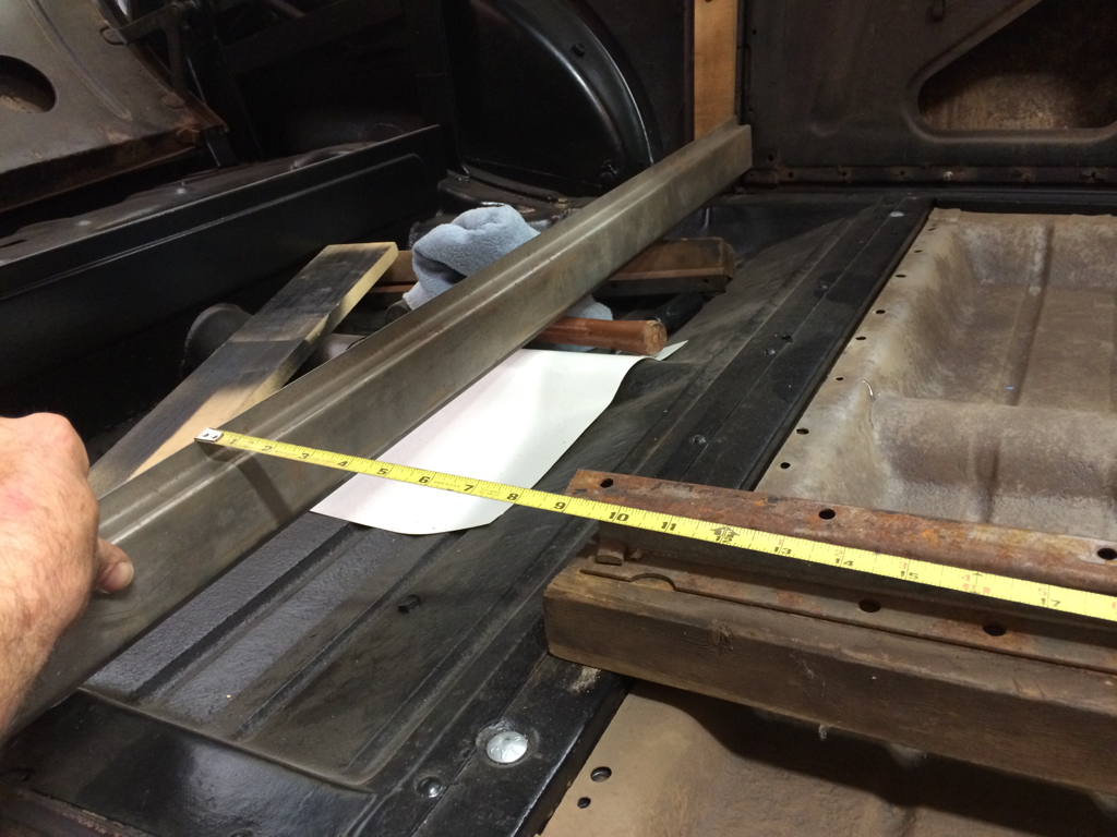

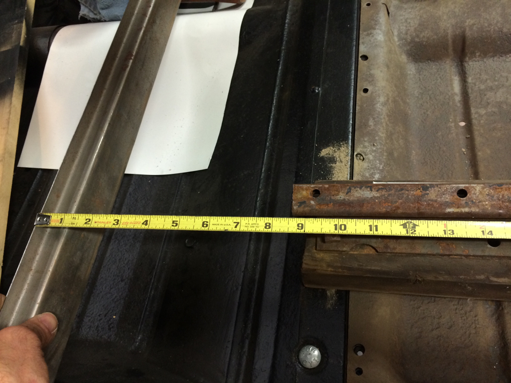

    Dennis, here are some seat point. The pan should have five holes in a line per side. The rear most hole is 9 1/4 inches from the back edge of the door jamb ( used a straight edge) when the seat track is centered in the travel. Let me know if you need more.
  4. 383deuce
    Joined: Jul 10, 2009
    Posts: 3,668
    383deuce

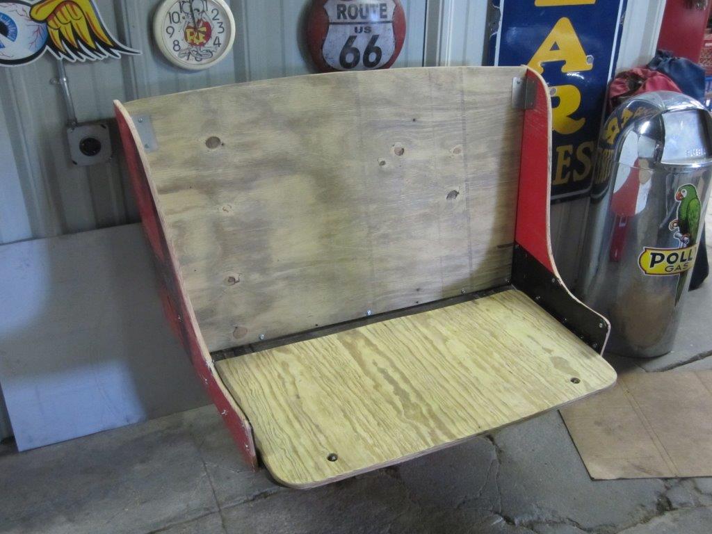

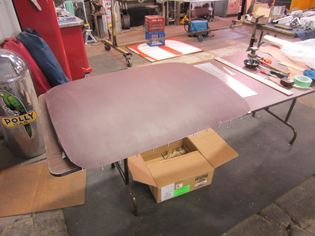

    Big Deuce thanks for the up date and Roadsir thanks for the measurement, but I am not going to do the seat tracks. I am going to set it up to fit me and bolt the pan directly to the floor due to the hard chop I need all the head room I can get. I am sure you understand my madness. But at least your measurements give me a general location of where it should go and that is what I was after.
    Sorry about the mess in the shop photos everyone, but I have 3 window parts everywhere from one end to the other. Sure will be nice to get some paint on all these parts and put them all together as a rolling frame.

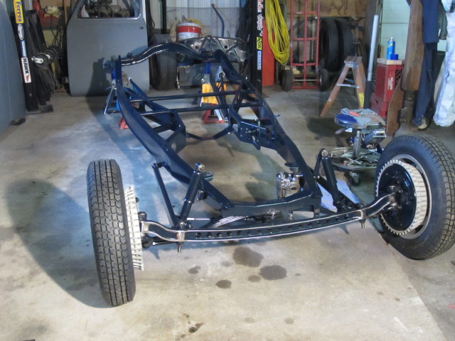

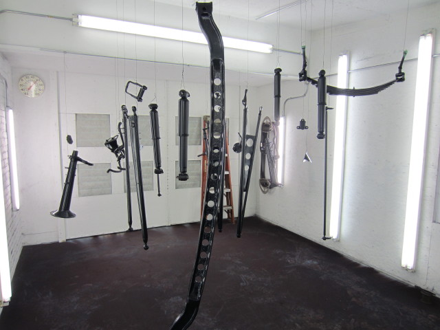

    Well guys at long last the frame and all related parts to it are primed
    and painted. I am really liking the color we mixed up for it. It is a
    PPG paint and 1936 Ford washinton blue that we changed up with more
    black parts and less white. Plus we added a flatting agent to it.
    You can see in the paint booth photos it looks to be black and the
    backing plate in the sun looks to be blue. I will say the photo of the
    backing plate in the sun comes out looking more blue than it is to the
    eye, but you all know how photo colors are never right.
    Hope you all like it.
