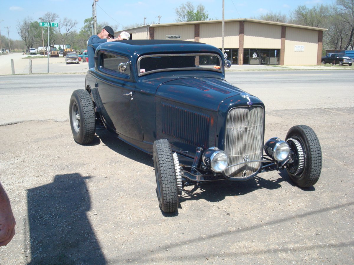

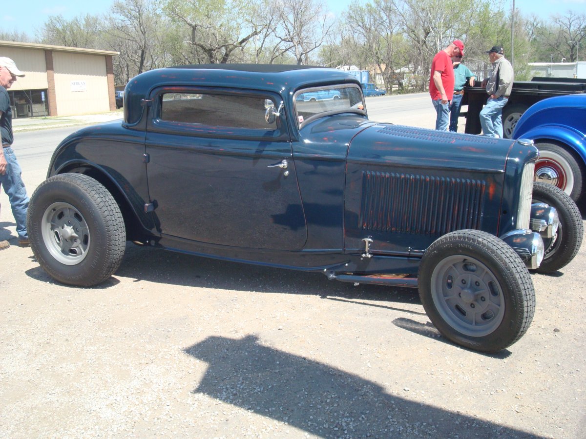

    Dennis made his way up to his hometown Salina, KS today for the first maiden voyage. About a dozen or so local guys got together and marveled over Dennis's car. You knocked it out of the park with this one. DSC09622.JPG DSC09623.JPG
  29. 383deuce
    Joined: Jul 10, 2009
    Posts: 3,668
    383deuce
    Bigdeuce,
    Thanks for posting the photos and for making time out of your day to come out to Garys to check out my new ride. It was great to see a lot of my old buddies that I ran around with back in the old days. About the only thing that would have made it better is if Bob was still around to have been there. I think he would have liked it.
    Put close to 400 miles on it that day and it ran great with no problems the complete trip. Got right at 19.39 mpg on the trip home.
  30. big duece
    Joined: Jul 28, 2008
    Posts: 7,107
    big duece
    from kansas
    You got that right. The only thing dad or I would have changed was the name on your ***le. Can't ask for more mileage than that for a 300+hp early '60s 327 build!!
