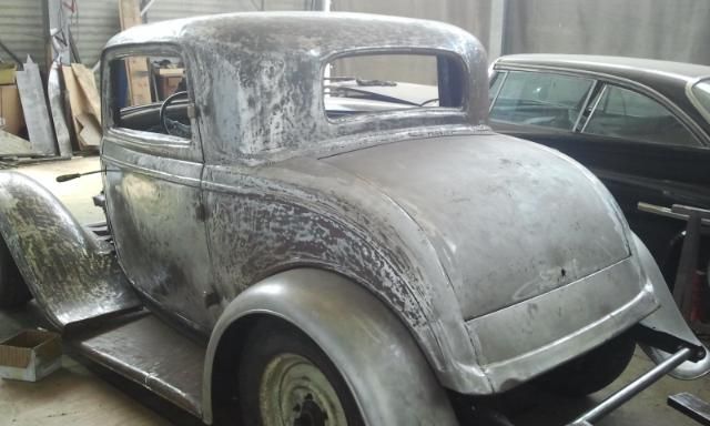

    Ok, some updates. Ch***is is completely mocked up...rear suspension is almost done....just rear shocks and panhard bar need to be done. Front suspension is done...have raised the monoleaf spring a couple of cm. ALso waiting for the panhard bar to arrive. Boxing of the frame needs to be finished. Rear end is AMC 20 out of a Jeep CJ...not my favorite choice...but was free. Tomorrow will place body on the ch***is to check for wheel fit inside the fenders...and to make some pics...than will blow everything apart for final welding. By end of july car will go the bodyshop to have last dents fixed and then paint....
    Some pics now....
  8. adventurer
    Joined: Aug 1, 2006
    Posts: 385
    adventurer
    If you guys with more experience than me ...see something wrong or unsafe..please let me know....

    Word of advice.
    Your rear wishbone mount should be mounted double shear at the front.
    Or use a split wishbone kit with tie rods.
    Michael
  10. adventurer
    Joined: Aug 1, 2006
    Posts: 385
    adventurer
    yes, that was in the list of things to do....a small crossmember and some more strength to the wishbone mount. Thank you

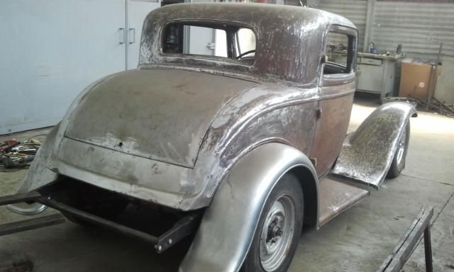

    Following suggestions, have reinforced the rear wishbone mounts...here is just mocked.. will finish welding when all ch***is is apart

    and here the car is on four wheels for the first time in many,many , many years....wheels are just temporary ..still undecided if will be using ET or solid wheels
