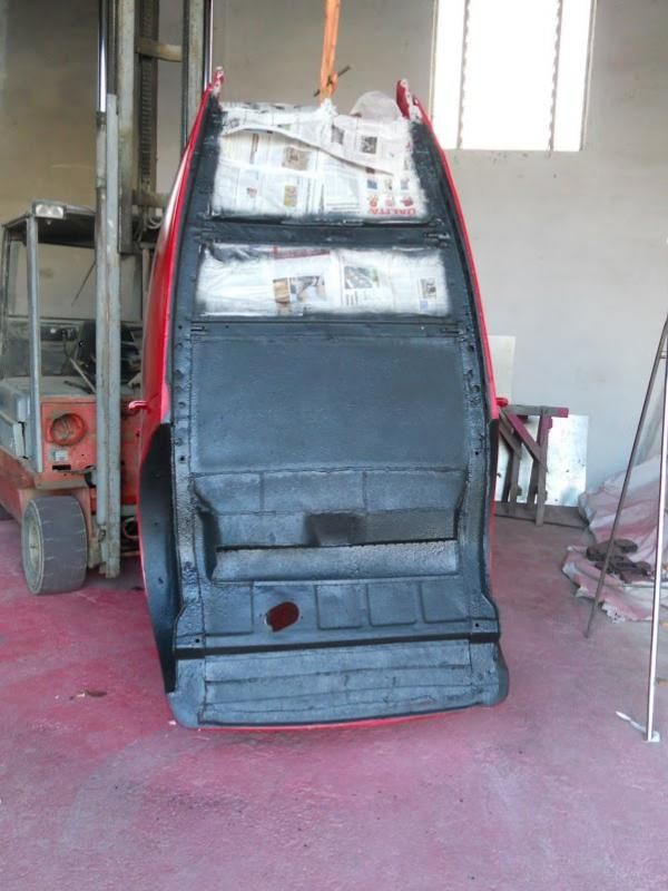

    spraying the undercoat....and getting ready to paint frame

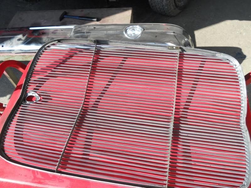

  19. adventurer
    Joined: Aug 1, 2006
    Posts: 385
    adventurer

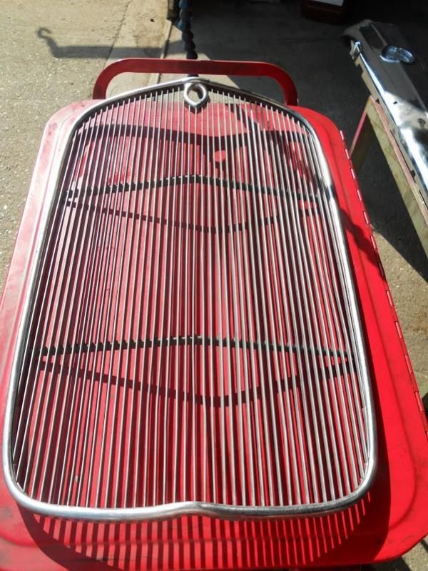

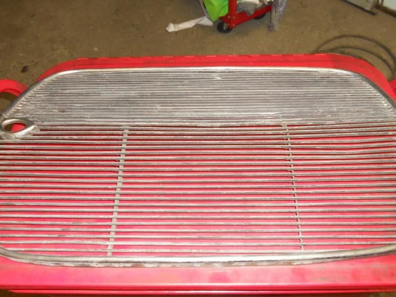

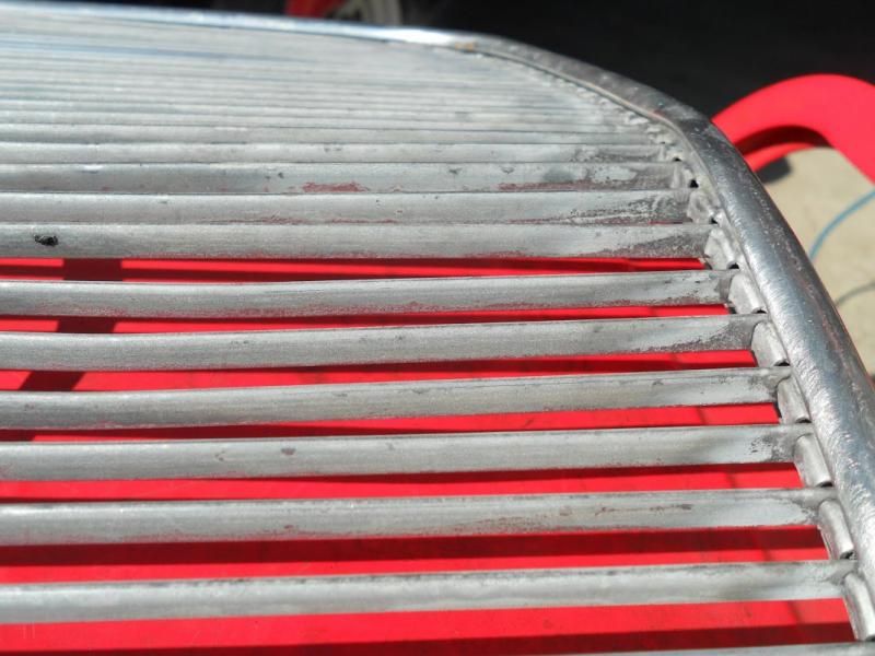

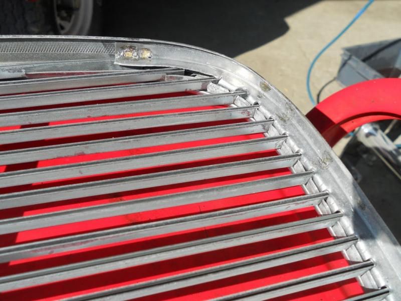

    The grille is a long story. I had an original grille, but had been reworked and many of the bars had been changed. The remaining bars were not in good shape, so I decided to purchase another grille. Found a nice one on ebay, and work started on this one. There was some rust and traces of paint, but sandblasting would have left a porous surface. So we decided to put in a bath of Evapo Rust, and after a day the grille came out looking new. Here are some pics of before and after

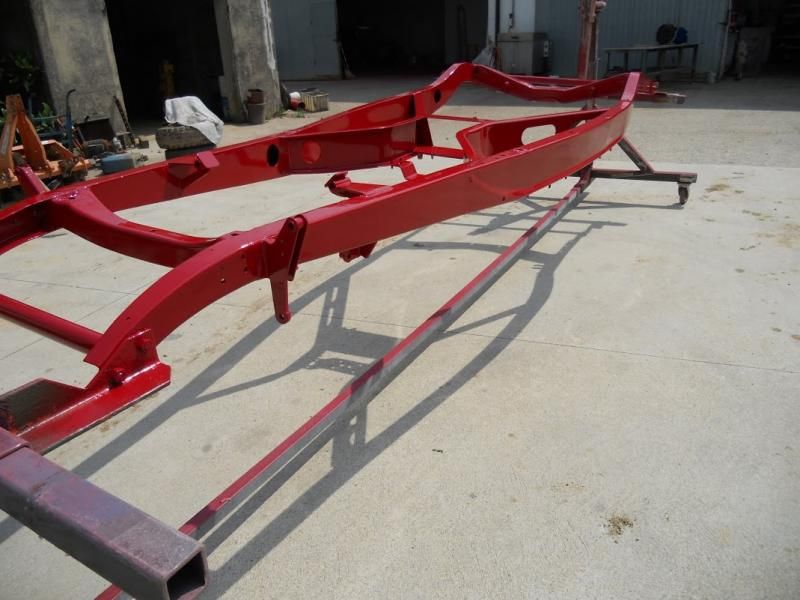

  23. adventurer
    Joined: Aug 1, 2006
    Posts: 385
    adventurer

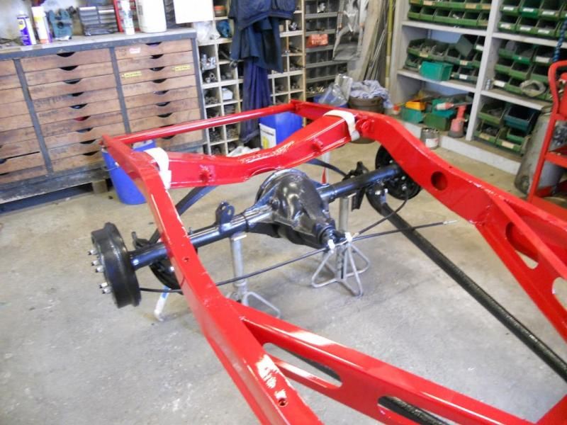

    frame Painted and ready to be ***embled

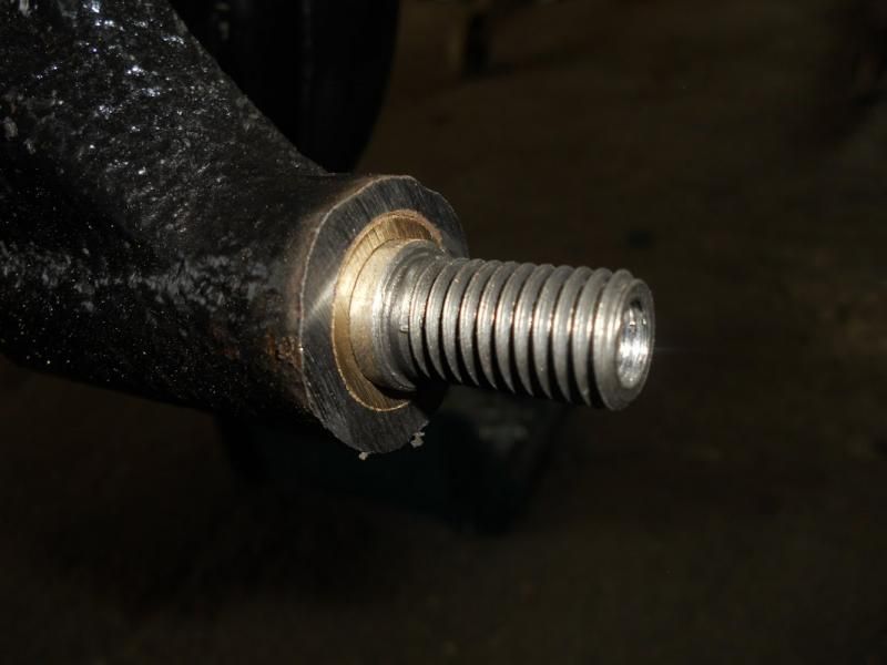

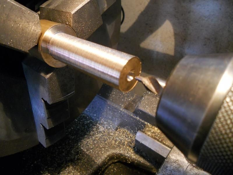

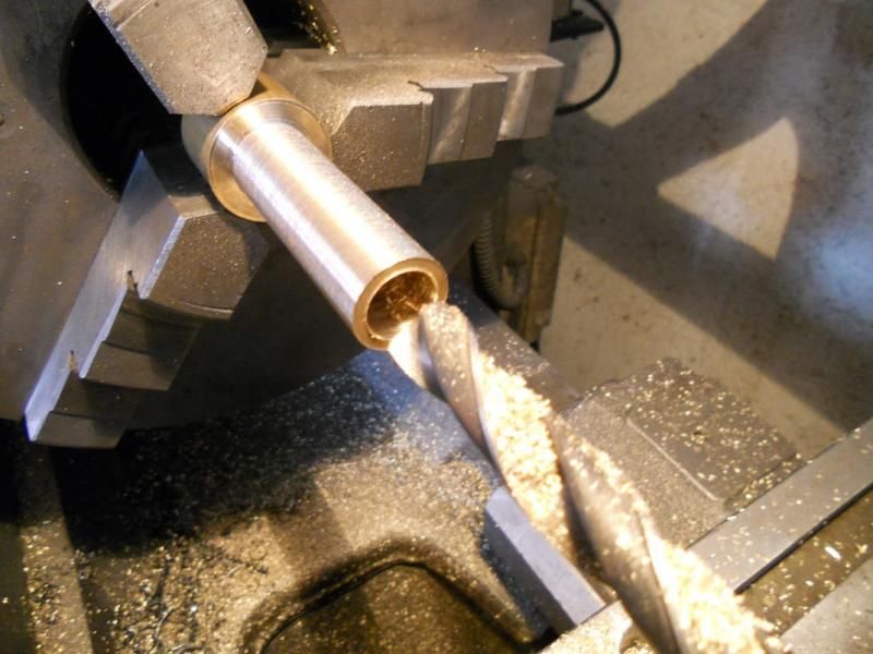

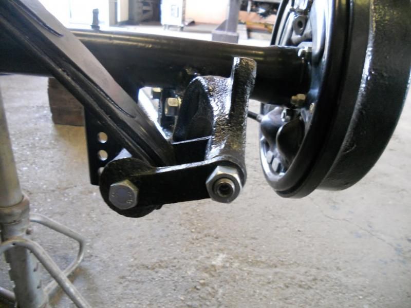

  24. adventurer
    Joined: Aug 1, 2006
    Posts: 385
    adventurer

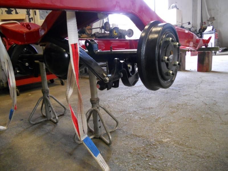

    mounting the leaf spring to the wishbones...a bronze bushing ahs bene created, with a threaded shaft with a grease fitting....
