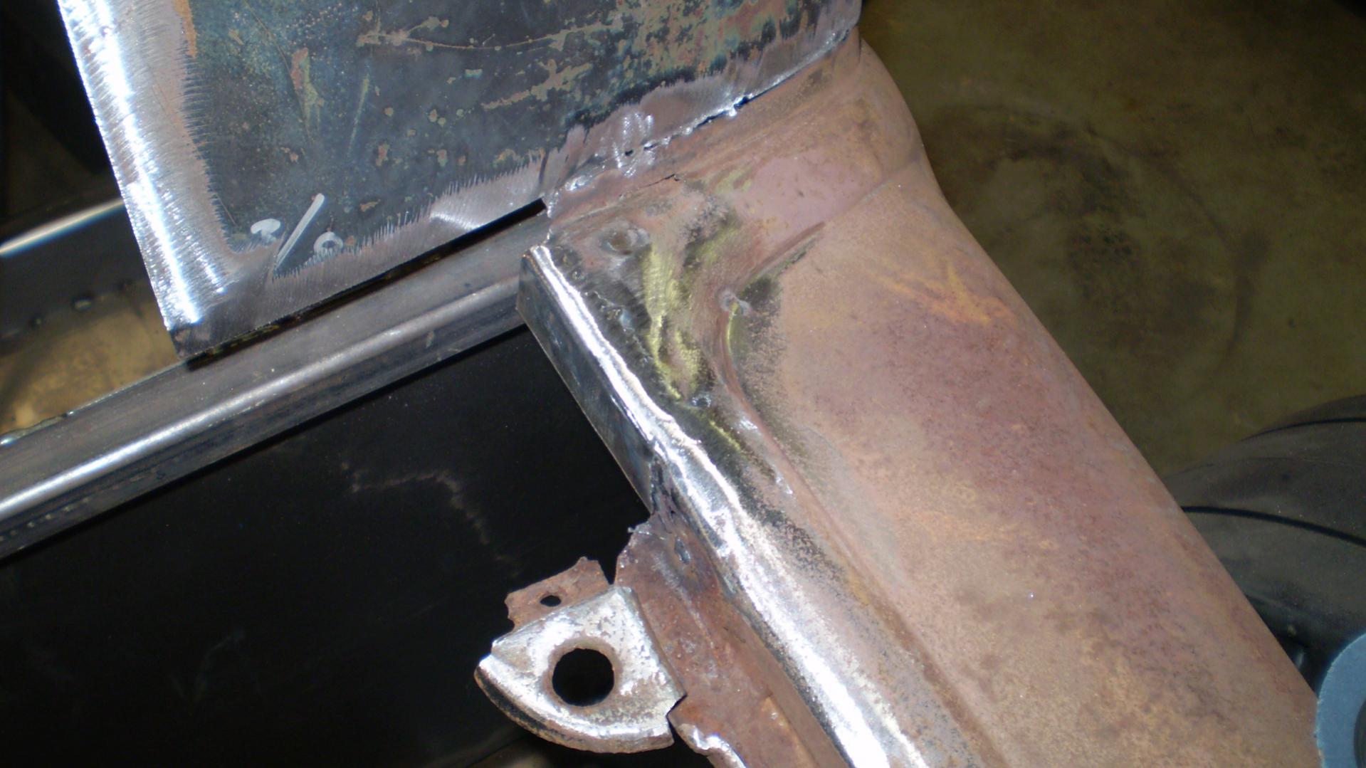

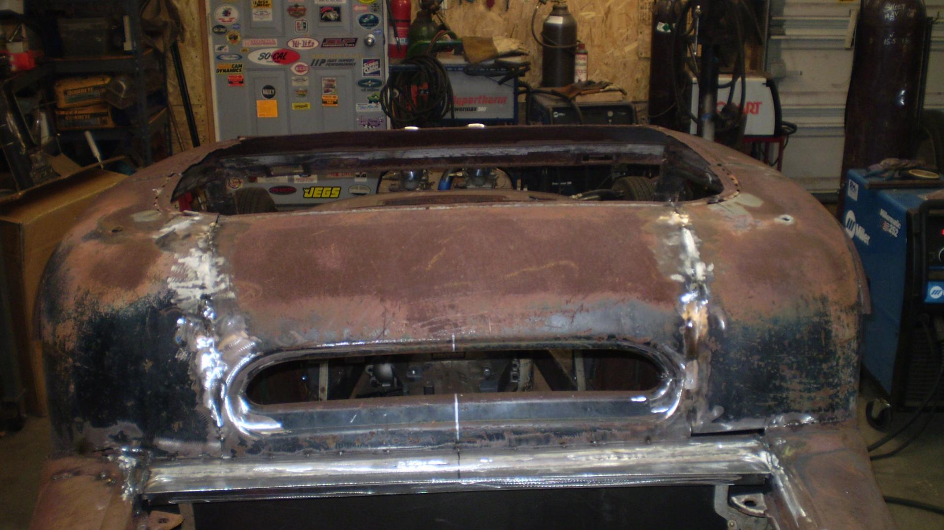

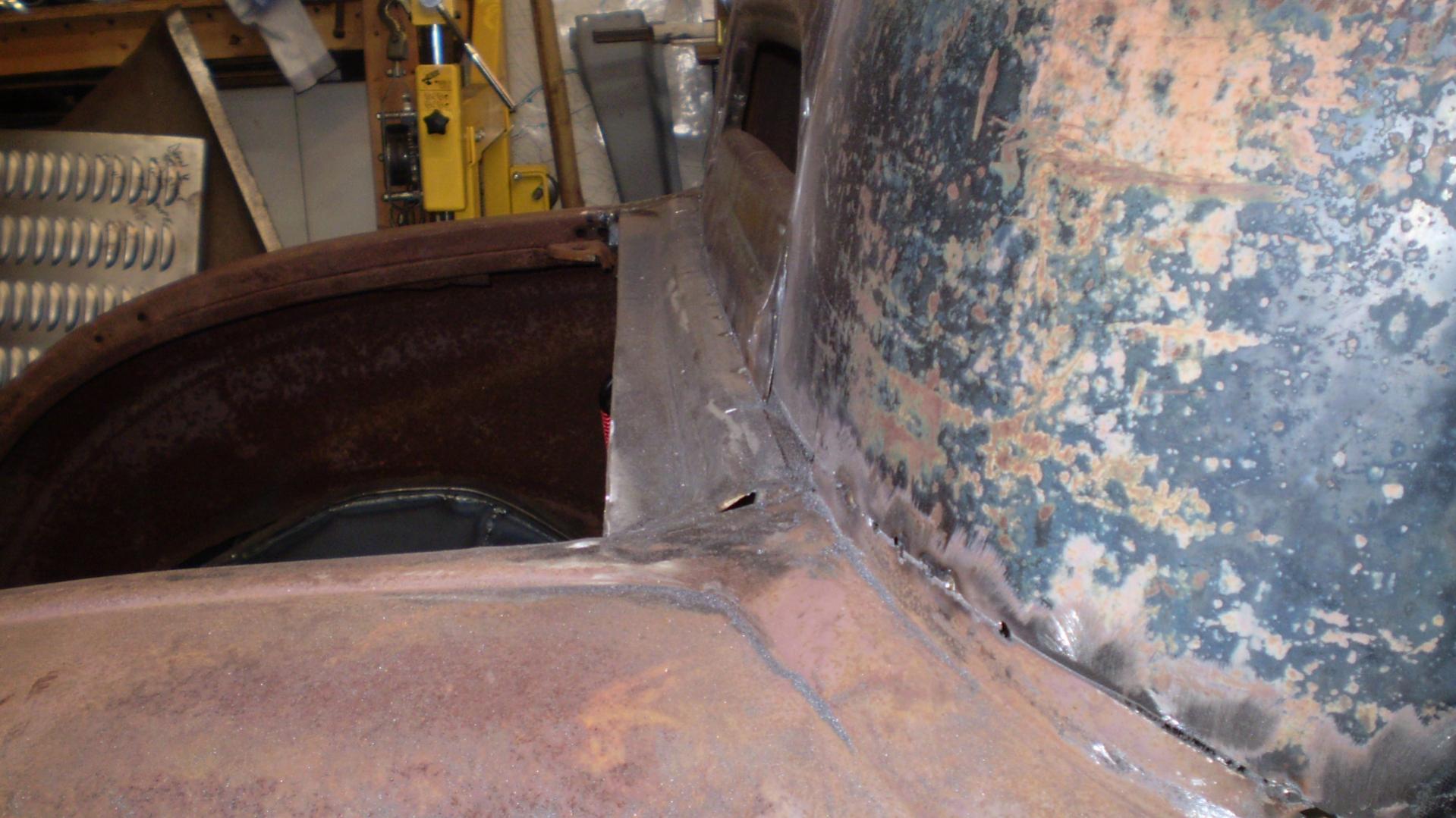

    i got some more work done. it is finaly a coupe. i got the back of the qtrs on for good and installed the roadster deck panel i modified. i also got the rear window panel in and welded. this was the hardest part so far. every thing meets together in the rear and i had to make sure that thr roof was the same on both sides and that the qtrs were level. i have to use a ratchet strap to pull the body in square. here are some pics
  10. 32coupedeville
    Joined: Dec 10, 2006
    Posts: 1,253
    32coupedeville
    from cincy
    i messed up in one place . i will have to go back in fill in a 1/2 x 2 1/2 strip. this is why you measure twice and cut once. but if this is my only goof up, i guess i will have to live with it.

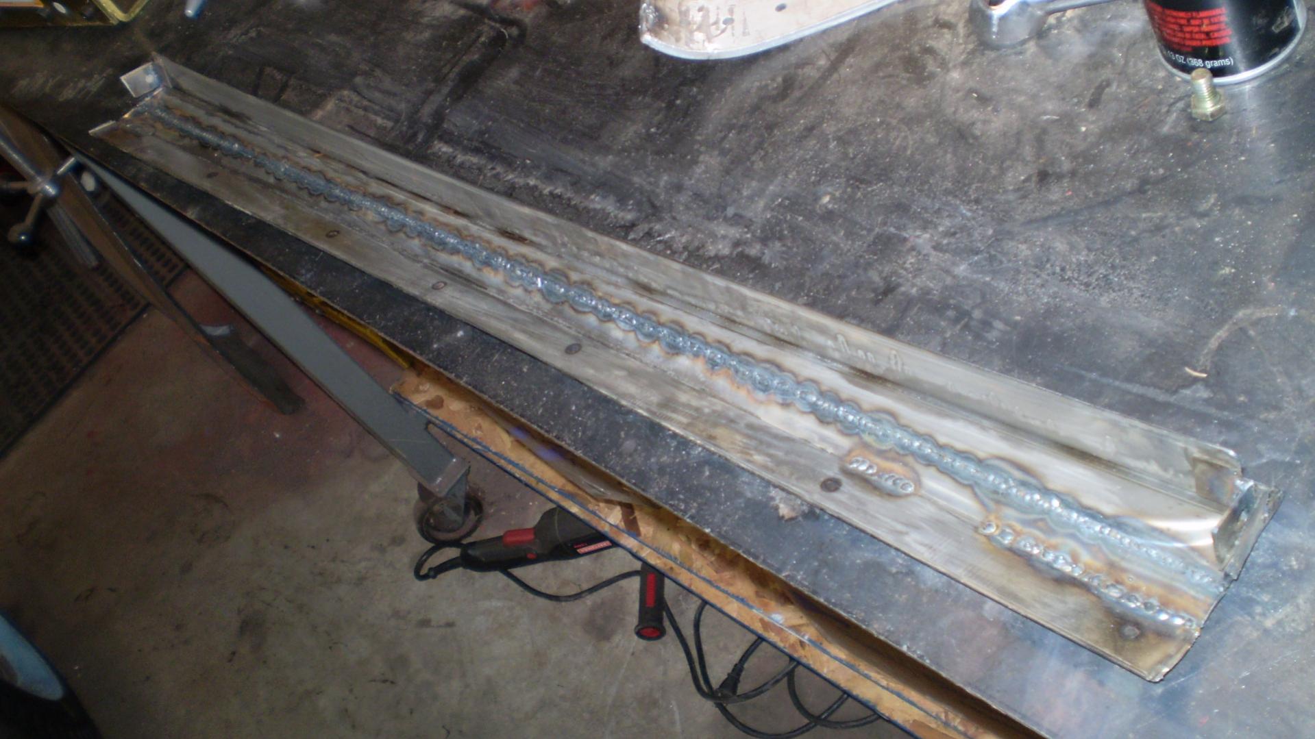

    i hav ehad some requests to see the bottom of the brookville roadster deck panel . here are some pics. also some people like to polish every last pieces they make when they post pics on the hamb. i know i am not the best metal man but this car will be stripped down to bear metal before it is painted . i dont feel the need to polish the metal just for pics. this will give you all some idea of what it takes to build your own 32 5 window coupe out of a fordor sedan. at this point i have 58 hours in the body encludes cutting the fordor, building the channeled sub floor and all welding to this point. these is some welding left aswellas all garnishmoldings to go. i think there is another 20 hours or so.

    ratchet straps,comealongs,chain...whatever it takes to square it up...keep on keeping on.....your on the right track and it's looking good kid!....... love the mail slot rear window

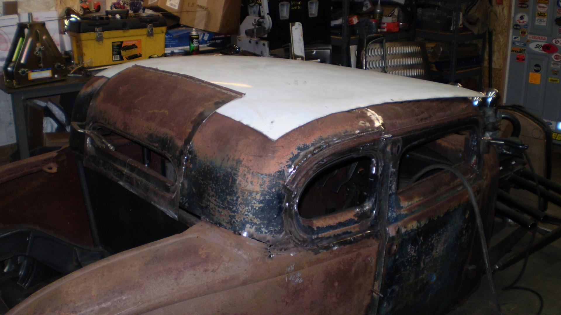

    a few more. also pics or mock up of a corvair roof on the coupe before i had welded the rear section on. i have to say that the 64 corvair 4 door roof works great. it lays on there like henry designed it.

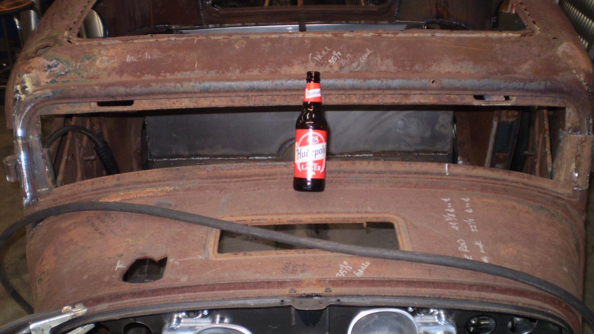

    36 ford rear bones and 1/2 eliptic springs made by cutting a 48 ford front 2" wide spring in half and redrilling the pack for locator bolt. here is the best pics i have so far. there is a temporary brace in the way in the pics

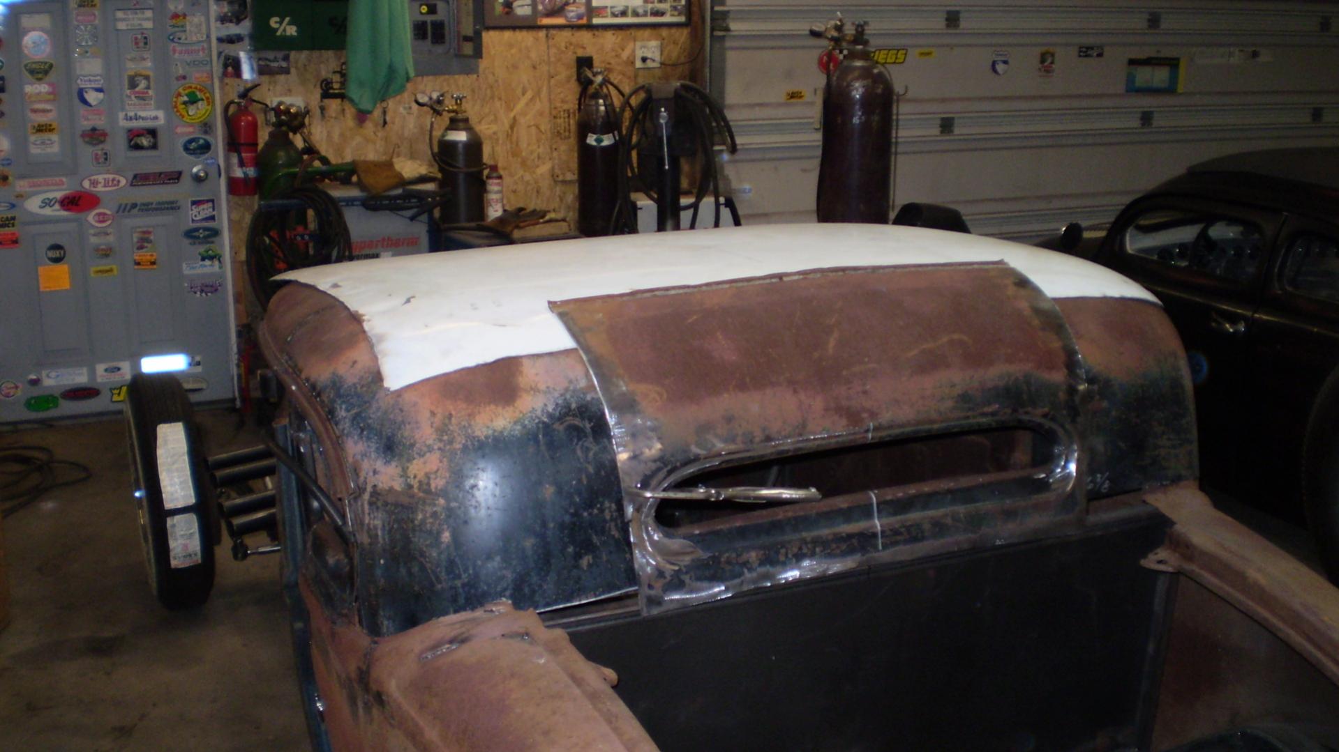

    here arte some more pics of the corvair roof fitted. still on the edgen on filling the roof. also so other misc pics of the car so far
