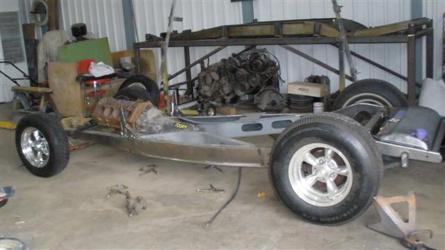

    I have a few pictures of the frame build. The wheels and tires are proper size and offset and are great rollers but the final wheels will be steelies with rings and caps. One of the thing KIRK does is center the axle and wheel with the fenders mounted to the frame, that way there is no surprises with car when the frame is welded solid and the bodies mounted andthe fenders are put on. Another issue was the fit and clearance for the Posies parallel rear spring set up, KIRK also mounted the frame horn covers and gas tank to make sure it all works. I wanted anew flat firewall, so I got a Brookville unit. Fits---- right from the get go. Set up for a 350 Chev. and a 700R4 trans. A Ch***is Engineering brake pedal ***embly. Provisions for the steering column and steering shaft and steering box. A lot of stuff in a limited area for sure. BILL RINALDI

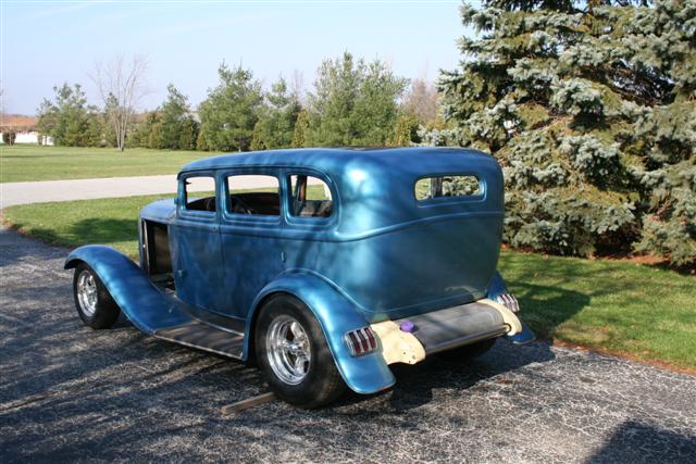

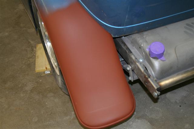

    One of the issues of the original {1950's] build of the car was, as nice as the 4in. chop was, it had "steps" in the windshield posts and front door frames. This "problem" was taken care of by Vince Spretnjak from Calumet Collision Hot Rod Repair. First thing he did was align the doors and got all the body lines as straight as possible. and the door gaps evened out. As for the steps, after removing the paint and as much lead as needed [yea, lead, the chop was done with steel rod and lead]. Vince slit posts and pulled in at the narrow part and spread it out at the wide end, welded in filler as needed. Sounds easy enough---If you know what your doing---Man he sure does!! A minor change but an important one, Oh yea, the Mustang tail lights went away, a major change for sure. Now the fenders have room for the N.O.S. Vega tail lights. BILL RINALDI

    I can't go on like this!! The tail lights are gone-----no more tail lights in the fenders---Period. The bodies on the frame and things are pretty much lined up. I'm just about ready to pull the body back off the frame and start the finish work on the frame and suspension. Here's a few current pictures. BILL RINALDI
