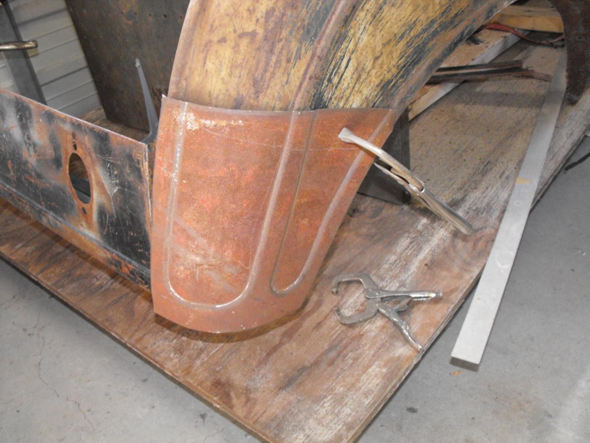

  3. [​IMG]
    Call Frank Borawritz at 602-248-0812 and tell him I sent you. Here is what they look like and how they went into my car.

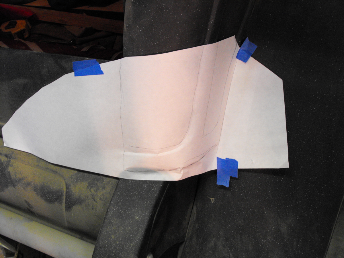

  22. tingeezer
    Joined: Sep 18, 2007
    Posts: 207
    tingeezer
    from colorado

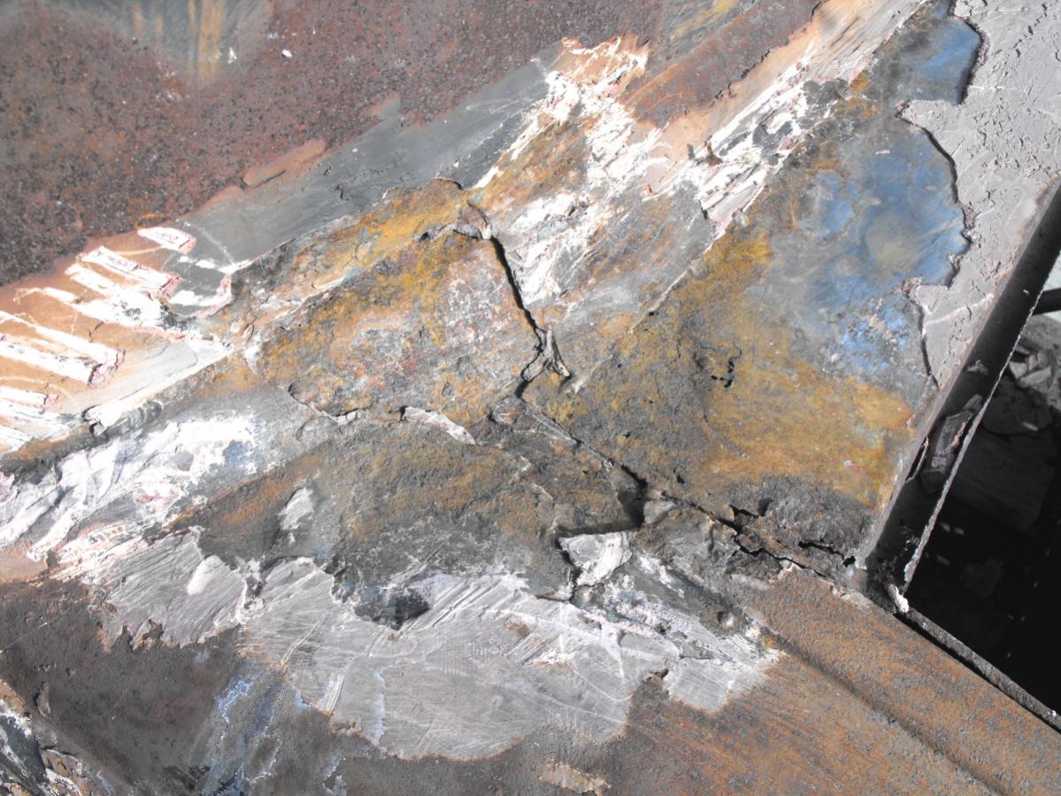

    As it turns out corners will be the least of my problems, what is there is solid except where water collected under the bondo. Those areas are gone. I have already started making what I can without the body being mounted to a frame, waiting for subrails and a set of frame rails. Some times it really is junk when you start.
  23. I probably have a advantage over you on this since I went straight to Frank with my car and we were able to make them for my car by using the roadster ones to start with and made the changes that were needed. I am sure if you talk to Frank and tell him what you are trying todo and he can make them the way you want. Hope this helps
  24. tingeezer
    Posts: 207
    tingeezer
    from colorado

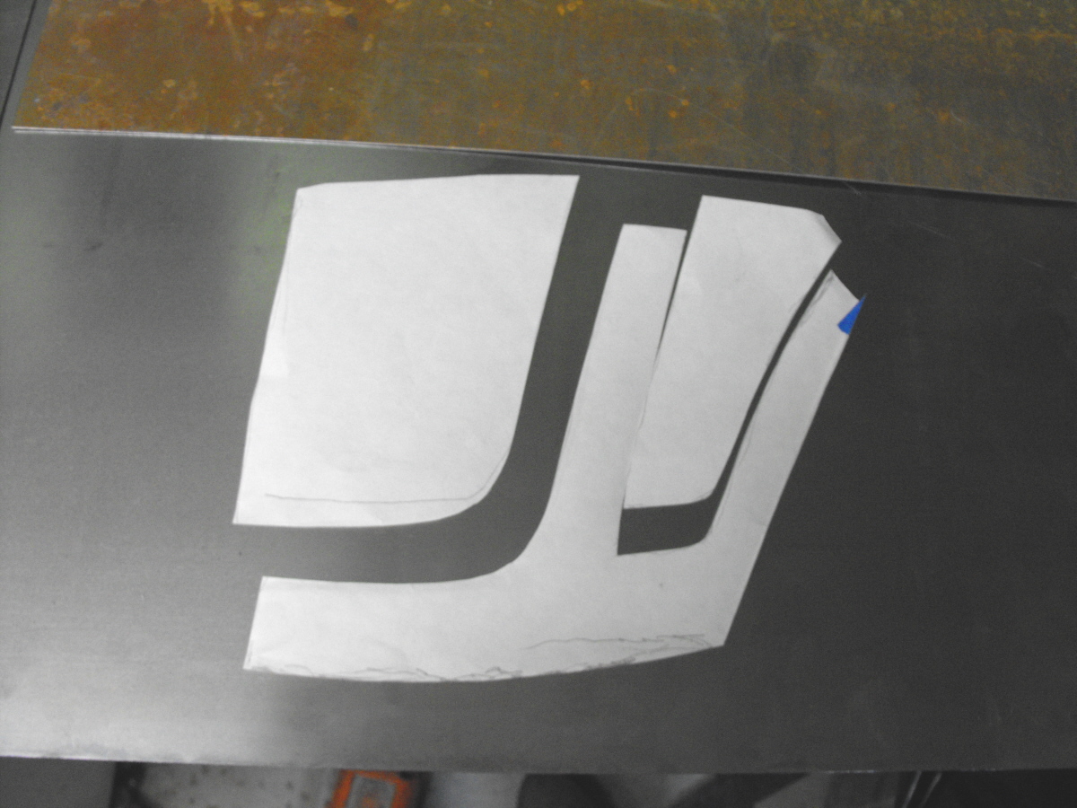

    I don't have my patterns yet, but I took pattern off a cabriolet body and winged it, just to see how hard it going to be. I think I can make them.

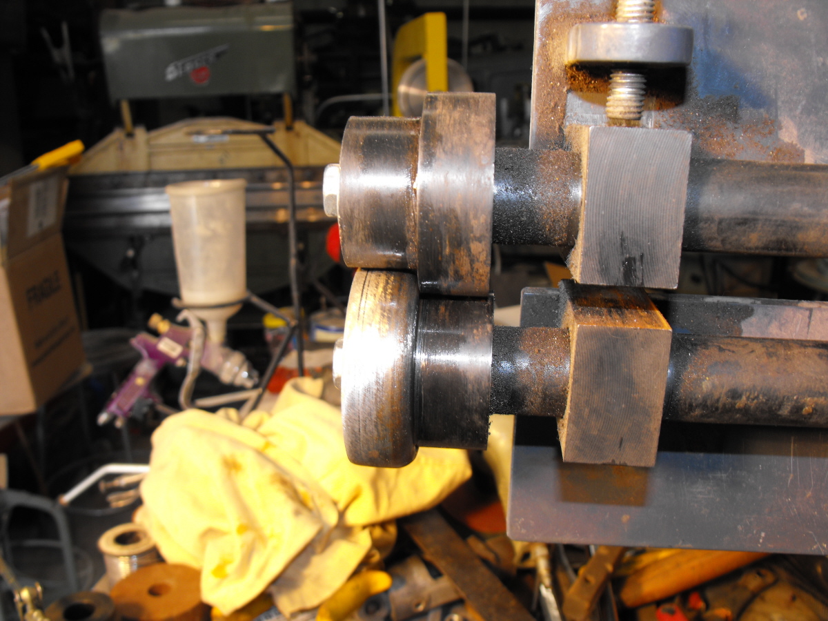

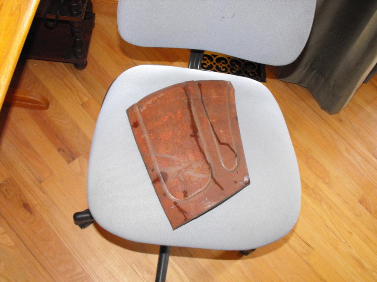

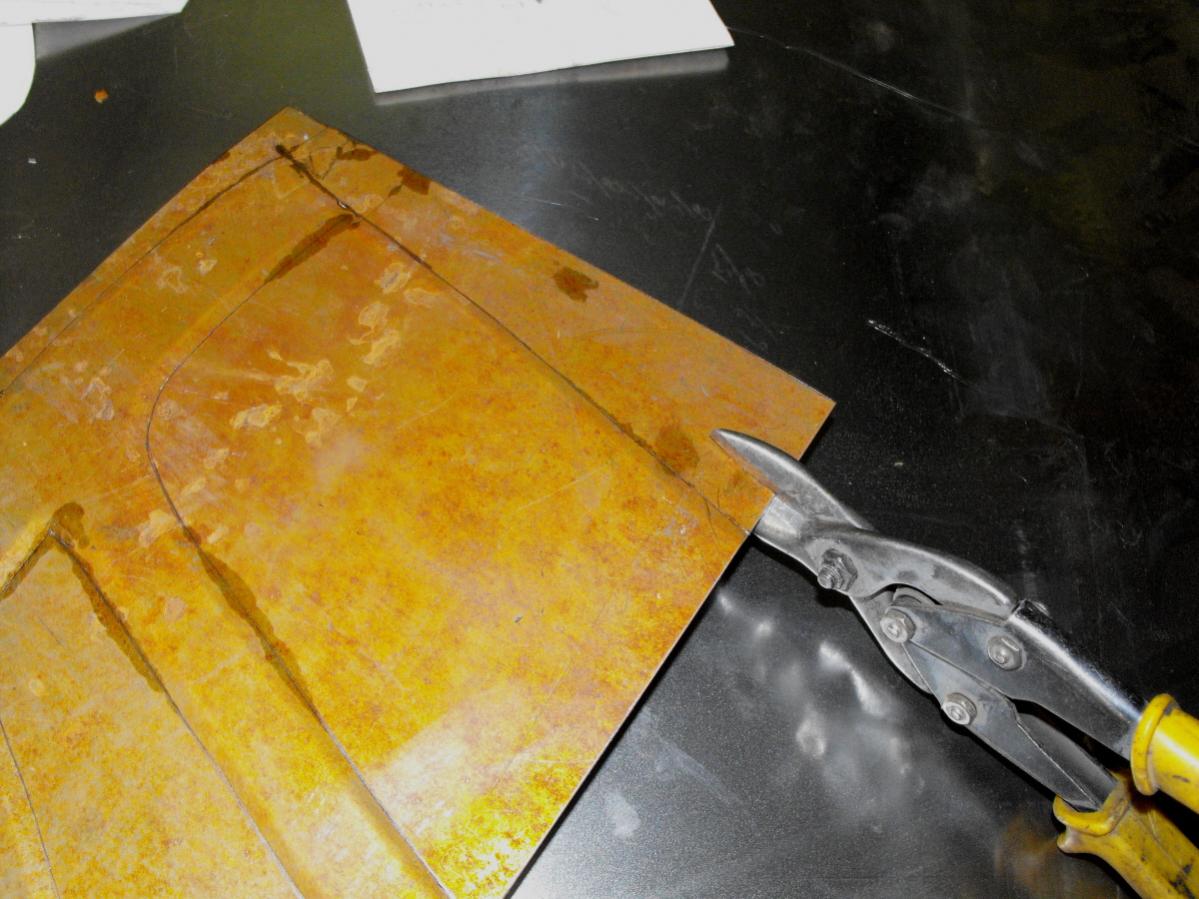

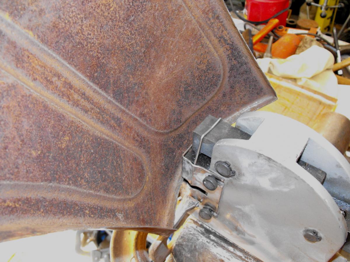

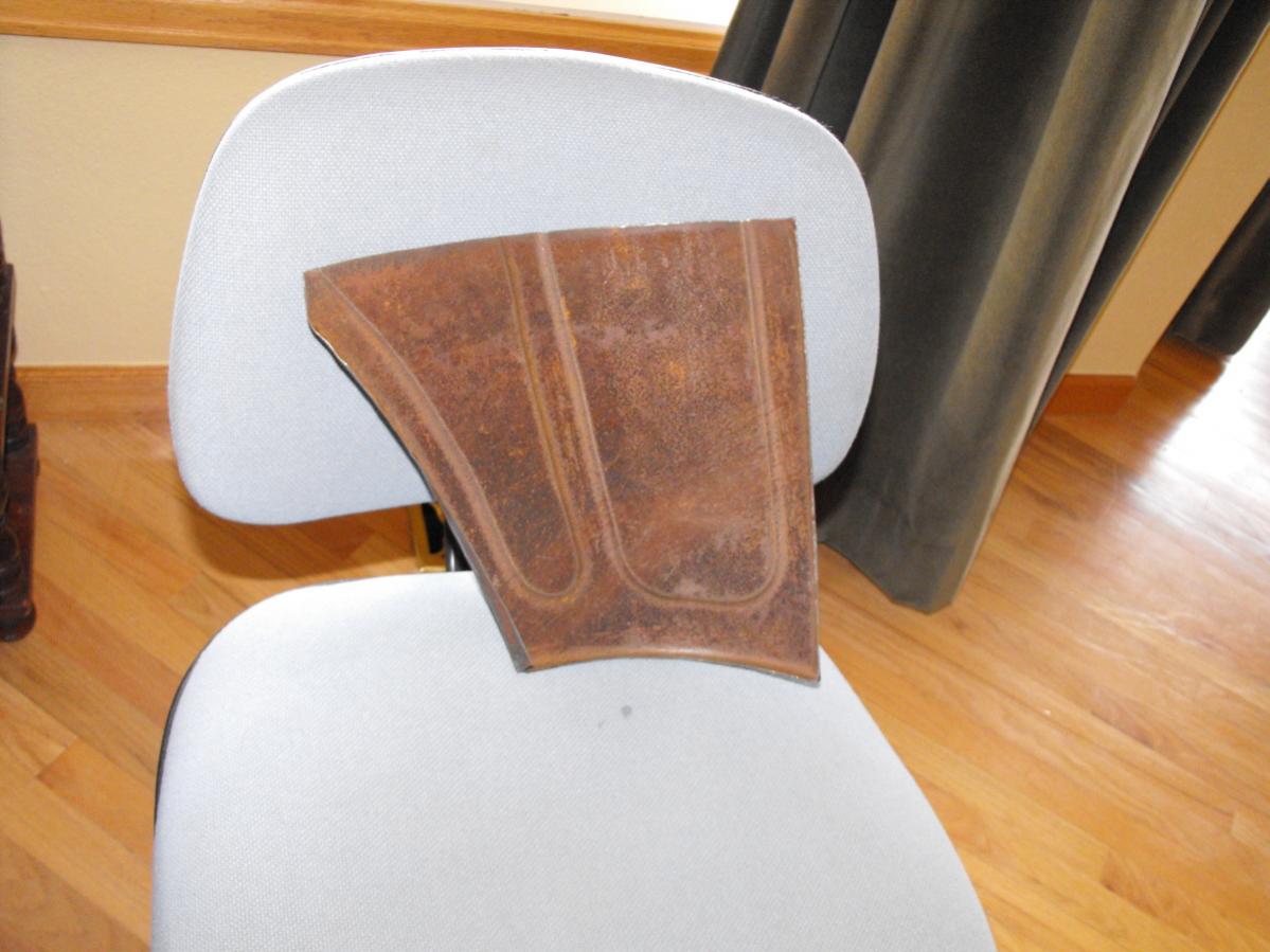

  26. tingeezer
    Posts: 207
    tingeezer
    from colorado

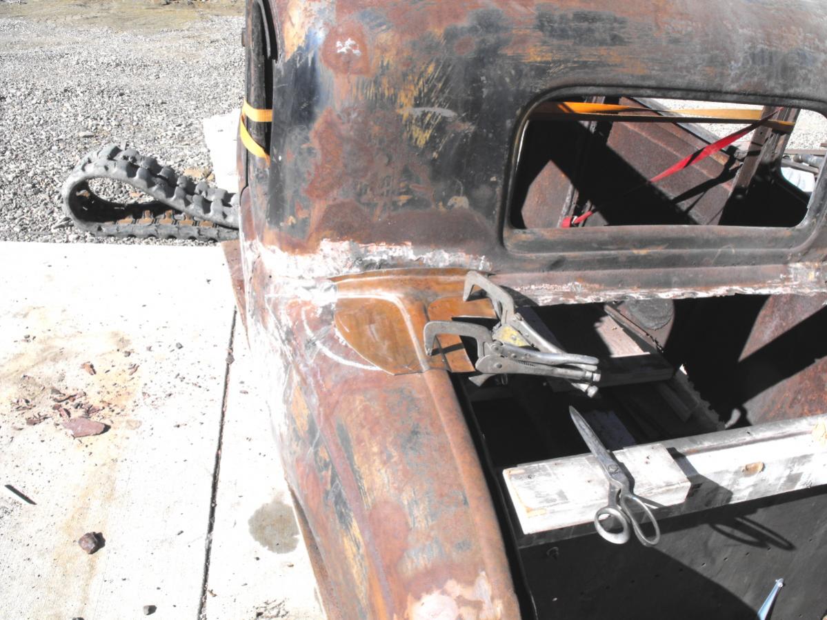

    This is how I made the corner shown, its not perfect but I think with a little more time on the pattern and the layout on the sheet metal, I think the finished piece would work just fine. Its a learning process anyhow.
