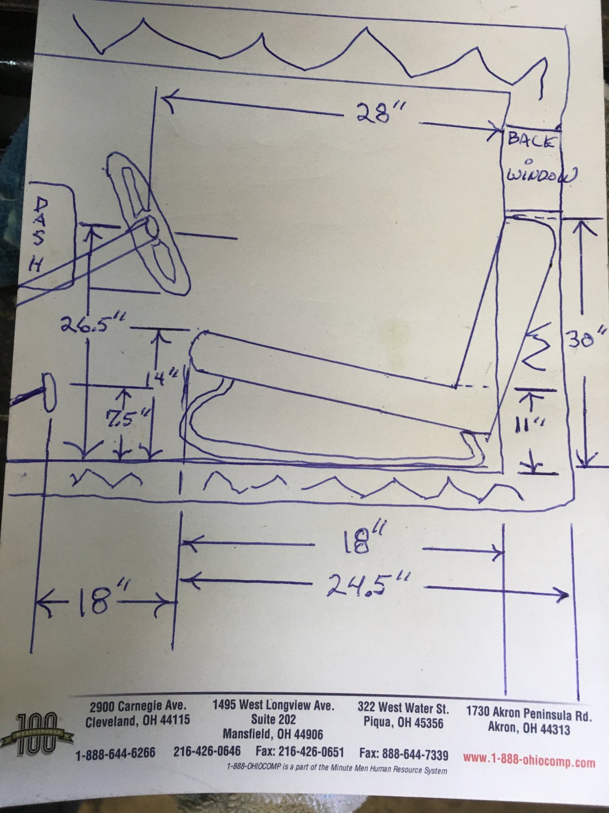

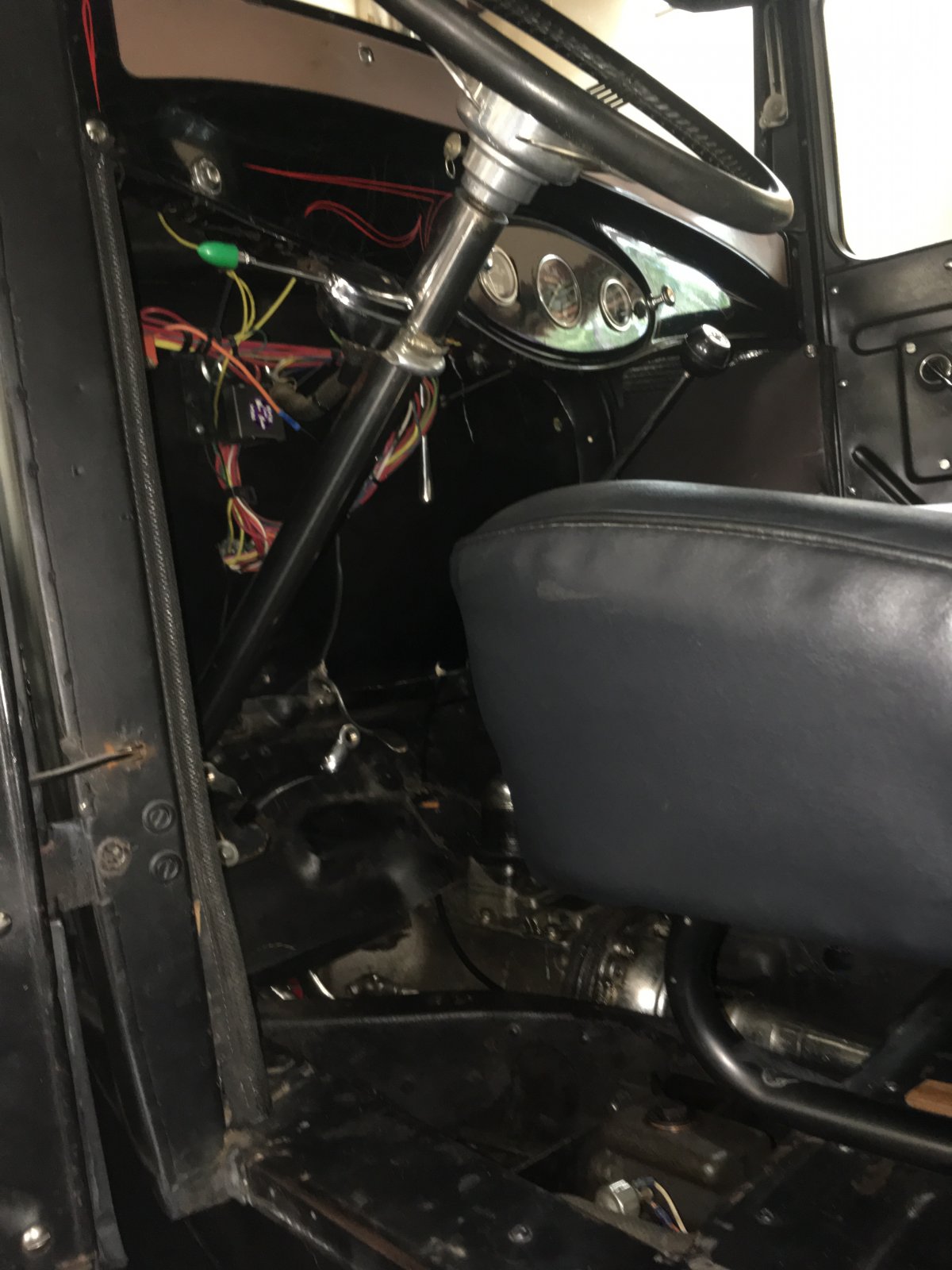

    Not a 32….
    But this may give you an idea of comfortable space distances.
    I’m 6’2” and 220. this is a very comfortable location with my 34 unchopped pickup.

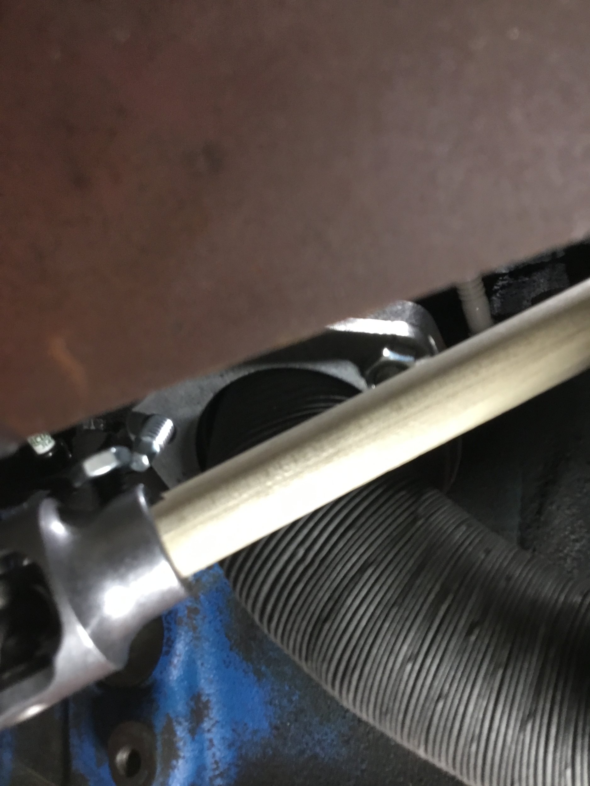

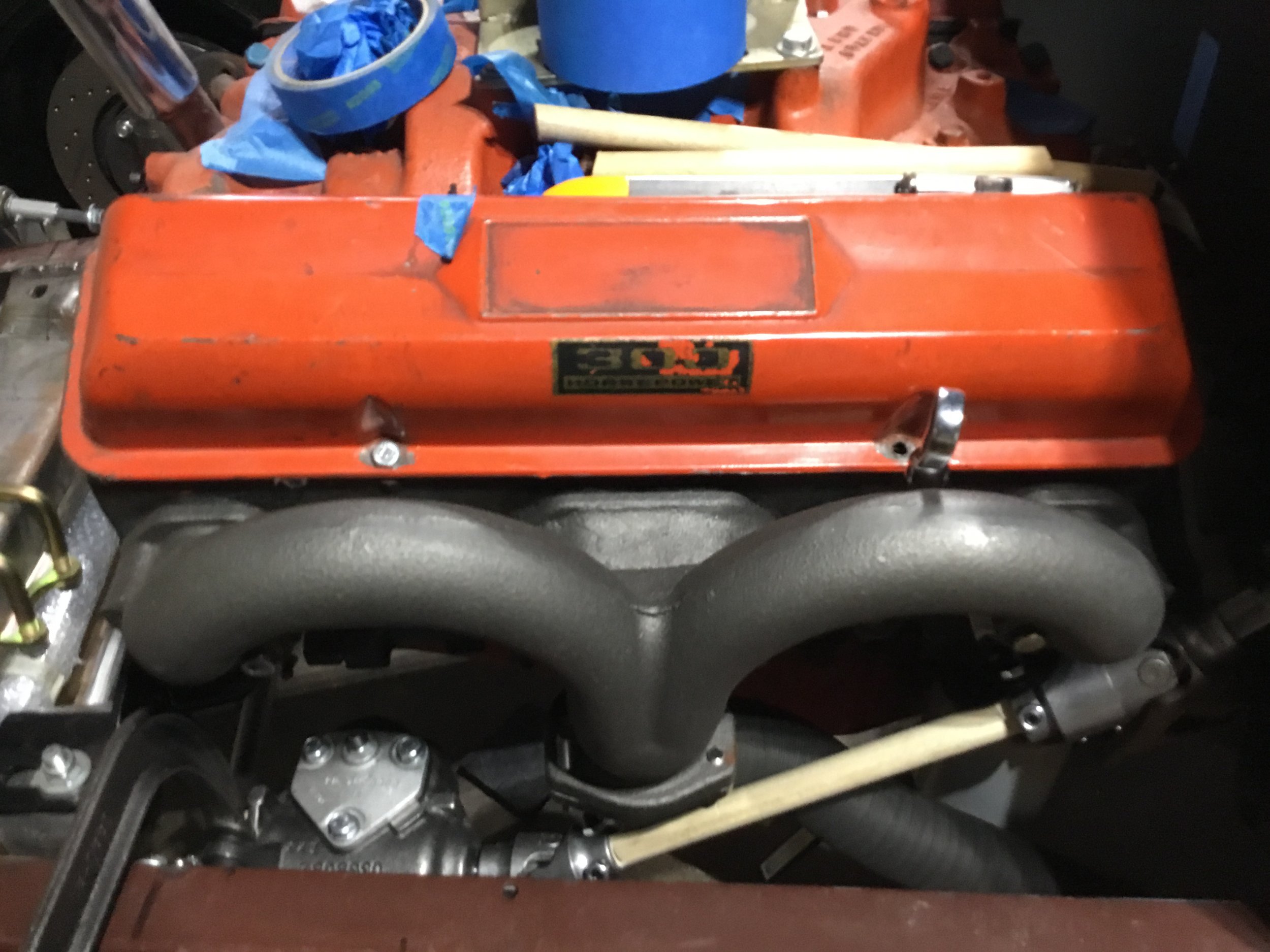

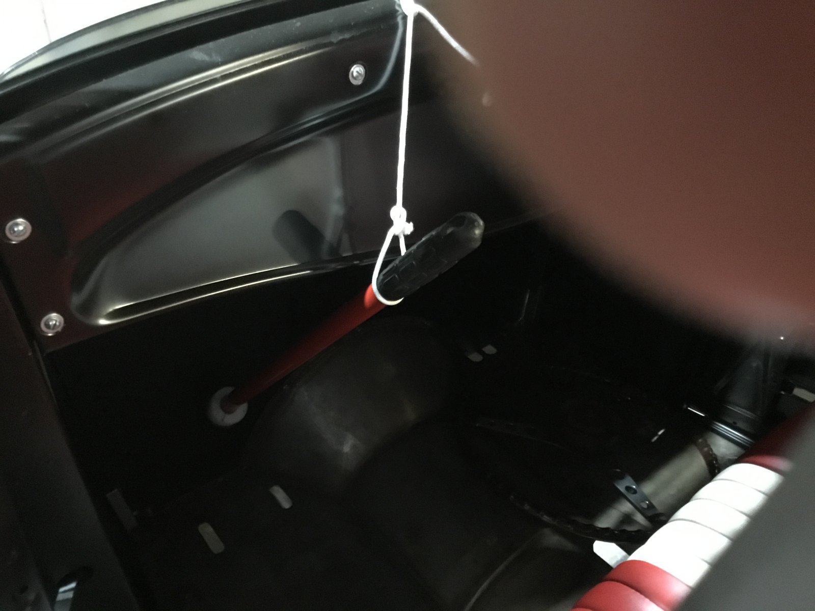

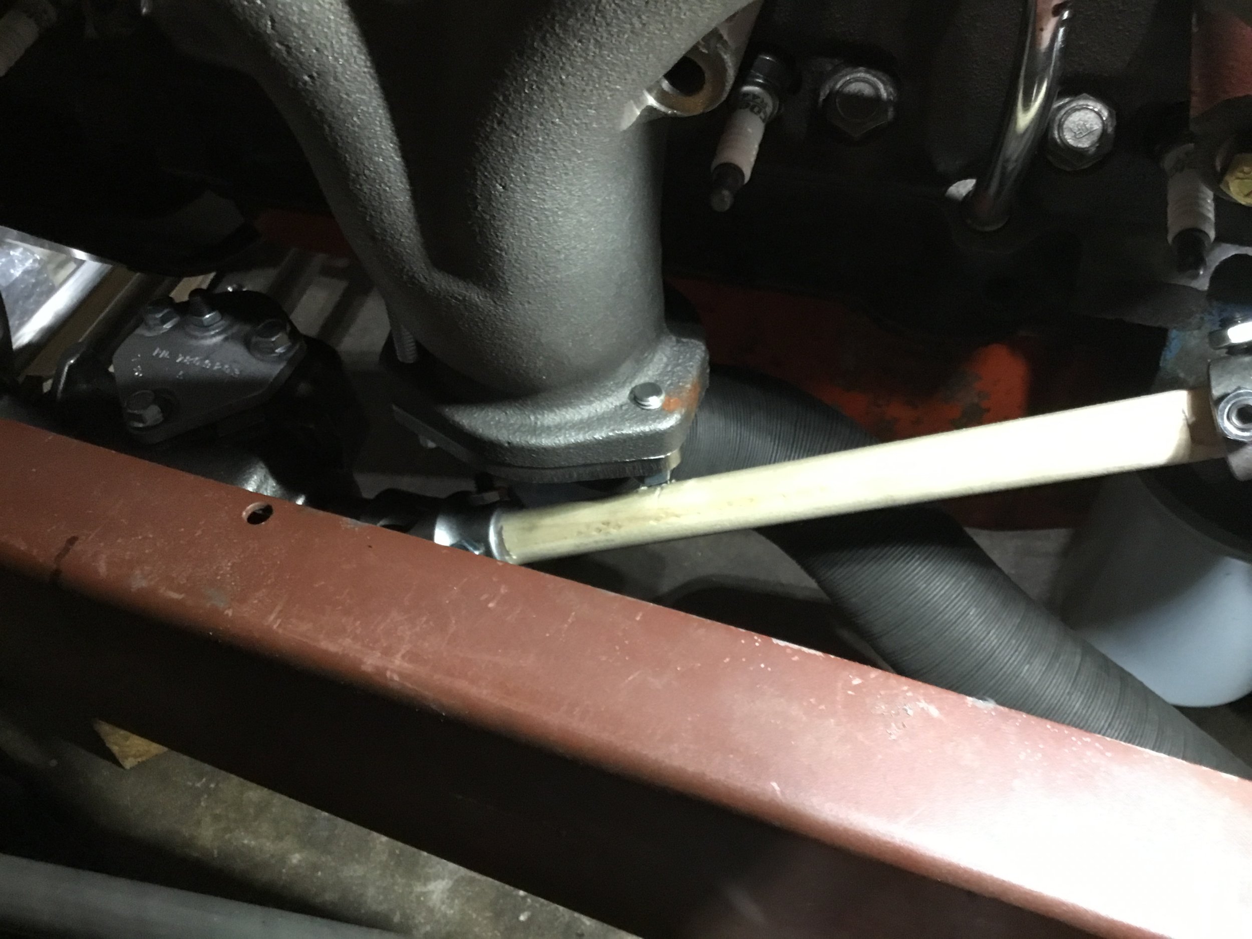

    Got my column in and am working on the connection from column to Vega box. I have run in to the age old problem of intermediate steering shaft interference with exhaust manifold. I dropped the steering box bracket as low as I thought (lower than P&J instructions) should be and it’s going to be marginal for clearance. I wanted to use the ram horn manifolds for a traditional look and avoid the problems associated with tube headers. Any suggestions or advice would be appreciated.
  8. 19Eddy30
    Joined: Mar 27, 2011
    Posts: 3,451
    19Eddy30
    from VA
    Is this a channels body?
    Not my build ,
    But I see a few options,
    First your column where it comes through the firewall is way too high,
    Lower & adjust your column drop to get the right angle that fits your needs and comfortable,
    Sweet are the smallest D-Ds in diameter.
    How much is D-D rod or joint hitting your exhaust,
    You can turn the D-D rod down if only touching about 1/8 - . 175 thoe, or half moon exhaust pipe, (dimple)

    Got back to work on my steering shaft clearance problem. I wound up using 3 joints with a heim joint bearing and moved the intermediate shaft toward the frame rail in a v shape. Then I used some 2 1/2 mandrel tubing to shape around shaft. So it’s possible to use the larger flow tech manifolds and 2 1/2 inch down pipes. Now on to the next.
