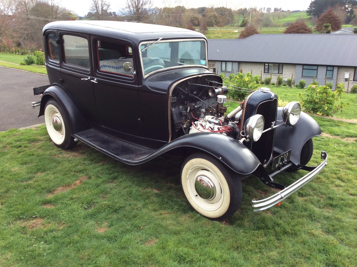

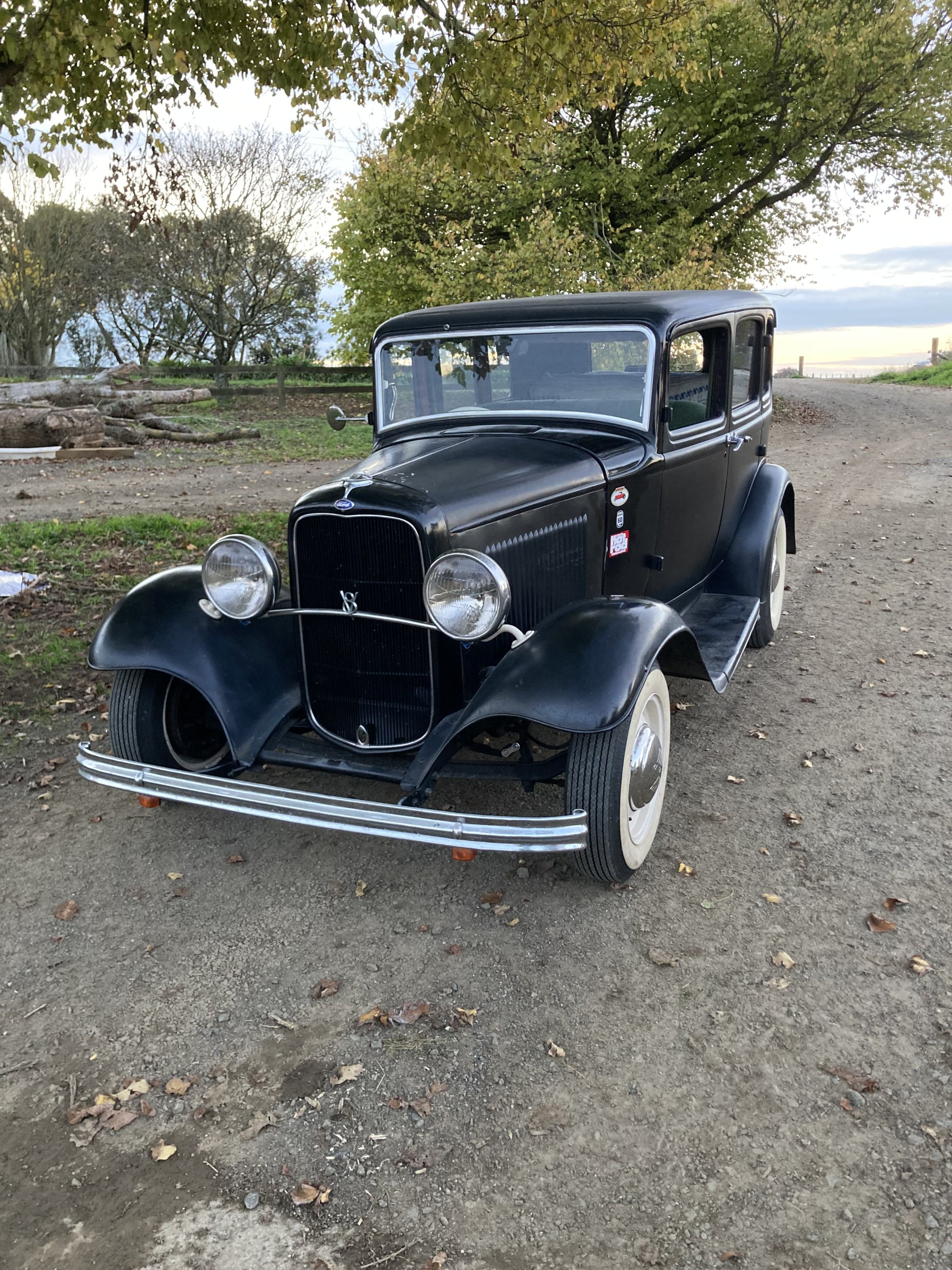

    IMG_2947.jpeg IMG_4428.jpeg I turned my peep mirrors into door hinge ones. ( didn’t trust the clamp type fitting and thought it would eventually vibrate loose and fall off).
    Then went to the long arm peep mirrors (still mounted to the hinge) as the J shaped arm held the mirror too close to the body and you couldn’t see enough for them to be helpful.
    took the door off, shaped the mirror with a plastic grinding disc to follow the contour of the door hinge, drilled a hole to line up with the mirror and a bit of lock***e and now a permanent fixture.
    Original version bottom photo, now has the long arm mirror which looks a lot better.[/ATTACH]
    swan neck mirrors is another option, but can look a bit street rod like.
    hagan hot rod mirrors have had some good comments on here, but I don’t have any experience with them.
