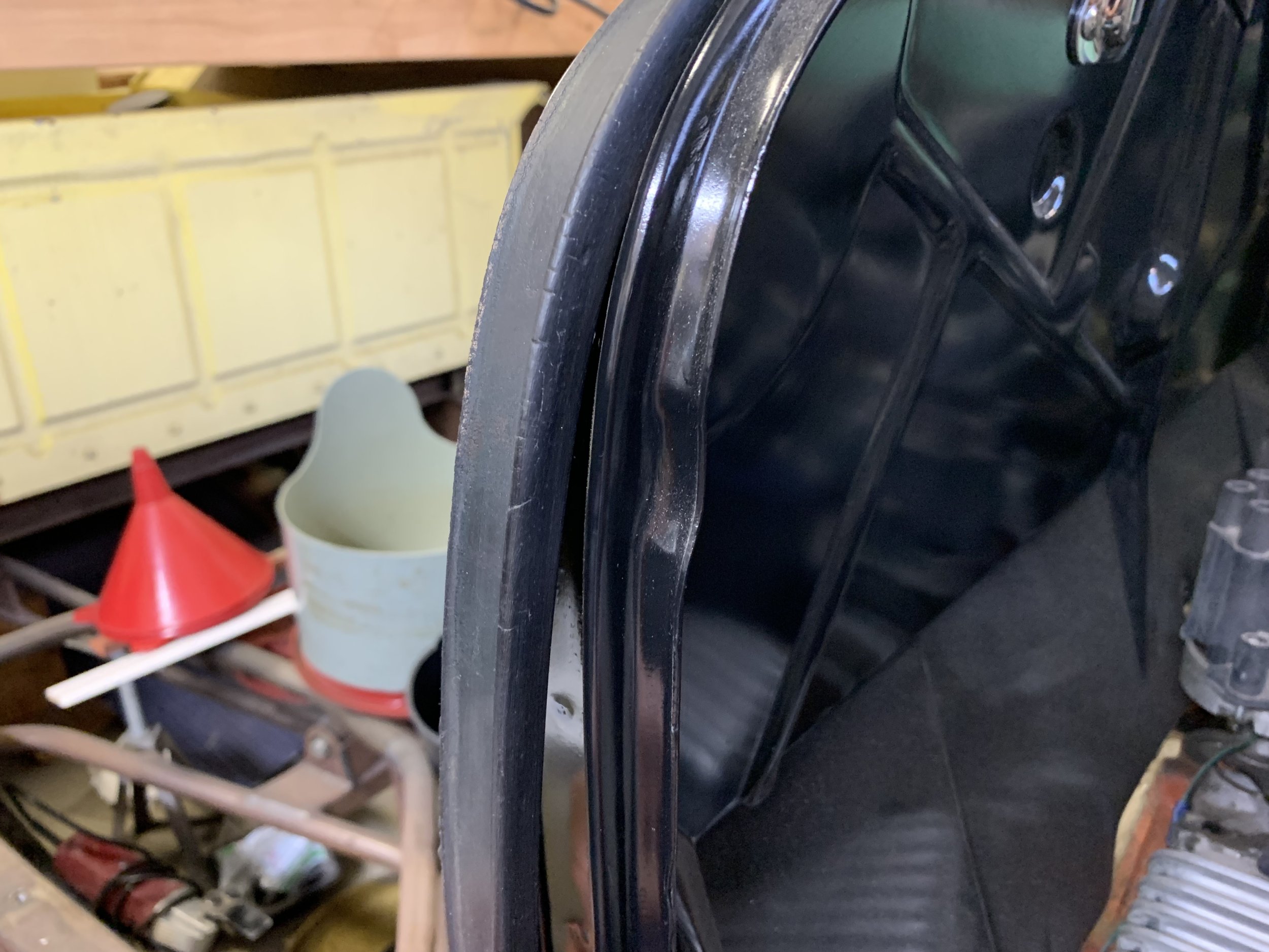

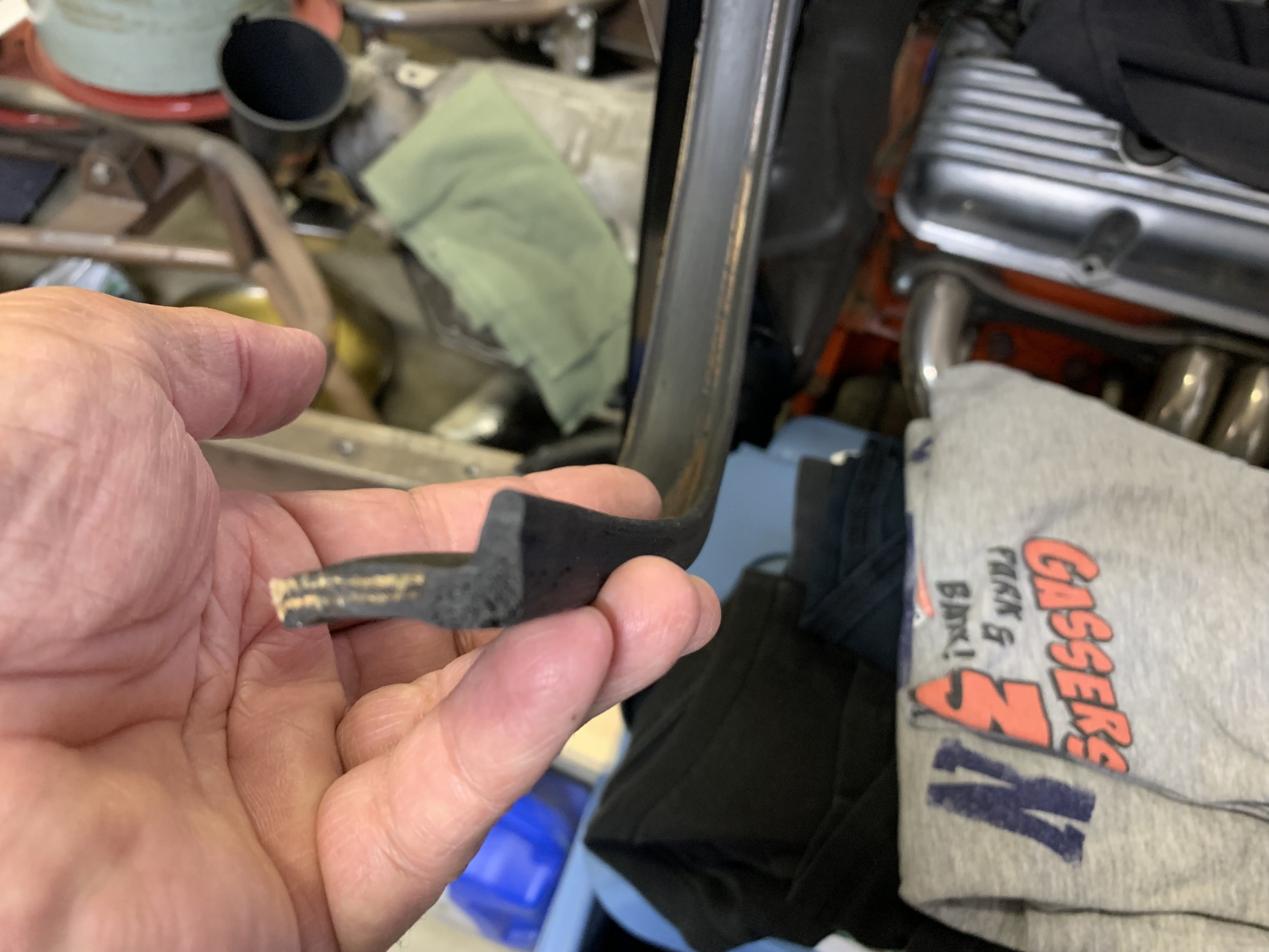

  5. Johnny Gee
    Joined: Dec 3, 2009
    Posts: 14,205
    Johnny Gee
    from Downey, Ca
    HI85WH1 likes this.

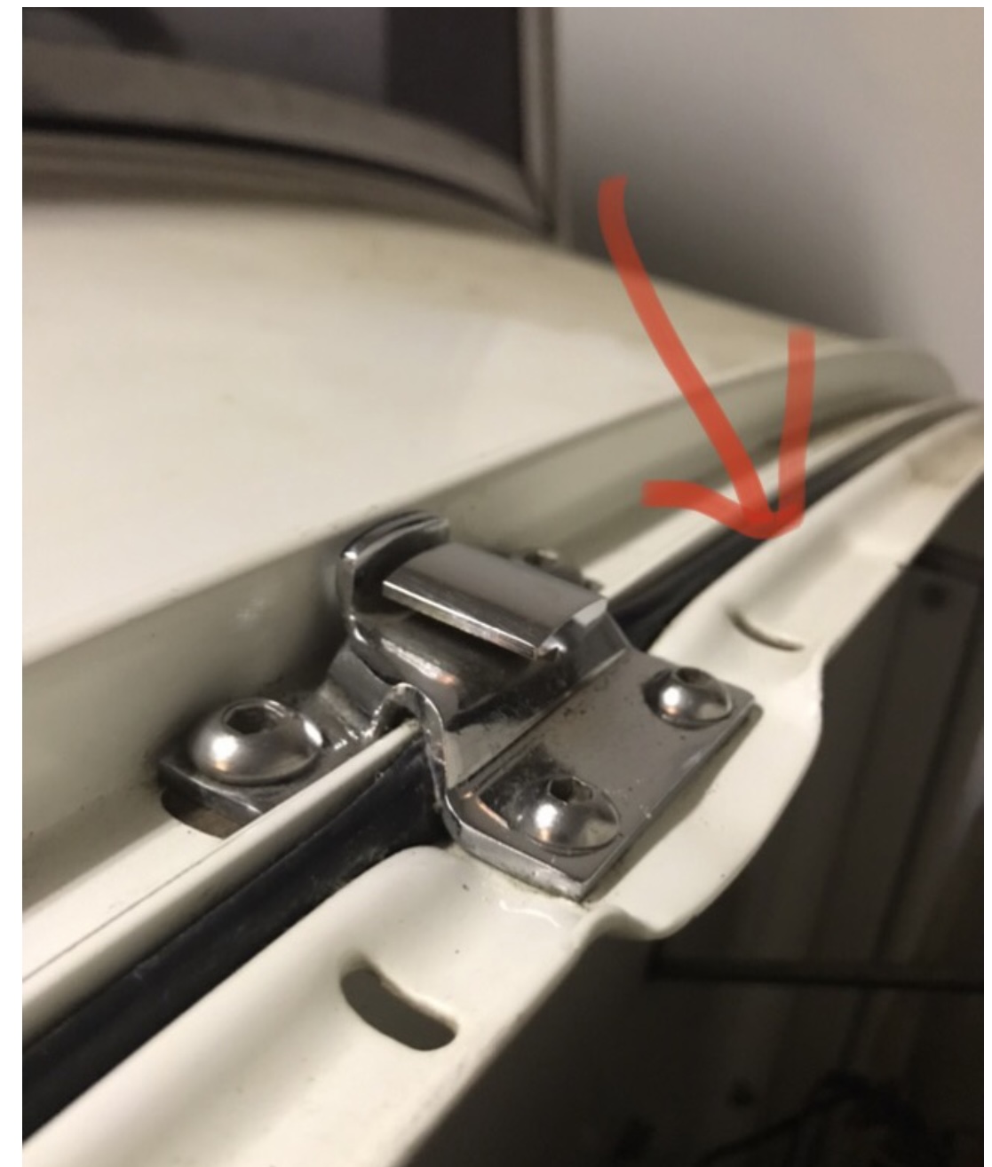

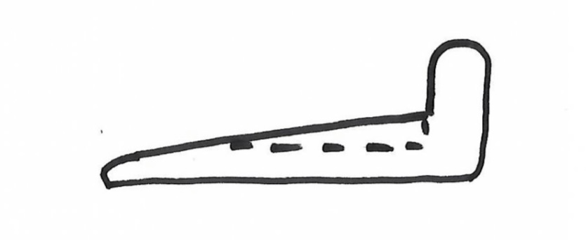

  6. Fordors
    Joined: Sep 22, 2016
    Posts: 6,411
    Fordors

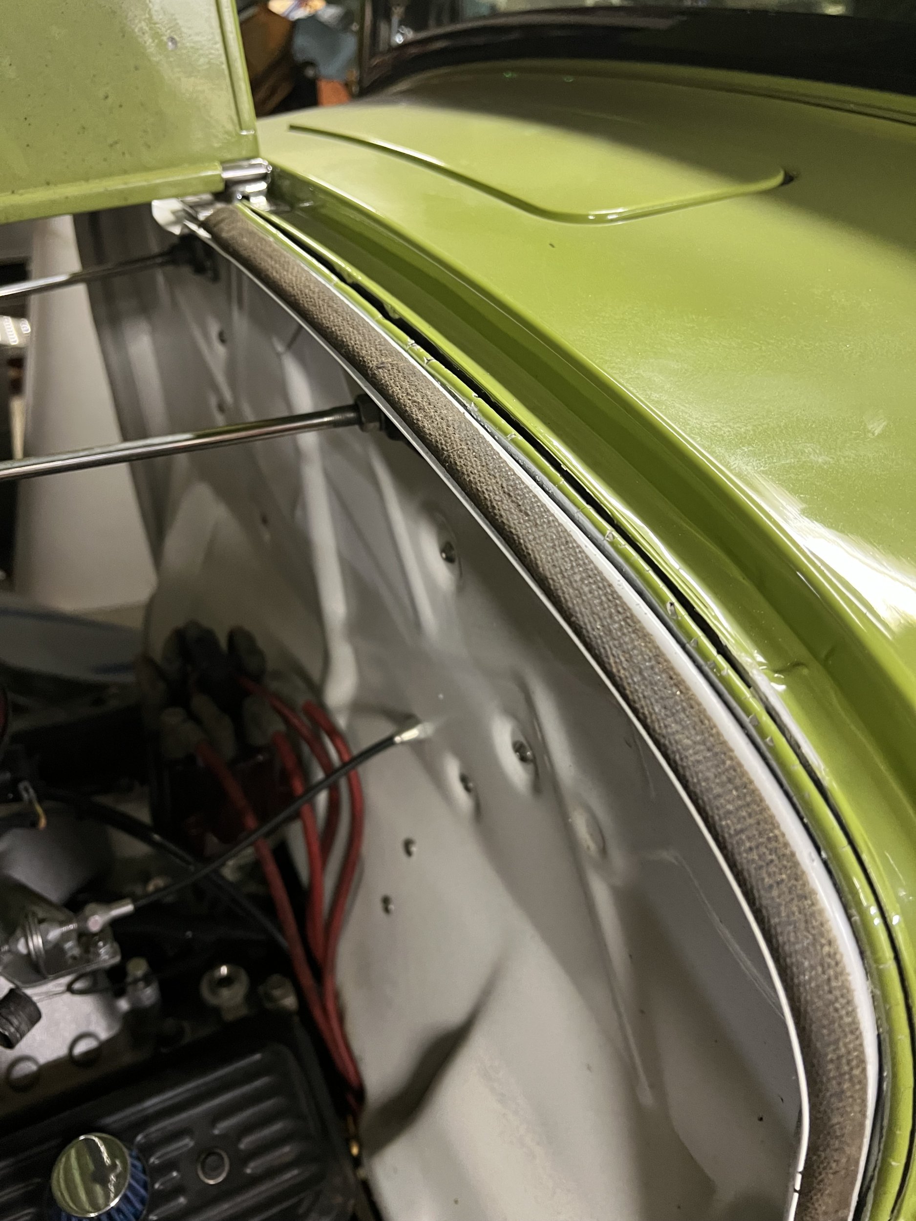

    Here’s a photo of the firewall seal (at the red arrow) in its position, the shallow trough at the front is where the hood lacing goes.
    Some reproduction seals have a heavy taper molded on them that may need sanding to fit properly.

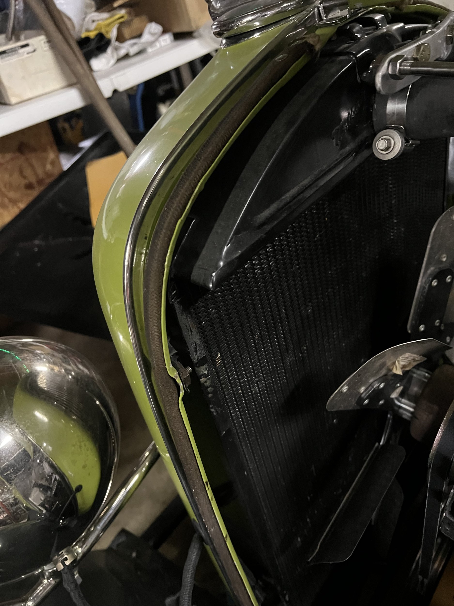

  7. 19Eddy30
    Joined: Mar 27, 2011
    Posts: 3,753
    19Eddy30
    from VA

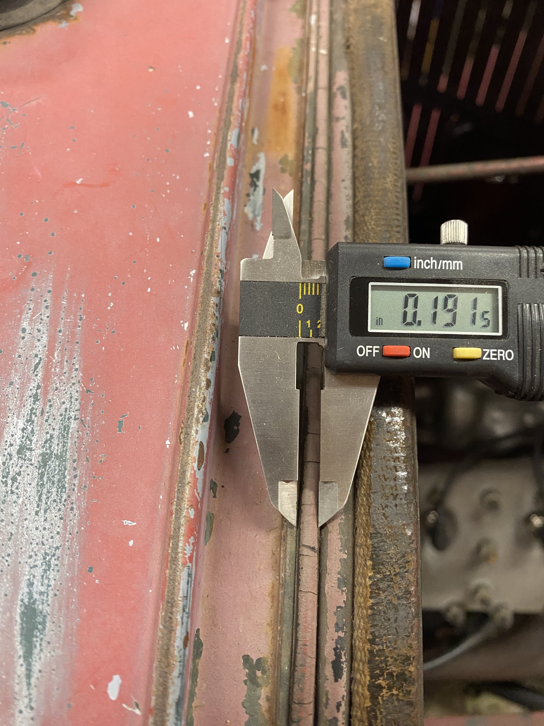

  8. alchemy
    Joined: Sep 27, 2002
    Posts: 22,546
    alchemy
    I was wrong, about 3/16”. Excuse the red paint on the original rubber.
    Just Gary, HI85WH1 and rod1 like this.
