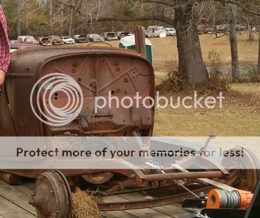

    Hi ,
    I'm looking for a pic of an all original firewall where no extra holes are drilled.
    I have one with many extra holes and want to know which ones i have to weld up.
    I don't want a smooth one so i like to keep the original ones.
    TIA
    Michael

    Get the repro book of '32 Ford service bulletins--excellent pics. Also, buy Bob Drake grommet kit...shows what goes where B and V8, every hole detailed.

    Except for the three holes over by the data plate this one appears fairly unmolested. Now, I'm just guessing on those holes, i have no firsthand knowledge of '32 firewalls.

    hey got anymore pics of this thing, looks to be an early 3w rod with the roof cut off

    I've filled 64 in mine so far.

    Mine does not have the 2 big holes below and to the right of the patent data plate next to the stiffening rib.

    Here's mine. Obviously the big hacked out one shouldn't be there, and the two either side of the hacked one. Note sure about the one at the 5 o clock position to the big one, though.

    tommy
