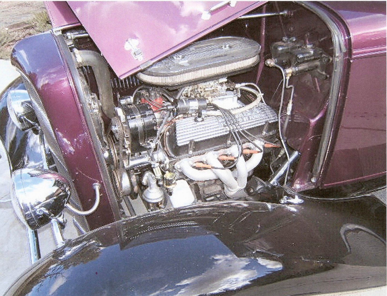

  4. The '32 Ford is the only car with a removable firewall, being able to set up the engine and transmission with the firewall sitting on the frame makes doing so one of the perks of owning a '32,
    Depending on the engine you may have to modify the lower portion of the firewall, this is a photo of the firewall in my '32 pickup after I modified it. HRP

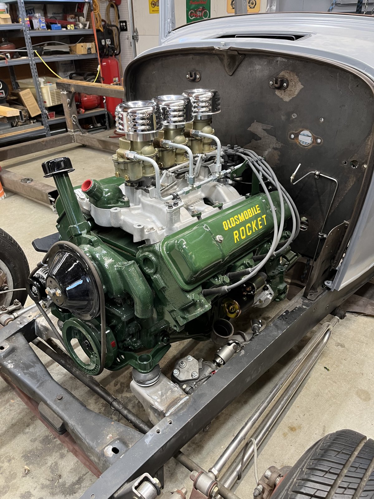

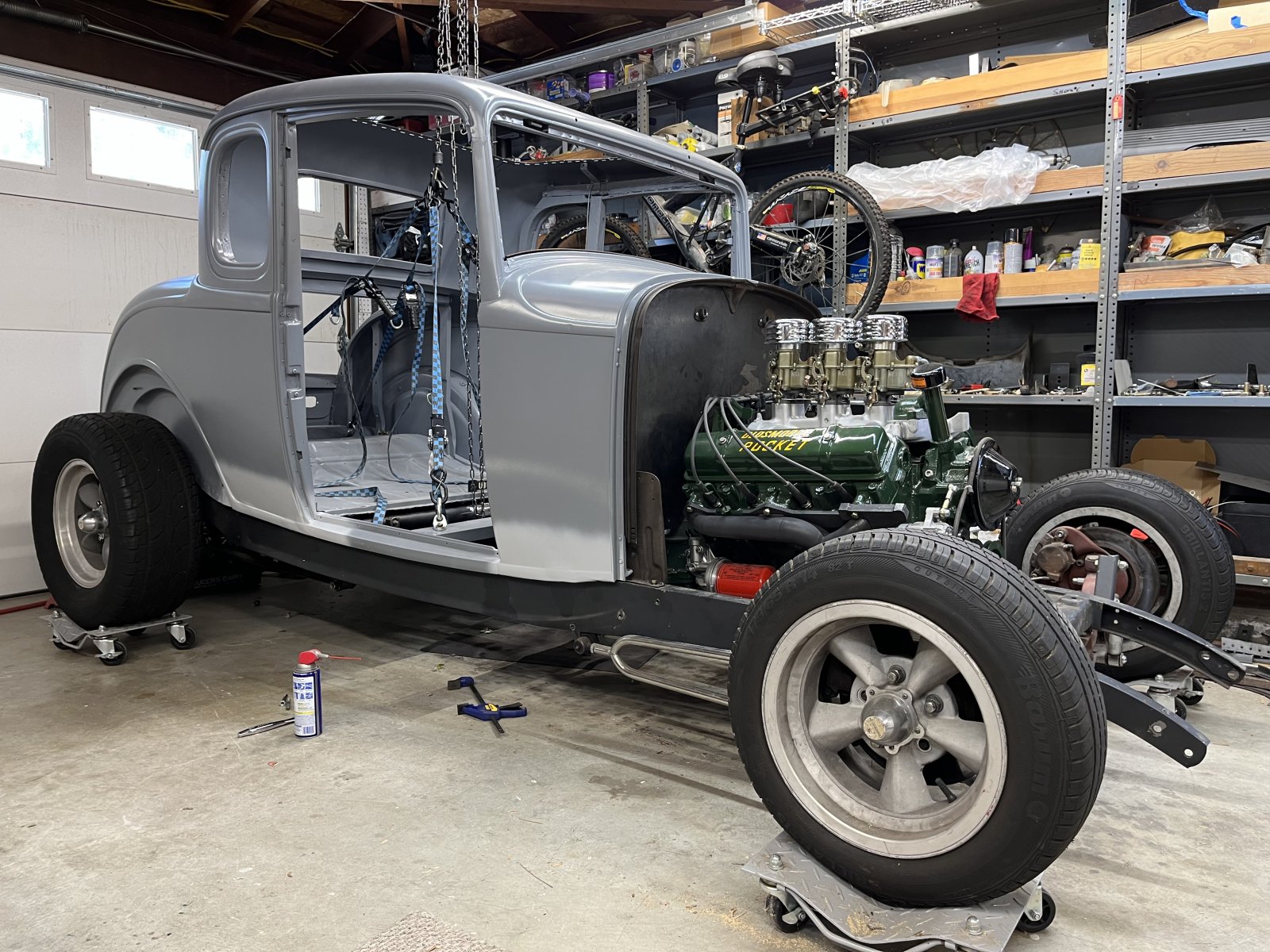

    Here’s a firewall I’m working on today. It needed a recess to clear a 409, but it retains all the stock feet and a majority of the ribs and dimples. It will mount to the frame and body just as Henry did it.
    oliver westlund, 325w and ekimneirbo like this.

  19. I like the picture of the one Alchemy is doing. I’ll never redo mine but if I did I’d copy his!
