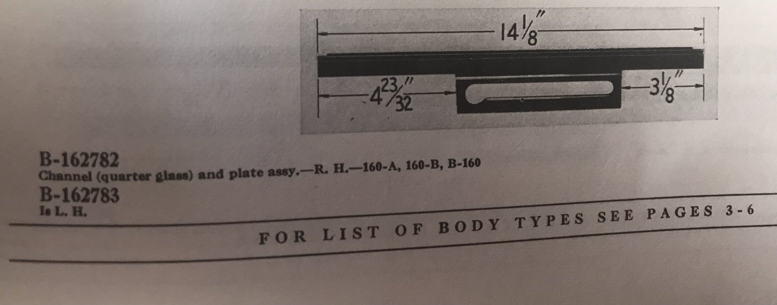

    Here are dimensions for the ‘32 quarter gl*** channels. You might consider other years that you could cut and the best place to get some ideas is in this book.
    dwollam, RICH B and alchemy like this.
