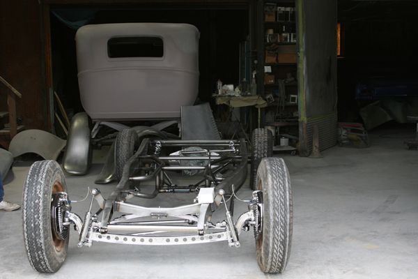

    If your looking to buy your own frame rails and build the frame yourself. Go with a set of ASC rails. Thats what I used...

    Kennedy, your car rules.

    What are the tire size you have there on that there Coupe? .........................:D

    The Engineer
    what rear cross member did you use in this frame? I love the way it sits....:D
