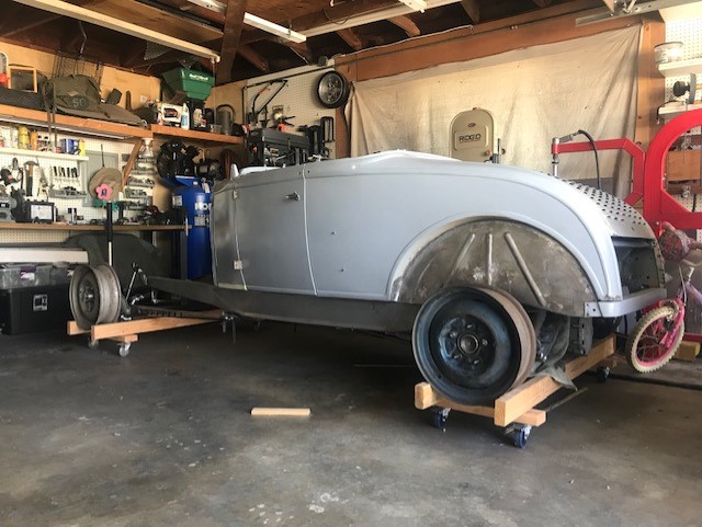

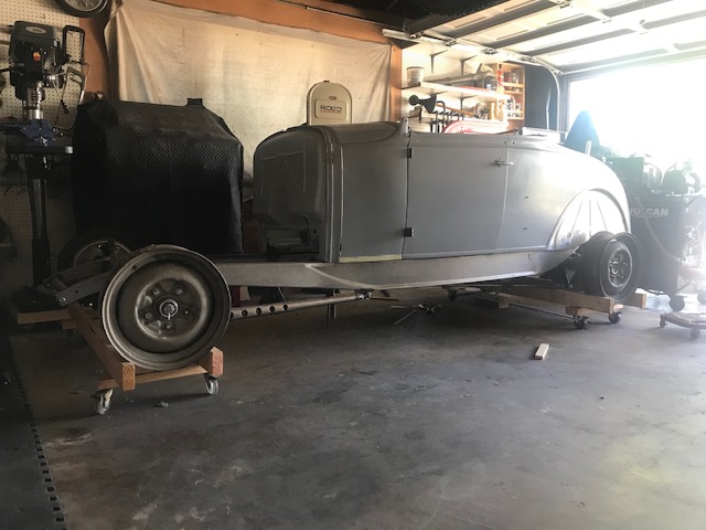

    Body is mounted and fully secured. Thank you for the advice on the wood blocks; I hadn't though of that and simple enough.
    Glad to hear there is some extra room there.
