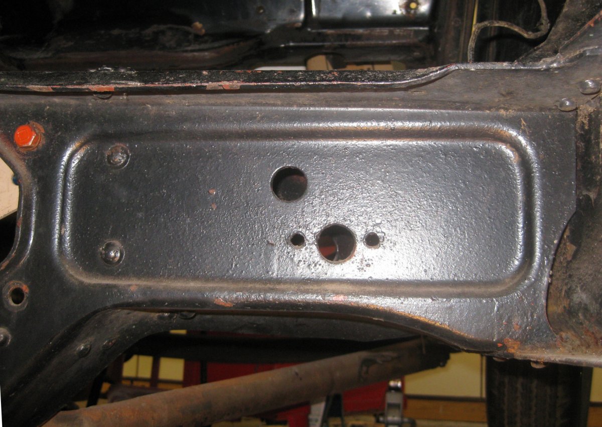

    there is an early front crossmember that is quite a bit different, but still accepts 4 cyl or V8.
  7. The early "B" (4 cyl) frames did not have the holes in the K-member for the V8 steady rods. These early frames usually also had the early front crossmember.
  8. Since people are bringing up differences with the early frames it might be good to know the serial number (use XXX for the last three digits).
    Charlie Stephens

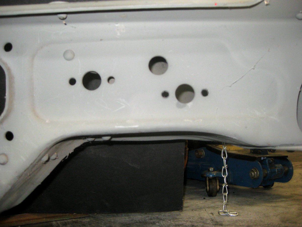

  9. K member V8_4205.JPG K member B_4205.JPG The K-member in the black frame in the attached photo is an early 4-cyl. The light grey one is the K-member of a later V8 frame
  10. To respond to Charlie's request, the serial number on the early B frame pictured is B-5006xxx. Later V8 frame pictured is 18-198xxx. So, the B is quite early and the V8 is quite late.
  11. It is interesting to note that the later frame was used for both the 4 and V8. The attachment for the 4 cylinder antichatter rods was retained when the ones for the V8 were added.
