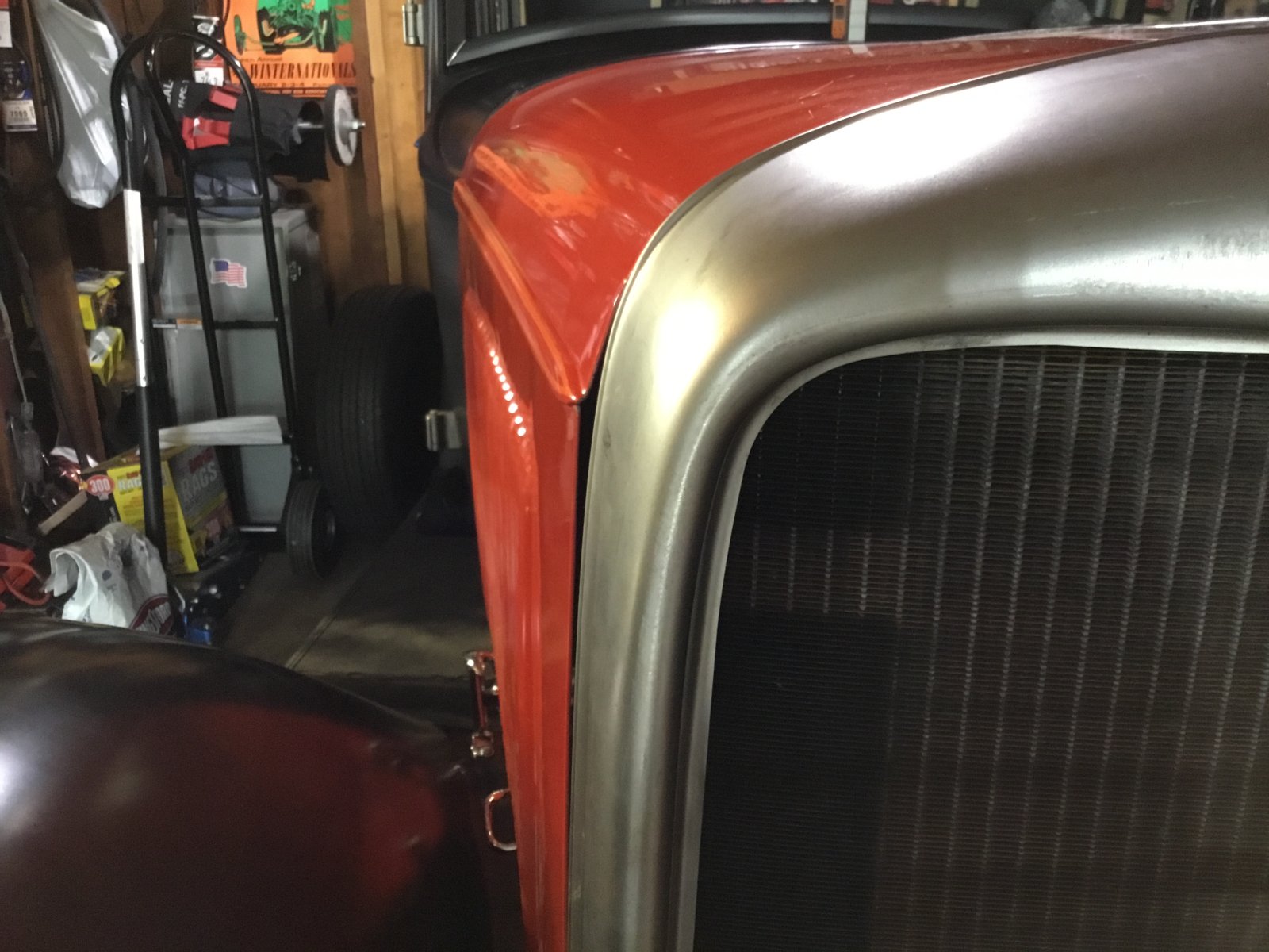

    I am now trying to adjust the hood and need some help. The rear bottom panel needs adjustment about .250. Any tips welcome.

    alchemy
    Raise your radiator and grille.

    Raise the grille shell x2
