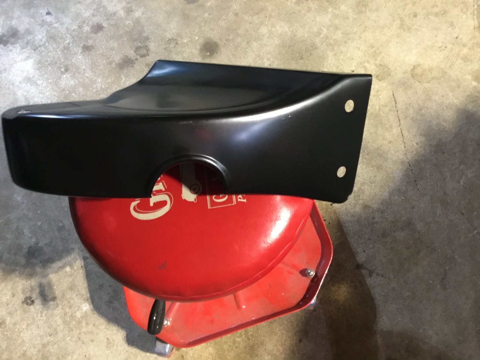

    I am continuing with my 32 mock up. I have got the front end on and I am mocking up the Vega steering. I am at the point I need to order a steering column so I need to establish the length of the column. I am going to use a stock 32 bench seat (see photo of the seat originally done in 1961 and in great shape). So I need some schooling on what it takes to bolt the seat in. Does the seat just set on the floor as is or is there fillers or brackets?

    There are rail sliders and adjustable ratchet type of mechanism. There are 4 5/16 fine thread bolt that bolts the slide mechanism to the floor. Depending on how original your floor structure is

    On a 32 five window, the seat was mounted on a pair of tracks and there was an adjuster for front to rear movement. UP has the tracks part number B20407 {2 needed) and the adjuster ratchet is B20405, the handle is B20406 and the bracket is B20403.

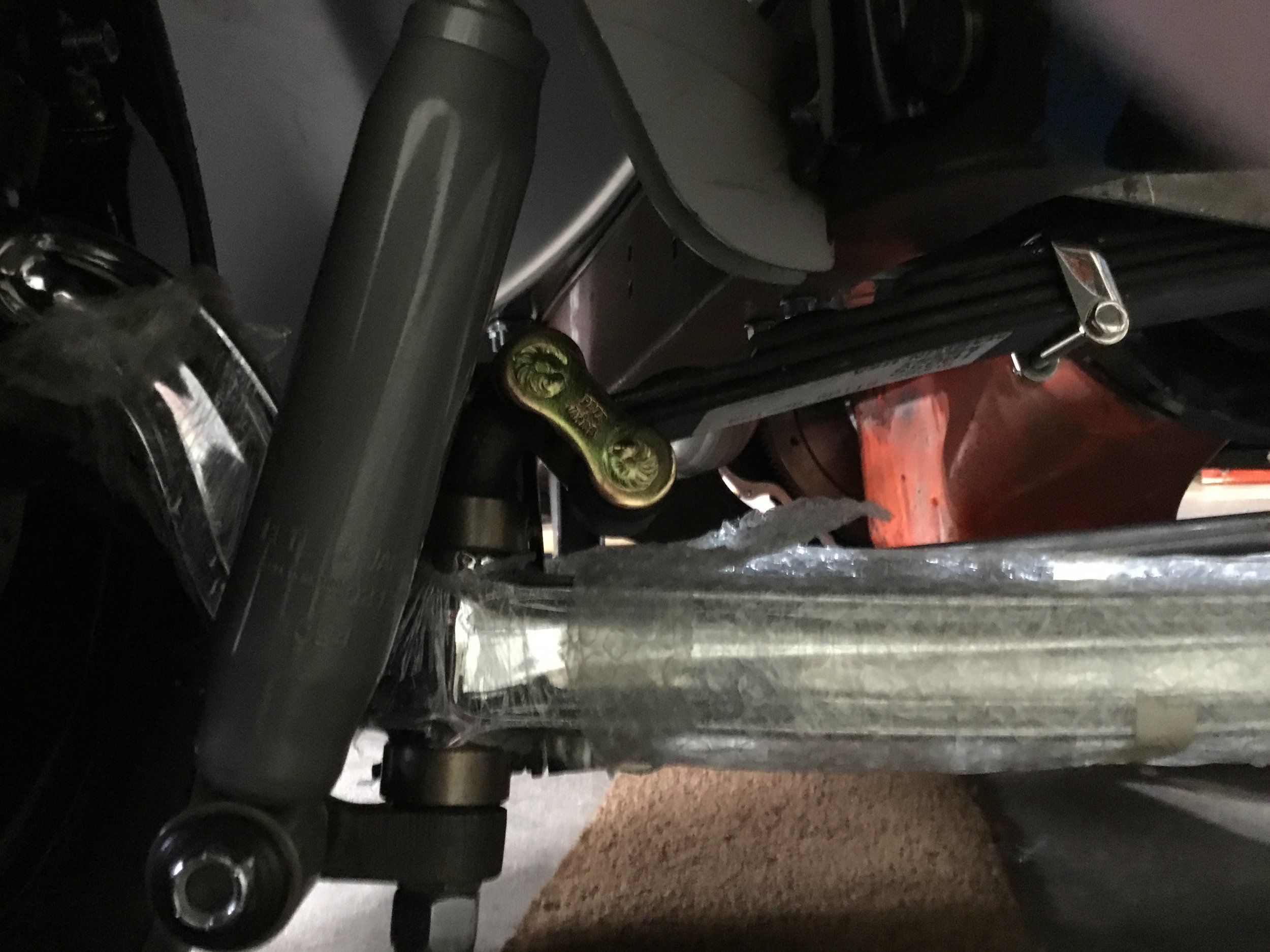

    Continuing the mock up on my deuce coupe making some progress but slowed down by a no fit problem with OE grill insert and Brookville grill shell but have a plan to fix that. I wanted to get everything mocked up before making it pretty. Anyway I need some advice on raising the front end 1 1/2 inches. I thought of a spacer/shim between the cross member and spring but not sure if that’s the best way. The front end is a Pete and Jakes setup with a 1 inch drop cross member and dropped axle. I thought I had it calculated correctly but missed it about an inch to low for the stance I want.

    Can we see a picture of the fearframe springs. Length width dia. Thanks

    Switch the reversed eye spring for a regular. That will give you an inch.

    Your standards are way different from the norm. I don’t see how the standard dropped axle and A style crossmember, without a reversed eye spring, could make your car too low. 99.9% of the guys with those parts are happy with them.

    I think most cars are being built with a nose down so called “California rake “which looks great but it’s not what I want. I want the front tire to be even with the front fender with no gap seen between fender and tire.

    How many leaves in your current front spring?

    Posies standard 7 leaf spring I didn’t remove any leaf’s.

    You mentioned a spacer above the spring. The easiest way would be to add two short leaves (8"-12") to the spring and add a longer center bolt. The compromise is a bit stiffer ride quality. An actual spacer is doable but a bit harder to execute. You would want the top to match the crossmember and the bottom the curvature of the spring. If you weld the spacer to the crossmember you just need a hole on the bottom to capture the center bolt. If you don't want to weld it in, I guess you could either have a pin on top to replicate a center bolt top or drill the spacer through and get a long centerbolt and bolt spacer to the spring.
