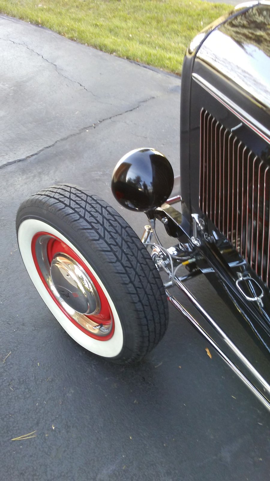

  6. HOTRODPRIMER
    Joined: Jan 3, 2003
    Posts: 65,117
    HOTRODPRIMER
    Old School style. HRP
  7. HOTRODPRIMER
    Joined: Jan 3, 2003
    Posts: 65,117
    HOTRODPRIMER
    Shock mount. HRP
    Just Gary likes this.

    You’ve probably already cruised the deuce threads for pics, but the easiest solution if you use smaller king bee or dietz lights is to use the upper shock mount location (shown above).
    If you use a frame rail mount style, just watch how far back you put it. You can run into interference with the back of the light bucket on the shock mount or your hood sides when opening them.

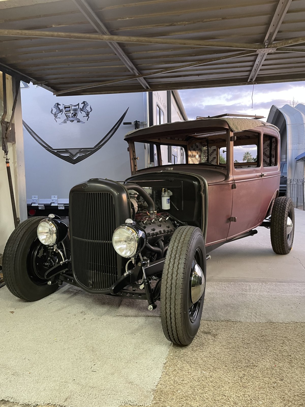

    I’ve only done a few 32s, but always seem to end up using frame mounts and putting them in the same spot. Here’s a pic for reference. Sorry it’s not a 3W.

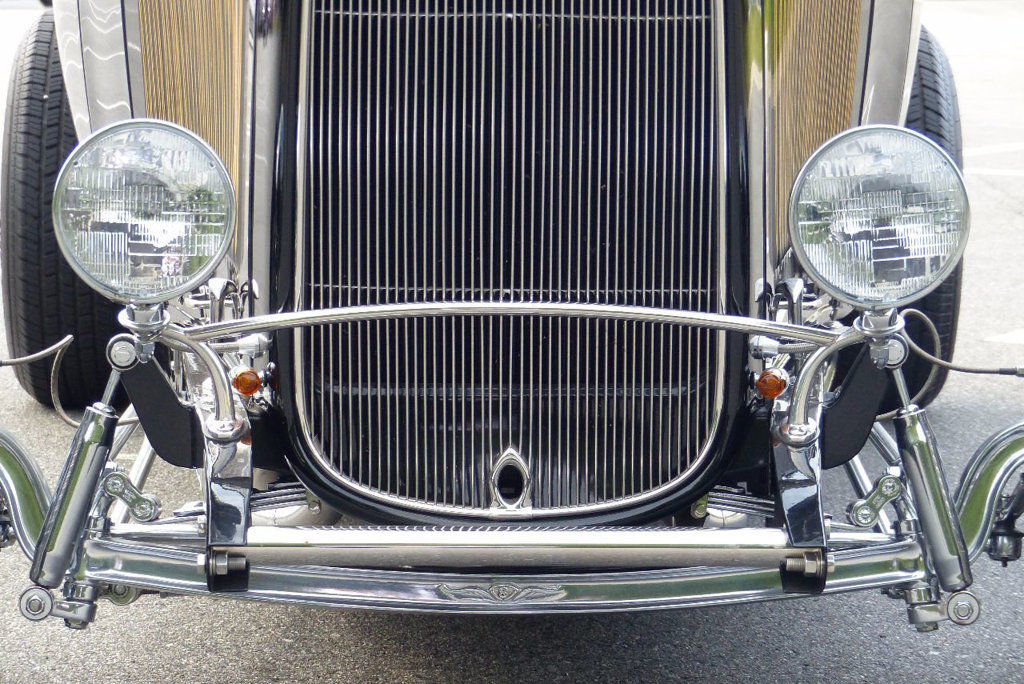

  18. ramblin dan
    Joined: Apr 16, 2018
    Posts: 4,143
    ramblin dan
    This to me is an interesting topic as it changes the entire appearance of the car. Here's a few pics I've c ;po.jpg 3 wind.jpg 32 1.jpg 32 shocks mounts.jpg 1932-5-window-coupe-hot-rod-24.jpg dfeg.jpg front end.jpg ollected over the years.
