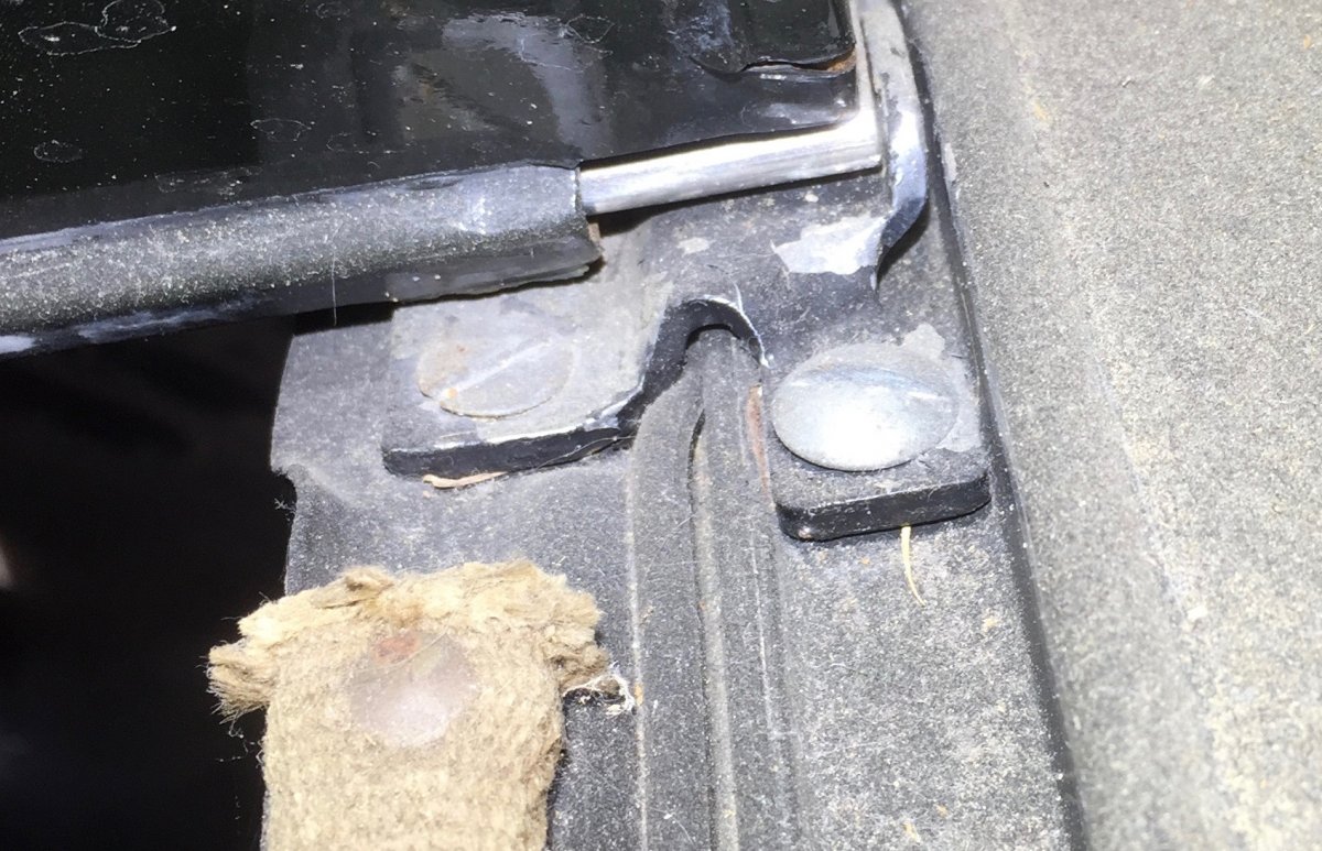

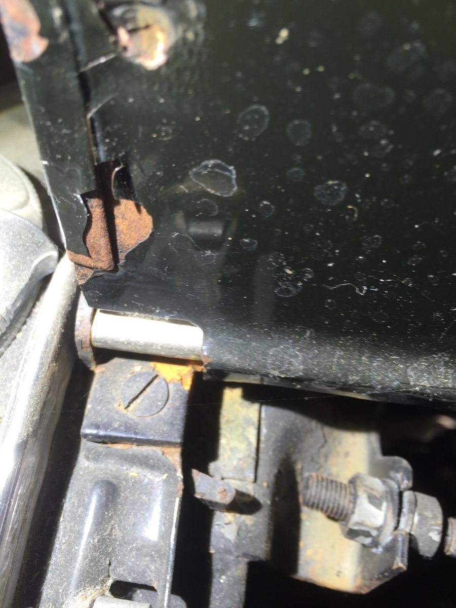

    hello could someone please post pictures of the 32 ford hood brackets on their car. I am building a highboy roadster and trying to fit the hood and I need a little information on how the hood fits the brackets and how to put the hood on the car engaging the brackets. Thanks in advance for any help.

    Yes I know what the brackets look like. Maybe my post was not clear I would like to see pictures of them on the car and how they fit into the hood. pictures please.

  9. Find a friend, it really takes two people to put the hood on if it has final paint. Start by installing the front and rear brackets without the hood. Measure the length of the center hood hinge and adjust the radiator support rods to put the correct distance between the two brackets (plus about 1/8 inch). If you can’t get the correct spacing remember that the V8 and 4 cylinder radiators took different length radiator support rods (and reproduction radiators may have been something else again). Remove the front bracket. With the help of a friend put the hood over the engine and slide the hinge into the rear bracket. Slide the front bracket onto the hinge. Open one side of the hood and install the screw for the bracket. Go to the other side and install the other screw. As an alternative install the front bracket, remove the radiator support rods and tilt the radiator forward to allow the bracket to slip into the hinge. Reinstall the radiator support rods and make final adjustments.
    Charlie Stephens.
