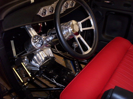

    here is my build if any interest ill post more .....belive me i love rusty but this one is a old style hotrod but clean

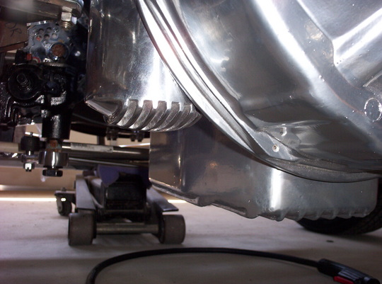

    ch***is......

    Who ever said "rusty" was cool? A nice car is a nice car,doesn't matter if it's painted.
    Looks pretty ****in awsome,to me. More pic's please!

    Dig it. I really like the little details. Especially the shifter. Get ti done and destroy some rubber.

    Very nice!! I also dig that drilled shifter handle... and the fact that you'll have 3 pedals!

    That looks damn good. Its great to see that you are going with a manual transmission. Keep up the good work

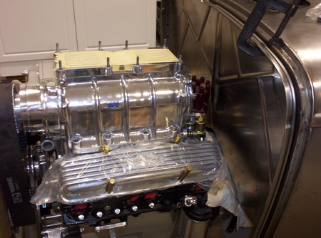

    <TABLE id=HB_Mail_Container height="100%" cellSpacing=0 cellPadding=0 width="100%" border=0 UNSELECTABLE="on"><TBODY><TR height="100%" width="100%" UNSELECTABLE="on"><TD id=HB_Focus_Element vAlign=top width="100%" background="" height=250 UNSELECTABLE="off">little update the ch***is is just about ready for the body and then a couple weeks later it should be haulin *** down the road ......cant wait!!!!!
    the engine is a 355 with world heads , blower cam and pistons , steel crank and hd rods , the blower is a bds 671 with demon supercharger carbs , the trans is a m21 , rear is a 3/4 ton winters quickchange with 374 gearing , exhaust is sanderson jaysters with larger primary tubes and down pipes under car with bullet mufflers , wheels are salt flat specials by american . gauges are autometer old tyme series . body is made by brookville ...

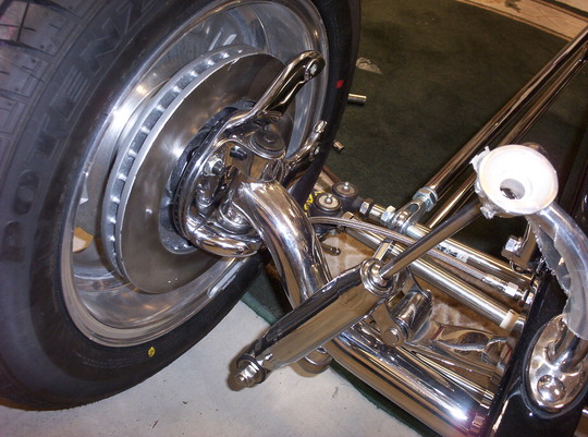

    I like the idea of brakes that match the power of that mill great job!!!!

    <TABLE id=HB_Mail_Container height="100&#37;" cellSpacing=0 cellPadding=0 width="100%" border=0 UNSELECTABLE="on"><TBODY><TR height="100%" width="100%" UNSELECTABLE="on"><TD id=HB_Focus_Element vAlign=top width="100%" background="" height=250 UNSELECTABLE="off">thanks guys , the 4 wheel discs are a must with us jerzy drivers...

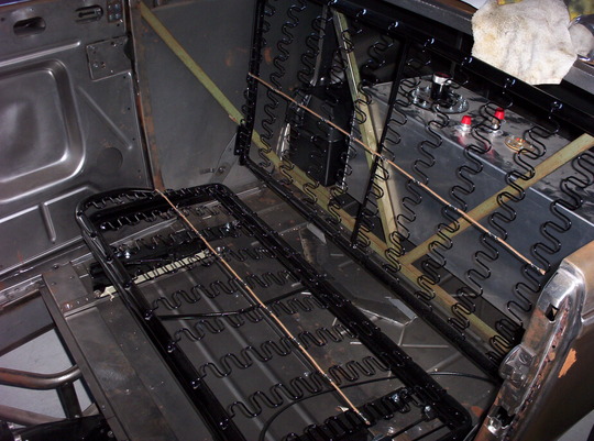

    <TABLE id=HB_Mail_Container height="100%" cellSpacing=0 cellPadding=0 width="100%" border=0 UNSELECTABLE="on"><TBODY><TR height="100%" UNSELECTABLE="on" width="100%"><TD id=HB_Focus_Element vAlign=top width="100%" background="" height=250 UNSELECTABLE="off">got some updated pics for you guys let me know whacha think

    <TABLE id=HB_Mail_Container height="100&#37;" cellSpacing=0 cellPadding=0 width="100%" border=0 UNSELECTABLE="on"><TBODY><TR height="100%" UNSELECTABLE="on" width="100%"><TD id=HB_Focus_Element vAlign=top width="100%" background="" height=250 UNSELECTABLE="off">anyone have a good suggestion for a trunk locking mechinism ....

    Holy **** that engine is sick!!
