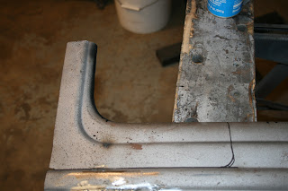

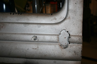

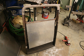

    some pretty seriously rotted 1932 ford pickup doors i fixed up.

    Did you use a bead roller for the upper door panel around the window opening? If not how, inquiring minds need to know :)

    i used a bead roller to form the beadlines, and used a hammer and dolly to wrap the sheetmetal back in the corner. if you check out my blog there is a pretty good picture of how i did the same thing to form the entire rear window opening from scratch.
