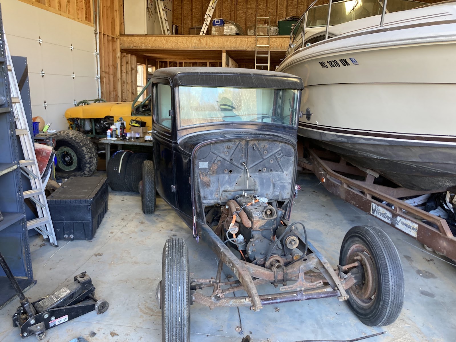

    Anyhow, I just recently brought home most of the parts of my first hotrod project, a '32 Ford pickup. I still owe the seller some money on the truck, and he still needs to excavate some more parts, but my understanding is that once it's all paid and collected there'll be MOST of the parts.

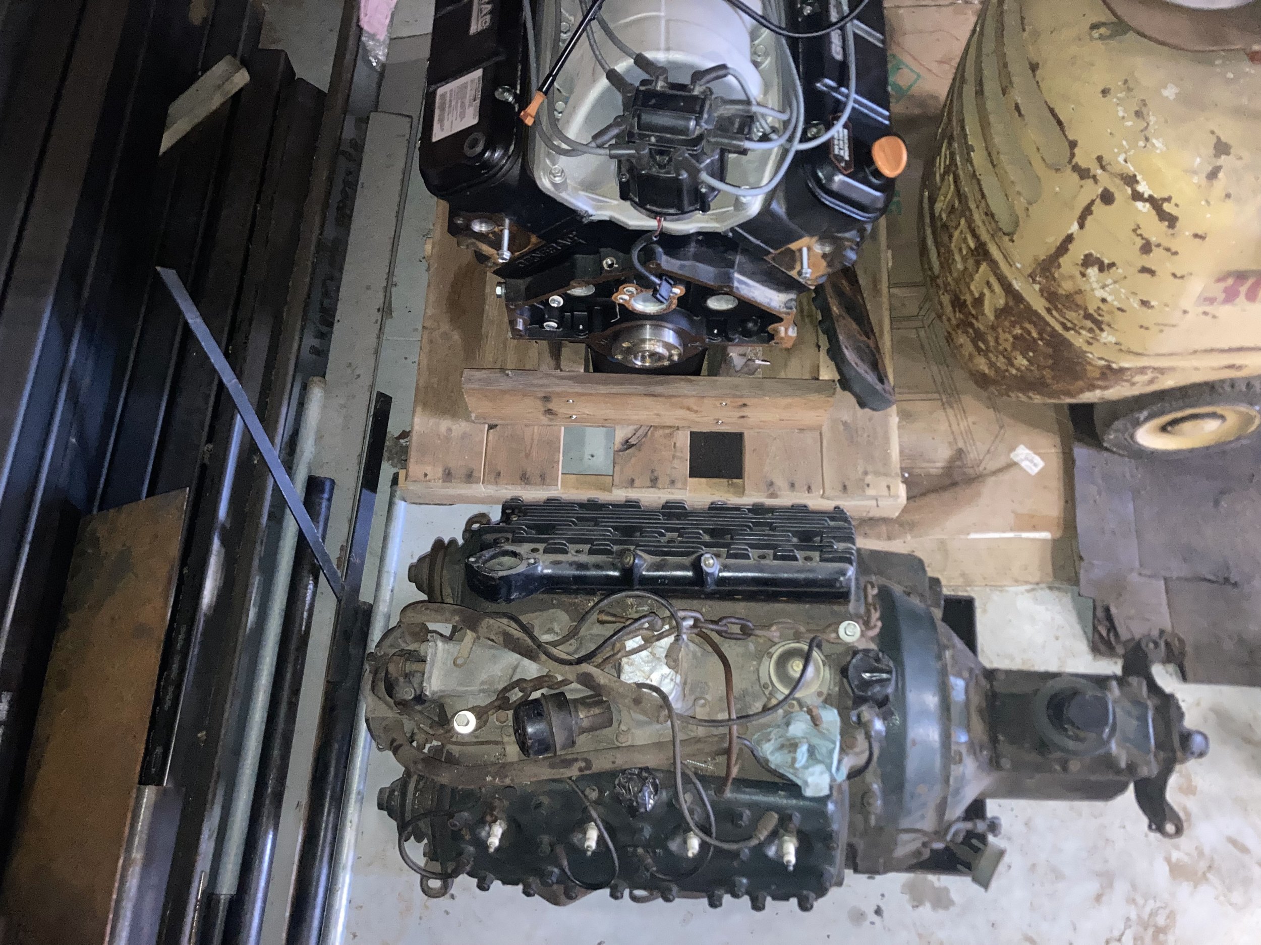

    The truck currently has a 4-banger in it. The head was cracked, and there's a decent amount of rusty-crusty in the cylinders. I don't have a pic before I christened it with ATF, but here's how it looks as of now. I'm hoping with a few weeks of soaking and careful persuasion I can get it freed up enough to take apart and see if it's salvageable IMG_1545.jpg

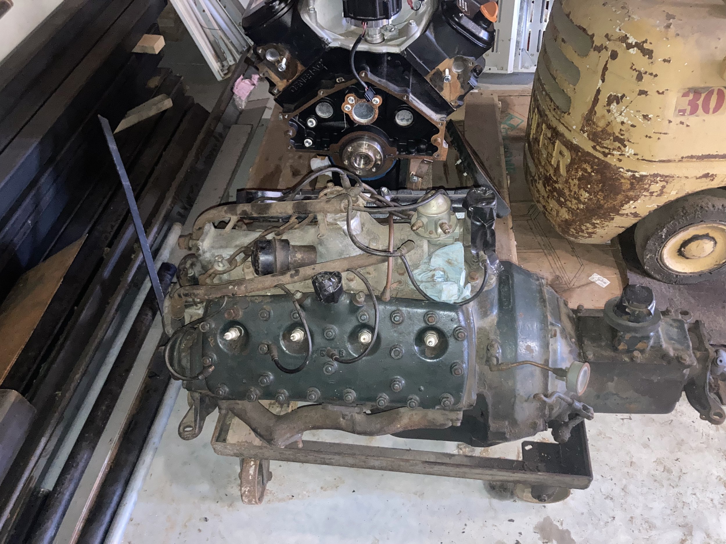

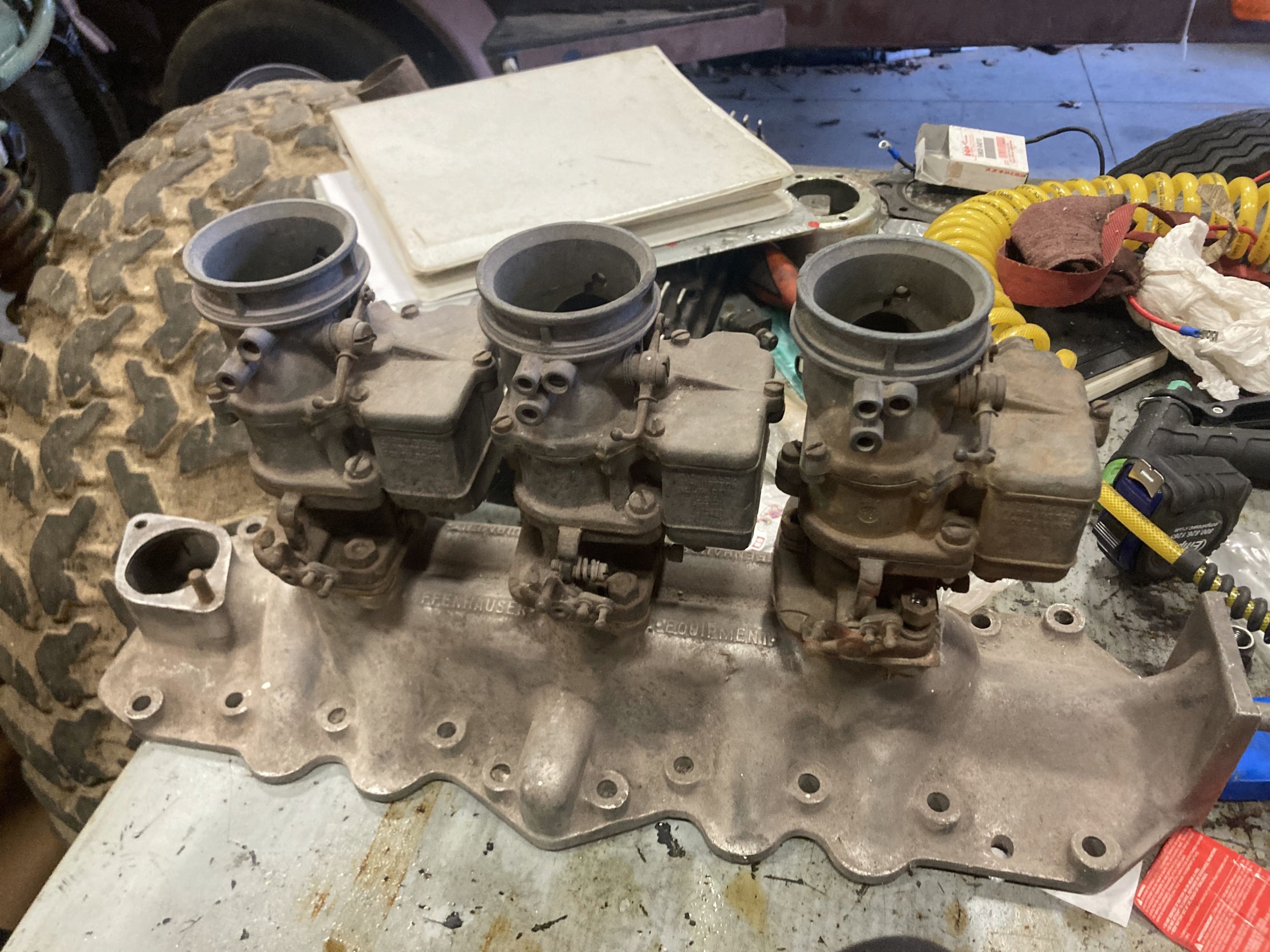

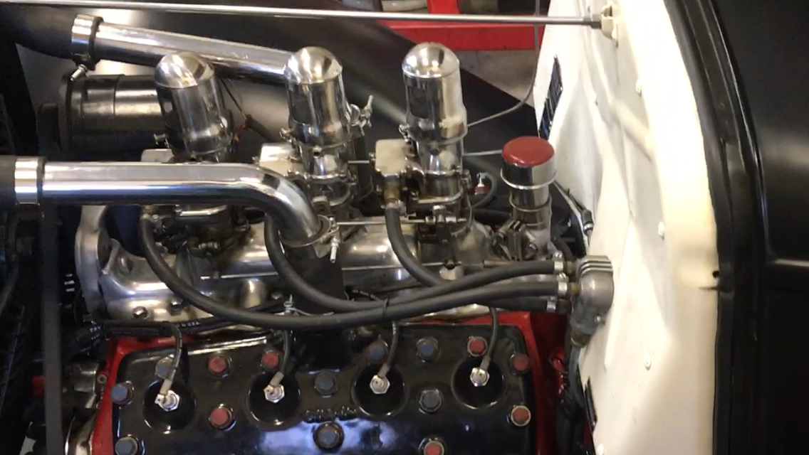

    The truck came with an extra flathead V8 that at least LOOKS pretty good, as it turns over and has really clean bores. That engine came with the original heads, but also a set of old Offy fin'd heads and a 3-duece intake populated with a trio of Stromberg 97's.
    My short term goal for this truck is to put it back together in some kind of running/driving format. Long term I'd like to get that V8 in it, probably with a T5 and a quick change.
    Since you gents have MUCH more experience with these things that I do, what are your thoughts on my best course of action for getting this to be a running driving truck in the short term? The banger's head was cracked (can sorta be seen in the pictures above) and it's sorta rusty. Is it likely the block was cracked in the same event as the head?
    The V8 looks pretty clean, but I have done enough engine swaps to know that they're never as easy as they seem like they should be....

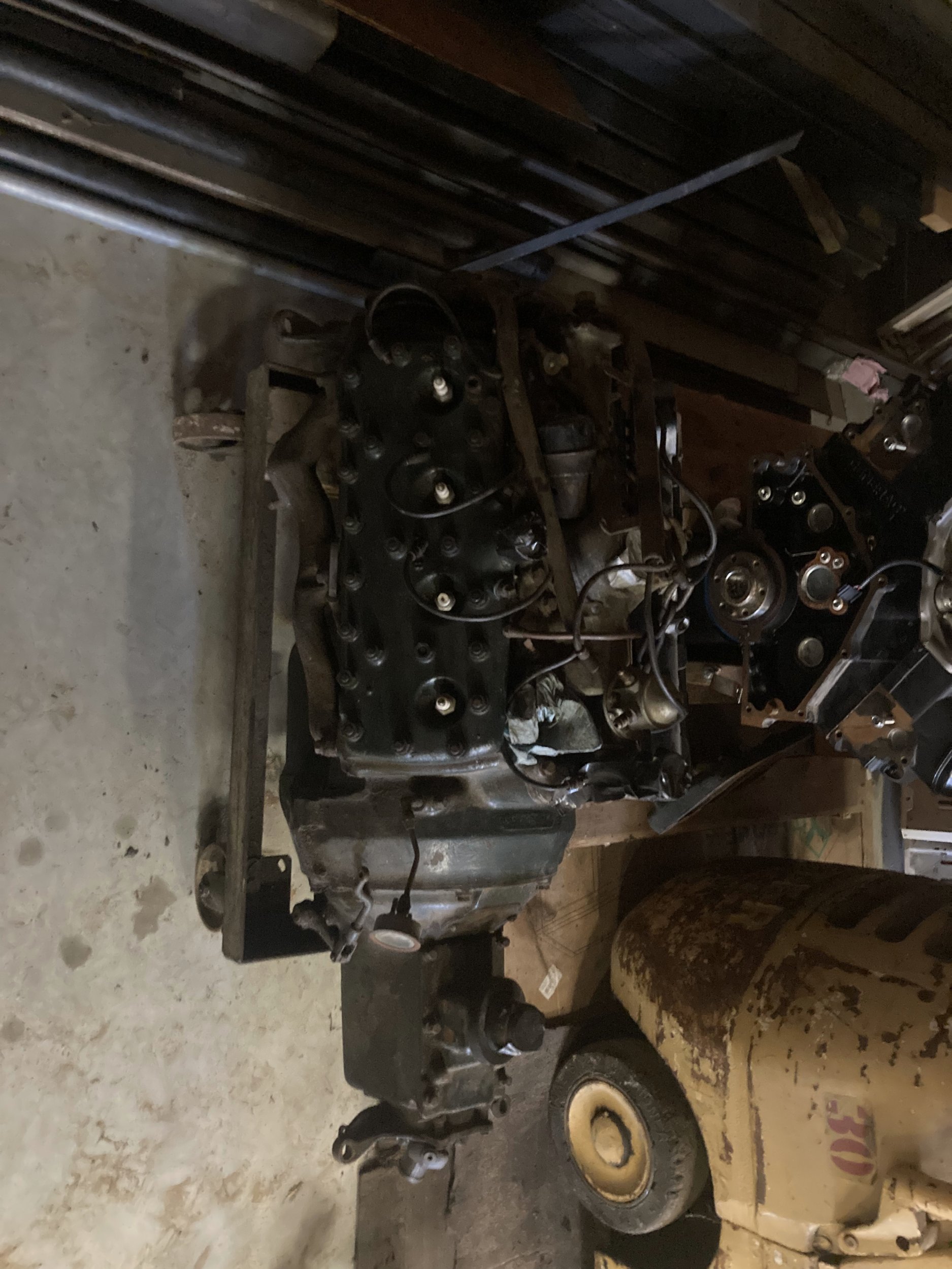

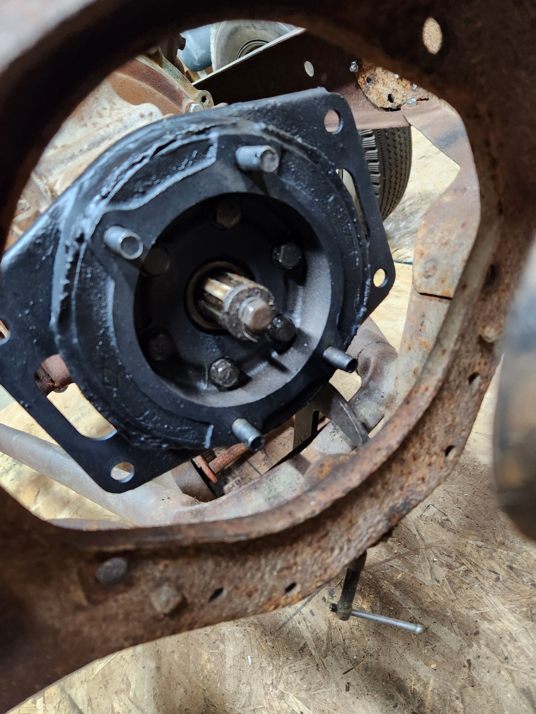

    Can any of y'all ID the transmission that's attached to the V8, and fill me in on what it takes to make this work out in my B ch***is? I have ZERO experience with the closed drive system. I can cut and paste on normal driveshafts all day long, just don't know what I 'm doing here!
    Would I move the crossmember back, and then shorten the torque tube? IMG_1550.jpg

    A 39-ish transmission, with the same rear mount. Can't tell the internals until you open the top and measure some stuff. The rearend in the pickup is a 32 for a B model. The transmission would bolt up just fine with the switch to a 32 rear trans mount. Bolts right on.

    So if I get a different rear (or center I guesss...) crossmember that V8 and trans will bolt right up?
    What does that do to the location of my rear axle? It seems like if that crossmember moves fore or aft I'll end up with my rear axle in a different spot due to the torque tube....

    Stick with the banger for now. Hopefully the head cracked and not the block. Swap on another B head. @rust

    No. The rear trans mount unbolts from the back of the trans and you bolt on a 32 style mount and Bob's your uncle. You'd need front motor mounts fab'd up.
    Get the book "how to build a traditional hotrod" by Mike bishop and vern tardel.

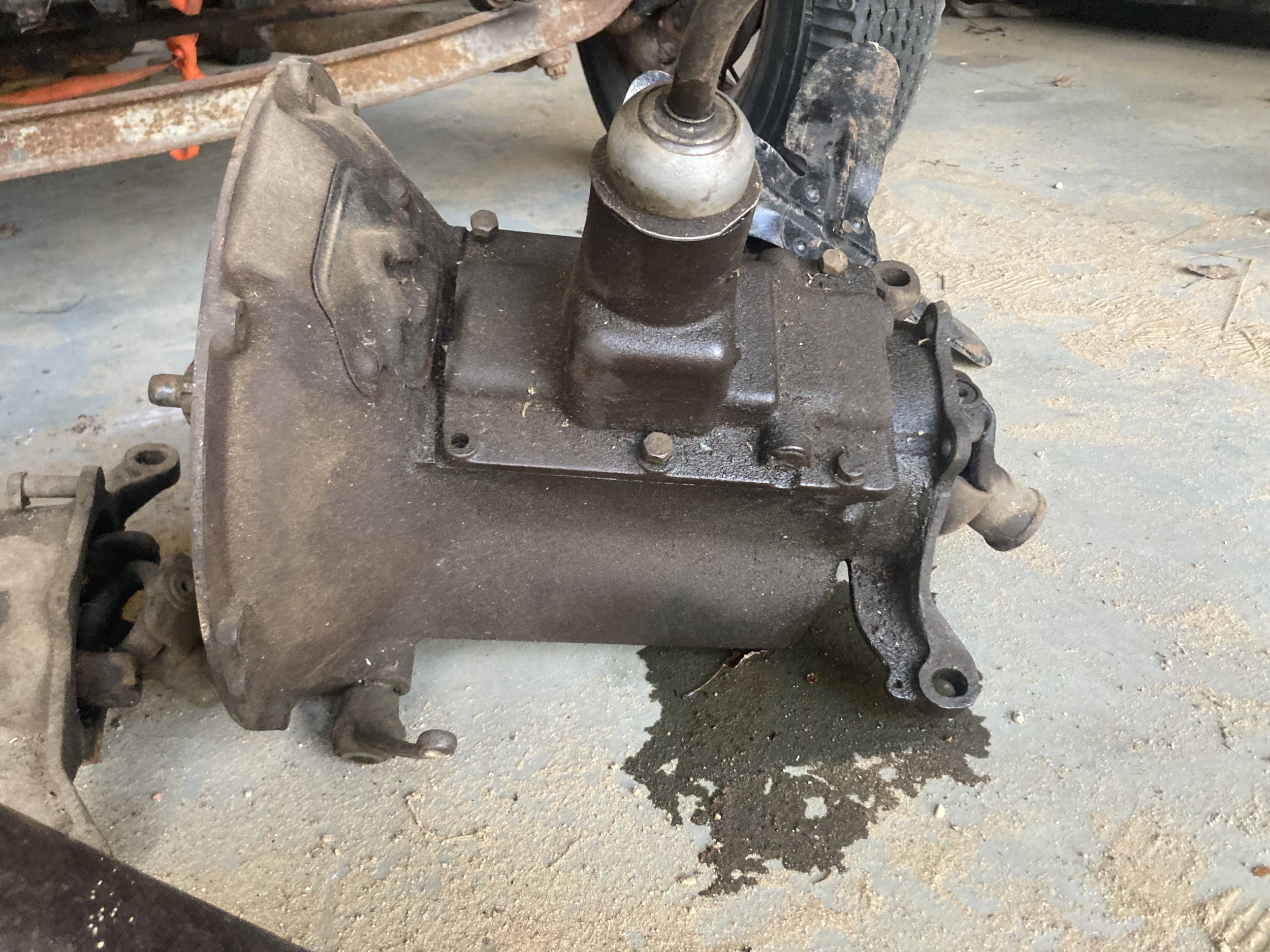

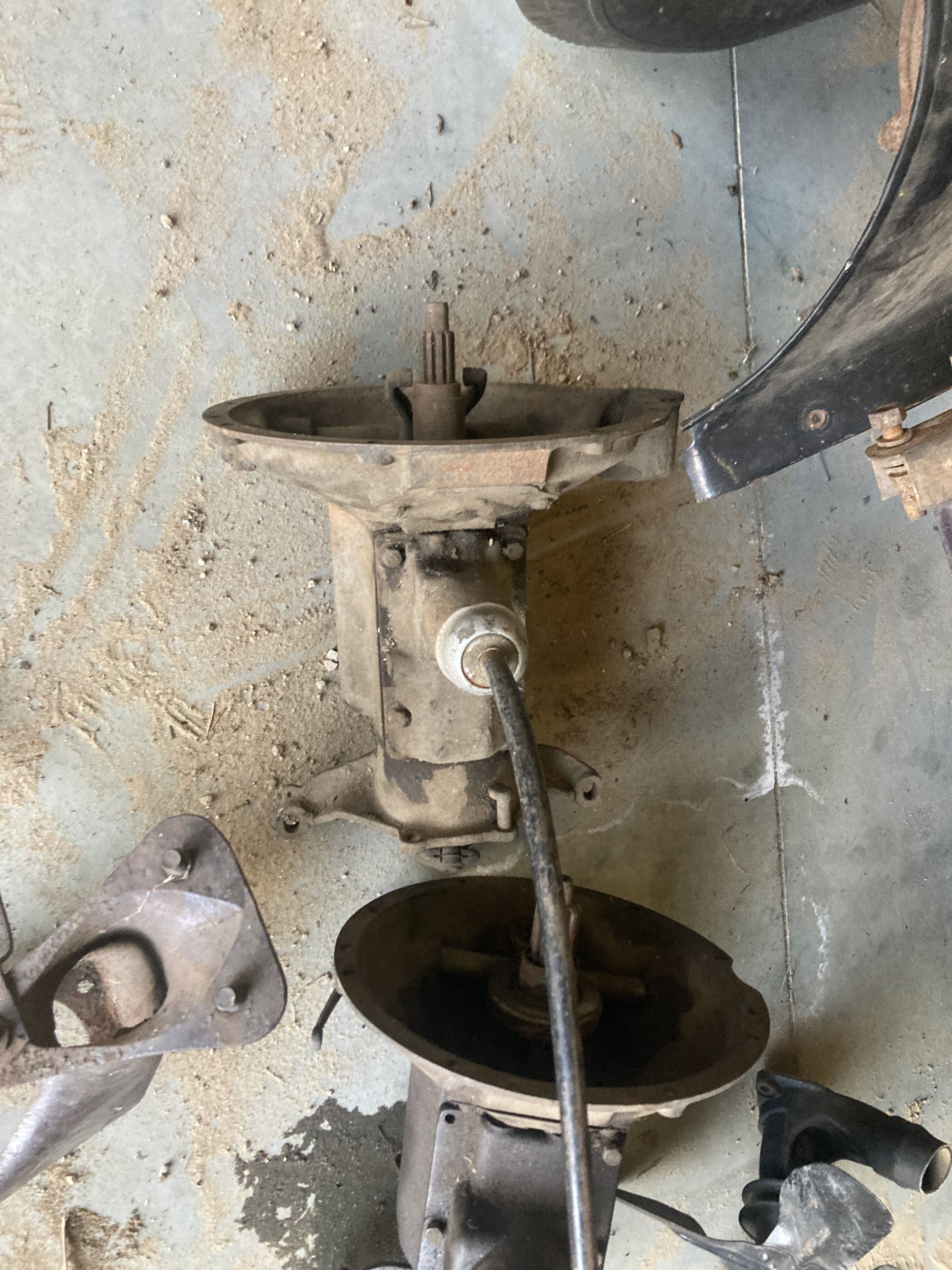

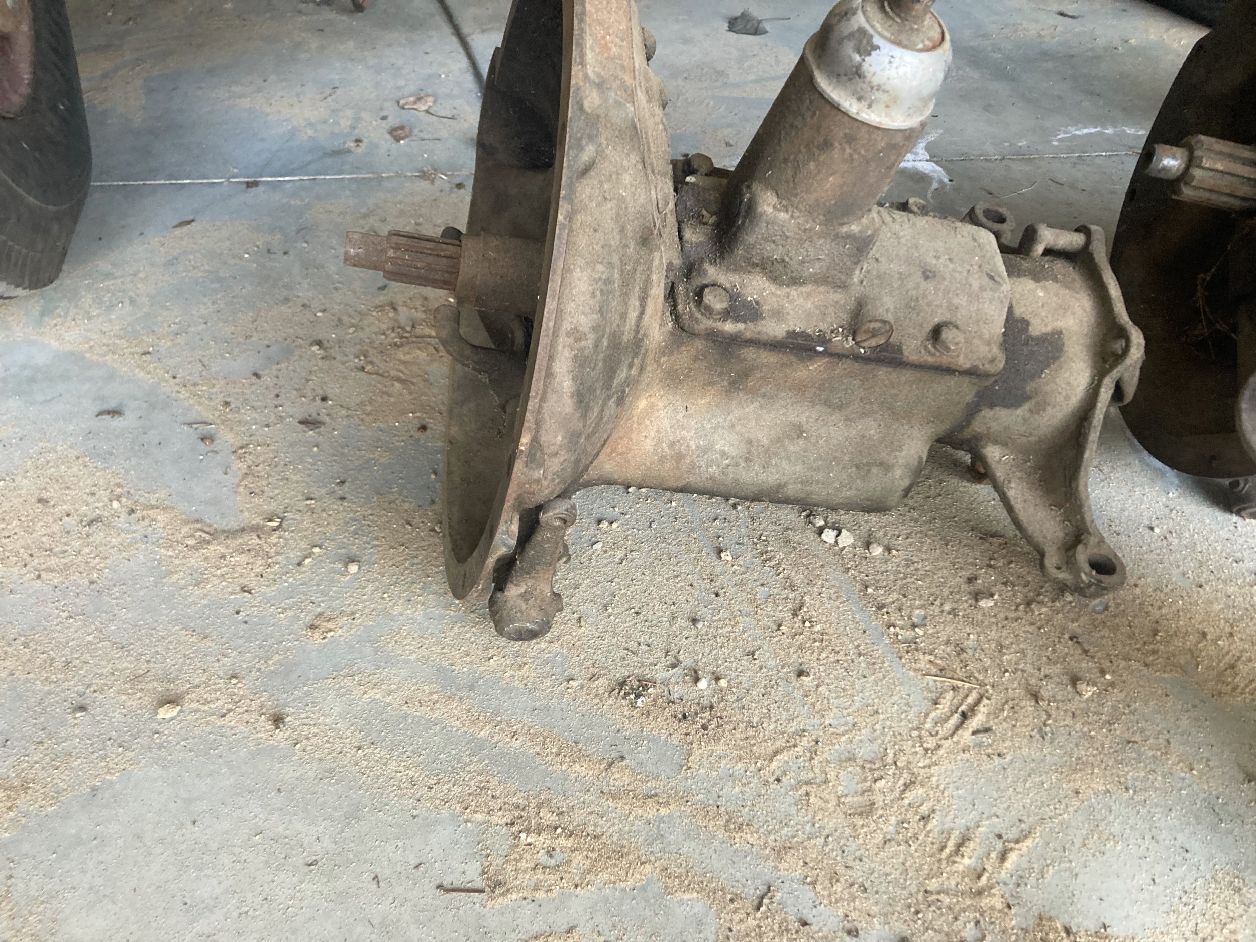

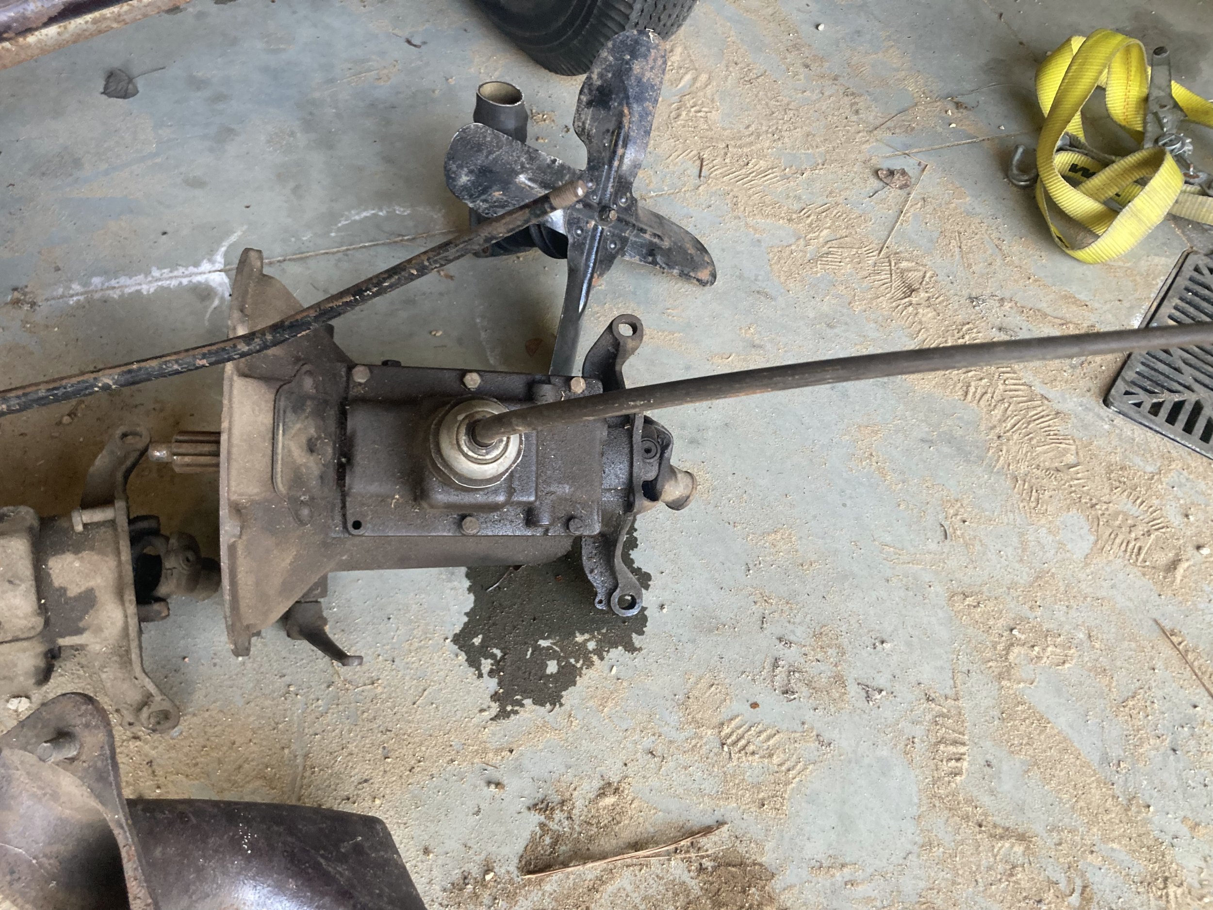

    These trannies also came with the truck.....do either of these have the '32 mount I'm looking for.
    My sincere apologies for being clueless here. Like I said, this is my first go-around with old iron, and I have a LOT to learn.

    Think that should work on a stock mount
  17. NoSurf
    Joined: Jul 26, 2002
    Posts: 4,867
    NoSurf
    Those look like later style to me.
    32 is flat up and down. Bolts directly to the k member.

    the rear mount on the transmission that is currently in the truck will swap from the B transmission to the v8 trans you have and then it bolts right back in. Get some 32 v8 front engine mounts like Neal said, that gets you bolted in. Then some wires and a radiator job for the v8..

    On the extra transmissions, the skinny one fits a 60 horse V8, not what you have, but still a valuable trans to a guy with a 60. The greasy one looks just like the one currently bolted to the flathead. Same sought-after double-detent top casting. But also hard to tell what internals are inside it. Shift it into neutral, undo the top bolts, then lift straight up. Then measure the distance between the fork tips on the larger fork.

    But the rear motor mount off of the B transmission can be swapped over to one of his V8 transmissions. You need the bearing retainer and plate, then add a new vulcanized mount.
    The torque tubes on 32's were all the same length, 4cyl and V8. It is 33-34 that there is a difference in length between 4Cyl and V8.
