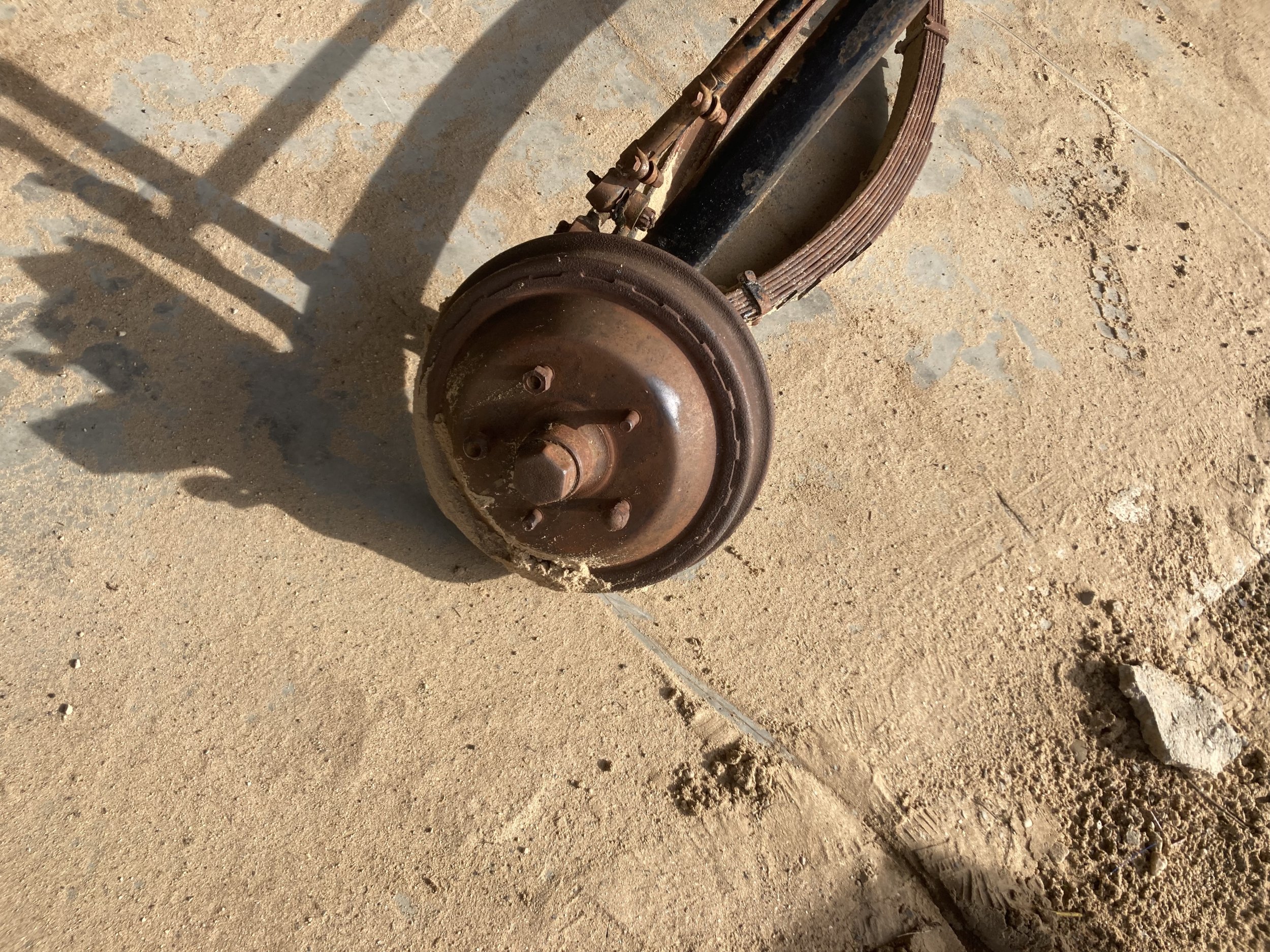

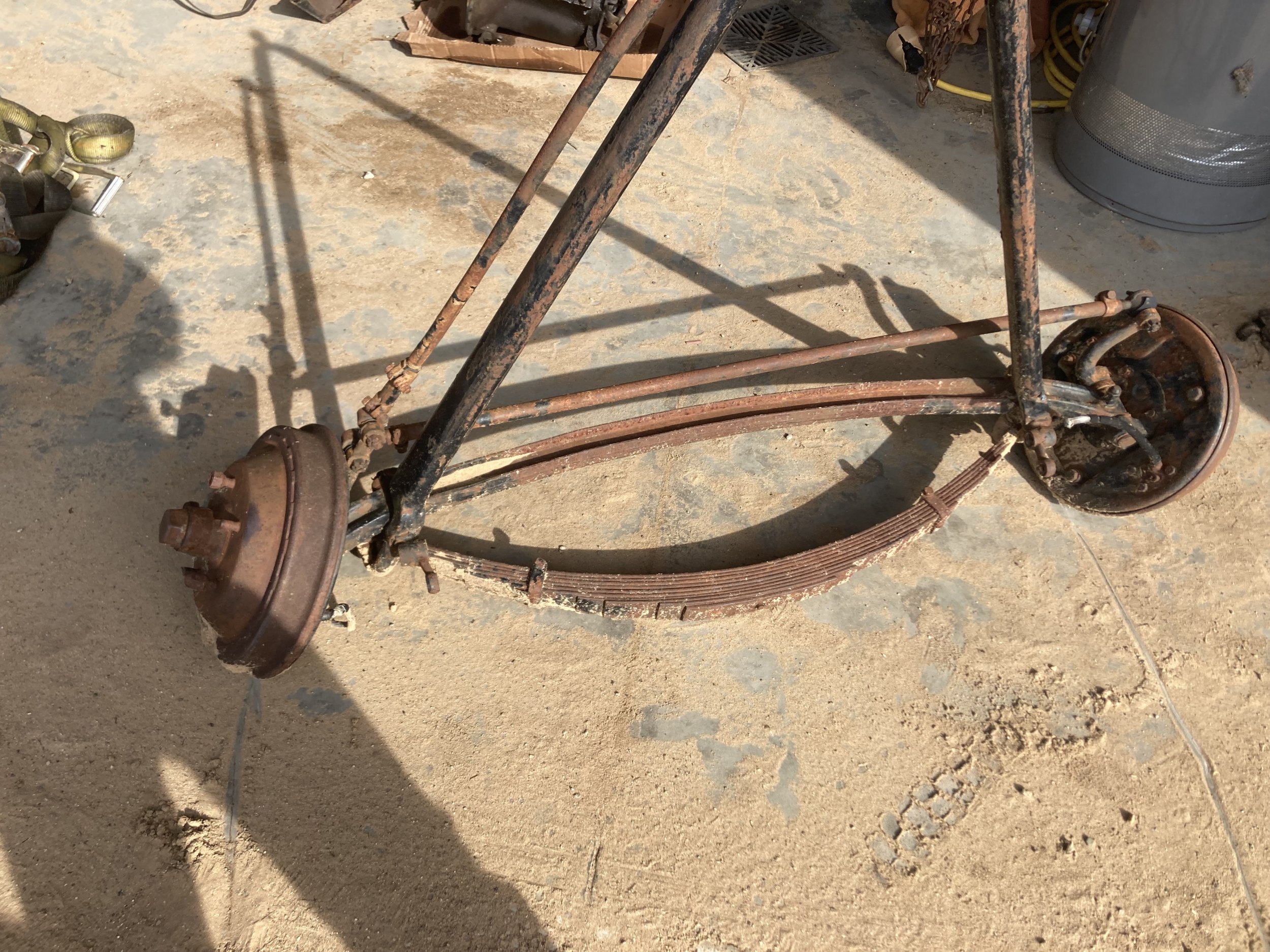

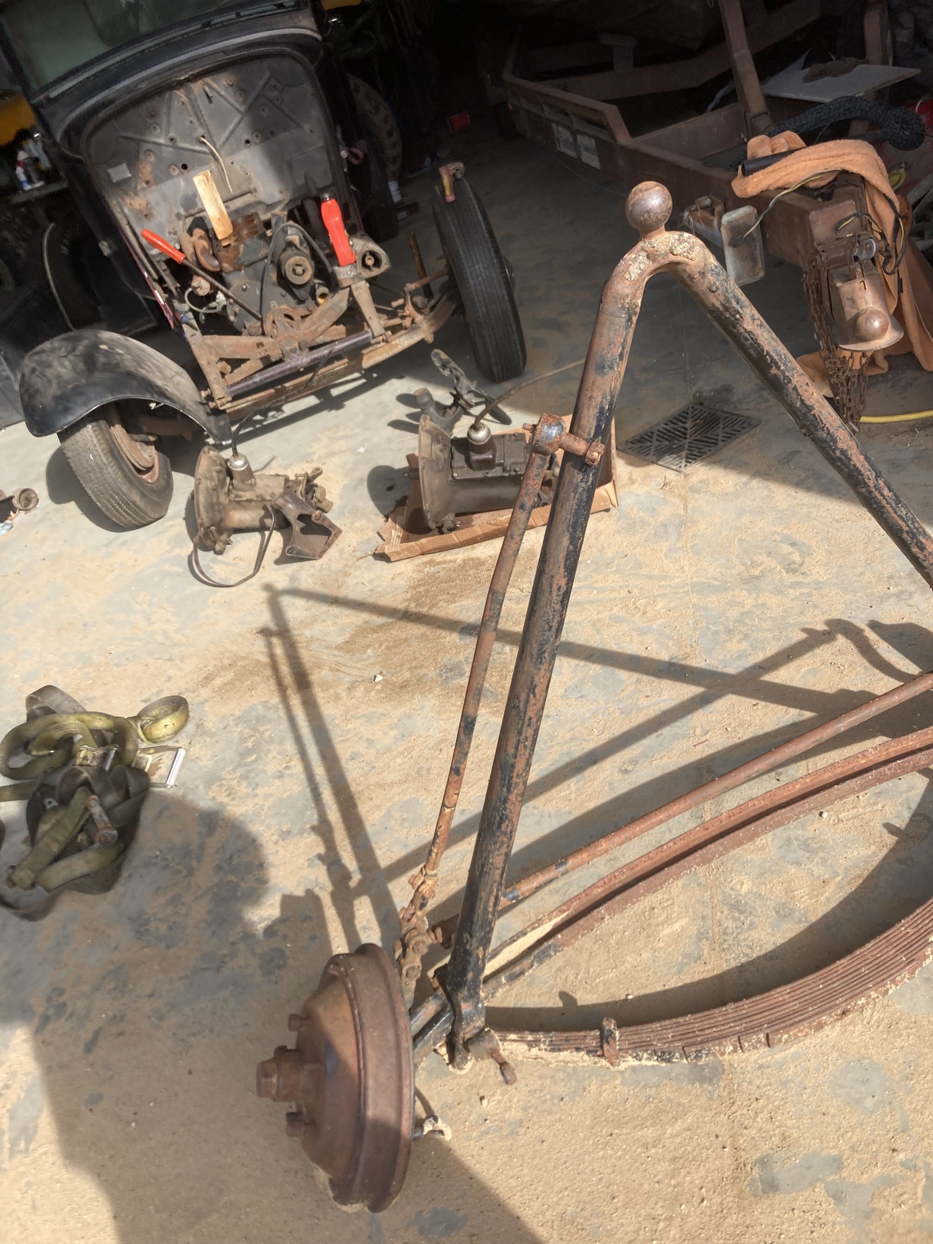

    I have some more pics of parts that came in my kit. This front axle looks to have the drag link attached to the p***enger side.
    Any ideas what it might be?

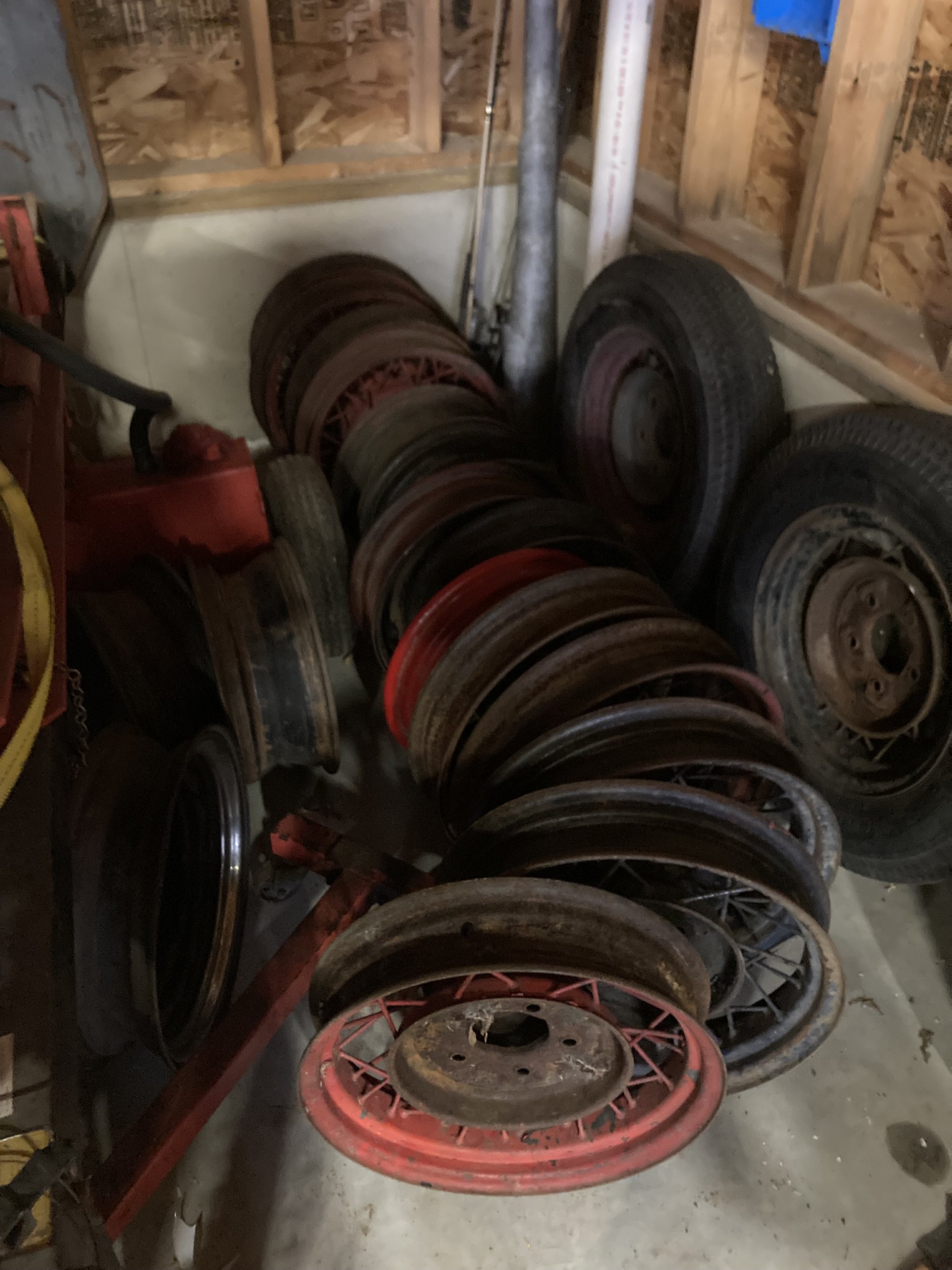

    Not a great picture, but I also came home with 22 ***orted wheels. Looks like I will be able to choose between big-n-little or whatever.

  15. I am going to start with the ***umption that the ***embly is as it left the factory and individual parts have not been swapped. Since the bolt pattern looks like 5 on 5 1/2 it is 1940 or later. Earlier ones were 5 on 10 1/4 1936-39. After the war Ford went to hubs on the outside of the drum so that makes it prewar. It looks "different", like it is a stamped steel center and maybe a cast iron ring? Maybe aftermarket or foreign production? The real question is how far oversize is it? 12.060 is generally considered max and that may also be a legal max. The post war brake drums and hubs had the hubs on the outside of the drum so it is not post war. The drums and hubs as an ***embly fit 1940-48 while the backing plates and other hardware are pre or post war.

  16. I would run the stock '32 18 inch wheels (but you probably could have guessed that looking at my AVATAR). Second choice would be bent spoke Kelseys if there are any in there. If you run the solid rims you won't need a spacer on the hydraulic drums (but that would only save less than $100).

    I really need to sort out the wheels to see what I have. The ones on the truck are all 16” I believe. And all the same size tires, but I think they’re mismatched brands.
    I think there are 17” and 18” wires in the pile. And some wide 5’s?
    Quite an ***ortment

    Yes, a 40 front end. Swap the spindles and brakes over to the 32 axle.

    That wide five looks like it could be one of the hard to find 3.5" wide V8-60 ones
