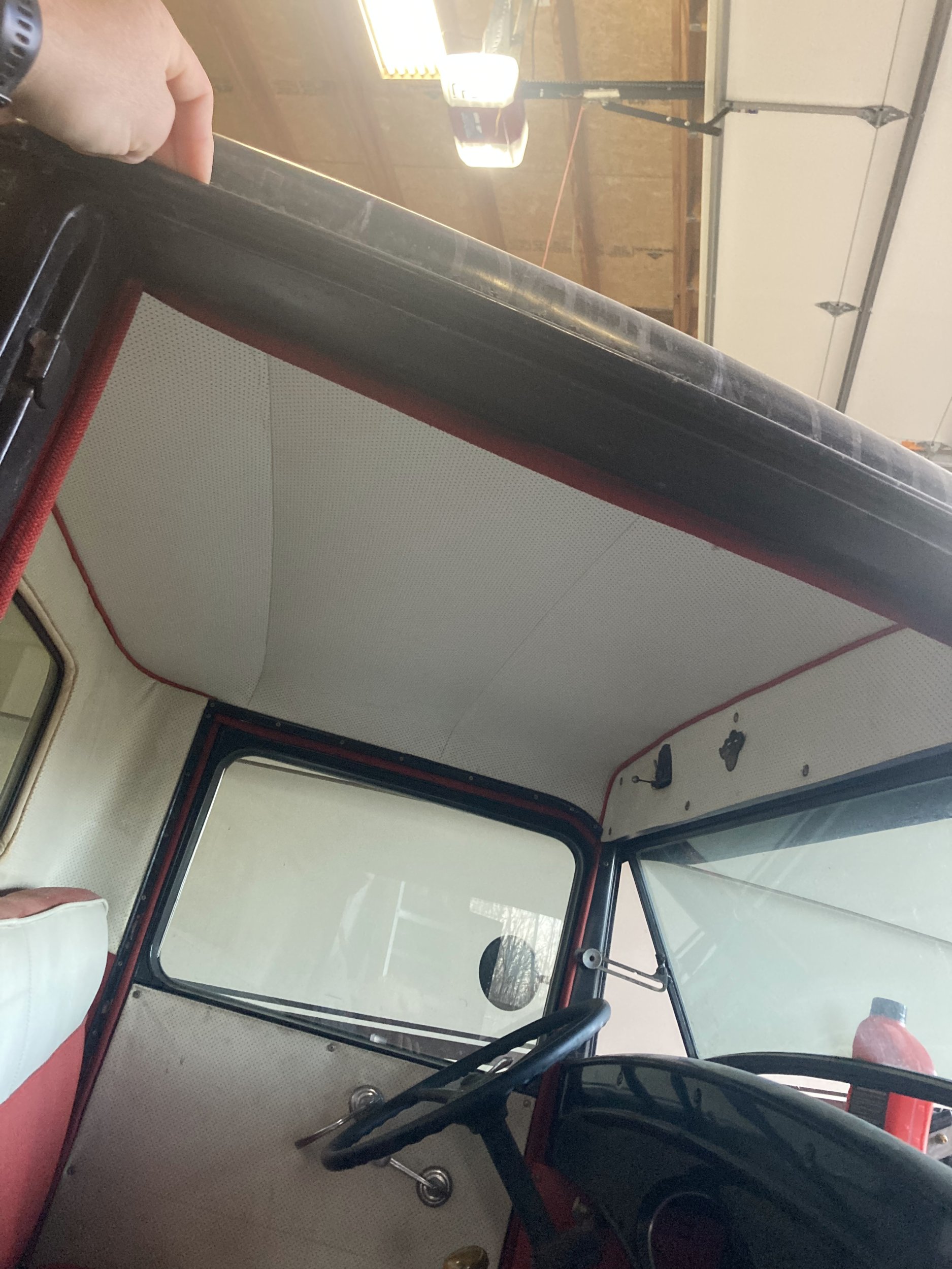

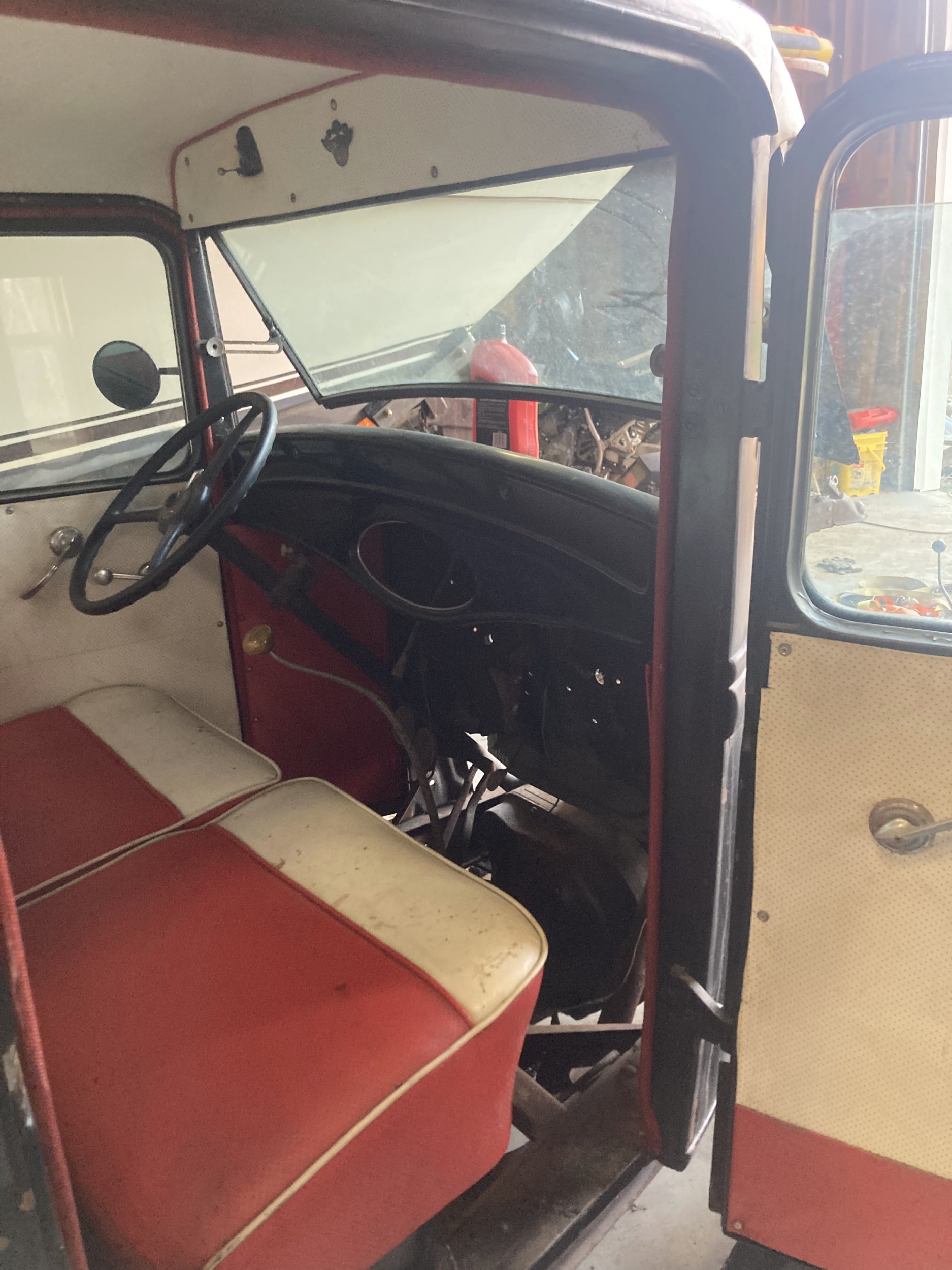

  10. JayMcJay
    Joined: Jan 5, 2025
    Posts: 45
    JayMcJay

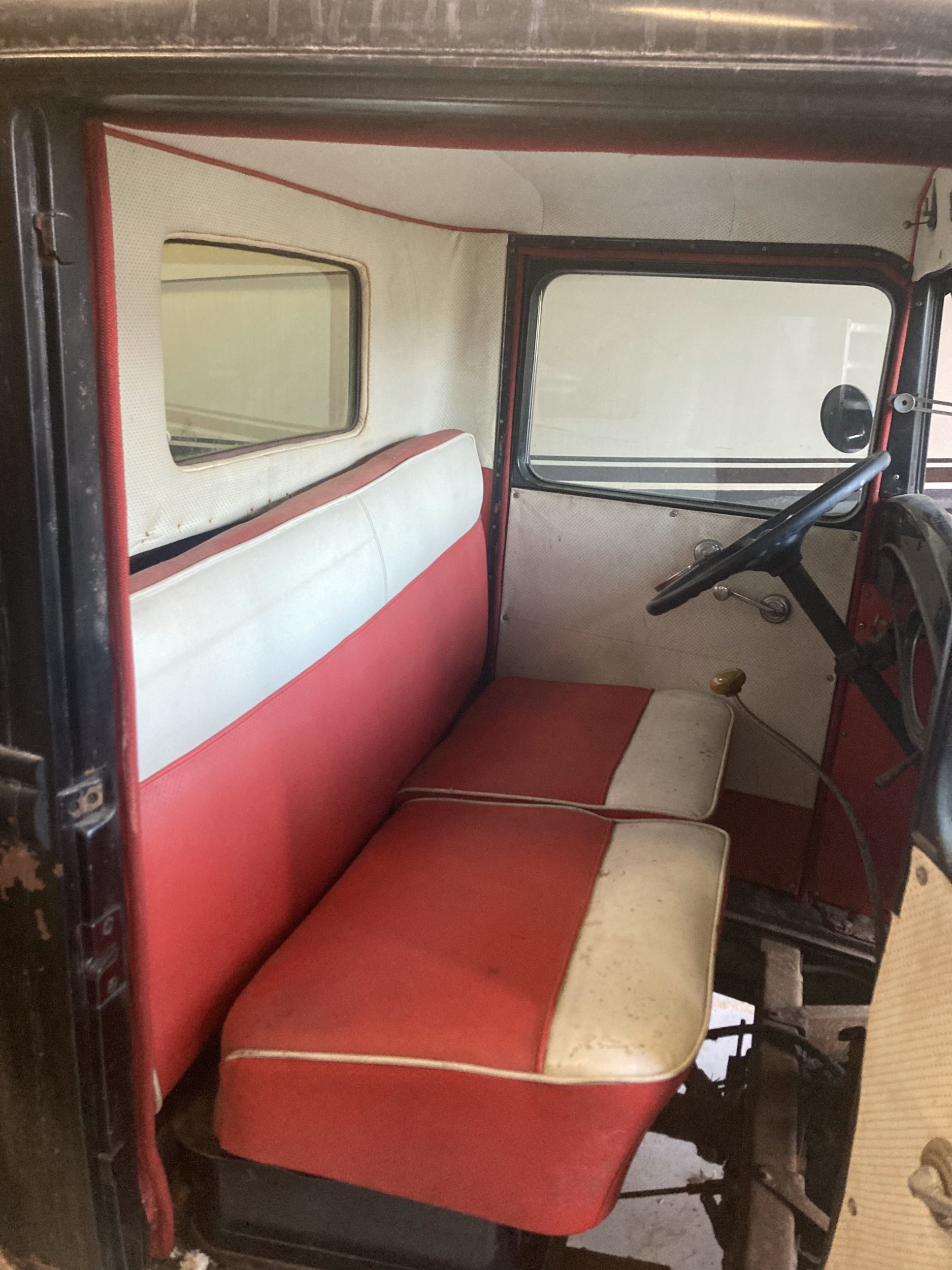

    I only have a 32" inseam, so my legs are probably on par with 1930's men. My height is all in my torso. So cutting a bit out of the seat bottom will probably be all I need to get 'comfortable' in the truck.
    I was sitting in it making motor noises this weekend and I can't really see out of the windshield. At least not very far. But I can see the panel above the windshield!
    Petejoe likes this.
  11. HOTRODPRIMER
    Joined: Jan 3, 2003
    Posts: 64,735
    HOTRODPRIMER
    I chose to make a new floor with steel adding a slight hum for the transmission and welding the riser to the new floor, I used the inside of the riser to install the heat/air unit and the wiring.

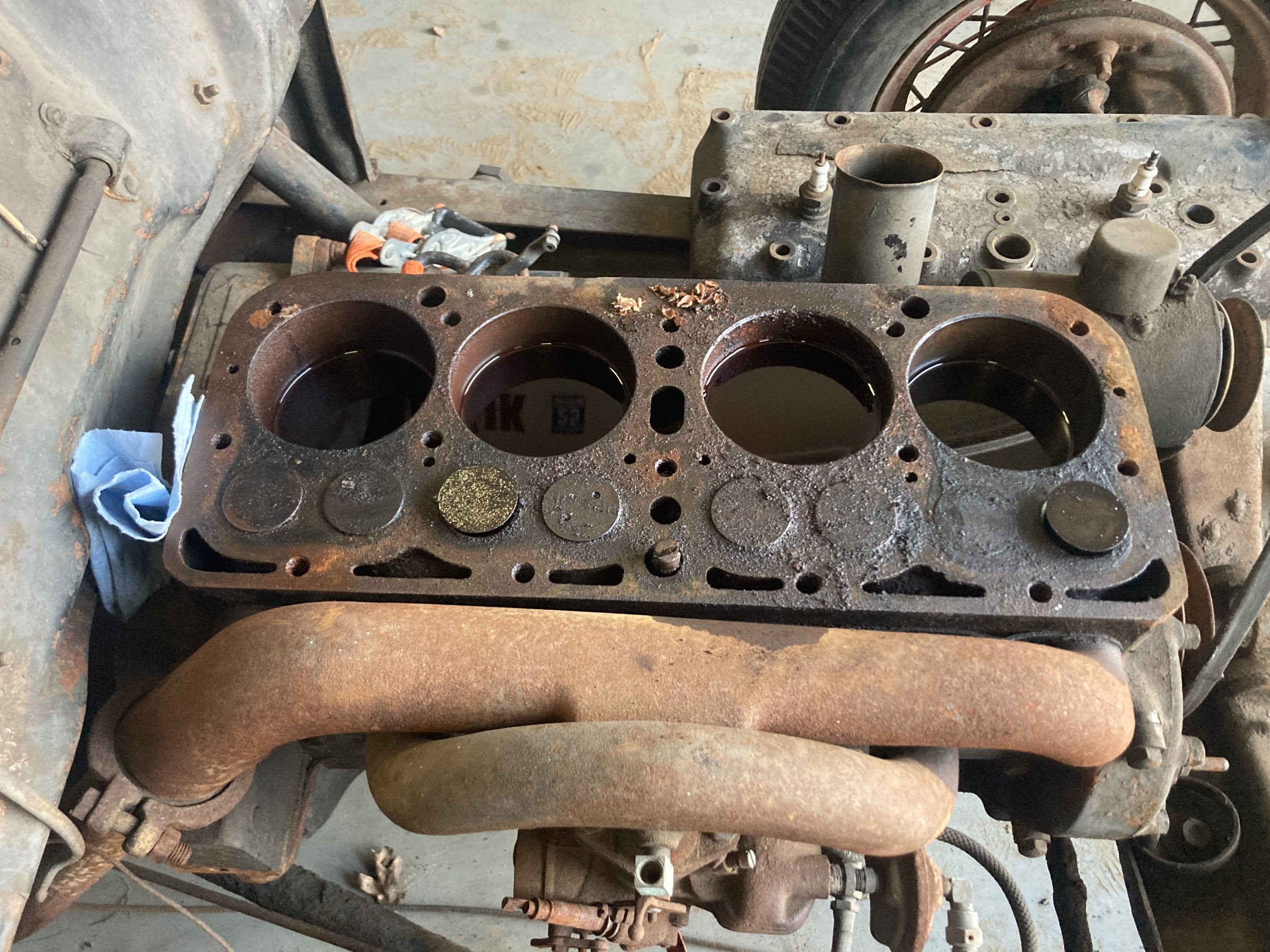

    Turns out I hadn't hit "GO" on my book order. I thought it was supposed to show up Saturday and was wondering where it was. Still in my cart! Anyhow, I did actually get it ordered on Saturday and it'll be here tonight they say. I'm excited to get reading it.
    My current strategy on that Banger is that I have the pots swimming in ATF. I have been tunking them with a block of 2x4 and a hammer every day or two. I might need to mix a little something into the ATF to help it creep better though. Should I also pull the valve cover off the side and release the valves somehow?
  26. RodStRace
    Joined: Dec 7, 2007
    Posts: 8,757
    RodStRace
    As far as reviving the banger, you can do the youtube shtick, check the oil, hook up a jumper and crank away which is the least work and fastest, but most likely to break something, to pulling the side cover and pan, clean, get things moving by hand, then apply power to the yank it out and send the whole thing out for a pro rebuild. Most fall somewhere in the middle, depending on tools, time, knowledge and budget VS running value. A banger isn't big bucks, a one-of-a-kind Bugatti is.
    Do what you can to ease it back to life. Understand that it may have been parked due to a rod knock or broken rings.

    Yeah, hooking up jumper cables and praying for the best isn't happening on this motor (although I have successfully done it on others in the past). At very BEST once I get things moving I'm going to have to take it apart and run a hone through the bores. But I can't even get it to budge yet....
    I thought I had read somewhere that sometimes these motors will have some issues in the timing chain or valve train that'll lock them up, so then you're fighting not only the rings glued to the bores, but also the valvetrain?
    Here's how she's sitting right now......soaking away!
  28. RodStRace
    Joined: Dec 7, 2007
    Posts: 8,757
    RodStRace
    You might as well pull the carb while you are waiting and check/clean it too. Keeps you from rushing the engine!
    Paul Shinn has a youtube channel dedicated to Model As. It will help with your banger, although there are differences between the 32 and the As. There are others too.
