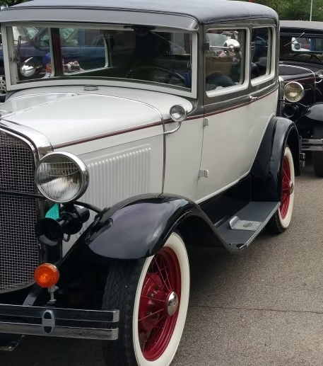

  23. Jeff34
    Joined: Jun 2, 2015
    Posts: 1,268
    Jeff34
    I think my '34 is Ford Dove Gray...just faded/oxidized. Truck at DiFalco shop.jpg
  24. JayMcJay
    Joined: Jan 5, 2025
    Posts: 46
    JayMcJay
    That's a good looking truck!
    The red and white interior my truck has is growing on me and I’d like to pick something that goes well with it. My thoughts are gray body/black fenders or red firewall and wheels, black everything else.
