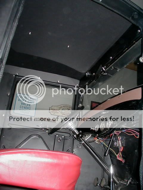

  6. Petejoe
    Joined: Nov 27, 2002
    Posts: 12,644
    Petejoe
    from Zoar, Ohio
    IMG_0524.jpeg I insulated the back side of the firewall on my 34. And installed windlace along the leading edge of the doors slong with the doors top and back edge.
    My flathead is rather loud but never really noticed much noise from the vent or windshield area to a point where I’d need earphones. I still have a working vent and working tilt windshield too.
    I did install a panel with insulation above the windshield for my temp gauge.
