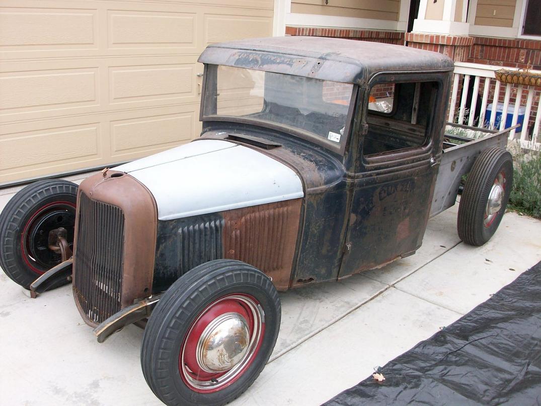

    I believe I am the proud owner of a nice 1932 Ford Pickup windshield frame. Can you guys take a look and verify for me? The problem is, that I bought this on e-bay, as a 1931 Model A Coupe windshield frame.
    Thank you for looking.

  2. I believe you are correct. The general shape looks to be like mine. The pics aren't at the right angle for me to be 100%. The hinge and posts for the arms looks like mine.

    I have a Model A windshield frame I bought for (as) a 32-34 pick up frame.
    Wanna trade?

    I've used model A windshield frames for 32-34 Ford pick ups. I believe they are the same except for the Model A frame has an extra piece that comes towards the dash (inside of frame). It can be removed and the dimentions are preety much the same. I've never had a problem. By looking at the picture, it looks like a 32 -34 For dtruck window frame.
  6. I think you are right too. I bought a new 34 pickup frame and they sent me a Model A frame with instructions on how to remove the extra metal that seals to the dash on the Model A.So they are pretty much the same thing.

    I have a 32 and a 34 pick up.
    Bought the frame for the 34.It's for a Model A,
    besides the extra lip on the bottom,the tabs for the slide out arms hit the garnish mouldings.I have it in there now,and I could make it work.
    But they are NOT the same.
    I just keep it propped open "Cali Style" it's only a moc up now anyways..

    My stock 34 pickup has a model A windshield with the bottom lip and it fits and works fine. Don't know why others may be different.
