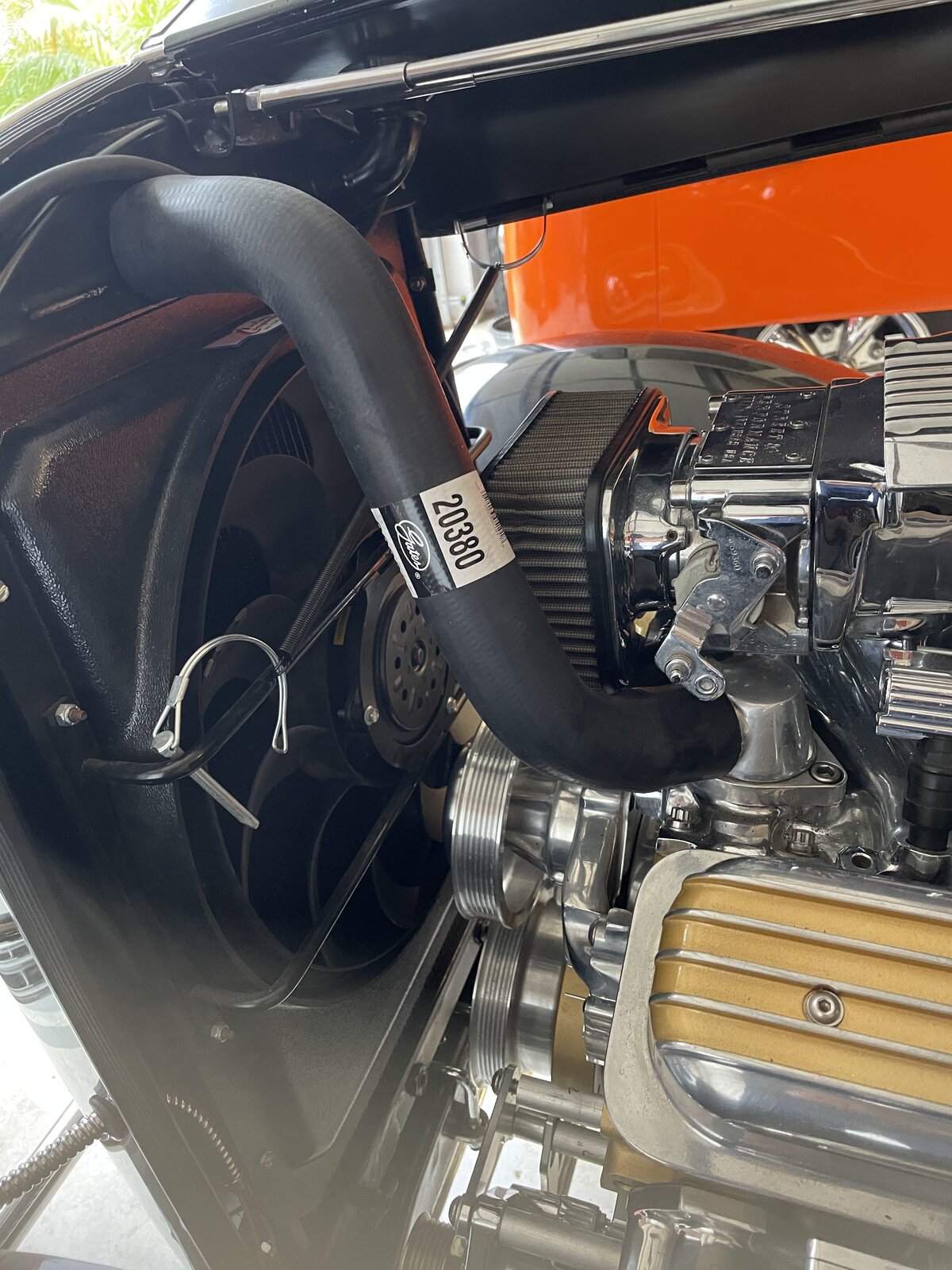

  6. Here’s an upper hose for a 90 degree or horizontal water neck. This one is adjustable. I trimmed the water neck side about 3 inches, the top is uncut.
    Berzerk likes this.
