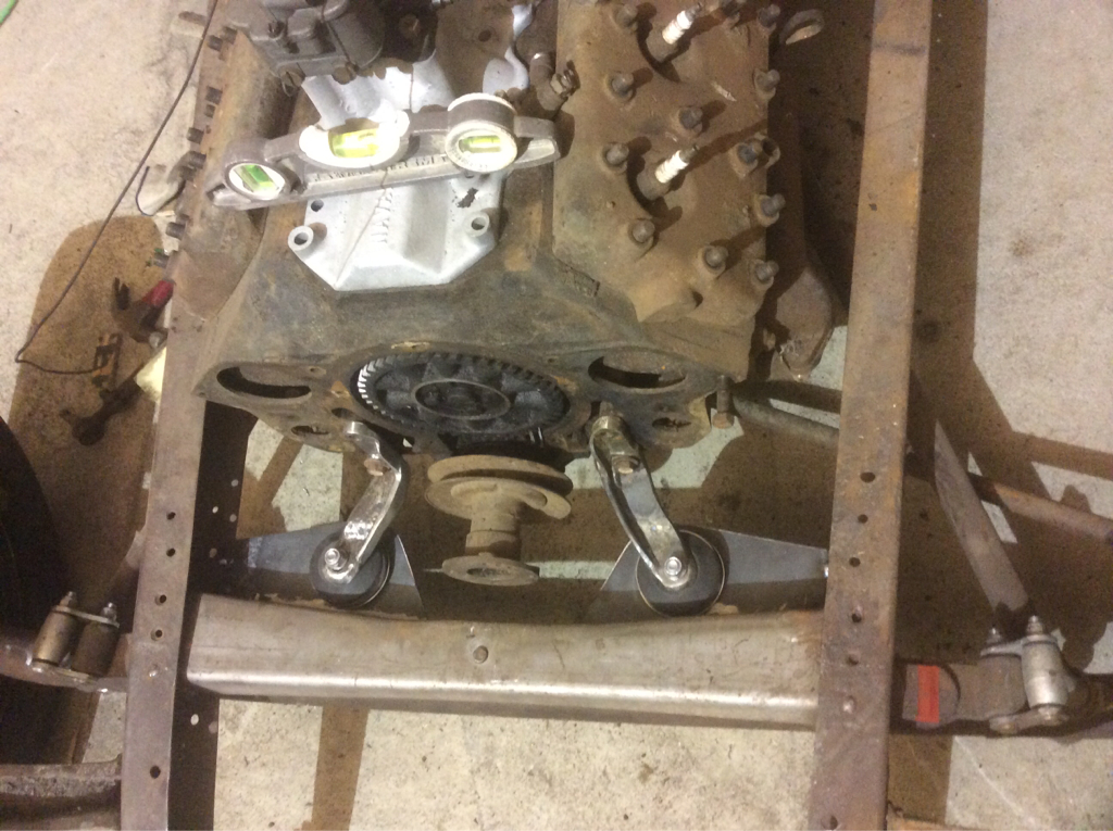

  7. Bader2
    Joined: May 19, 2014
    Posts: 1,143
    Bader2
    Got hold of David G on the barn,says they are the same,got some pics coming,not sure if it's gonna fit with my non stock flat front crossmember tho! ImageUploadedByH.A.M.B.1453402959.371217.jpg

    Won't your completely flat front crossmember move the radiator up a little, which in turn moves the grille shell up and then the hood will run uphill? I'm not sure, but it seems to me the mount is slightly lower. I thought Walker came out with a radiator that was slightly shorter for this type of application.

    Bader2
    That pads that mount the rad are still below the top of the frame,same as the stocker. And I'll guarantee I won't run the hood uphill,thanks. Walker chops a rad for guys that wanna run a chopped shell,to run the hood even more downhill.
  14. alchemy
    Joined: Sep 27, 2002
    Posts: 22,294
    alchemy
    The tanks on a stock radiator drop below the feet. A stock radiator (see how I spelled that all out, R-A-D-I-A-T-O-R?) won't fit on your flat crossmember.

  25. I do believe that a Walker radiator goes into the engine compartment 1''- 1 1/2''. Original V8 radiators work real well.
  26. Bader2
    Posts: 1,143
    Bader2
    Tanks are below the mounting tabs though,I've got a flat crossmember,the top of it is only a 1/2" below the top of the frame. I think it will put the top of the top tank too high. And therefore the top of hood will run up hill. I'm thinking an aluminum RAD may be the right choice. ImageUploadedByH.A.M.B.1453419239.796175.jpg
