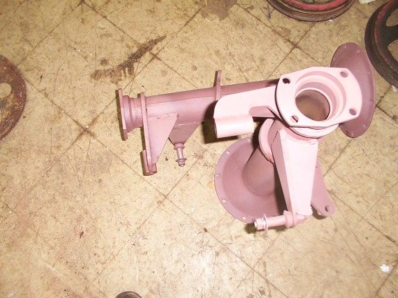

    Here are some photos of some of the ways to use bones by making brackets and while I could not find the exact photo you can see it is not hard to duplicate. The straight spring provides more space for the shocks but requires modifying the center of the rear crossmember. 1936 bones can be used by cutting off the spring hanger. PSI made these years ago but I don't know anyone that has them today. The company is still in business in Pasadena - Antique Automotive - Gene Scott. The quick change bells have the short spring hangers you are using for the 32-34 spring. The photo of the 40 bones shows the brackets welded to the housing which could be done on the 9 inch also. The 9 inch is using 36 bones but you could use your set up also. IONIA Rod Shop can help you out with your plan.
  8. This is a '34 but mostly the same thing...
    Uses stock bones (modified ladder bars), stock curved spring and stock rear end.
