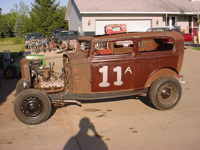

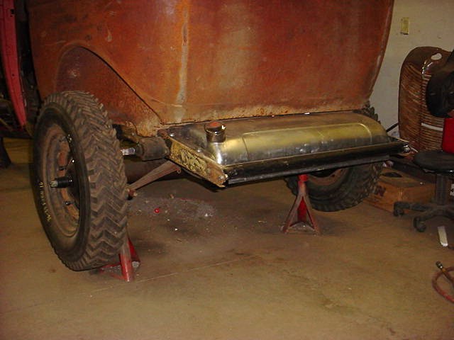

    Johnny - I'm all for you putting that '36 rear end in your 32, torque tube and all. I think all you have to do is notch the spring like Groovy says. I had a 32 I had to move the rear crossmember back 3/4" and then had to notch the flange and the tank, (it was a 40 rear end) but it all worked out. Don't give up!!! Your car will be respected and look "right" when you are done.

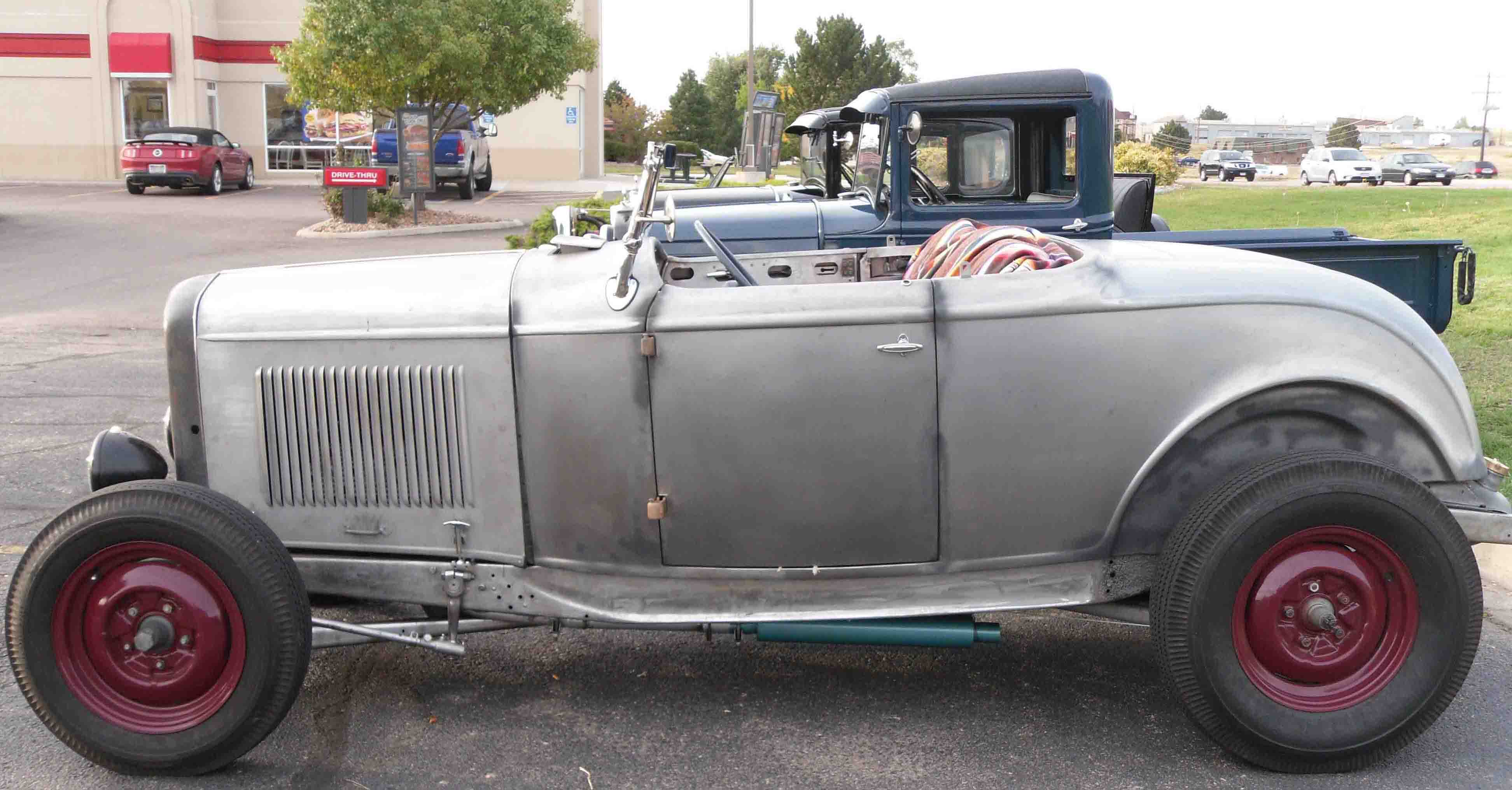

    Here's a side view of my '32, the wheelbase looks fine to me.
    All I did was notch all the leafs in the spring to get it to fit.
    Once the wheelbase is set, you can cut the torque tube and driveshaft.

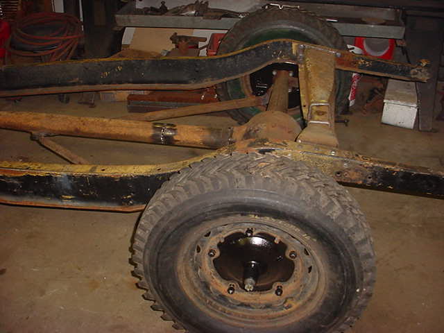

  3. the spring is done and I got it to fit greatbut with the heavy wishbones i was told it would move my wheels foward .

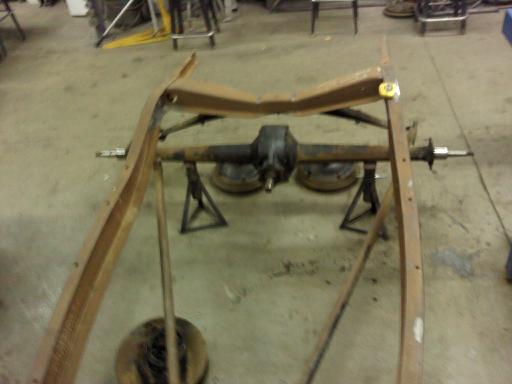

  5. I can only say the distance between the spring and the banjo is diffrant from a stock model B and the 36 heavys that I planed on useing
  6. the spring mounts directley off the arms on the endcastings on my 34 rearend. The spring mounts off the 36 heavy wishbones

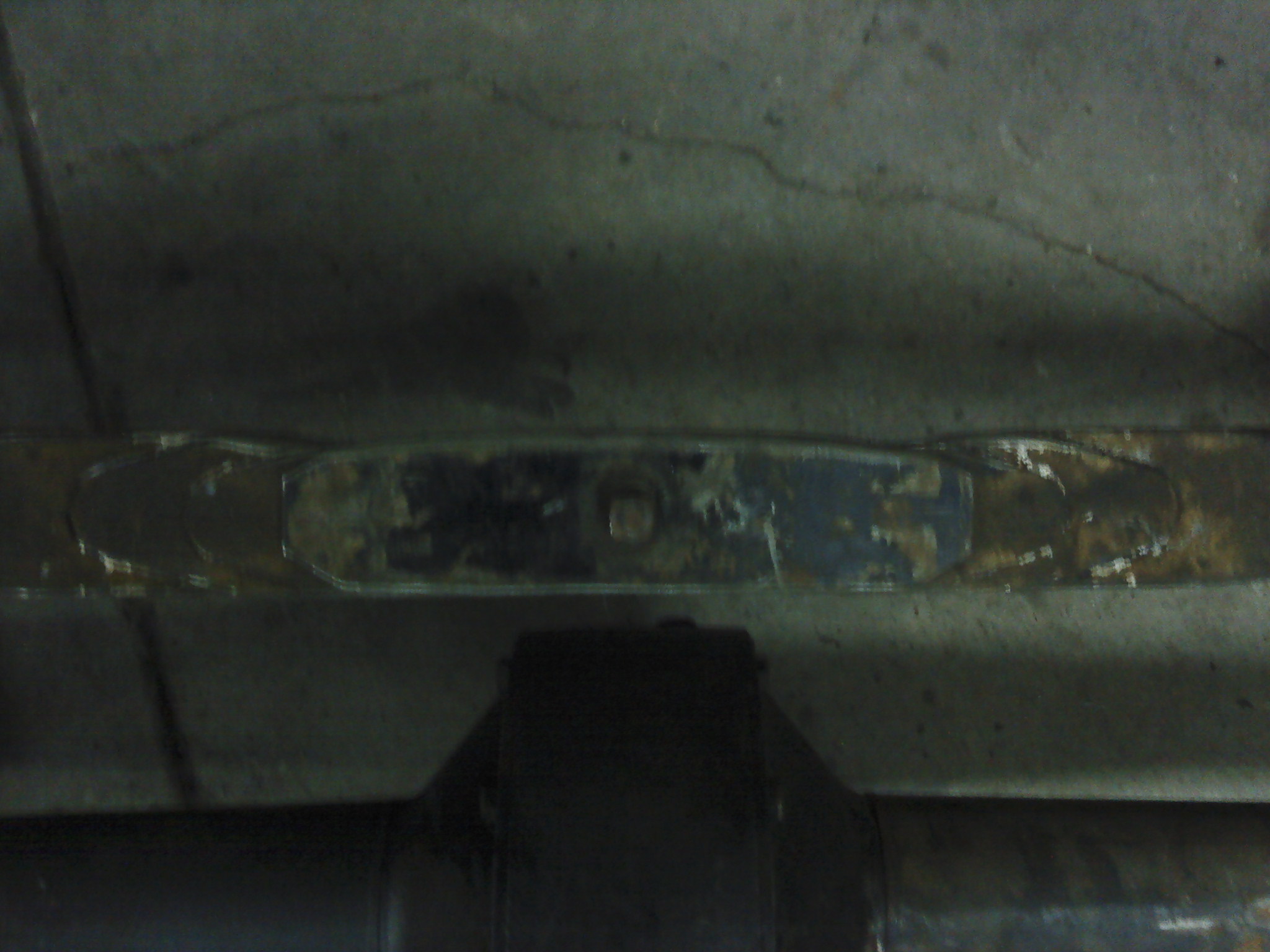

  8. the only way to get the spring in is to grind it because the crossmember is cresent shaped and the spring is straight.You can see in the pic above its ground already.
