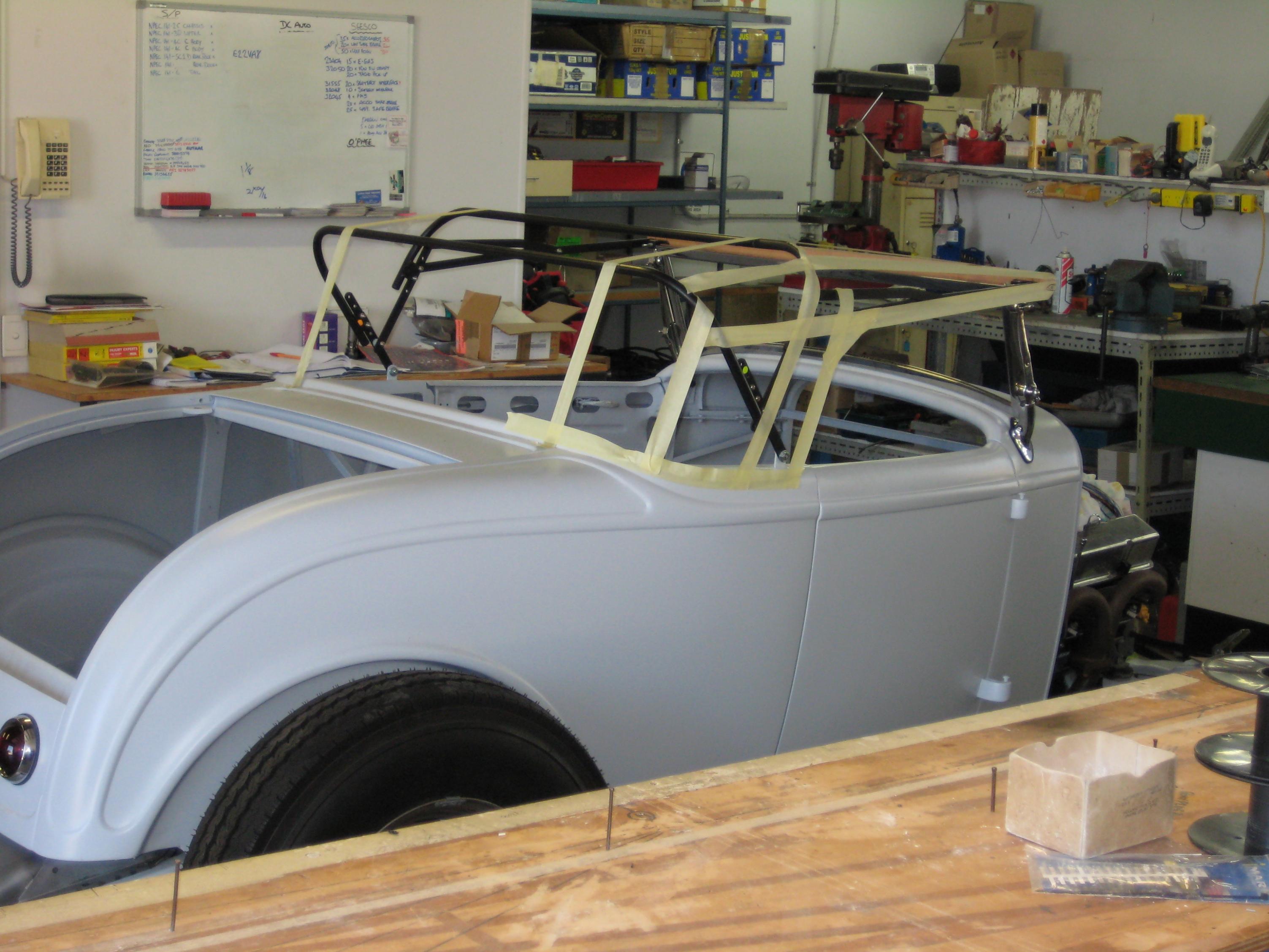

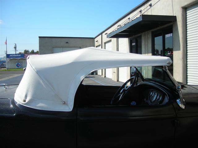

  8. I built my own irons out of 1"x 1/4" flat stock. These very much follow the factory specs as I took the dimensions from an original set that I knew a fellow rodder had.
    The timber bows I had made up by a furniture guy who did a lot of laminating when making his products. He happened to have a mould which he simply adjusted to suit the size I needed.
    I finished off the timber bows and ***embled all of that. I then took it to a trimmer friend who s***ched up the fabric top. That was made out of a type of sail cloth. Very tough .
    See pics attached.

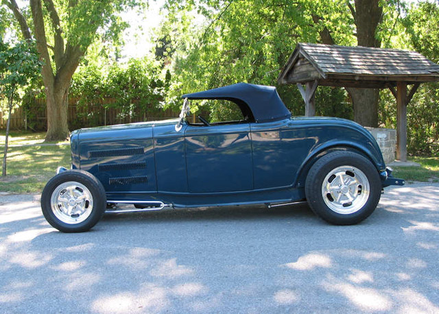

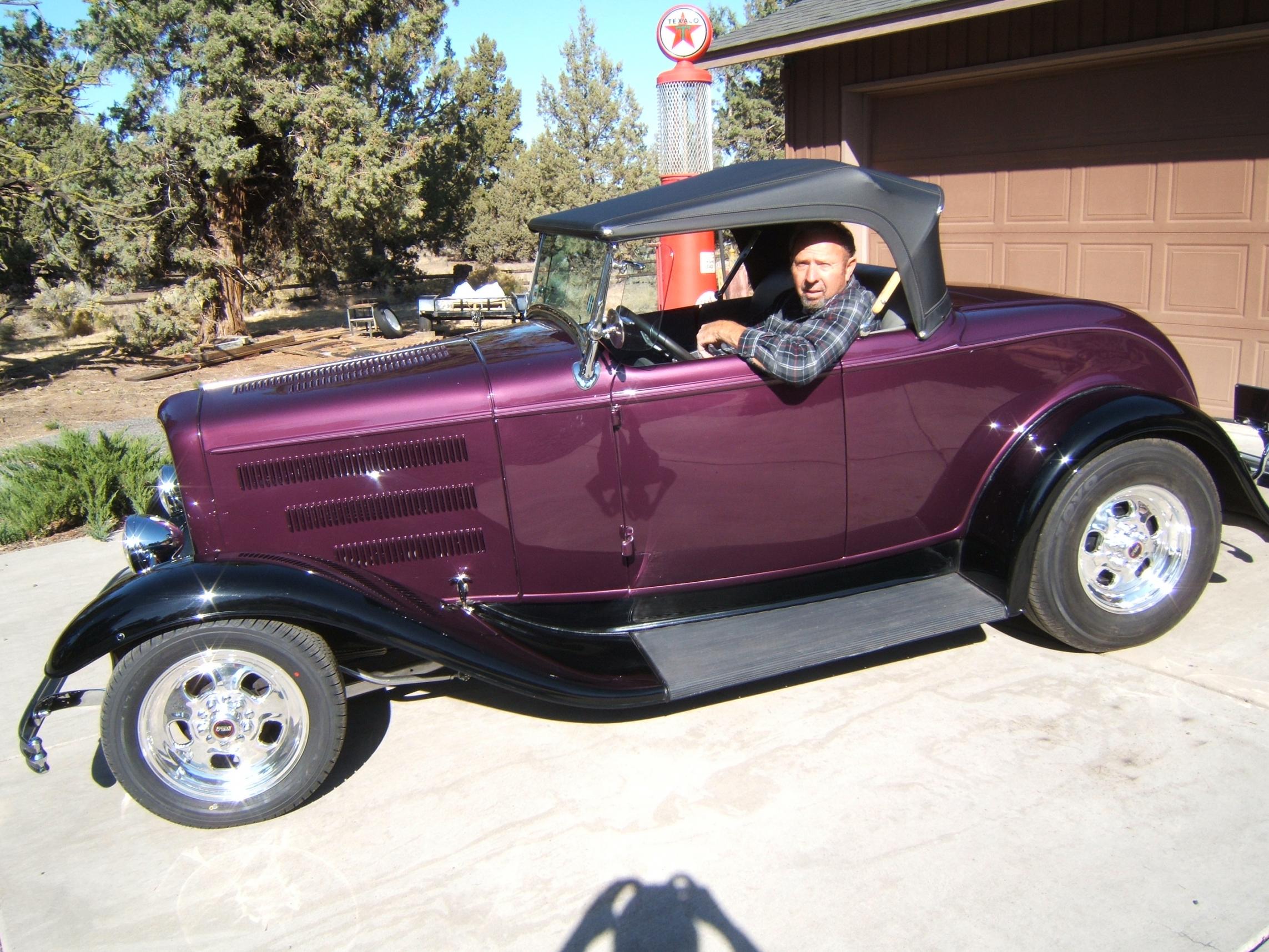

    Here's mine!!

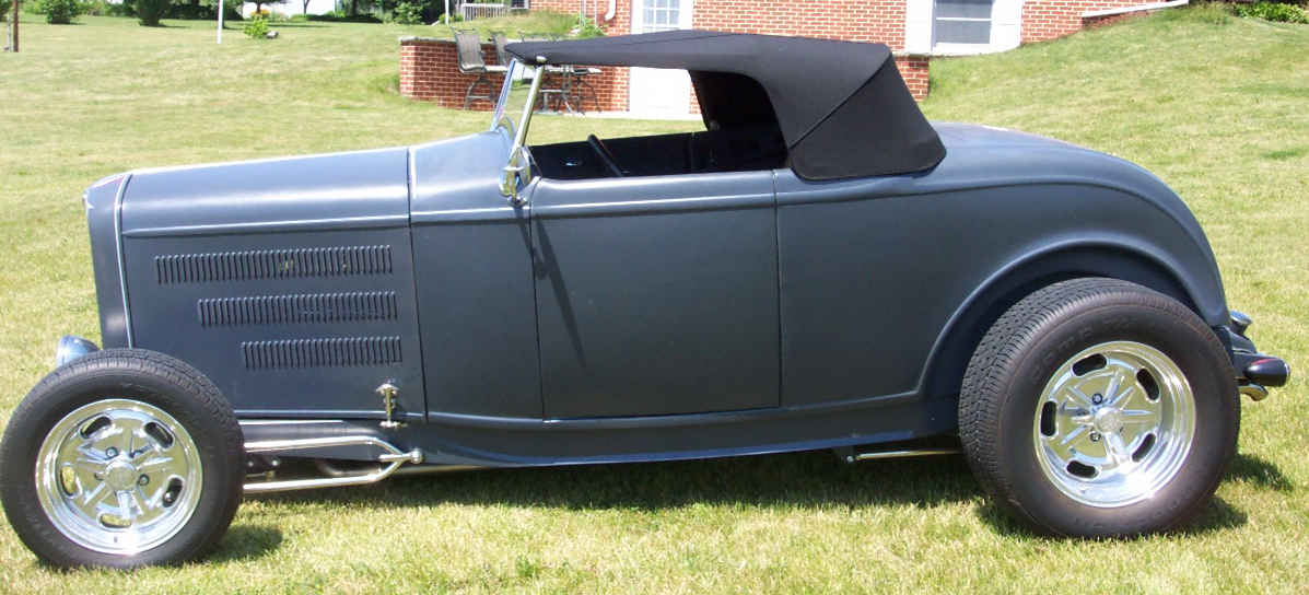

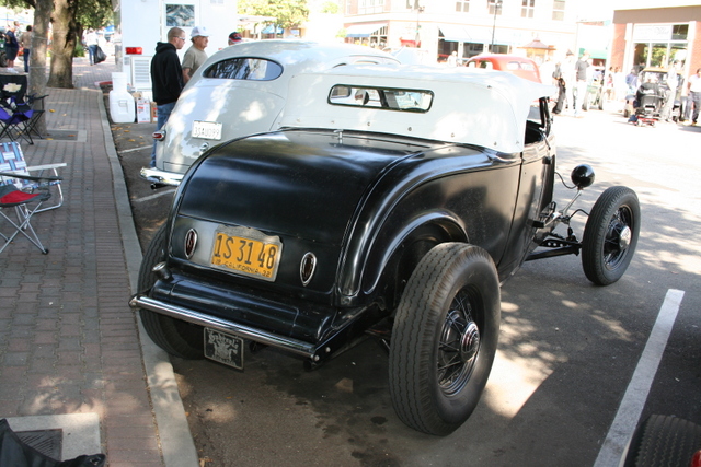

    I've fitted a Kwik Top. They have a few ways to mount the bows depending on the shape you want. I modified this one a bit. Hasn't been trimmed yet.

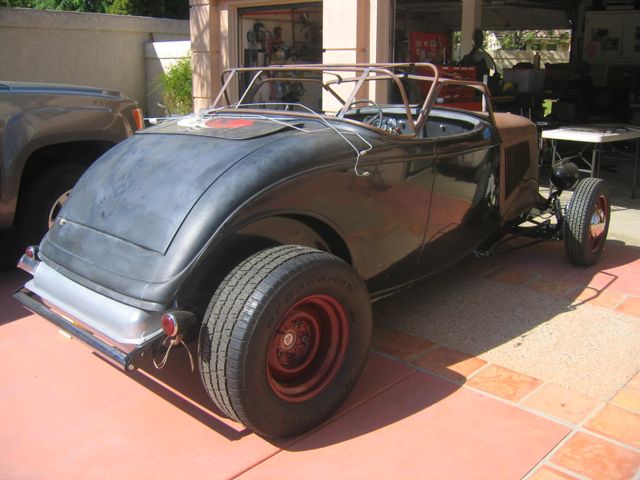

    I made my own out of 5/8" conduit...I made a header out of oak and covered it in masking tape several times and standing back and looking at the shape...I cut it about until I got the look I was after.The conduit was bought from the local home depot type store and I used an external 5/8" bending spring and my kneee to get the proper bends(a bending machine would pull the radius too small).I made some stainless clevis`s to mount it to the two lugs on the body and bot the whole deal powder coated to compliment the steering wheel and top material.The two rails that I made that runs from the main hoop to the header were detatchable and allowed the hood to be broken down.I took it to the trimmer and gave him a template of the mailslot back window and told him I wanted it drumskin tight.I also got him to knock up a pair of side screens as well(made a huge difference stopping buffeting at speed in bad weather).I was building on a tight budget, but It turned out ok I think.

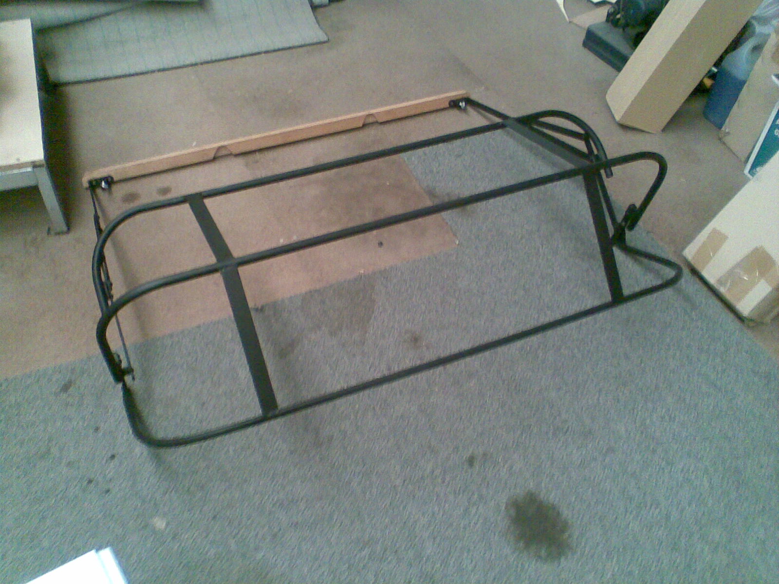

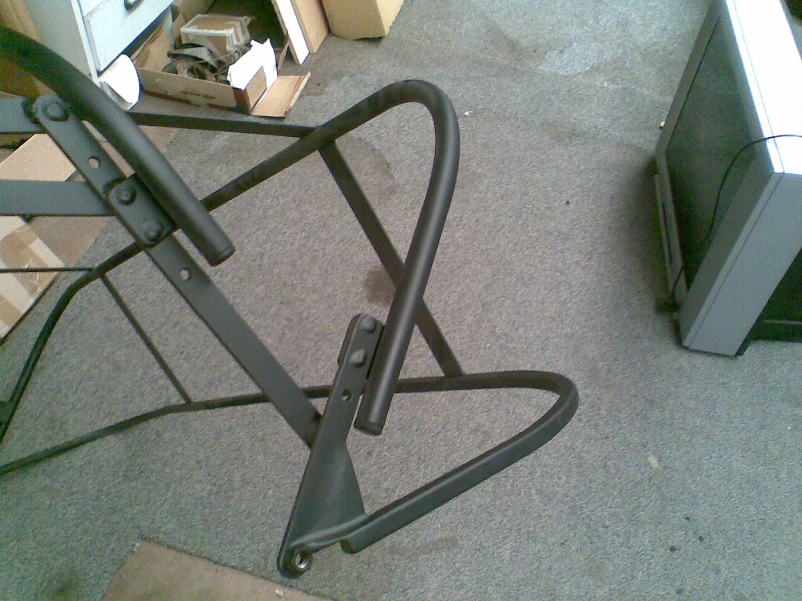

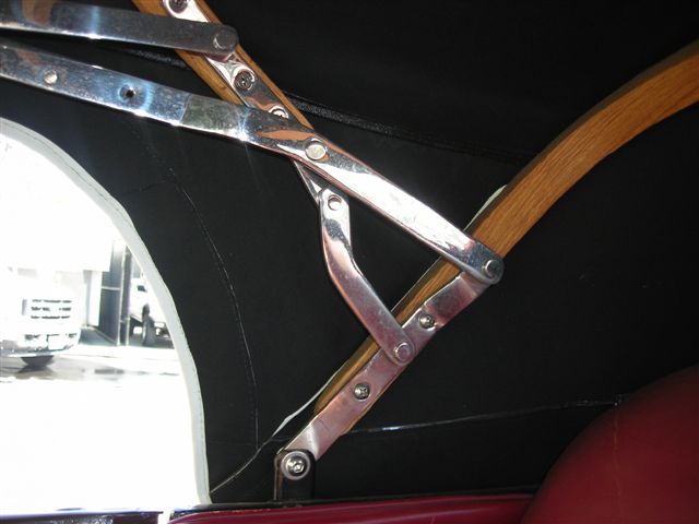

    I was asked for pics of the square tube around the bottom to take the snaps, so here goes. Because this top has been made rigid I also added some flat straps to add a bit of strength and resist the bows flexing against the trim tension. Probably overkill.

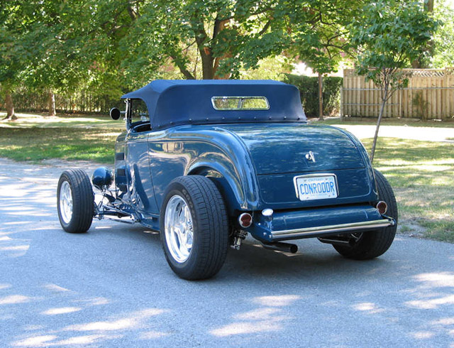

    I made this top with a oak header and welded .75 round tube. I added 18g flat sheet metal around the rear for the upholstery to be attached to. The seat was low in the car so I wanted the top to have a low profile. I also pushed the back to midway between the ****pit and the deck lid. Used a '34 roadster rear window.
