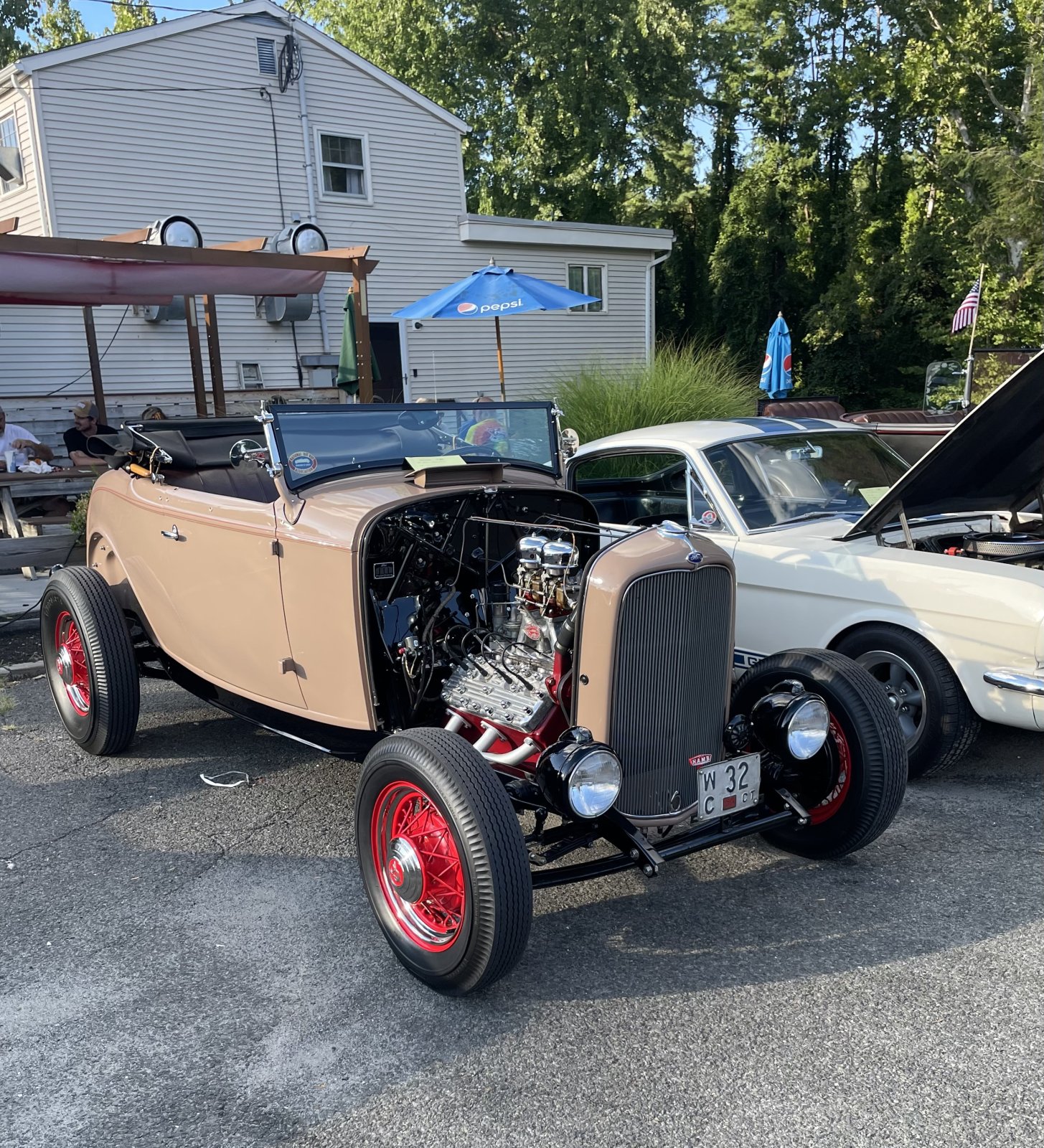

    This is mine- LB 2" chop. But I know it is not chopped enough because I can still see the traffic lights.:cool: Some day another inch or so.:rolleyes:

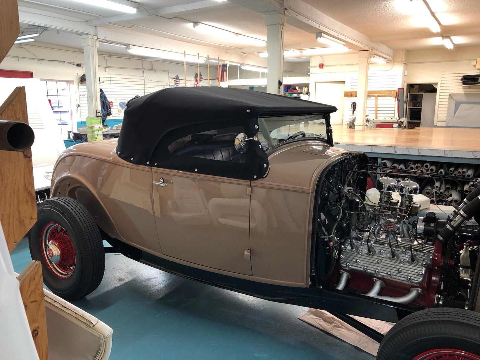

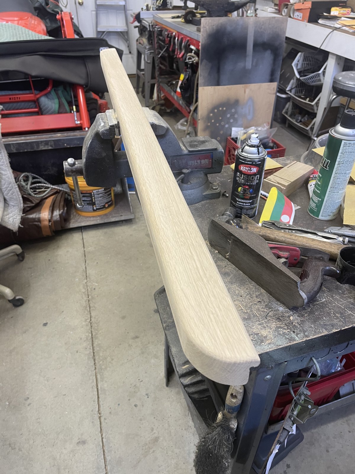

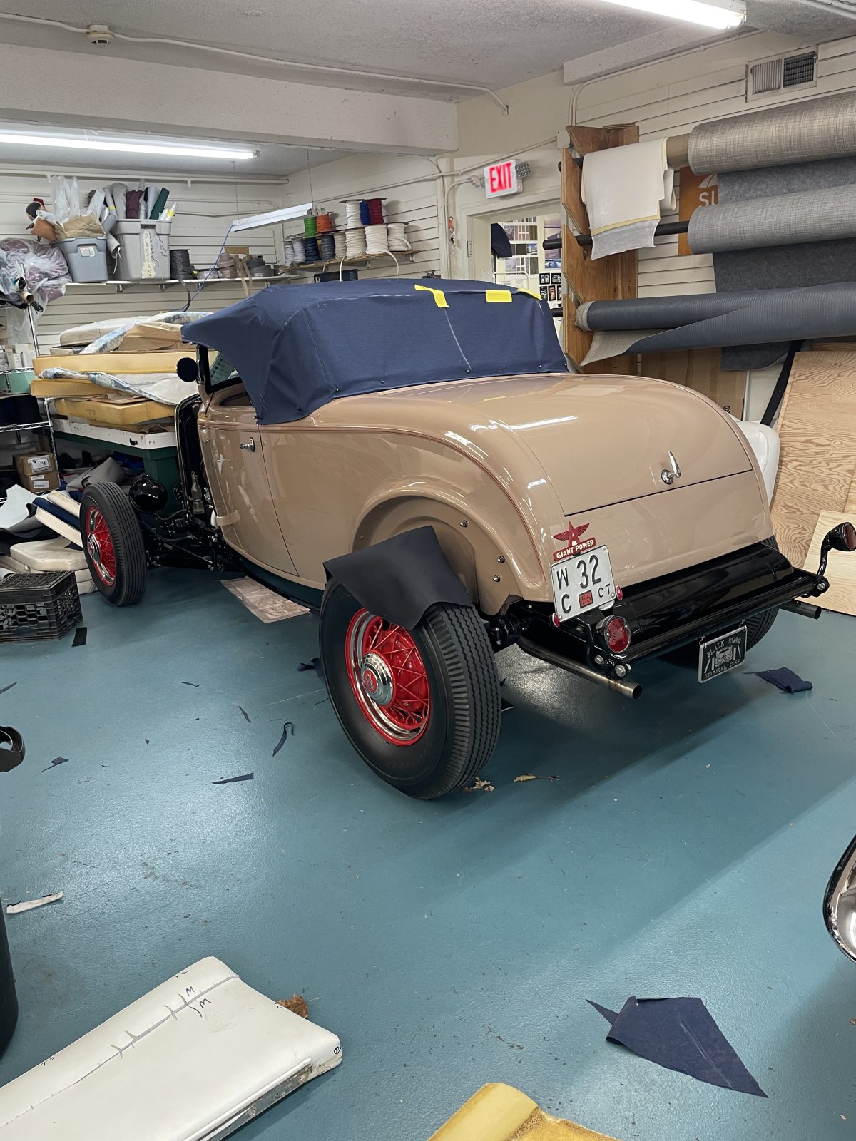

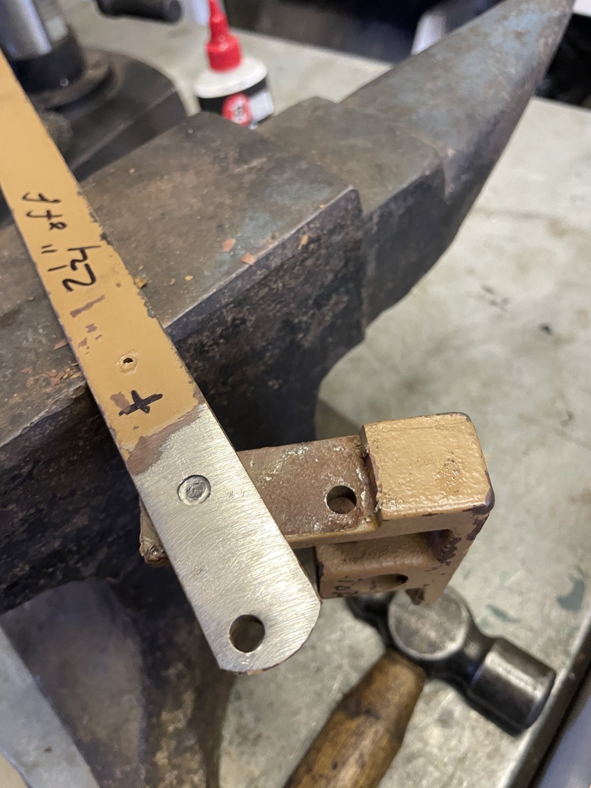

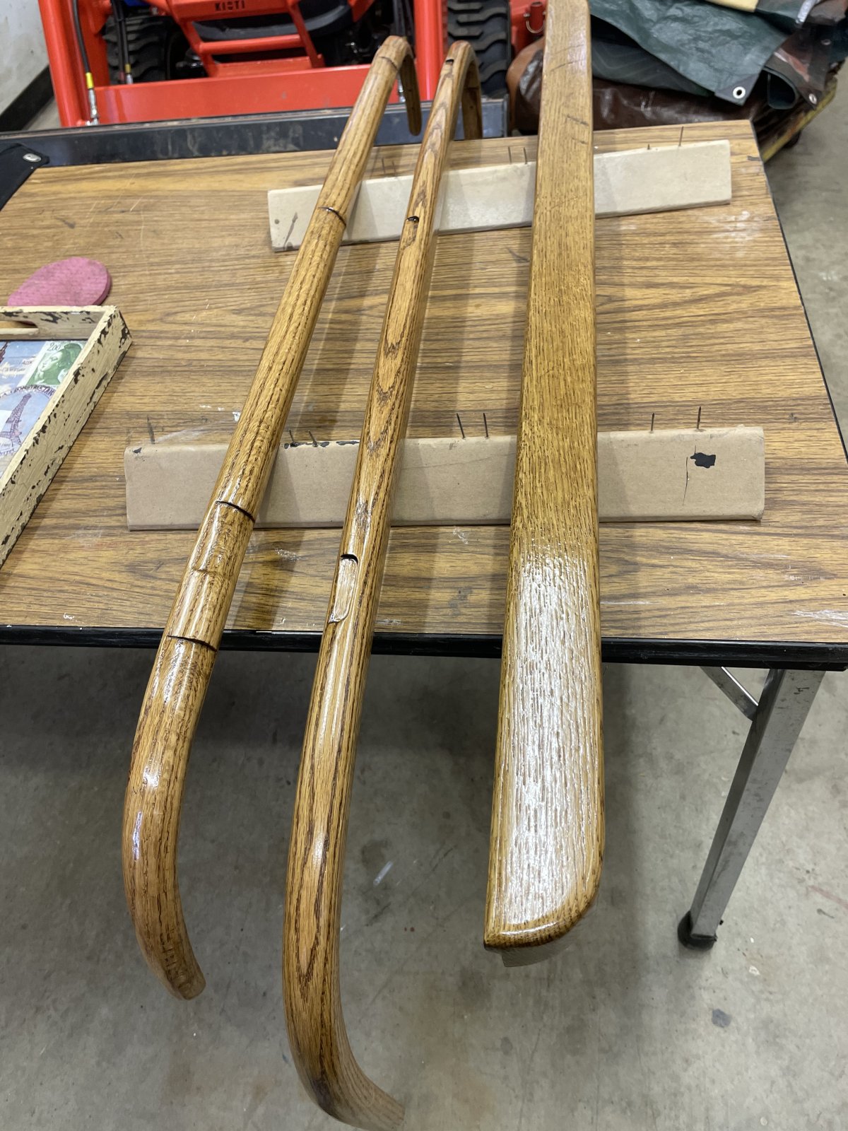

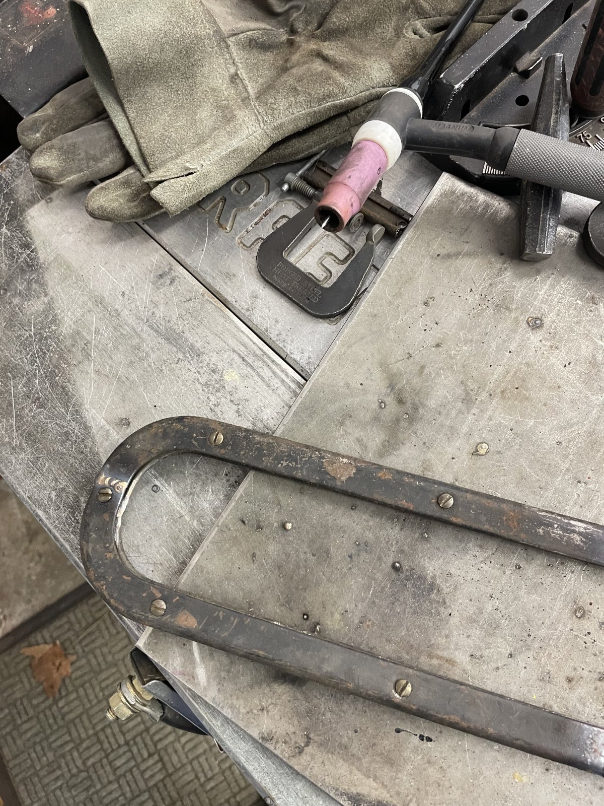

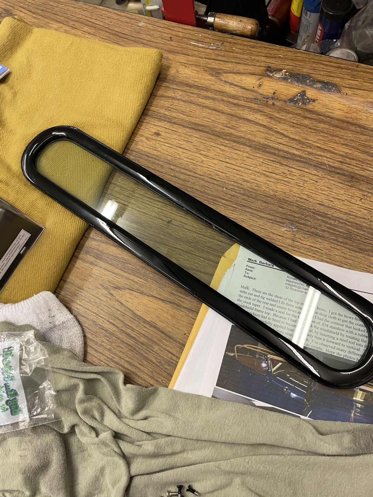

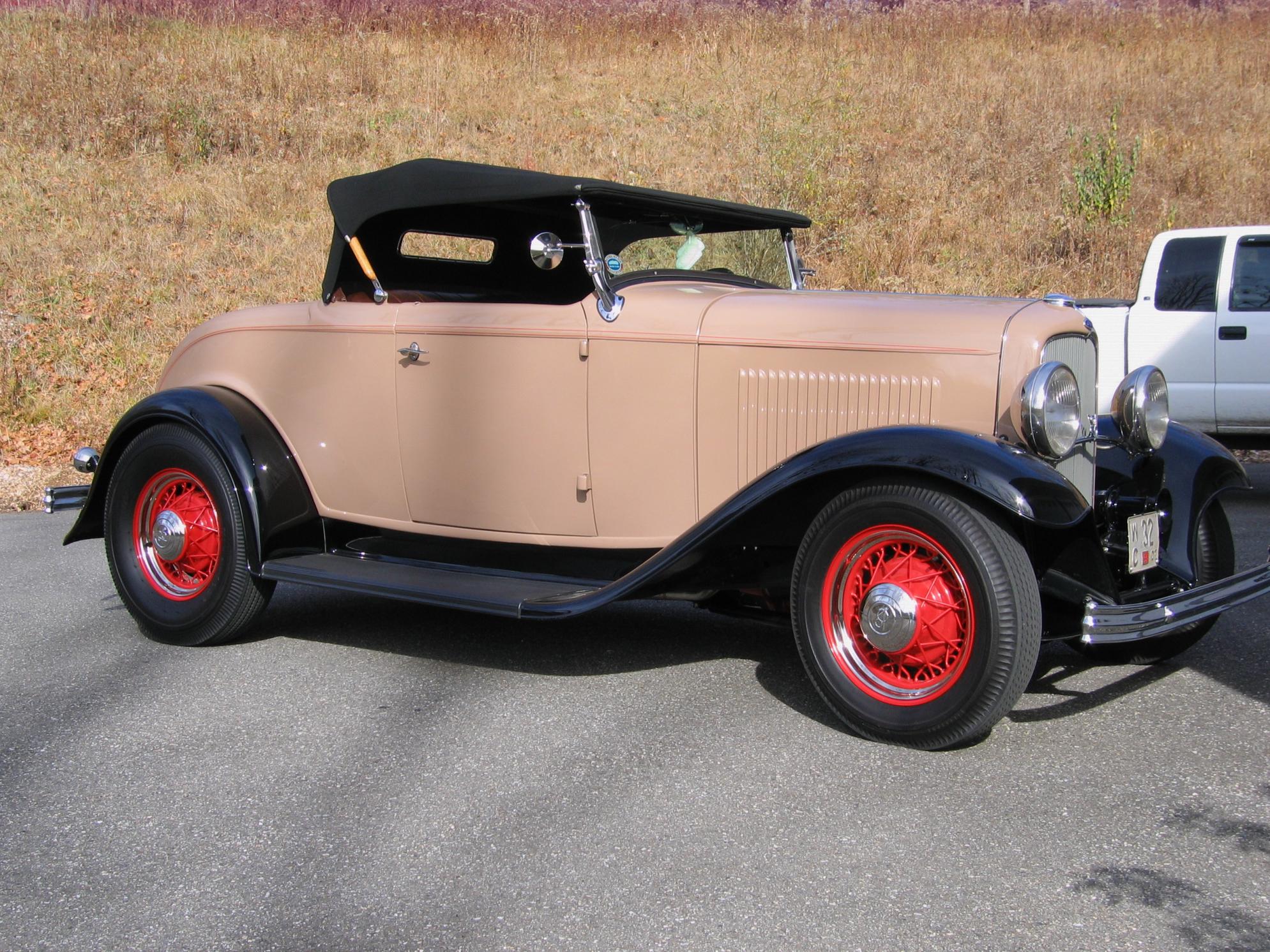

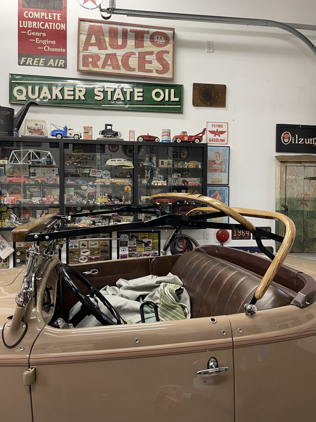

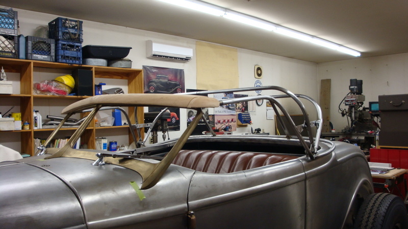

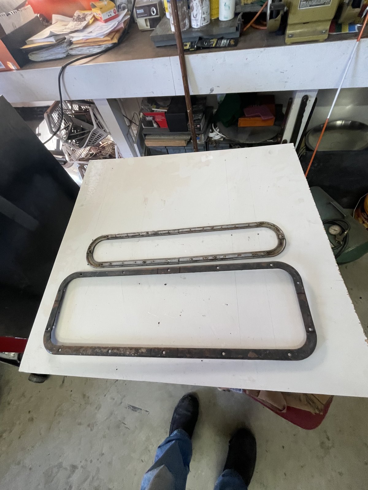

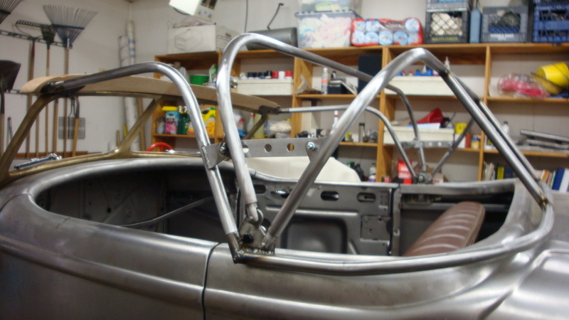

    Well I am in the process of doing my 3” chop. Did the irons from old originals. Made the header and modified bows. Made the rear window from an old frame cousin Ted had laying around.:cool: Started a mock up at the trim shop today on some cheap pattern material. Finished will be black Hart’s. Also doing side curtains. Did the windshield awhile back. D9903496-1744-4BEC-AD34-4D45530B4D69.jpeg 5EDAA7EE-4573-438E-B84B-3F3B93FEFB70.jpeg 77E53D88-8813-4753-B758-306B4A089621.jpeg E05468E8-D15C-4F98-A02A-8948A9022074.jpeg 5AF8413D-19C1-4936-9D82-E88CC5B05CAF.jpeg 053F6A13-7838-4061-B180-D7518B5BE638.jpeg 461FCEEA-5DB6-4380-96A0-04C2B302F555.jpeg B27CA221-3156-4170-A12A-261C607FB9B9.jpeg F9136EA6-2088-42A9-B7D7-17D413680C03.jpeg EA6E89A0-5491-4314-ABD0-713C70D1F2C8.jpeg 9CA53D55-0E89-49BE-852C-7C6072E3E534.jpeg

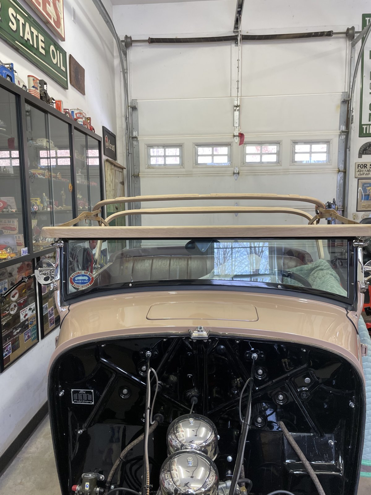

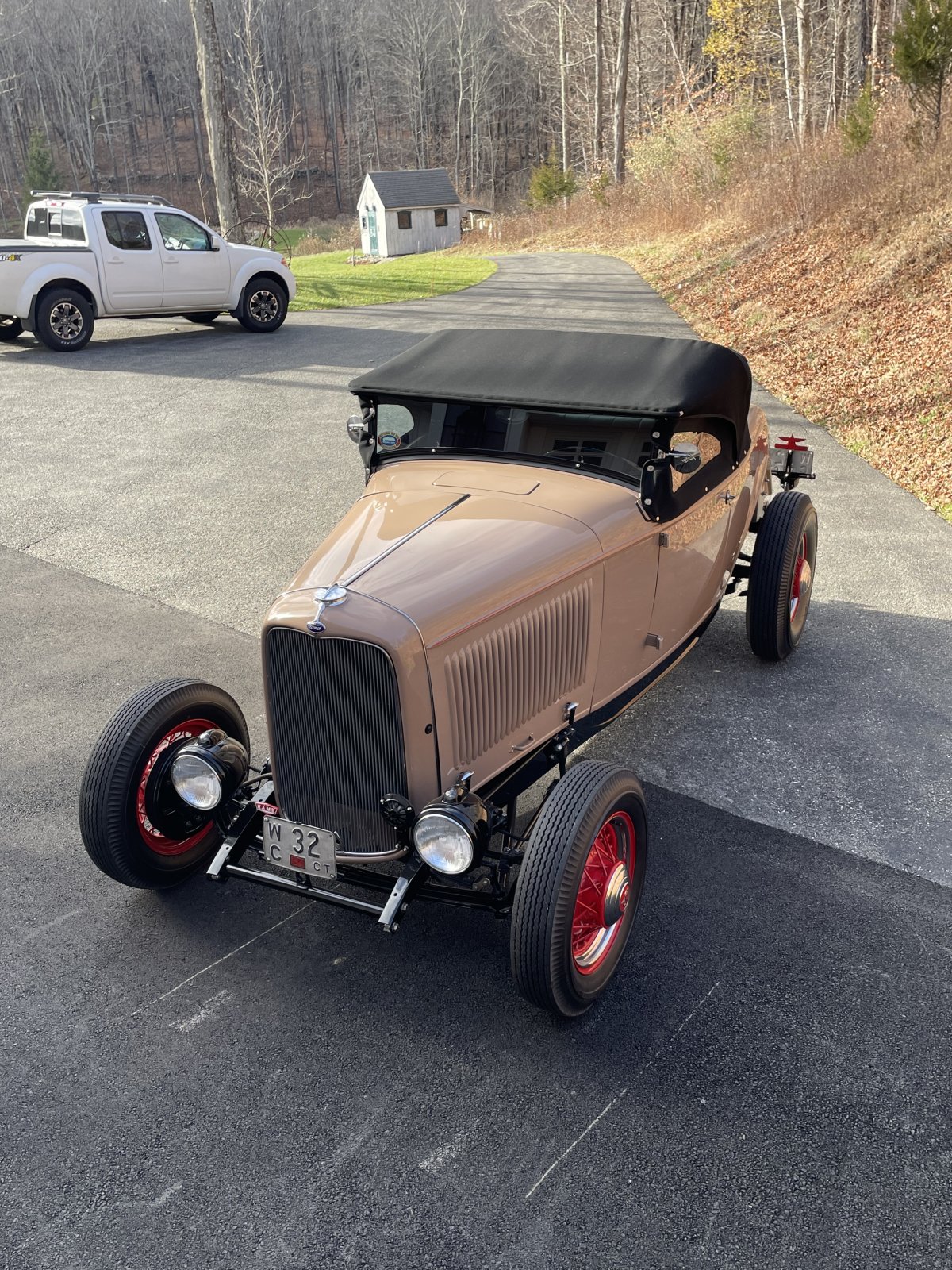

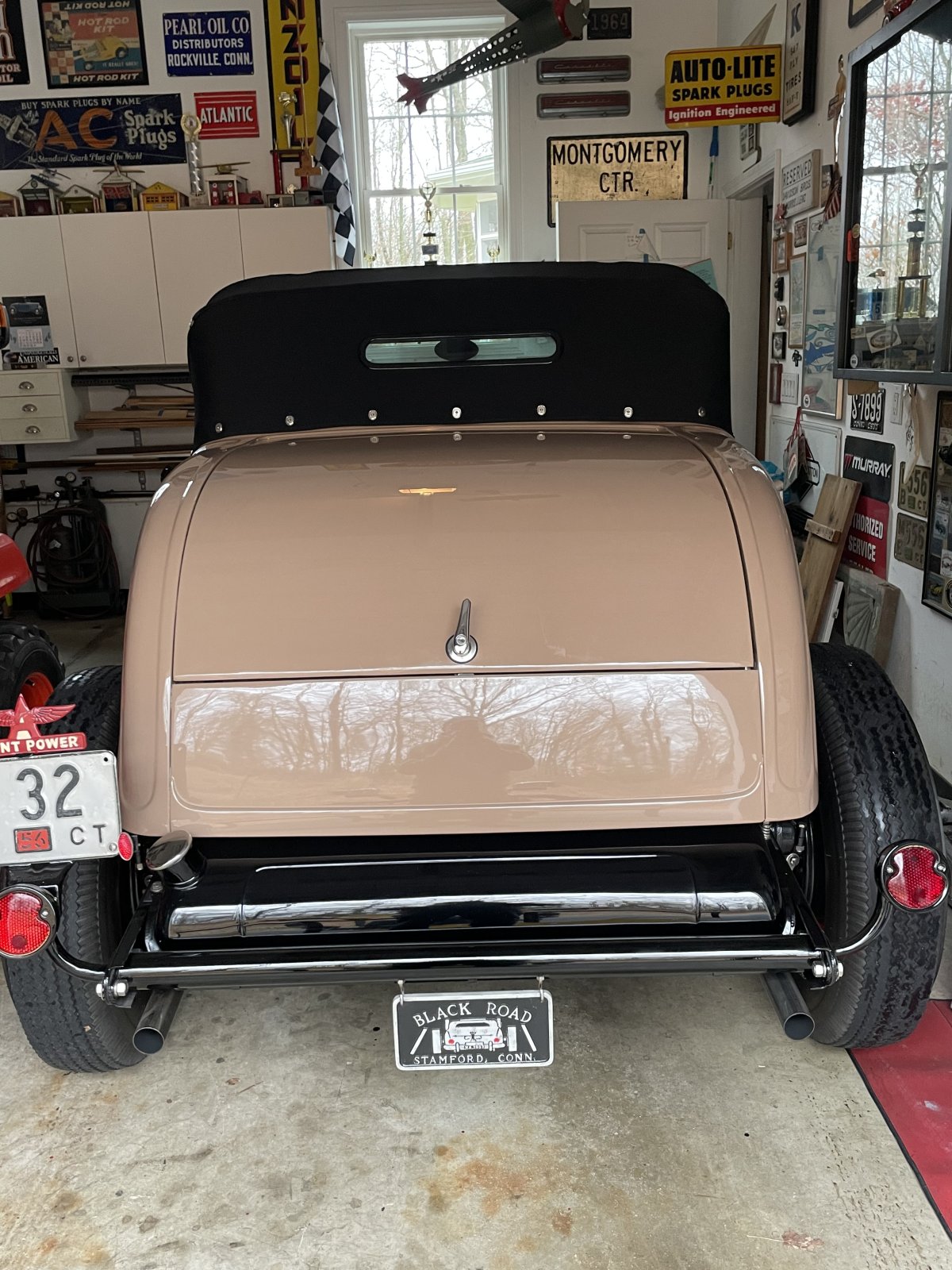

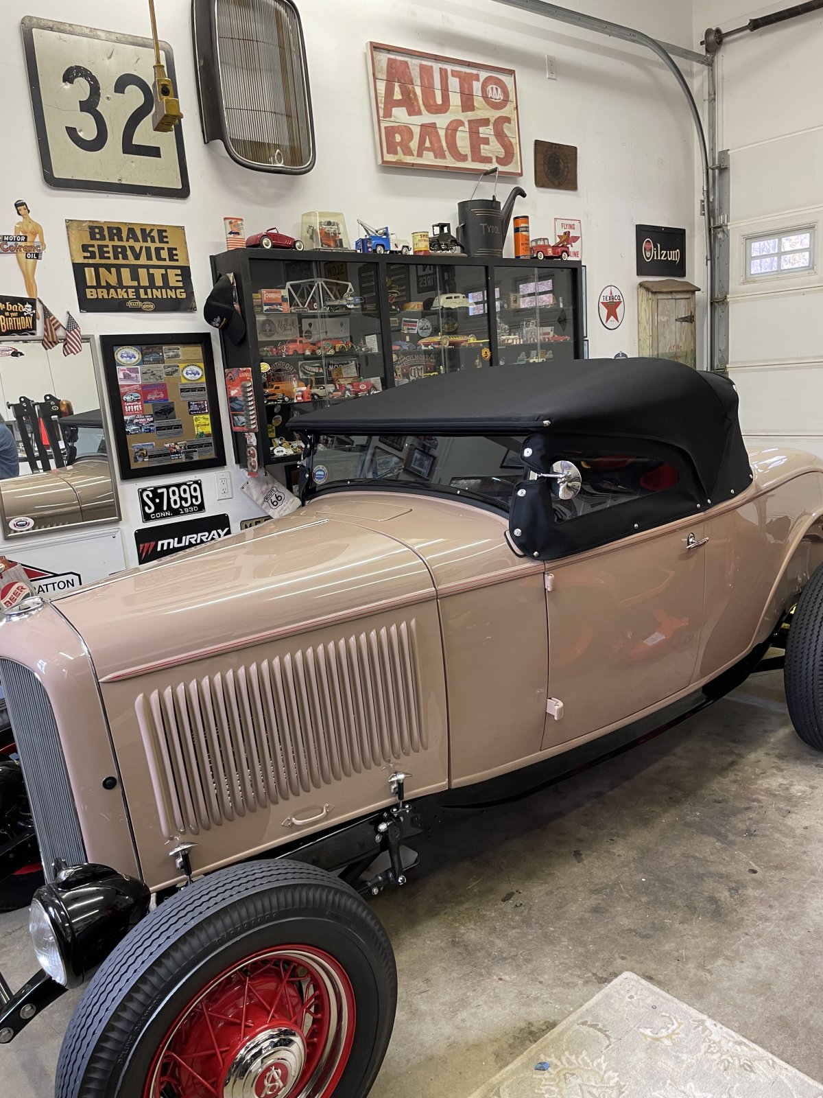

    Top all finished. Picked it up today. It’s like driving a chopped coupe:cool: E97C143C-8565-4748-8998-DA5CEC6F4FB1.jpeg 10607F64-1D78-417C-B4FD-1E9DFF174466.jpeg 7CE40891-7647-4788-BF1C-13AAEE86E7A2.jpeg 9BED34B5-3339-4FE5-B375-ADFDE0800F7C.jpeg
    Cyclone_racer, echo ed and GordonC like this.

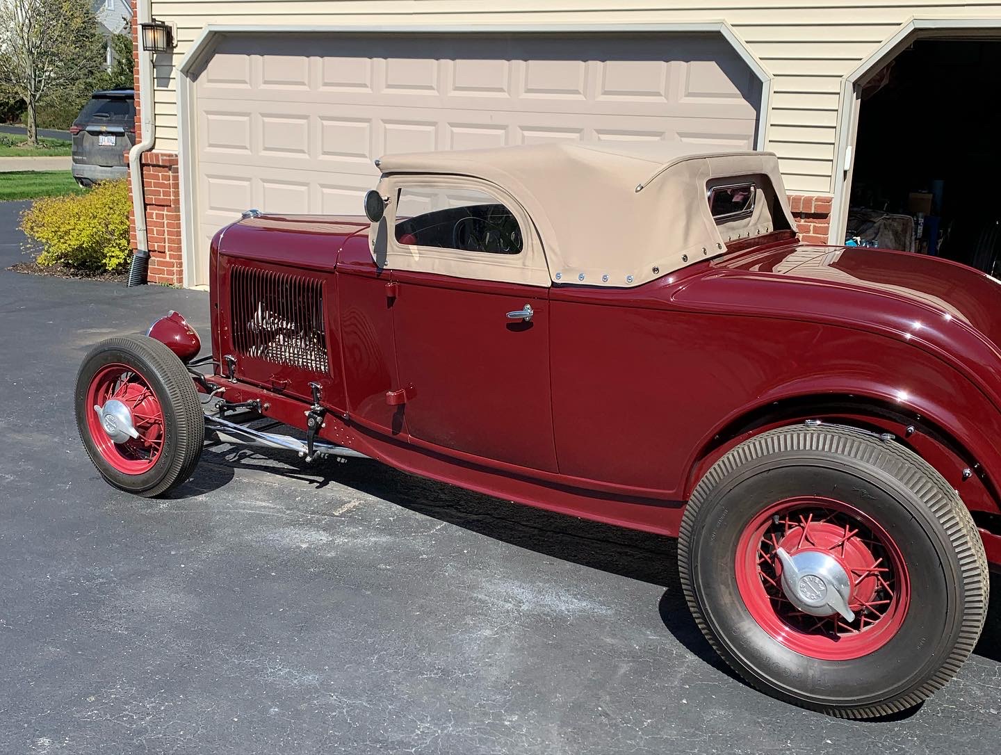

    That turned out fantastic @ct1932ford !! I love your side curtains too. I haven’t taken mine off since complete as it really takes the heat off the summer sun (3.5” chop)

    Thanks for the compliment. I can fold mine down. I like that jalopy look. How do your side curtains mount on top? Do they just slide inside the top? I am going to need some additional support for mine. Maybe a small strap to the irons. The rods are too far back to offer support in the middle.
  9. x77matt
    Joined: Mar 2, 2004
    Posts: 832
    x77matt
    Mine are just retained as the top overlaps them. The ability for your top to fold down and not get in the door opening is a big bonus in my mind.

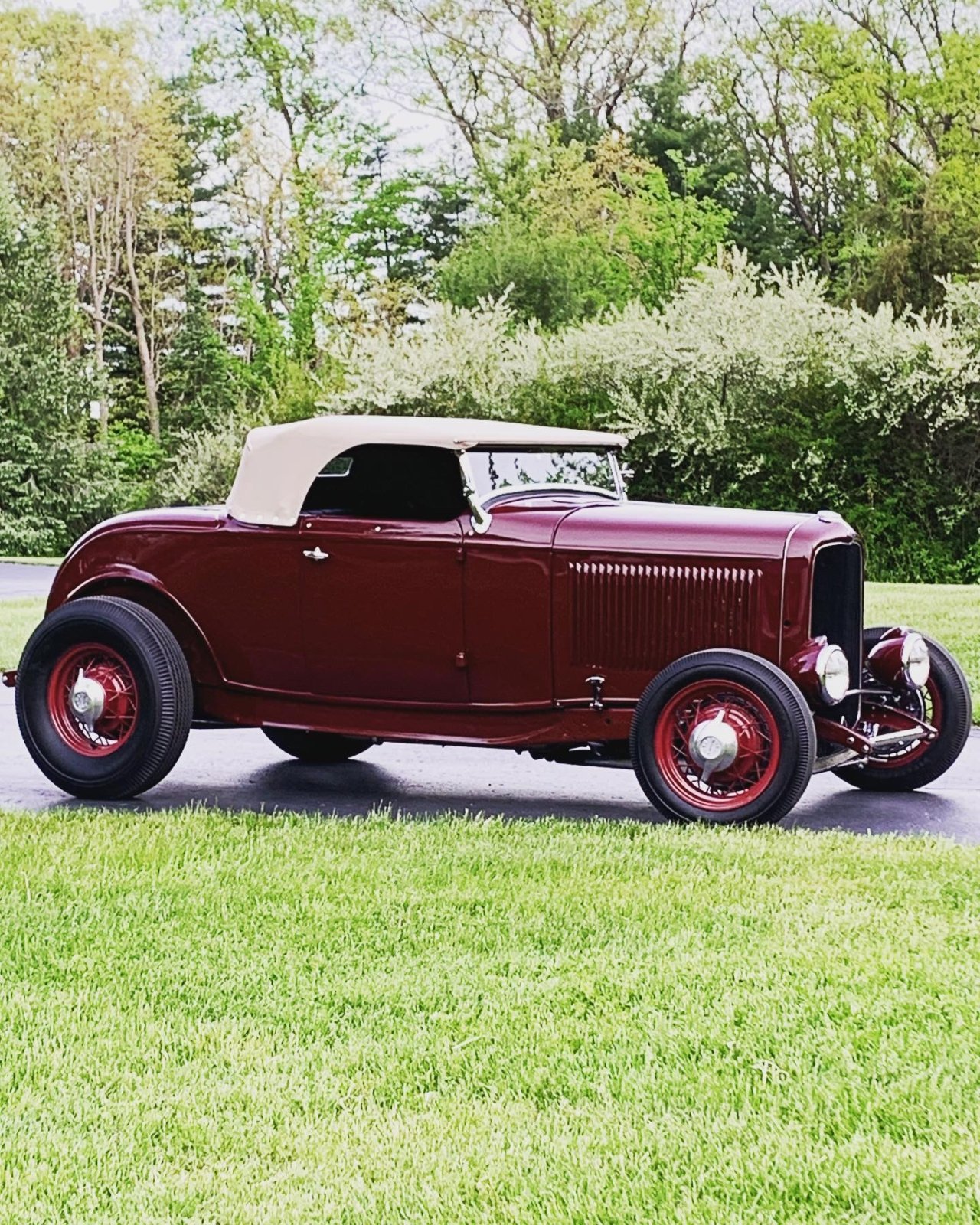

  12. ct1932ford
    Joined: Dec 3, 2010
    Posts: 13,501
    ct1932ford
    swifty and x77matt like this.

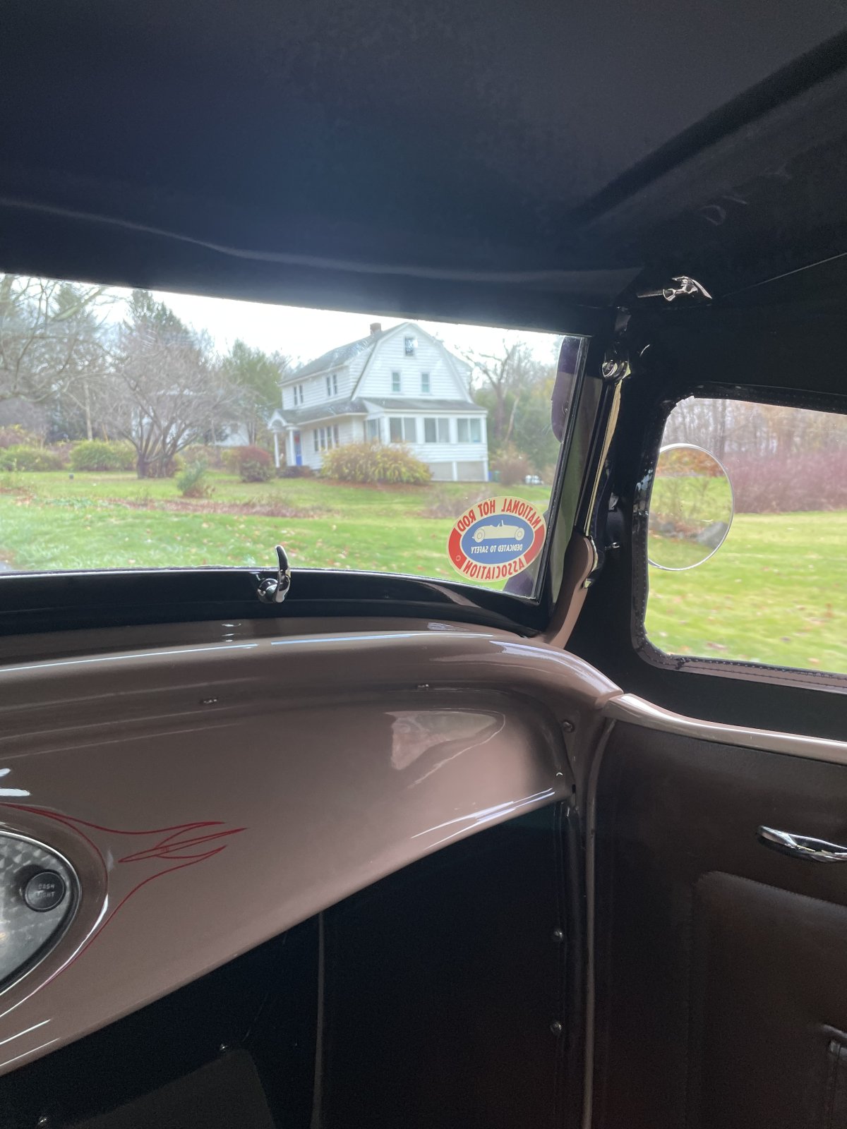

  13. 4bangerbob
    Joined: Jun 29, 2013
    Posts: 157
    4bangerbob
    from AB, Canada

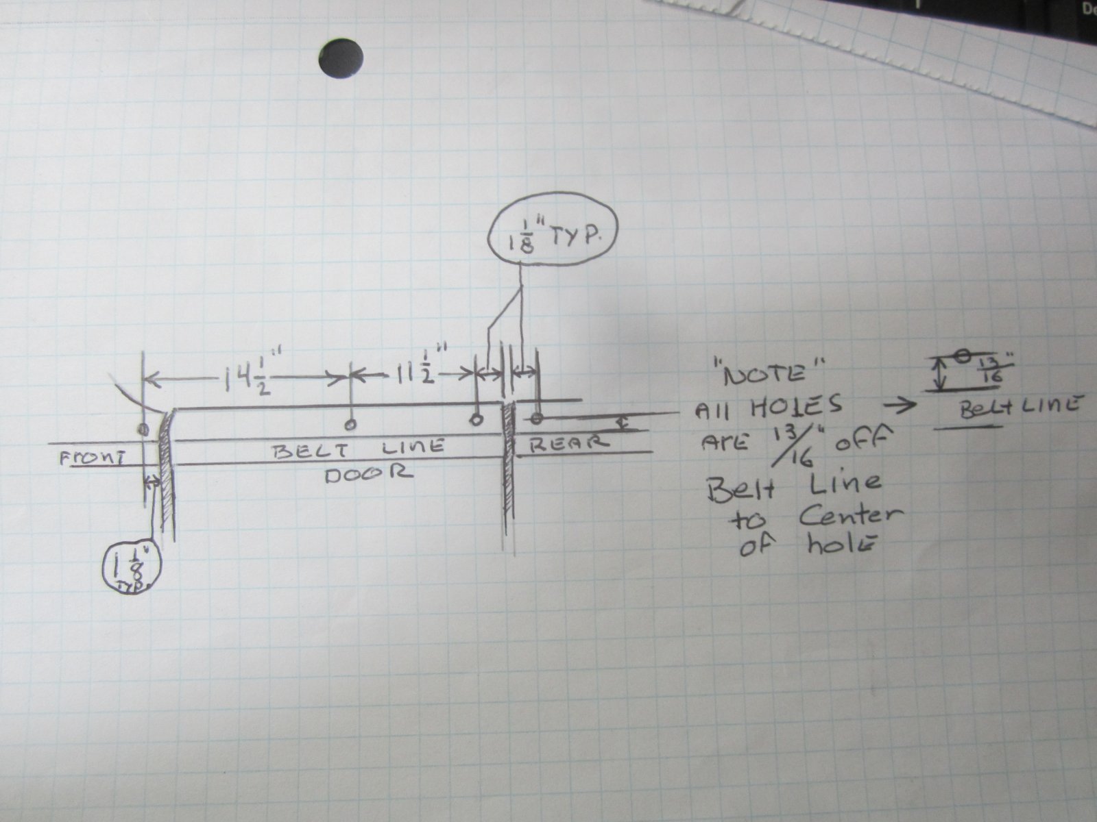

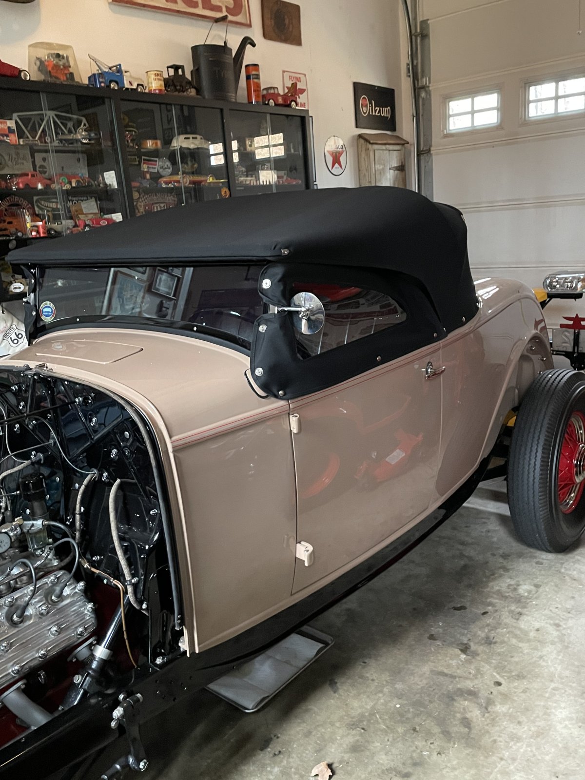

    I really like your top and especially the side curtains. Is it possible you can show some additional photos of the side curtains and how they attach to the windshield post and door? Thank you.
  14. ct1932ford
    Joined: Dec 3, 2010
    Posts: 13,501
    ct1932ford

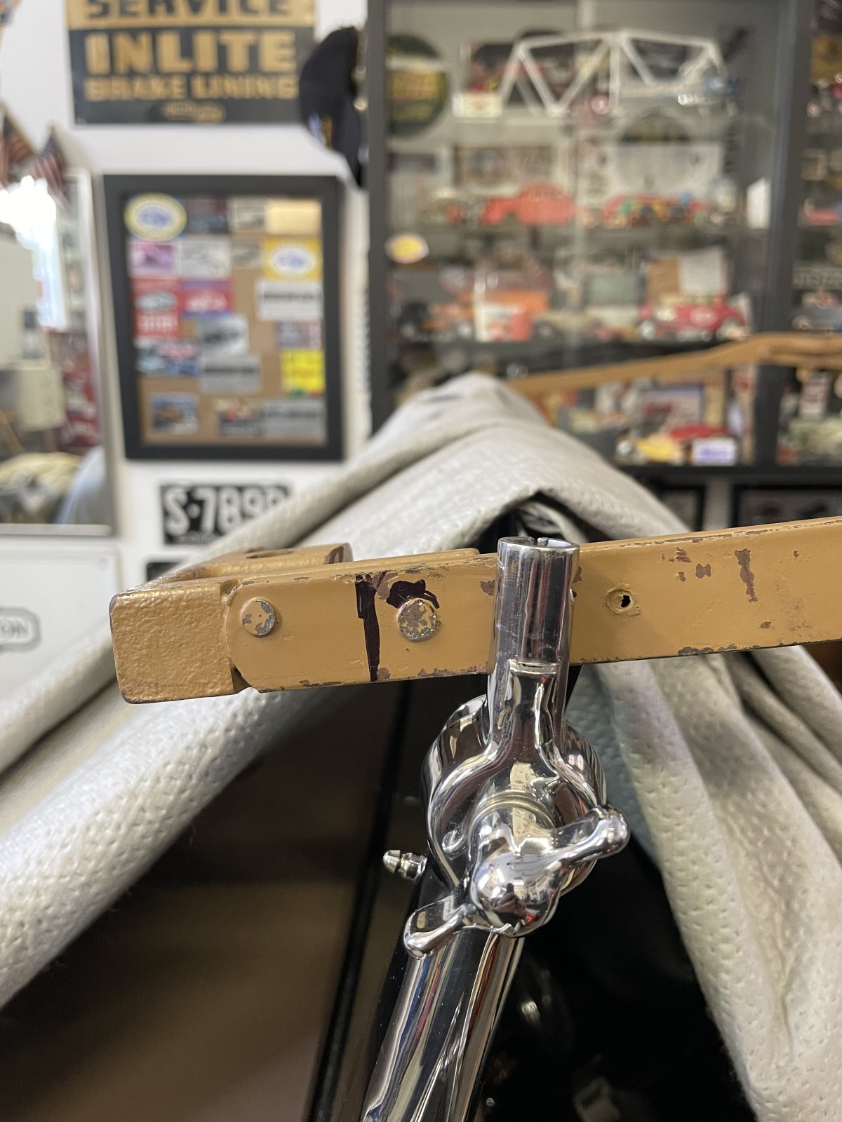

    You can see the studs for mounting on the stantion and windshield frame. I took original mesurements from original car and adjusted for 3" chop. IMG_3059.JPG

    Again you can see the snap placement that i used original car to lay out. IMG_2945.JPG

    Do you still have the layout dimensions for the side curtain snaps? No original 32’s around here.
    These are the door snaps. Some originals had another one at the front of the door. I decided not to use one there. As far as the windshield frame and stantions , is your car chopped?

    Thanks much, @ct1932ford !! Much appreciated!
    Yes, chopped 2”.
