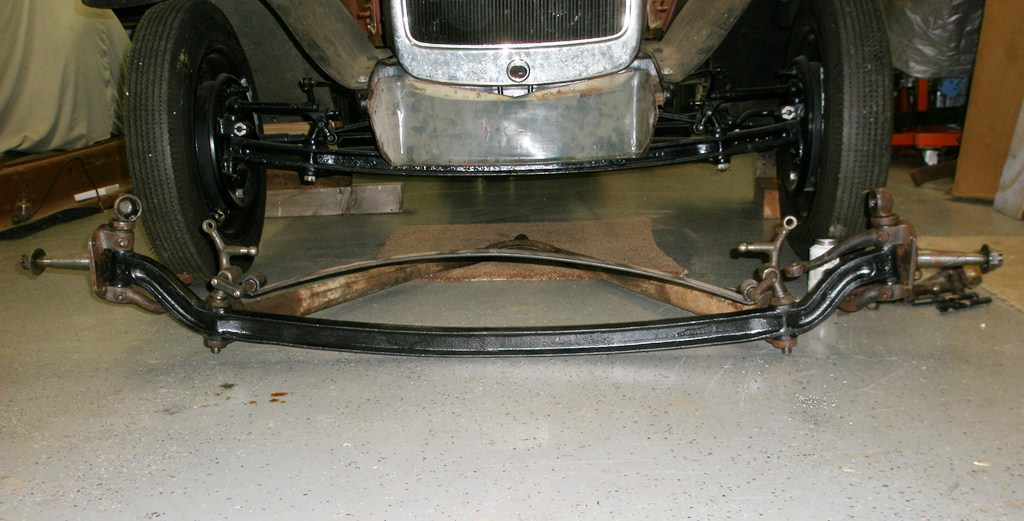

    Just bent a customers stock 32 steering arm yesterday to follow the contour of the dropped axle and there is no way it would clear an adjustable perch on the drivers side. I used spring perch's from P&Js and everything cleared good. Perch was long enough that I used a lower bolt on shock mount that the customer requested.

    Here are the perches you mention, A on the left '32/4 on the right.
    Also, dropped Model A axle mocked up with '32 spindle and perches, plenty of stub sticking out the bottom.
