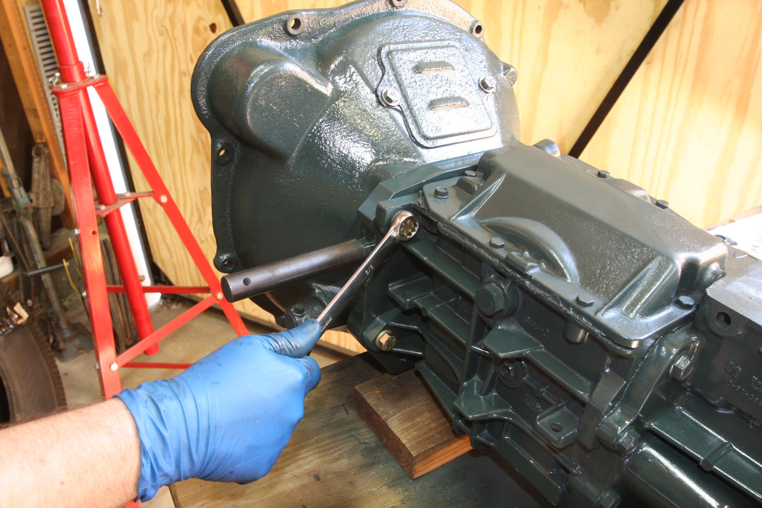

    AA and BB bell housings have a different bolt pattern to the primary engine housing, I have had both, the images above are BB truck, I adapted a TR6060 to a 33 B engine, as stated I used a 16mm aluminium plate to join the housing to the trans.
