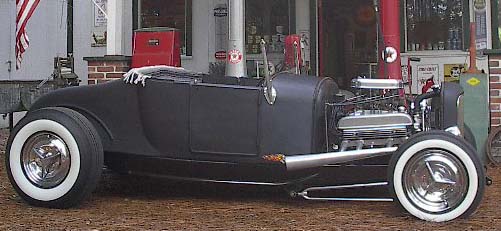

    Mine's channeled a couple inches...so the frame had to be narrower than stock. It ended up being about 3" narrower than stock at the front spreader bar and about an inch wider that stock at the rear. Thats how the contour of the rails ended up matching the body the best.
    I've pictures of highboy T's from the '40's on stock width '32 frames...the top edge of the frame shows about the whole length of the body and looks funny. The lower edge of the '26-7 T's are narrower than a model A.

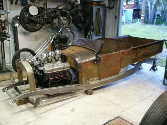

    Here are a couple more pictures.
    One of the car sitin on the rails (but narrower than stock width).
    One upside down before I started cutting the body.
    And one rightside up again channeled.
    I kinda miss my old big shop!
    -Jeff
