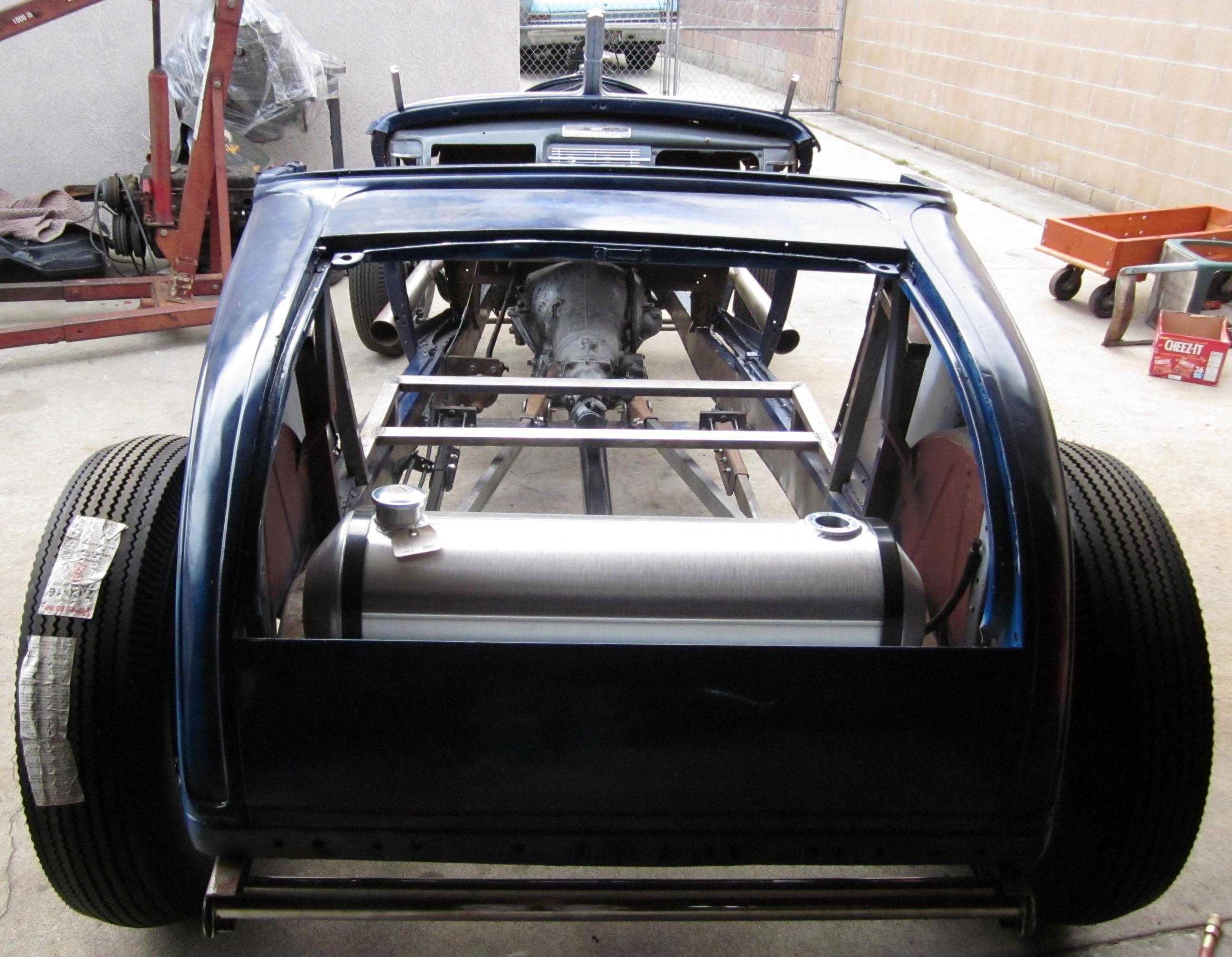

    MATACONCEPTS
    $750 rails
    $150 boxing plates
    $75 front crossmembers
    $150 speader bars
    $100 S10 rearend (PERFECT WIDTH)
    A big ass heavy duty (accually a 2x3 warehouse rack boxed tubing) trans crossmember & chevelle rear arms lengthend to mount the same crossmember centering all the energy & wieght.
      503.1 KB
      199
