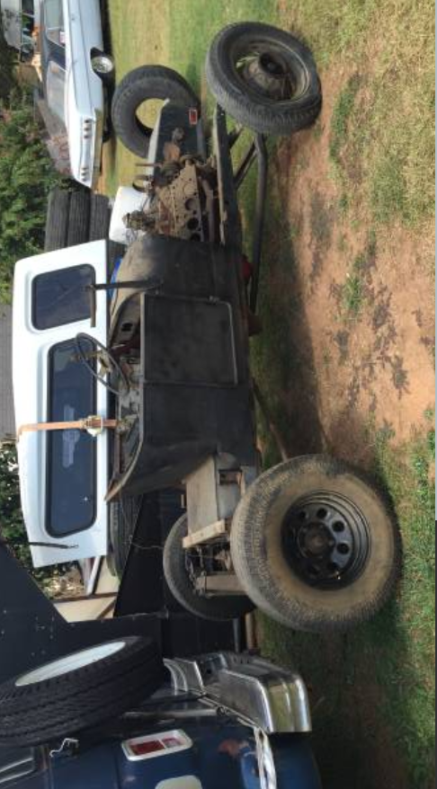

    I know the pictures aren't very good but can anyone tell me if it might be a 32. The seller is telling me it is. 527035089.jpg 527035116.jpg 527035124.jpg 527035142.jpg

    Looks like a Model A frame from here.

    Nothing is 1932 that I can see, all Model A, rear end is V8. Bob

    Thanks I'm wanting to build a AV8 it looks like a good start but I don't want to over pay for it.

    Yes, if it can be bought right buy it, just don't pay the price for a '32 frame. Looks like you are buying juice brakes a flathead of unknown quality and a rear axle, I'm thinking it is a $500.00 pile. Bob

    Model A frame, front axle looks to be 37 or later, (used long shackles to make it work), Later rear with the A spring mounted behind which shortens the stock A wheelbase unless the frame has been extended.

    So I could use the frame front end steering and transmission but would have to change the rear end to set a A body on it?

    Not sure what the steering is, could be a 35-48 ford rotated for side steer. As you stated, you could use what you mentioned. You could also use the rear end, just extend the frame and correct the wheelbase.

    are you thinking the frame has been shortened?

    A stock Model A rear has a spring over top the axle, the later has the spring behind, when used in a stock A frame, moves the rear axle forward shortening the wheelbase.

    Oh ok now I understand thanks so the frame is right I would just have to move the rear end back under the spring.

    The seller probably considers he is selling you a "car"; but it doesn't look like it ever was.
    Looks to me to be a poor choice as a start to build an A/V-8.
    Wrong front axle and bones, wrong steering, from the looks of the weld marks all over the rear cross-member the frame may be cobbled up, engine left open to the weather, etc, etc. Not really a lot there.
    Better off to get the correct (and good) parts the first time.

    You didn't mention it had a 26-27 T Roadster body...............forget that $500. I mentioned earlier.:rolleyes: Bob

    I can get it with the body or without. I was trying to get it without to save money because I already have a 30 roadster body.

    I think the body is the best part of the entire "ac***ulation".
